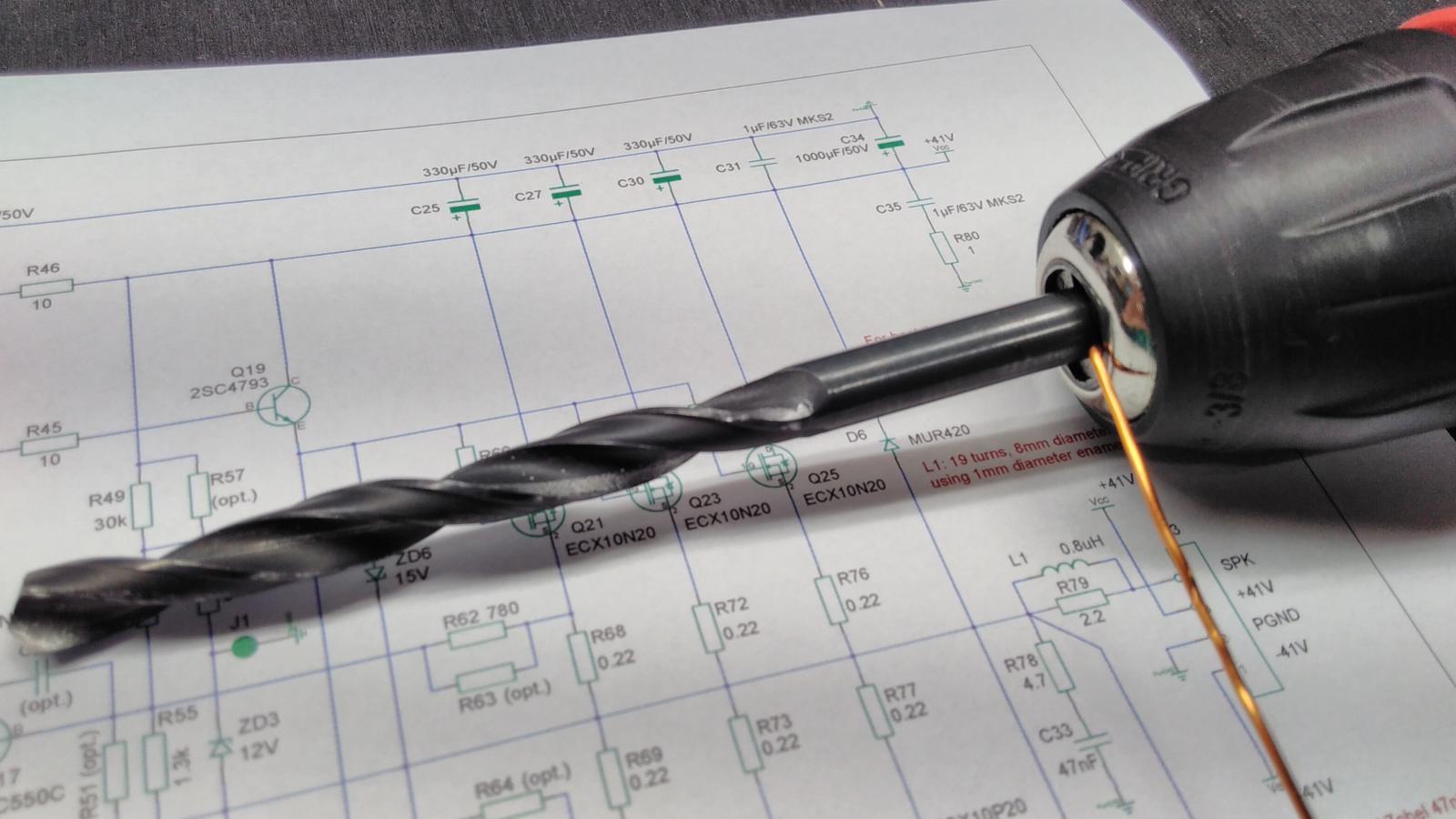

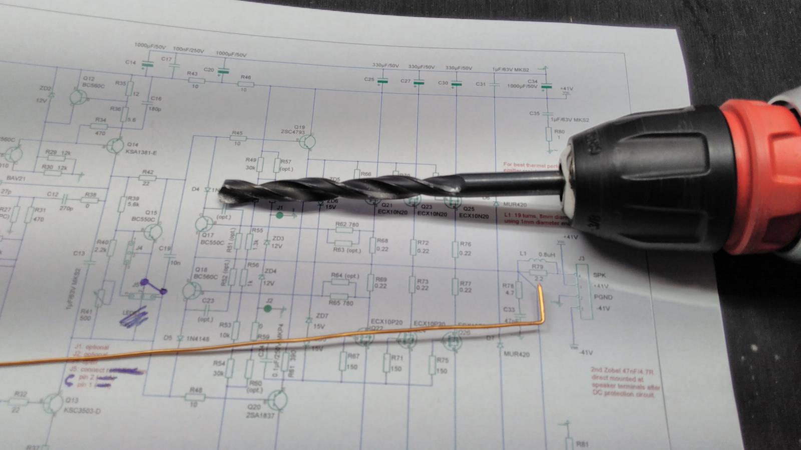

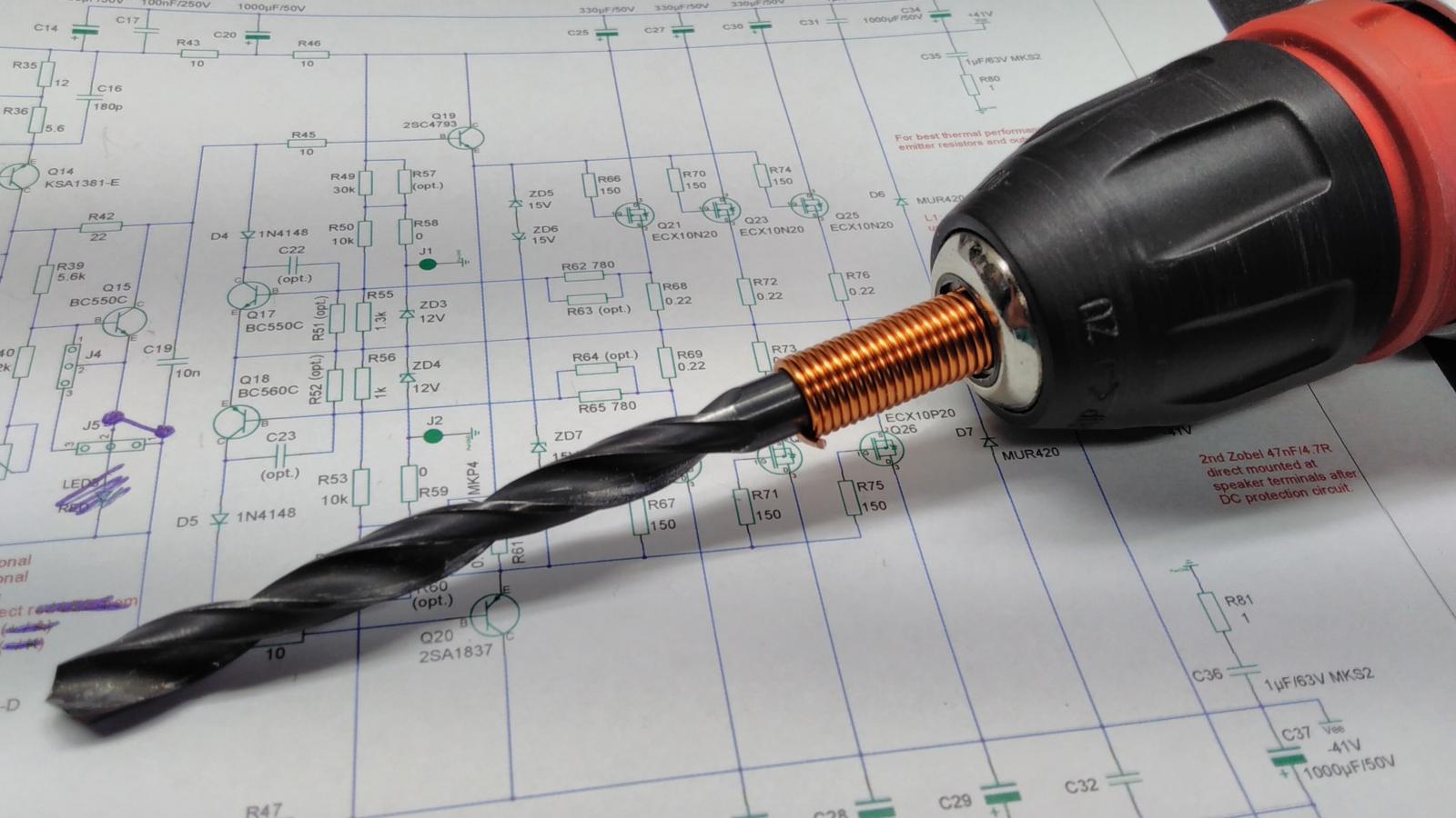

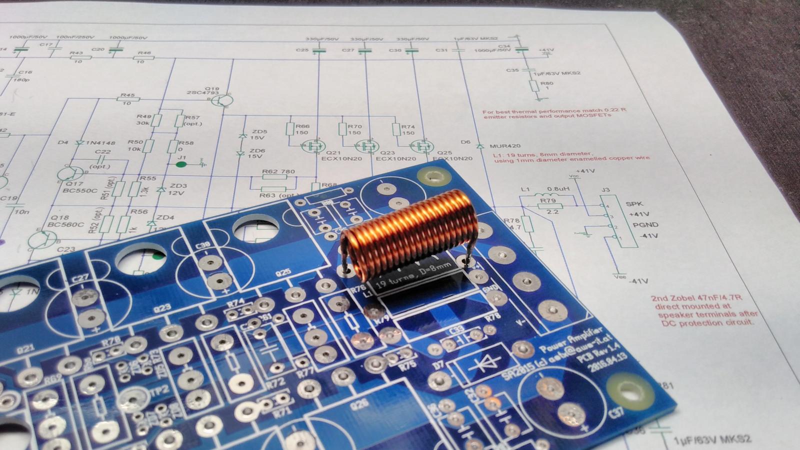

SA2013, SA2014, SA2015 - output coil - making of
Thx!
My quick 'n dirty method to create the coils used in my power amplifier projects:
  • get 55cm of 1mm diameter enamelled copper wire
  • bend 1cm as shown in picture 1
  • use 7mm diameter drill
  • insert wire
  • rotate slow counter clockwise using battery screwdriver
  • 18 - 19 full turns ...
  • depending on the final diameter your coils inductivity is between 0.8 to 1.1 µH
Have fun, Toni

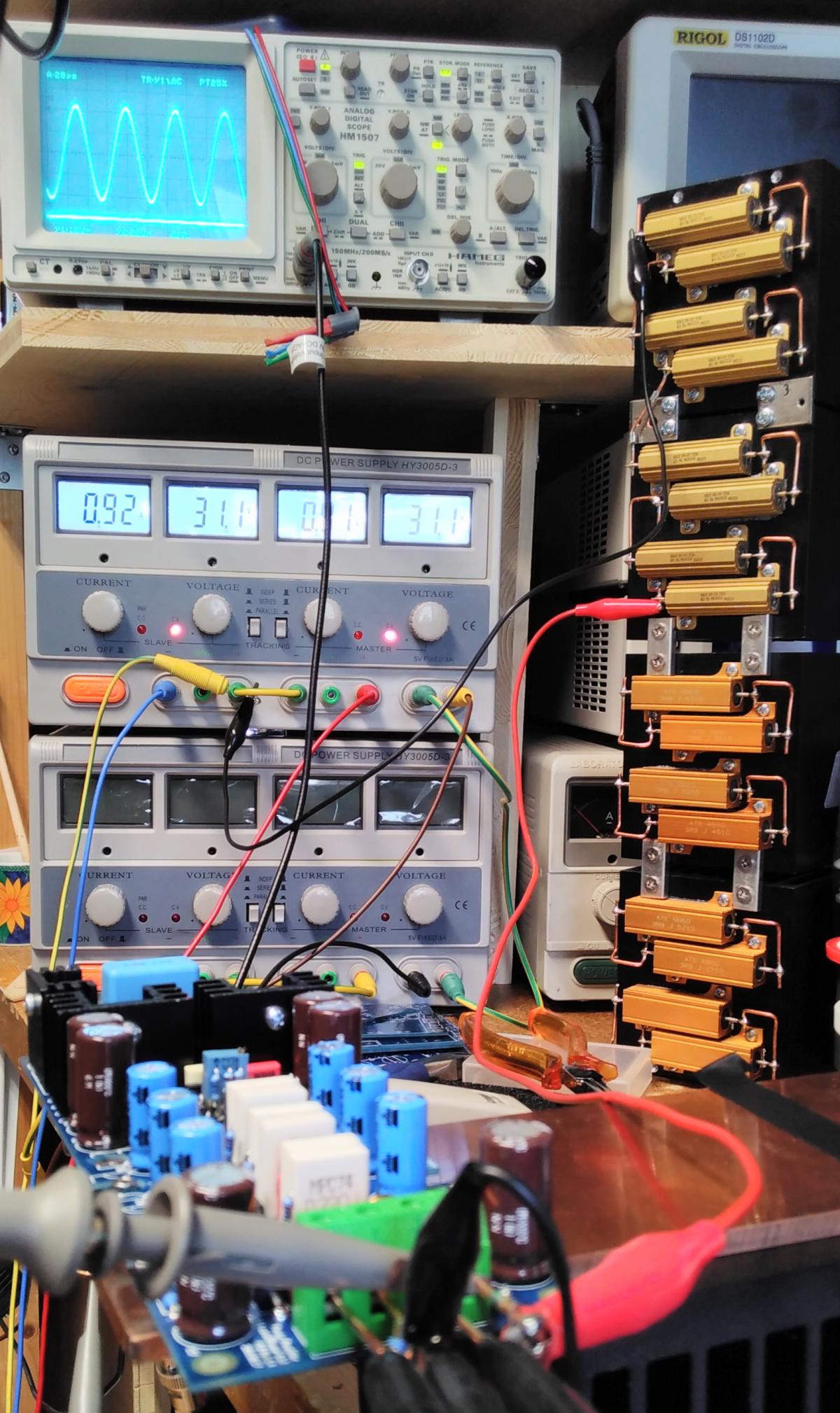

SA2016: using lateral mosfets EXC10N20 EXC10P20
99 % ready for beta testing.
Need only BJT/MOSFET isolation and a final hardware check.
Have fun, Toni

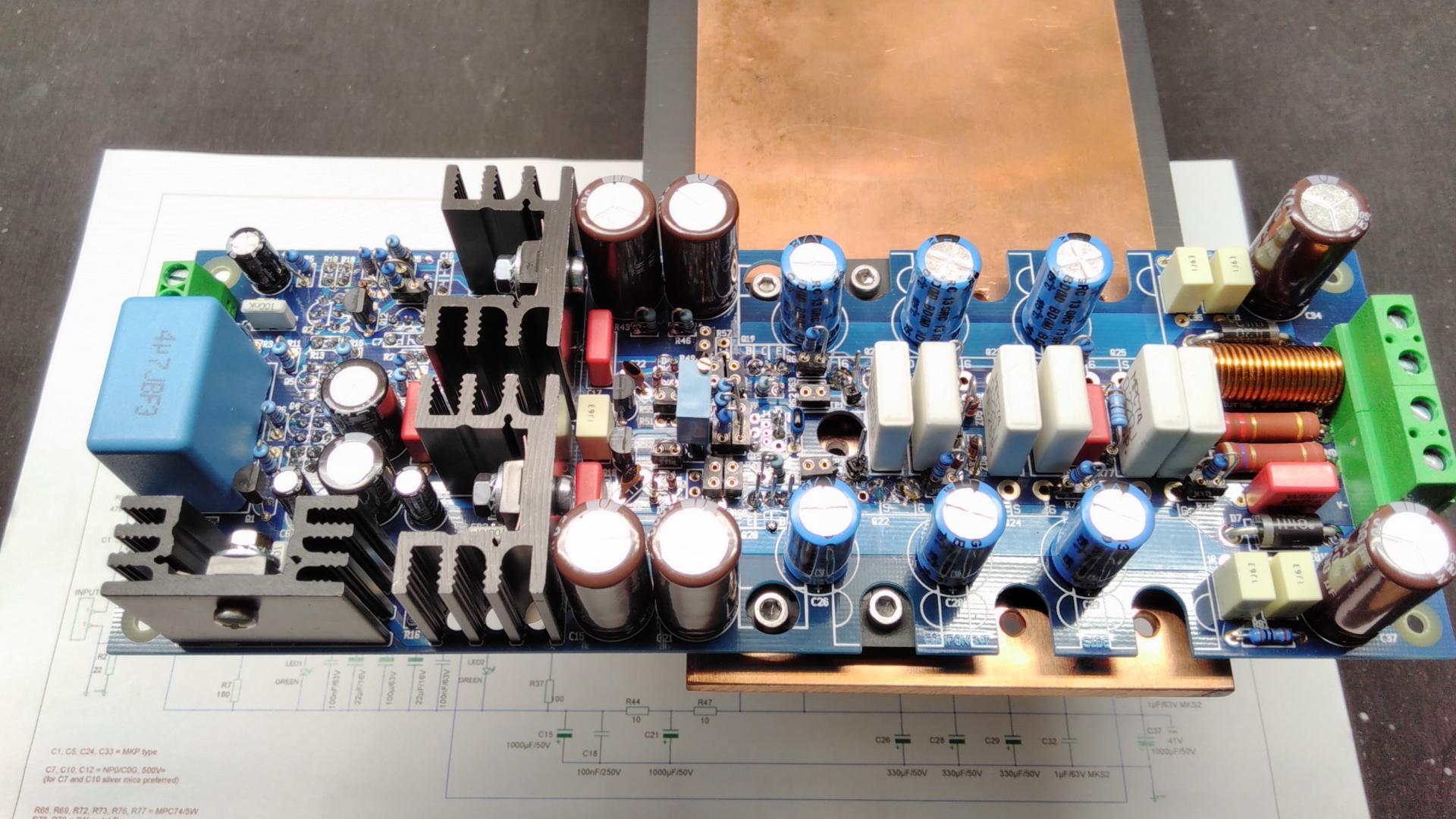

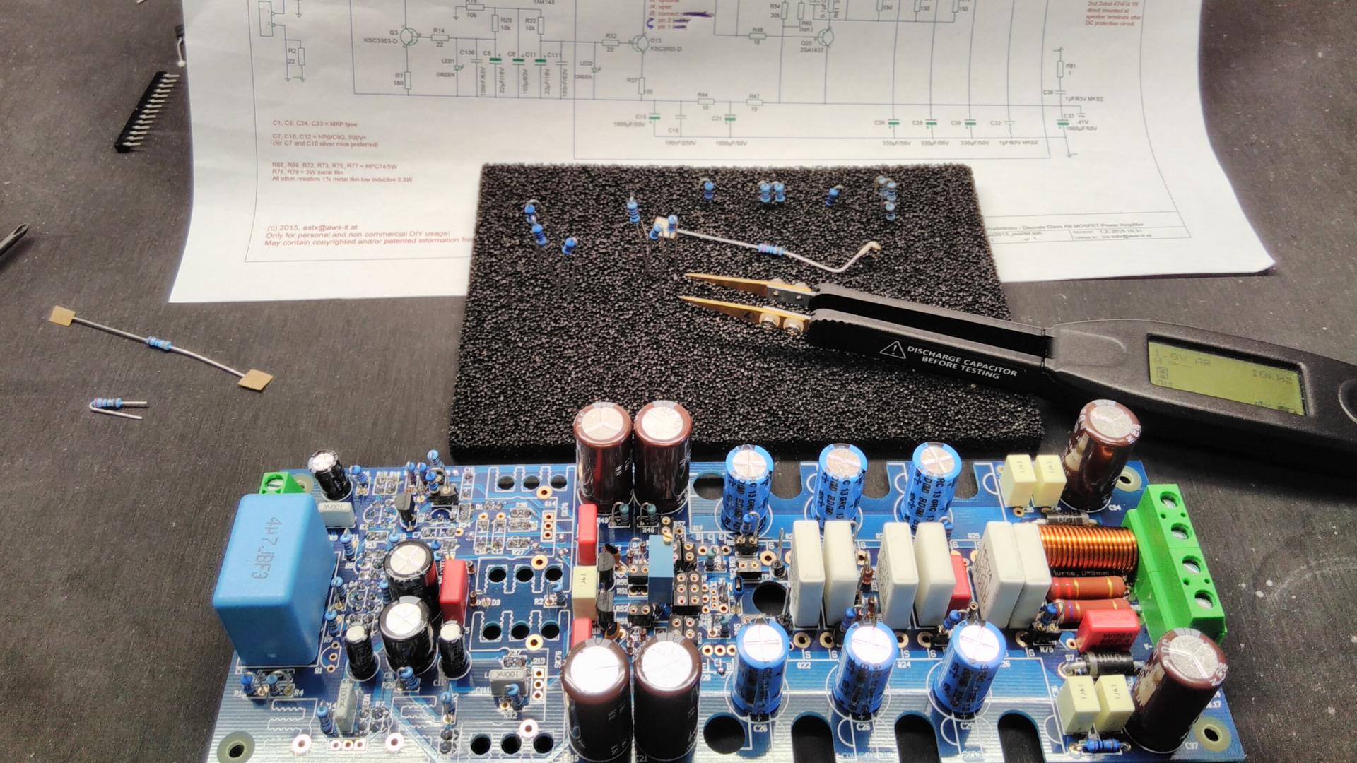

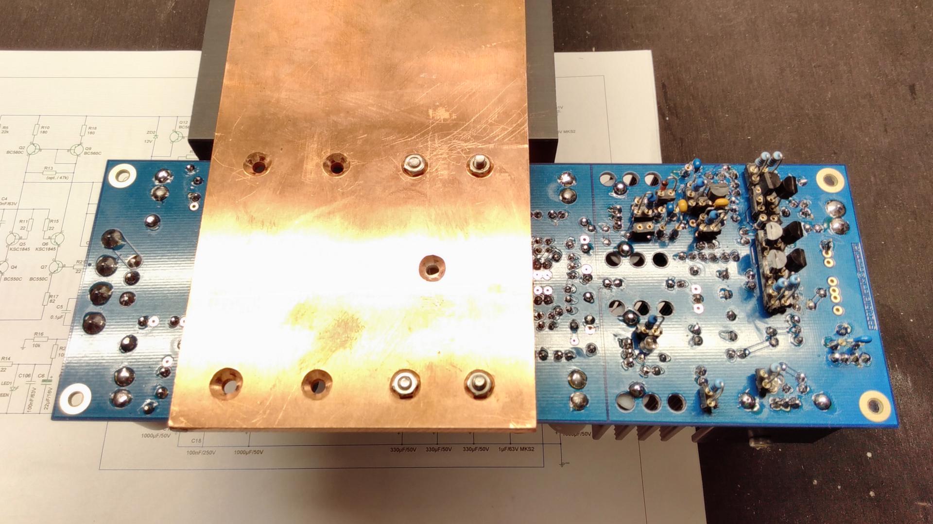

:eek: Found 3 (!) mask errors on PCB (so all prototype pcb's are unusable without some mechanical rework). Each mask error has created a short circuit to ground.:eek:
After removing some copper the amplifier started to work without any problems. :)
First tests with only one pair of EXC10N20/10P20 with 100mA bias running at +/- 30V DC are very promising:
  • 1k@1W@8R THD+N < 0.0025 %
  • 20k@1W@8R THD+N < 0.0035 %
  • 1k@30W@8R THD+N < 0.00095 %
  • 20k@30W@8R THD+N < 0.0045 %
(analyzer bw 80kHz)
Clipping: excellent behaviour as SA2014 and SA2015 V-MOSFET.
Wow!
More data will follow after populating all pairs...
BR, Toni

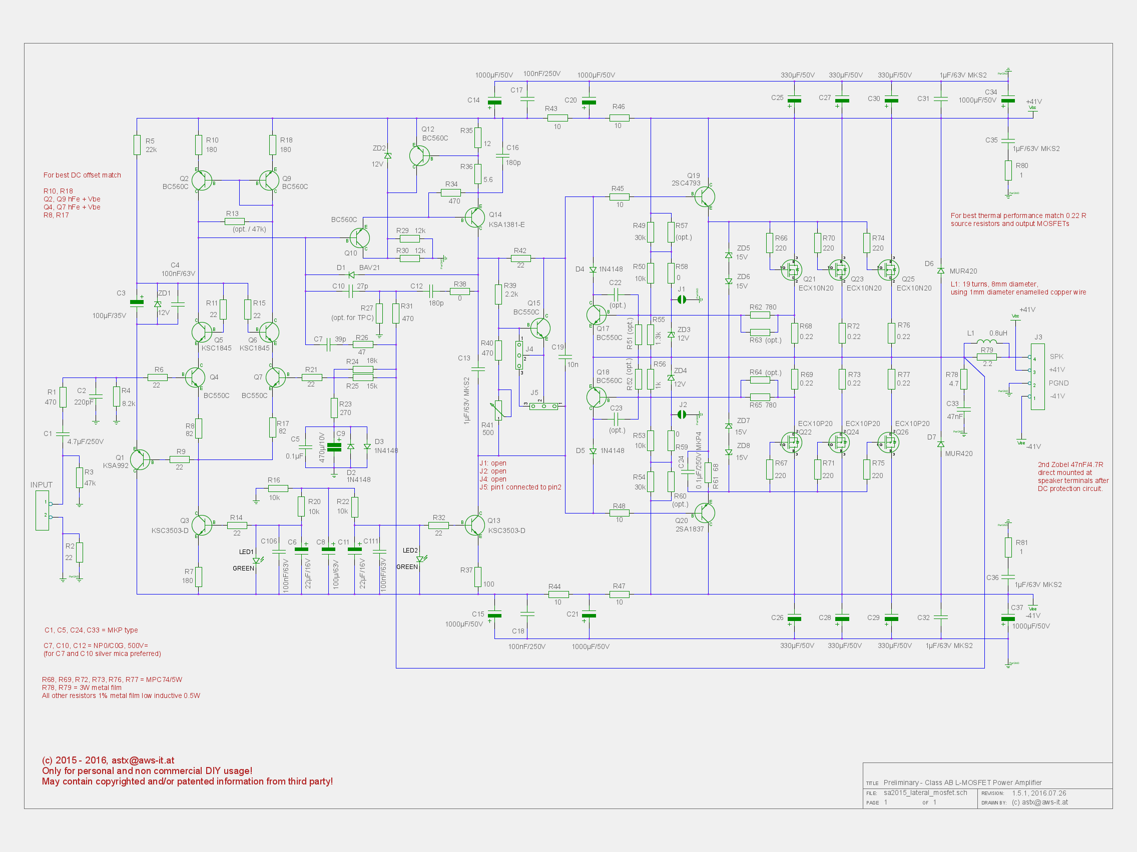

Joined 2011
Schematics - preliminary!
NOTE: Schematics and/or pcb gerber files are free to use only for non commercial DIY projects!
BR, Toni
