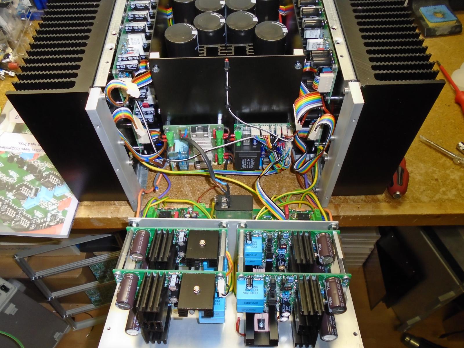

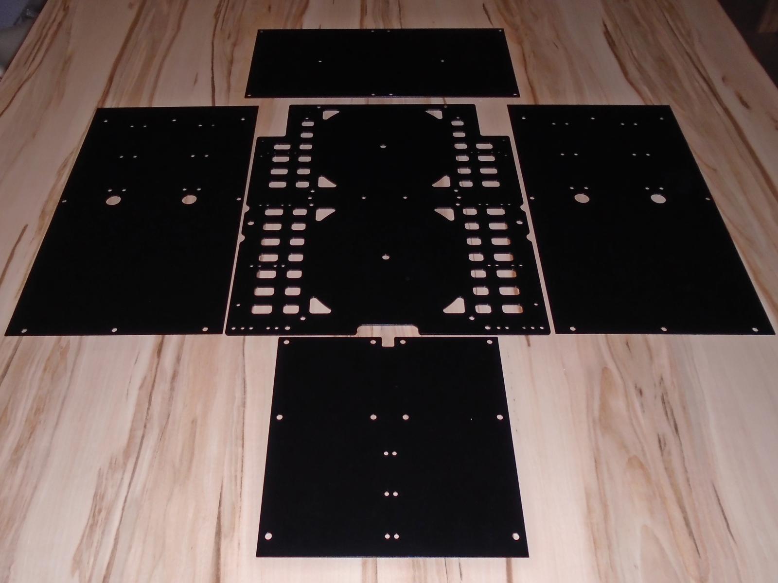

Milling Mu-Metal was a big catastrophe so I decided to go for lasercutted and powder coated steel plates for the powersupply...
... start tuning for lowest SNR with homebrew h-field probe ... need to add some cnc machined mu-metal.
SNR from lab is as low as 125 (A-weighted)
Current SNR is about 110 db (A-weighted)
Picture 3: homebrew h-field probe
Pictures 4 and 5 are showing rectifying spikes. Using the h-field probe it is very easy to find "hum" hotspots. 😉
BR, Toni

The major problem during milling was the cooling of the cutter. I have used automated spray cooling (lubricant: WST20) which seems to be not enough to cool down the cutter. Even manual drilling is difficult - a HSS drill is unusable after some holes.
The soft iron plates weight is of course higher as the aluminium/mu-metal combination. But soft iron is also much cheaper... 😉
BR, Toni

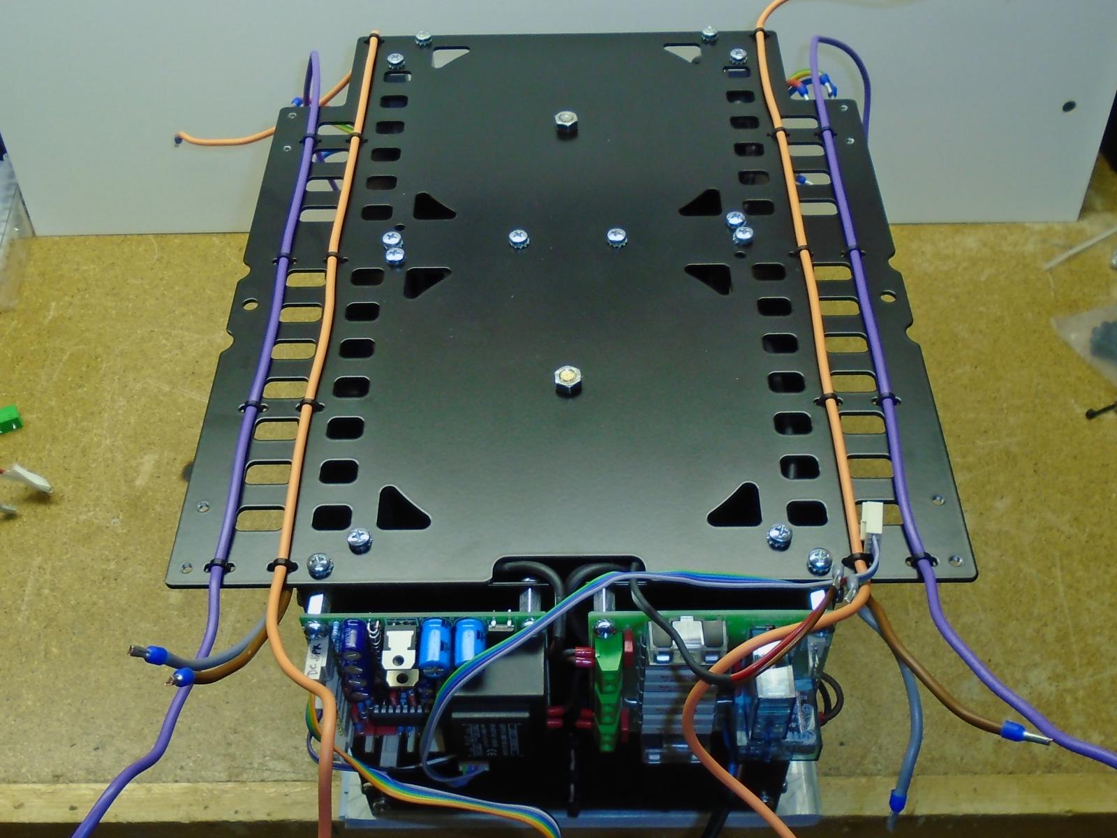

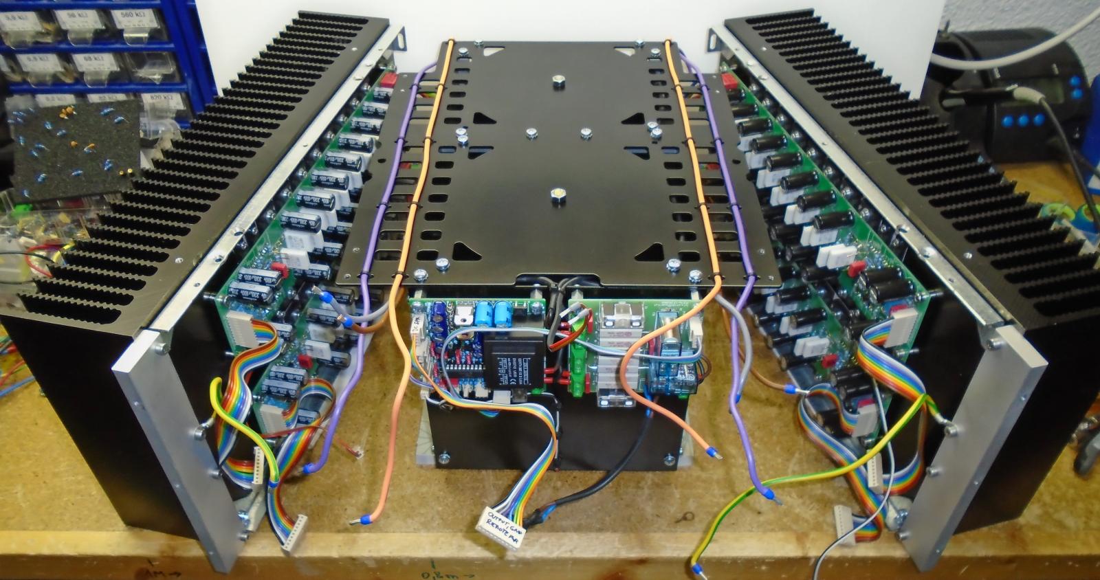

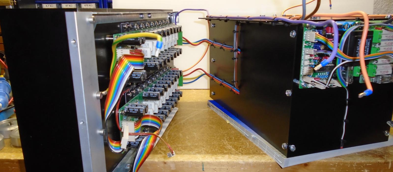

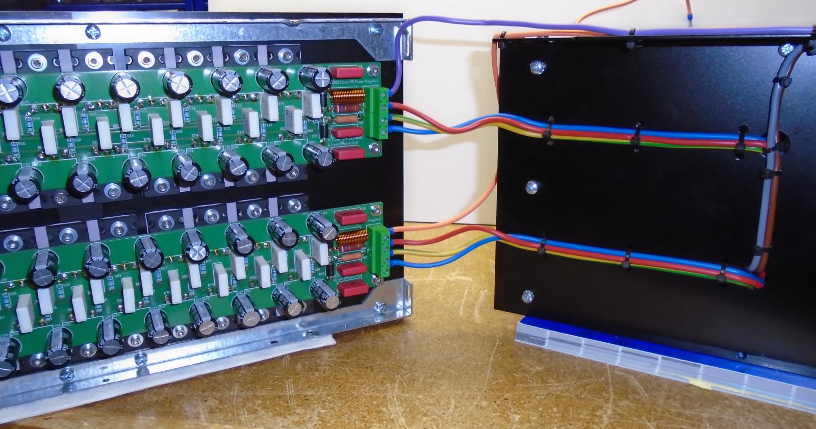

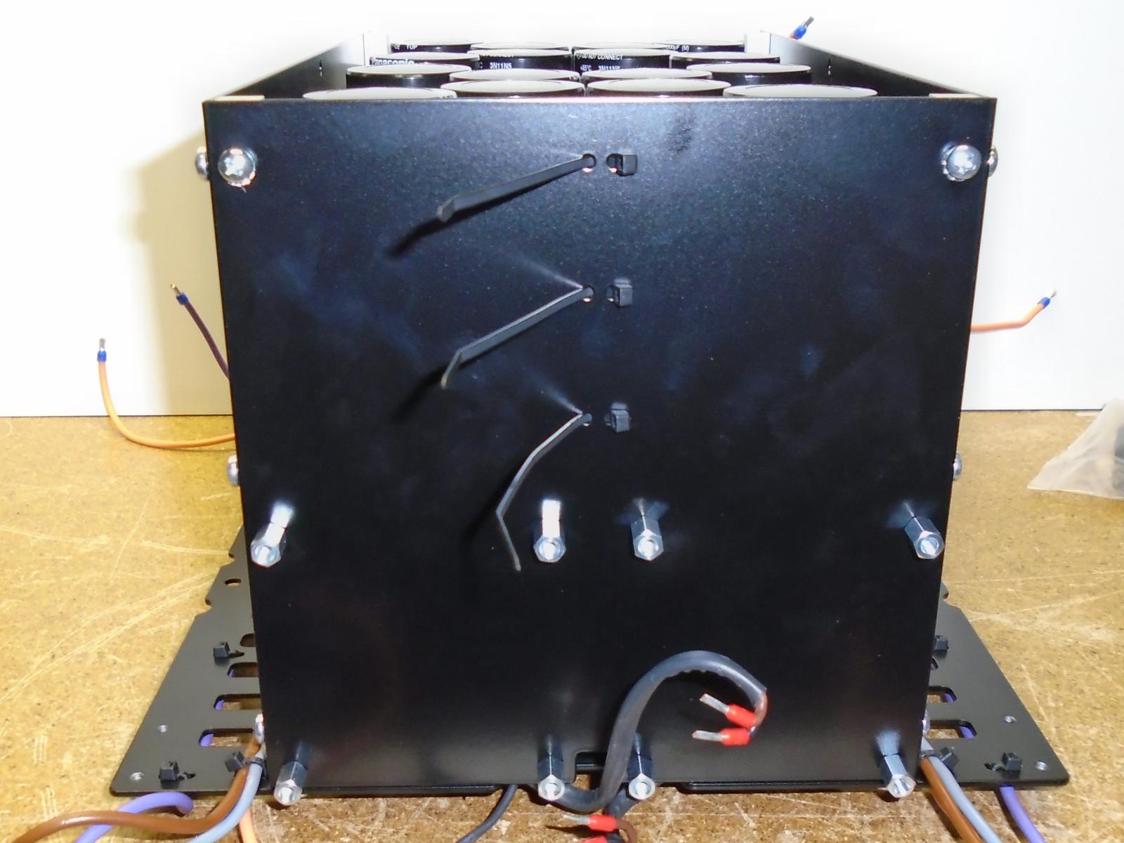

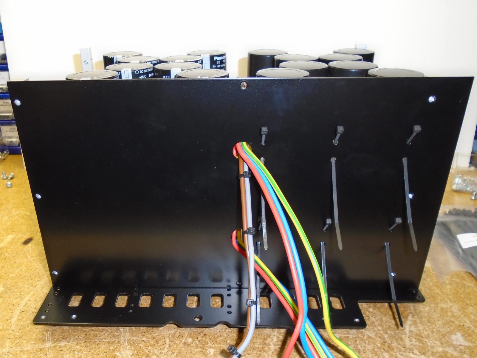

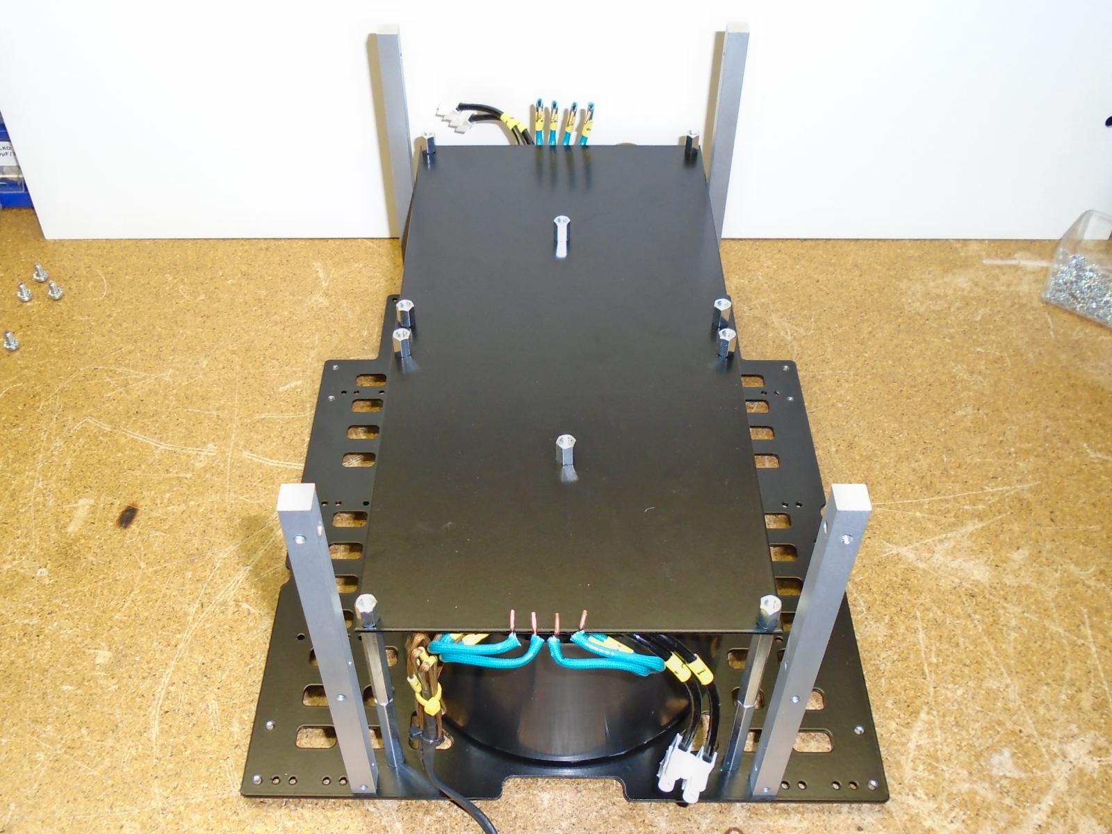

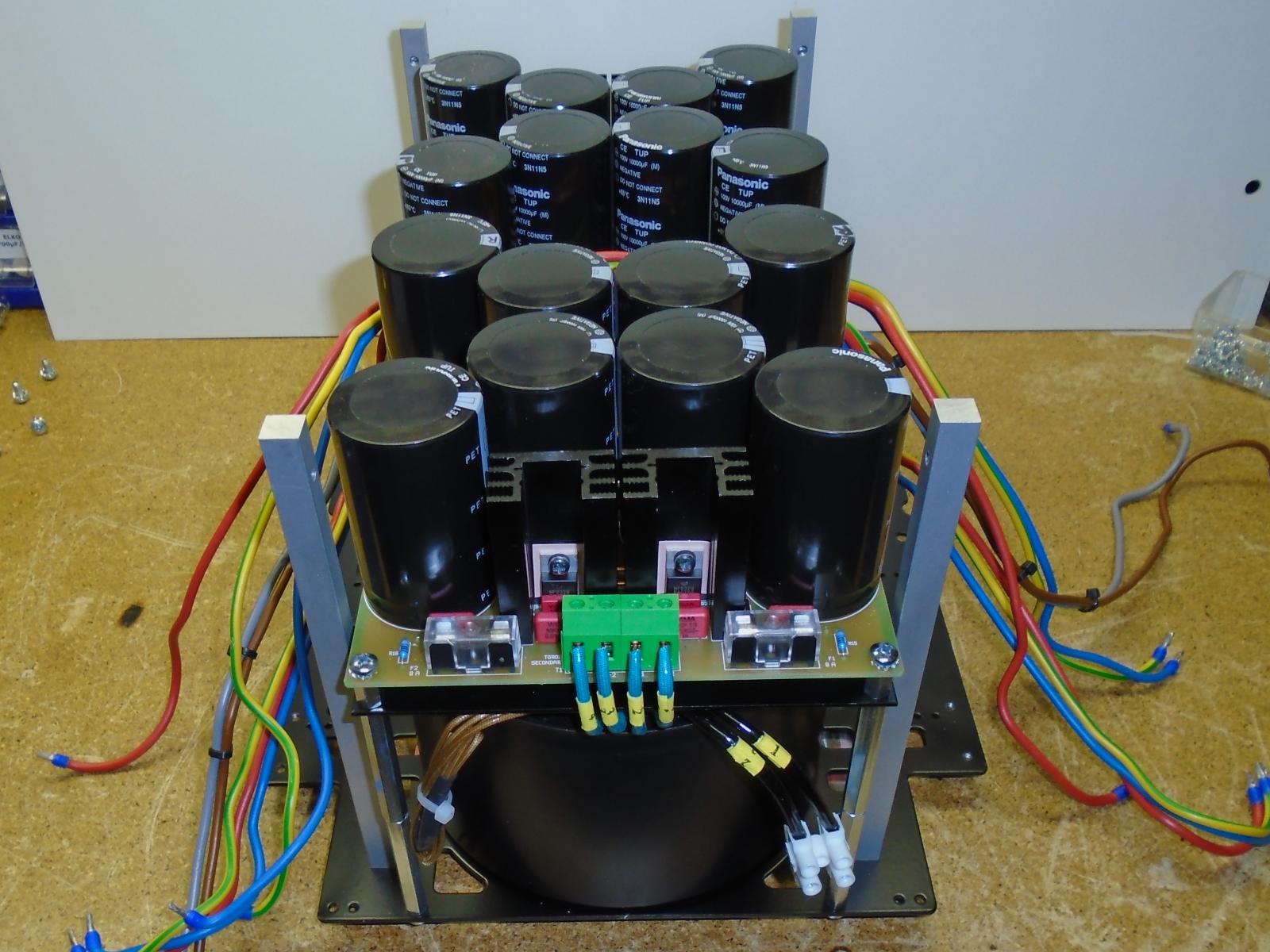

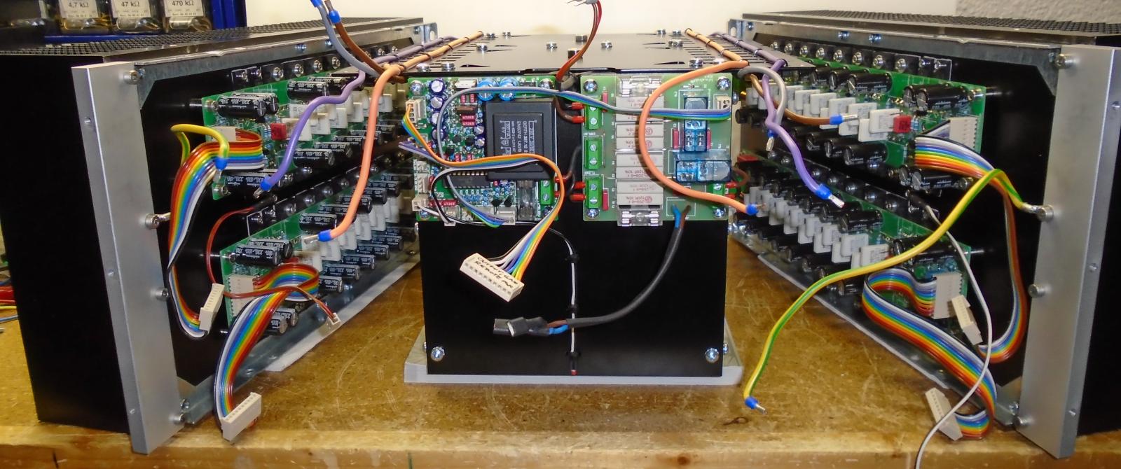

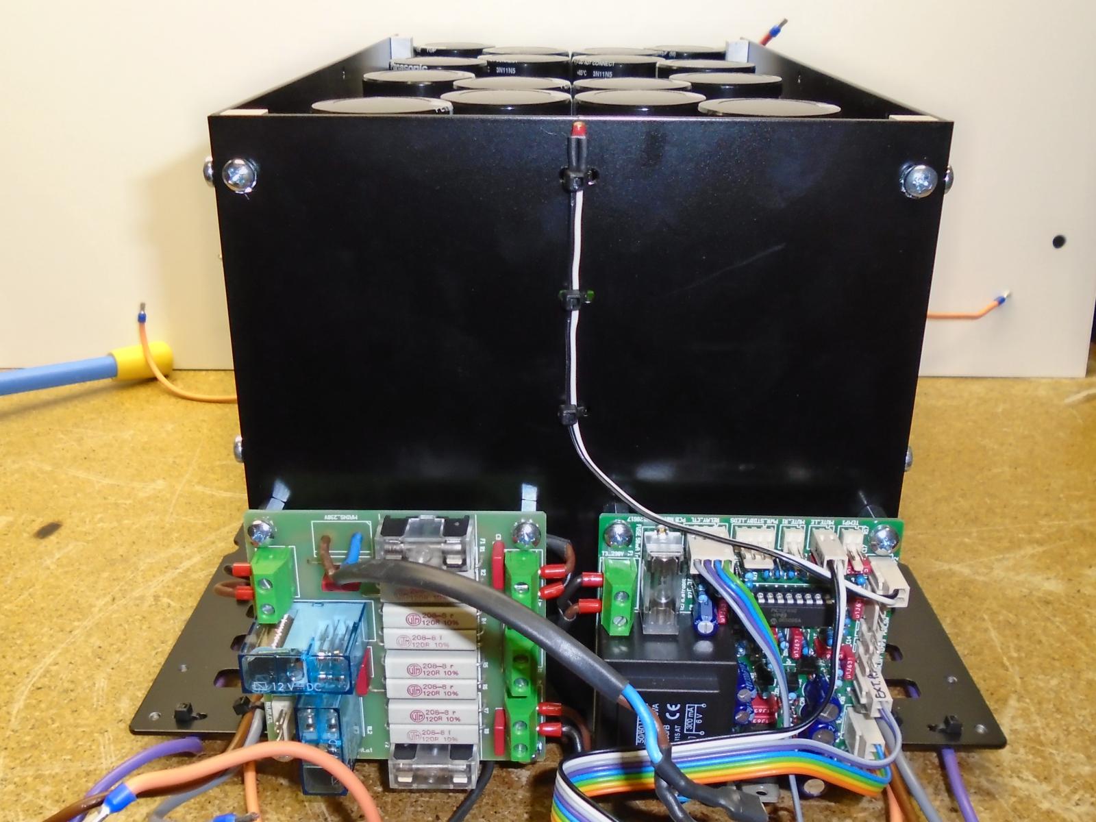

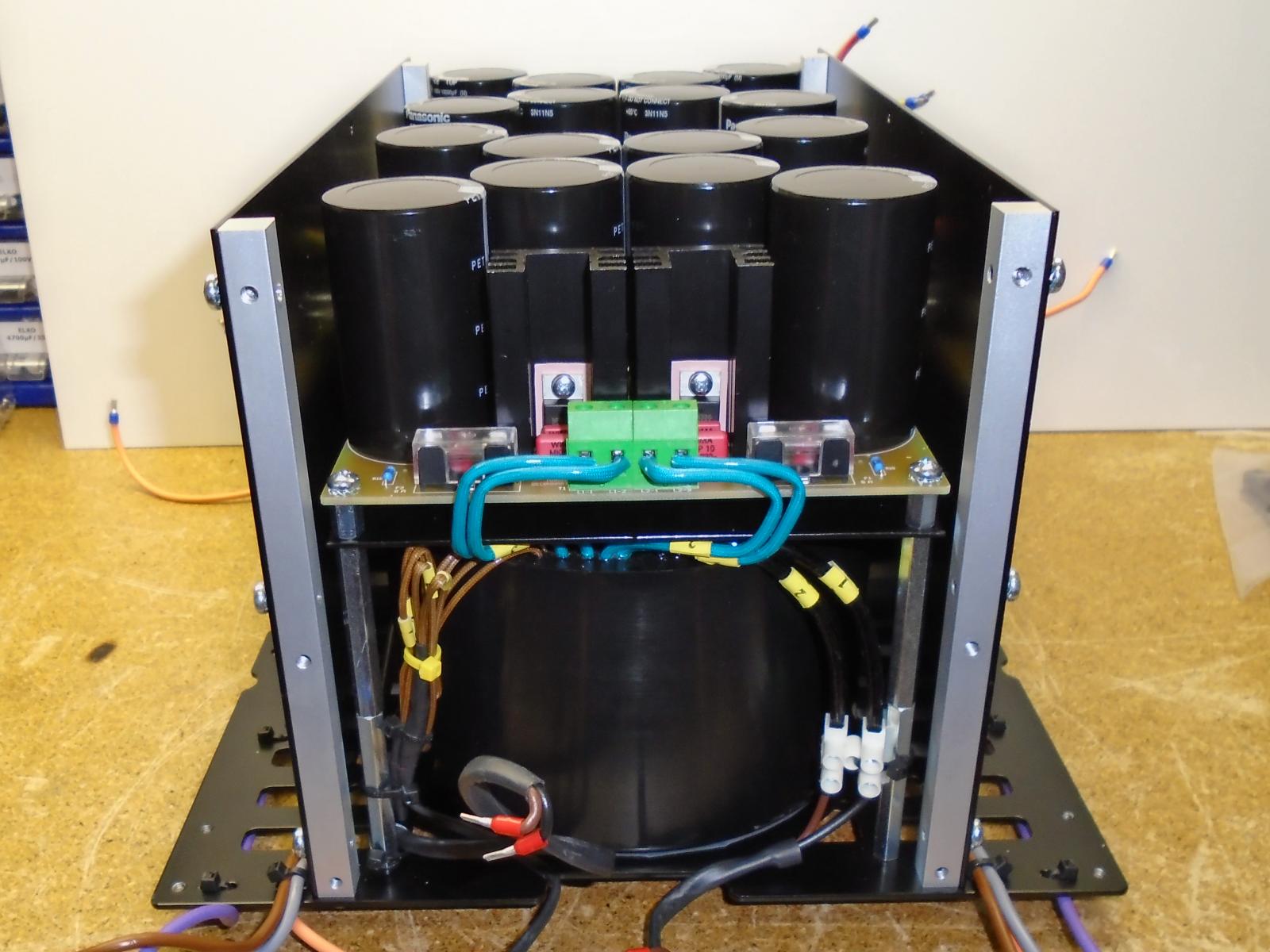

Fighting the hum using soft iron ...
Using soft iron for power supply housing I got it down to
Seems to be my technical limit putting 4 Channels and 2 x 600VA toroids in one case...
THD+N 20Hz - 20kHz 200W@8R below 0.003%
THD+N 20Hz - 20kHz 230W@8R below 1%
THD+N 20Hz - 20kHz 350W@4R below 0.004%
THD+N 20Hz - 20kHz 390W@4R below 1%
(measurement bandwith 80kHz)
Attached some pictures about "making of" the power supply housing
"part 1".
BR, Toni

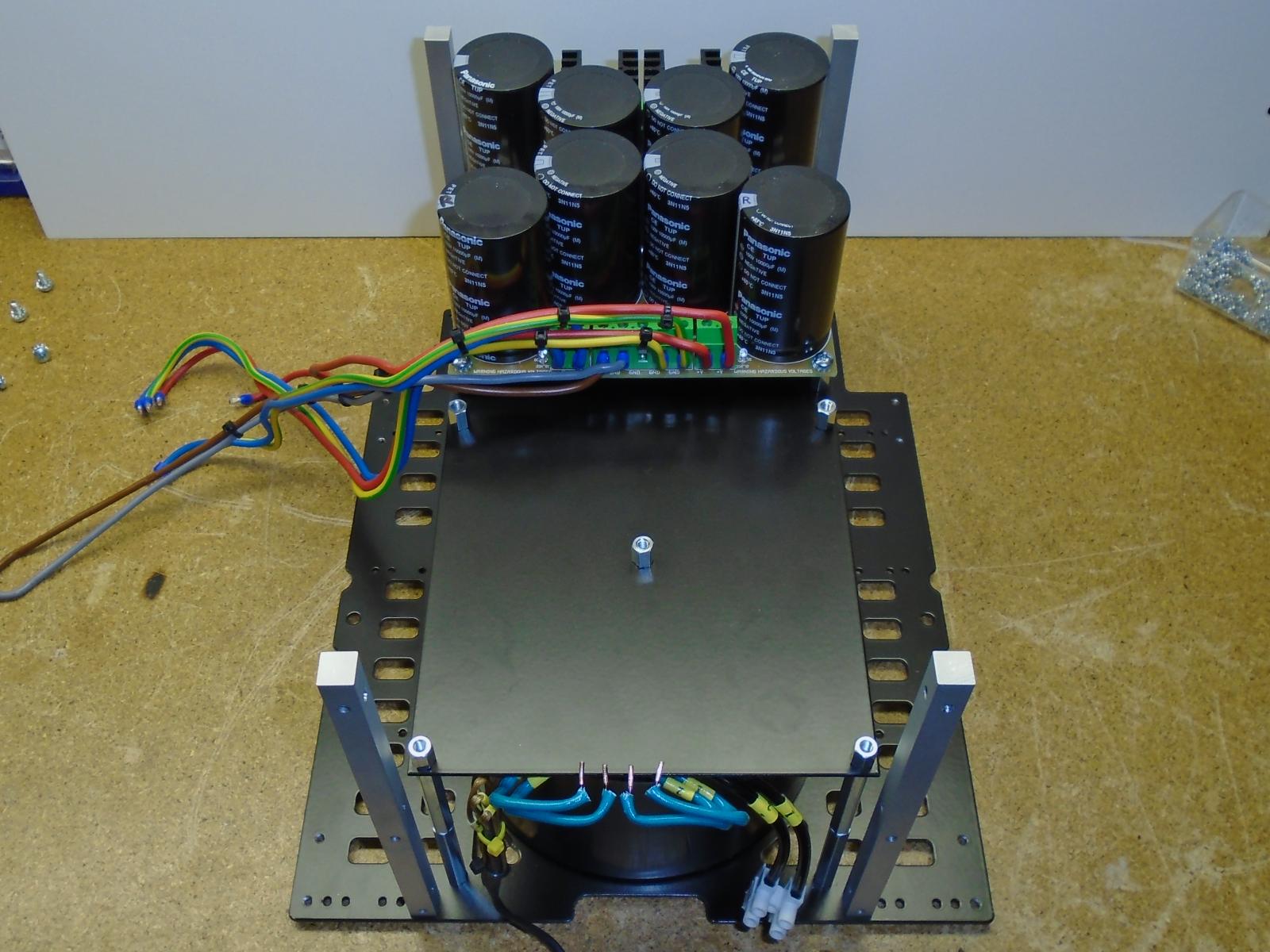

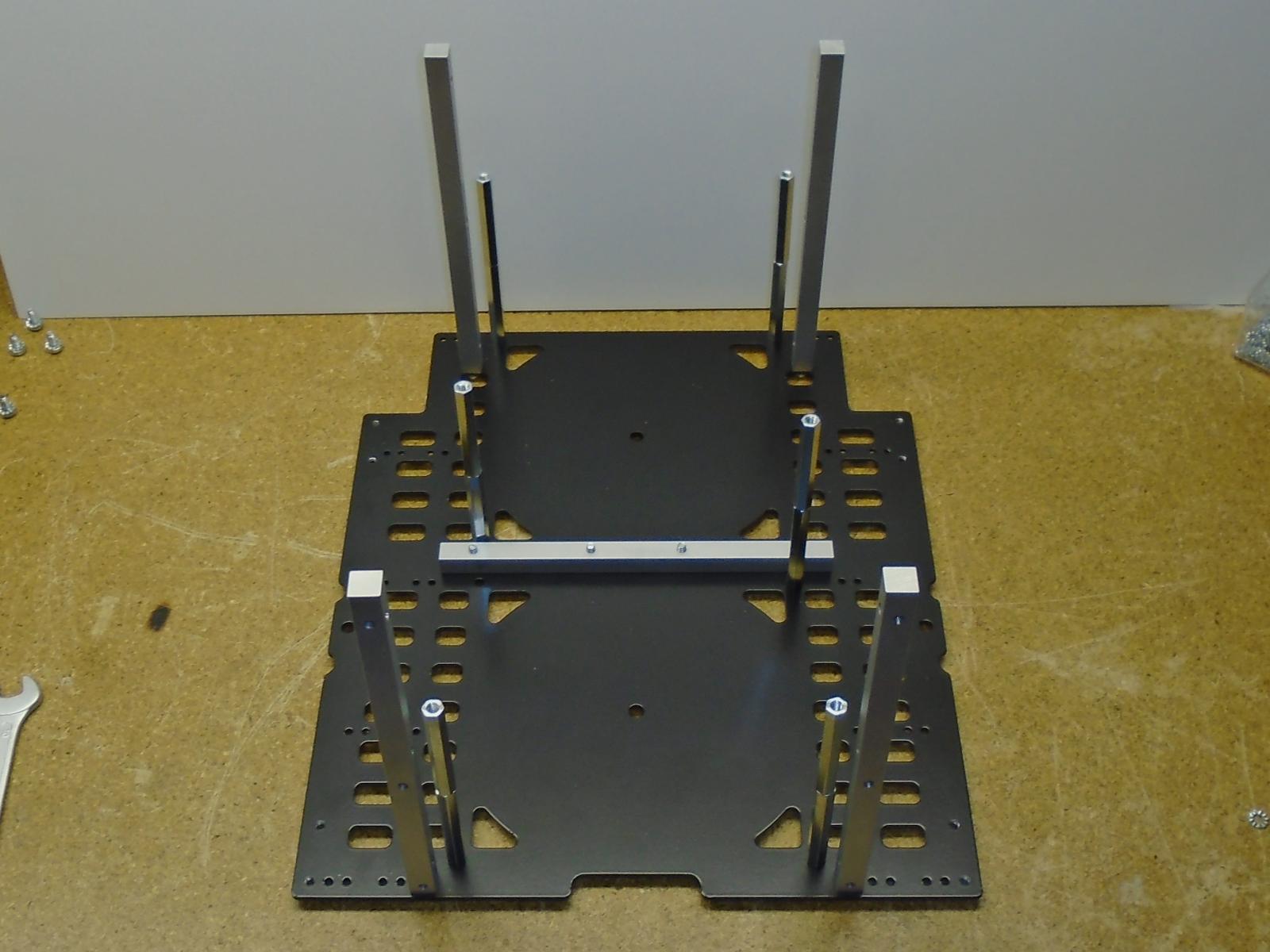

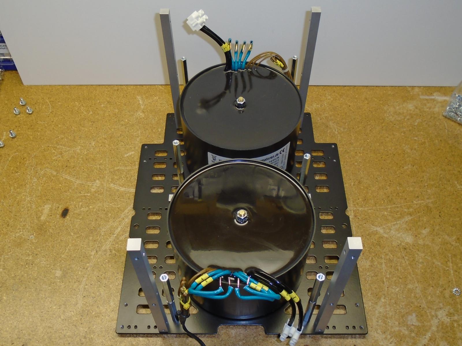

"part 2".
BR, Ton
"part 2".
BR, Ton
Wow. I am amazed by all the metal machining as much as everything else! 😀
I need to read this entire thread again but where do you think you'd get to with two channels now?
Thx for the kind words!
To achive lowest possible SNR to come close to the lab measurements it may be necessary to build 2 separate monoblocks. Currently an optimized wiring is difficult as 2 channels share one power supply.
One of my next Ideas is to build a 3 channel monoblock tower design placed directly at the speakers with included active crossover.
Br, Toni
Br, Toni
