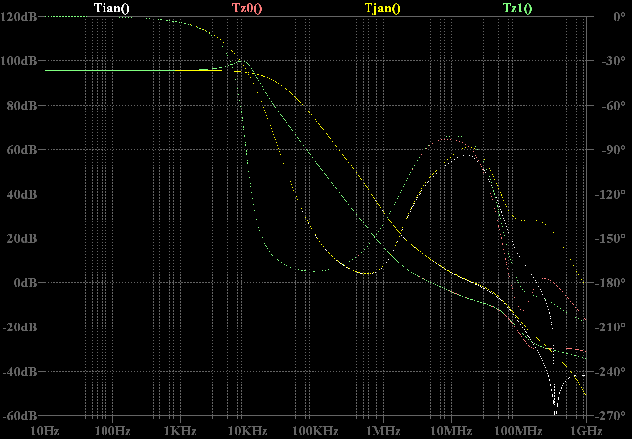

Just to be specific.
Here are the inner and outer loop gains for my complementary IPS amplifier (still private, sorry).
Red and white are before a 6nF capacitor is added to the LTP input.
Yellow and Green are after, obviously.
Improvement in phase, not sure if that is entirely explained by the small increase in gain way up in frequency.

Adding to my last post, if at the frequency in question the differential LTP impedance is capacitive, and the source impedance is resistive, then your effective LTP transconductance will be inductive. If the situation is reversed, the LTP transconductance will be capacitive. These change the phase of the loop gain.
Note that the source impedance includes everything at the input node, not just the input resistor. So for instance if the transistor's Cbc is 22pF and the input resistor is 33k, at RF (above the corner frequency) it will be capacitive, and since the LTP differential impedance at RF is capacitive as well, there will be a reduction in transconductance but no change in phase.
How your feedback loop responds to the source impedance depends on the phase of the currents through the LTP, as these will be reflected in the differential impedance through Hfe.

Thank you. The trade-off is a ULGF of 5 MHz on the outer loop.
I believe this is feasible with the PCB layout I have.
Modern motherboards do 1000 MHz so I have learned a few tricks, the build will tell.
The gain for the development model is about 50 = 34 dB
This is to allow for the 600 W bass amp to be driven to full power by 1 V, approximately.
But the loop gain plot is actually from the 100 W amp, I need to fine tune this stuff.

4 8.000e+04 4.552e-05 5.451e-07 136.73° 138.30°
5 1.000e+05 1.868e-04 2.237e-06 -43.25° -41.68°
6 1.200e+05 6.435e-05 7.705e-07 122.81° 124.38°
7 1.400e+05 2.162e-04 2.588e-06 54.93° 56.51°
8 1.600e+05 8.265e-05 9.896e-07 144.93° 146.51°
9 1.800e+05 1.385e-04 1.658e-06 41.44° 43.01°
Total Harmonic Distortion: 0.000848%
1st THD # is with AFEC at 440W RMS into 8 Ohms at 20 kHz
2nd THD # is with AFEC switched out - same drive and load conditions.
#'s below are for 3 Ohm load with AFEC
Harmonic Frequency Fourier Normalized Phase Normalized
Number [Hz] Component Component [degree] Phase [deg]
1 2.000e+04 8.358e+01 1.000e+00 -1.60° 0.00°
2 4.000e+04 1.030e-04 1.233e-06 -22.46° -20.86°
3 6.000e+04 7.212e-05 8.629e-07 131.00° 132.60°
4 8.000e+04 7.690e-06 9.200e-08 165.83° 167.43°
5 1.000e+05 6.498e-05 7.775e-07 29.77° 31.37°
6 1.200e+05 1.502e-05 1.797e-07 155.55° 157.15°
7 1.400e+05 6.988e-05 8.361e-07 82.63° 84.23°
8 1.600e+05 2.143e-05 2.564e-07 152.24° 153.84°
9 1.800e+05 1.074e-04 1.284e-06 60.25° 61.85°
Total Harmonic Distortion: 0.000231%
#'s below are for non-AFEC
.step rafec=1e+012
N-Period=1
Fourier components of V(vout)
DC component:-0.512149
1 2.000e+04 8.352e+01 1.000e+00 -1.57° 0.00°
2 4.000e+04 9.718e-05 1.164e-06 22.24° 23.81°
3 6.000e+04 6.256e-04 7.491e-06 60.10° 61.67°
4 8.000e+04 5.472e-05 6.552e-07 112.64° 114.21°
5 1.000e+05 3.753e-04 4.493e-06 -45.88° -44.31°
6 1.200e+05 6.942e-05 8.312e-07 68.89° 70.46°
7 1.400e+05 3.048e-04 3.650e-06 6.24° 7.81°
8 1.600e+05 6.467e-05 7.743e-07 85.55° 87.12°
9 1.800e+05 3.739e-04 4.477e-06 -12.22° -10.65°
Total Harmonic Distortion: 0.001062%
The distortion at 225 W 20 kHz 8 Ohms is 1.27ppm with AFEC
