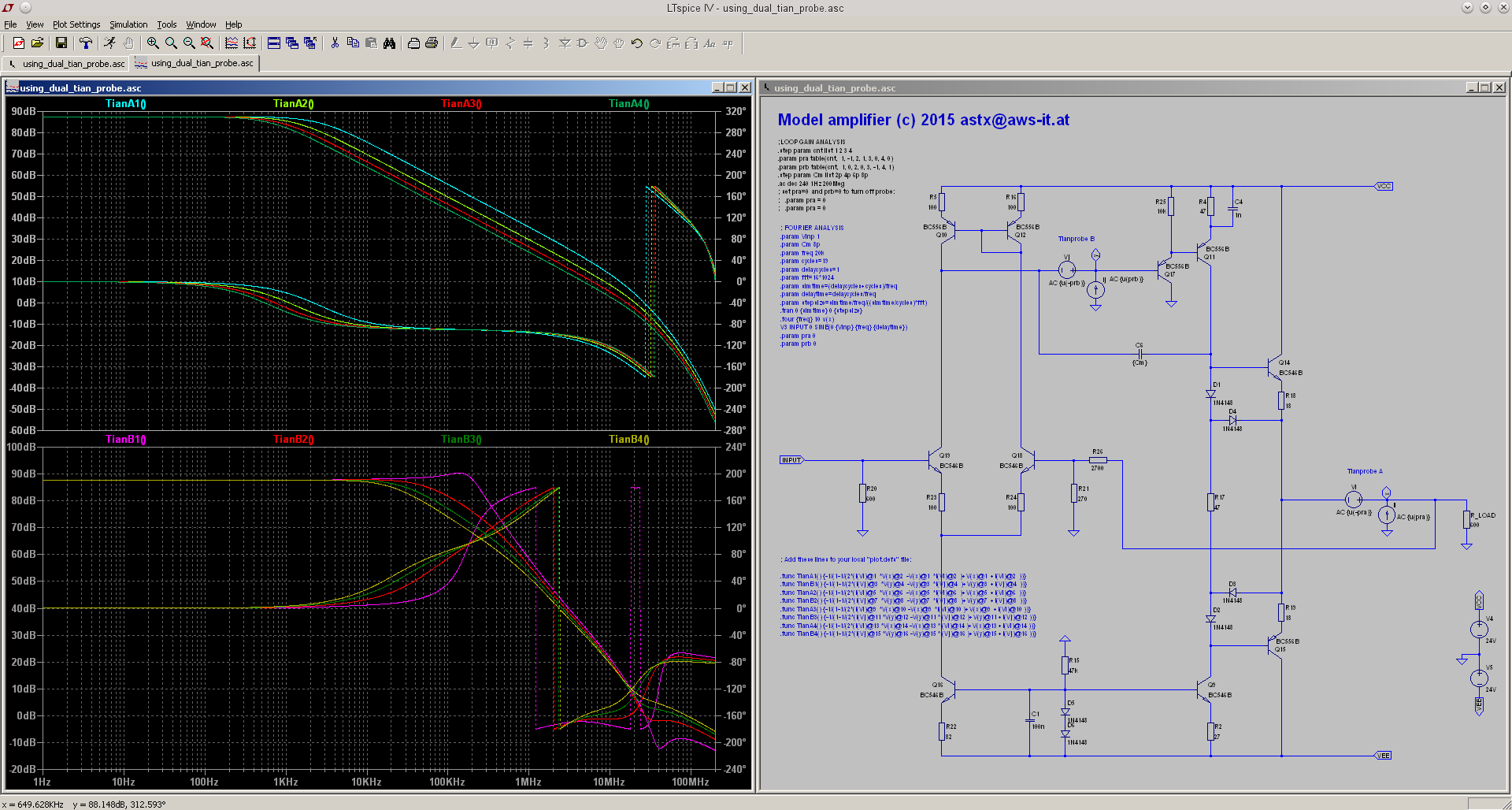

Playing with LTSpice: Dual Tian probe and parameter stepping
To get rid of manually running multiple tian probe steppings I have had success using the "table" parameter.
There are two Tian probes:
Maybe someone needs this too to speed up development ... 😉
Thanks goes to Dave Zan showing me the dual Tian ...
BR, Toni

...the "table" parameter...There are two Tian probes:
Hi Toni.
I am happy to see you like the dual Tian probe.
Your implementation is a little different, my version is very simple but your version may be easier to enhance for a Middlebrook GFT probe.
Could you post the ASC so I can see the details? The part on the screen shot is not quite what I expect.
Best wishes
DAvid
David, I'd very much like to try your dual Tian probe too.I am happy to see you like the dual Tian probe.
Have you got a simple working example you could post?
And of course, I'd like to see Toni's version too. 🙂
David, I'd very much like to try your dual Tian probe too...
Happy to help.
Link >Here< to post of Paul's that has a copy of both my balun and the dual Tian probe.
It shows pretty well how to use them both.
Some of the details are hidden in the V sources to de-clutter the circuit, "encapsulation" in software nomenclature.
Best wishes
David
Attached a simplified "table" Version.
BR, Toni
BR, Toni

I’m not sure that the Tian B probe is showing anything useful in this simplified example.
Me too. 😉 Maybe Guru Zan can explain, if the 2nd Tian probe is correctly placed and/or makes any sense...I’m not sure that the Tian B probe is showing anything useful in this simplified example.
I only want to show how it could be possible in LTSpice to add 2 (or even more) Tian probes to a circuit and be able to do a parameter stepping.
BR, Toni
I’m not sure that the Tian B probe is ... useful in this simplified example.
Hi Harry, Toni
Sorry to be a bit slow to reply, been at the beach.
Like Toni, I took it mainly as demonstration of the probe implementation.
But is of interest.
The probe position does correctly look at the inner loop.
If a nested loop has no feed-forward (and this is very close) then instability will be shown correctly in either the inner or outer loop, so can be checked in either.
It may be useful to check the inner loop for non ideal behaviour that would deteriorate stability.
For instance where is the zero around 30 to 40 MHz from?
But I think the inner loop is more important to study when there is additional complexity, like HEC or even TMC.
Then there is more potential for feed-forward and non-ideal behaviour.
So the main use of the simplified example is to provide a base-line for comparison.
And on that subject, notice the phase behaviour?
Phase leads as the gain drops.
Hmm?
Best wishes
David
Hmm?
Best wishes
David
Hi David,
I am not sure you've missed it or just ignored it, but I would like to have your opinion about what I said here http://www.diyaudio.com/forums/solid-state/243481-200w-mosfet-cfa-amp-70.html#post4230628
Best wishes
Damir
Yes, the position of the probe is correct, but it does not give the loop gain of the inner loop, if the outer loop is active. How can a feedback loop with a capacitor (of order pF) as the feedback element have almost 90 dB of gain at 1 Hz?
To observe the inner loop loop gain, you need to disable the global loop at AC (global loop DC feedback still required in order to bias the amplifier properly). This can be done by shorting the +ve and -ve inputs to ground via 1 kF capacitors. I’ve modified the .asc to do this when the TianB is active (see attached). Now, we get more realistic looking curves for the loop gain of the inner feedback loop.
Enjoy,
Harry.
I should have said before - thanks to astx for bringing the “table” keyword/syntax to my attention - this looks like it could be very handy!
