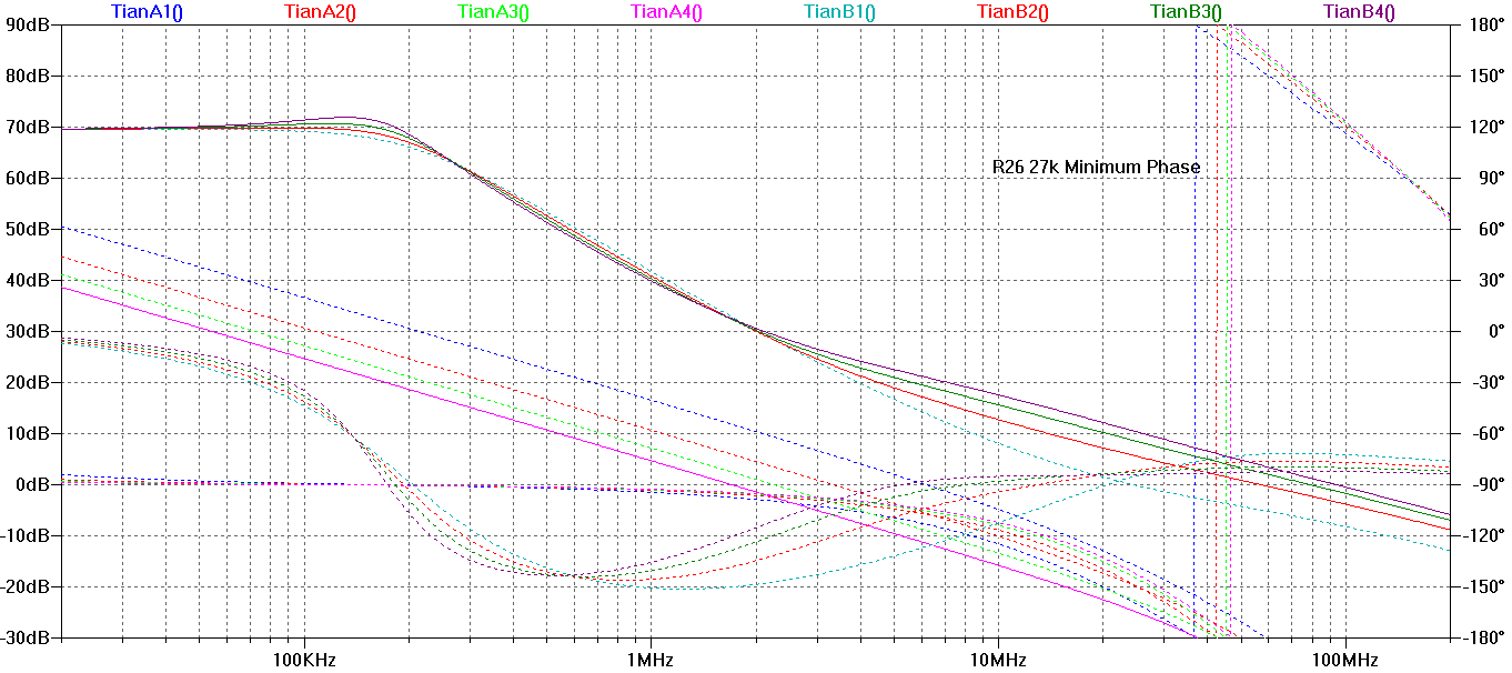

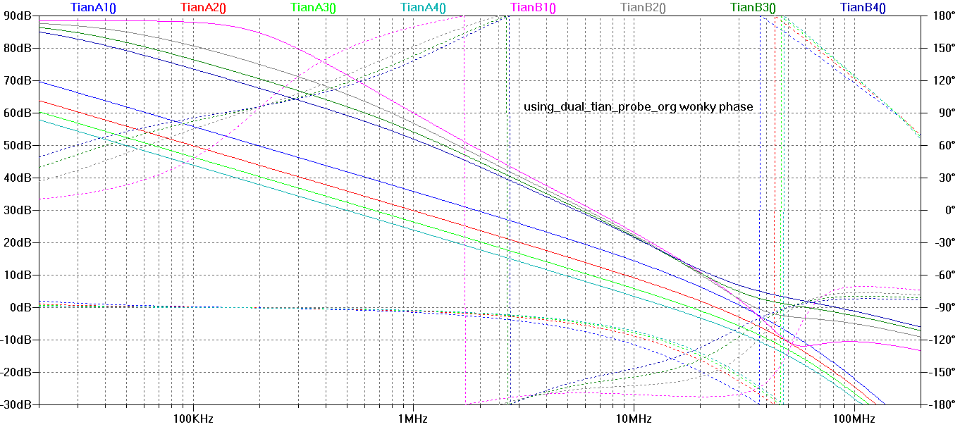

could one of you please explain how to "read" the gain and phase plots in post1240.
I think I understand the upper set.
Green goes too steep as it crosses the 0dB and this shows as phase margin approaching 0degrees @ ~ 2MHz. Whereas the lower curves are less steep at 0dB (in the range 2MHz to 3MHz) and it looks like phase margin ~80degrees at 2.5Mhz, if we choose the correct colour of curve.
Is my interpretation correct?
Can it be restated, to be clearer to others?
But the lower one is quite different. What do the curves mean?
Yes, that is correct. Assuming the gain only crosses 0 dB once, the phase must be greater than -180 before the crossing point, otherwise the amplifier will be unstable.
If the amplifier is stable, it has:
- “gain margin”, which is -1*(the loop-gain gain in dB at the point where the phase is -180), and
- “phase margin” which is = (the loop-gain phase at the point where the gain is 0 dB) + 180.
In general, people get nervous if the gain margin is less than 6 dB and/or phase margin is less than 45 degrees.
The lower one is a loop gain plot of the “inner” loop, which is the negative feedback loop consisting of Q17, Q11, C8. You can “read” it the same as any other loop-gain plot to assess stability of the loop, it just looks a bit unusual because the feedback element is a capacitor (=open circuit at DC), so there is no loop gain at DC.
Non-Minimum Phase unicorn captured
The first pic is Toni's demo circuit. The 'inner Return Ratio' shows NMP behaviour with phase rising as amplitude drops.
2nd pic shows .. if the feedback resistor R26 is made 27k, the path around the 'main loop' is now less than path via Cm and the behaviour is nicely Minimum Phase.
R26 =8k2 is interesting as the variation of Cm straddles the point where this changeover occurs.
No idea if this changeover has any significance in amp design/performance. The 'main loop' doesn't seem to show any strange behaviour as you cross this point. More work indicated.
But this may be the explanation for the various NMP unicorn sightings 😀

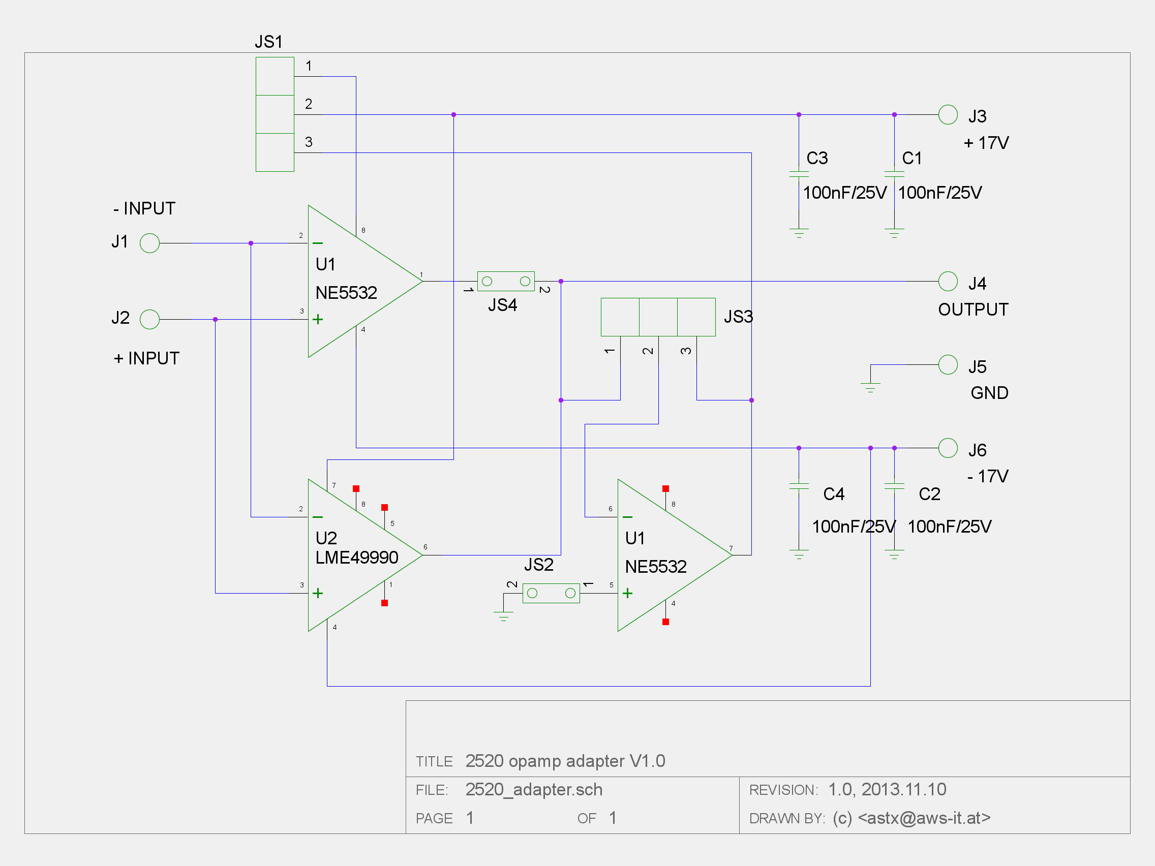

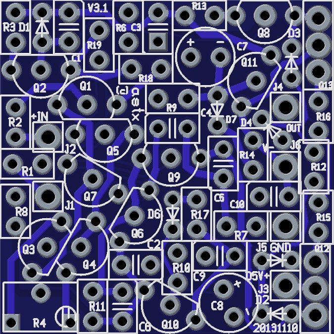

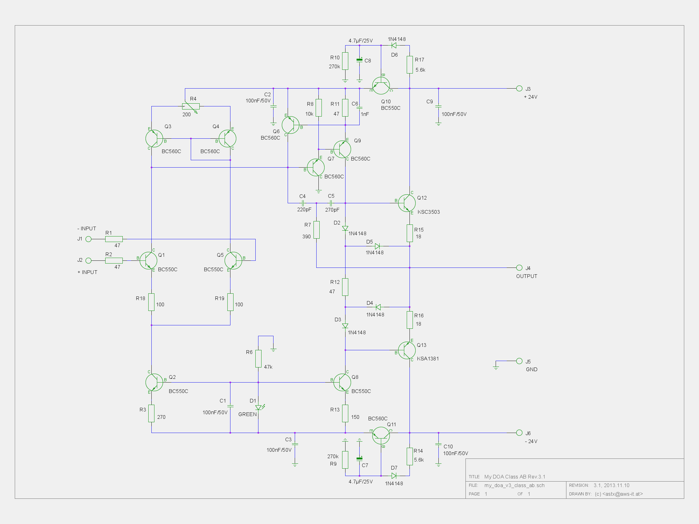

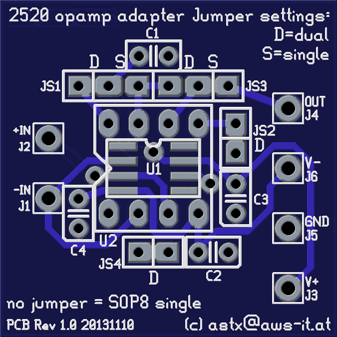

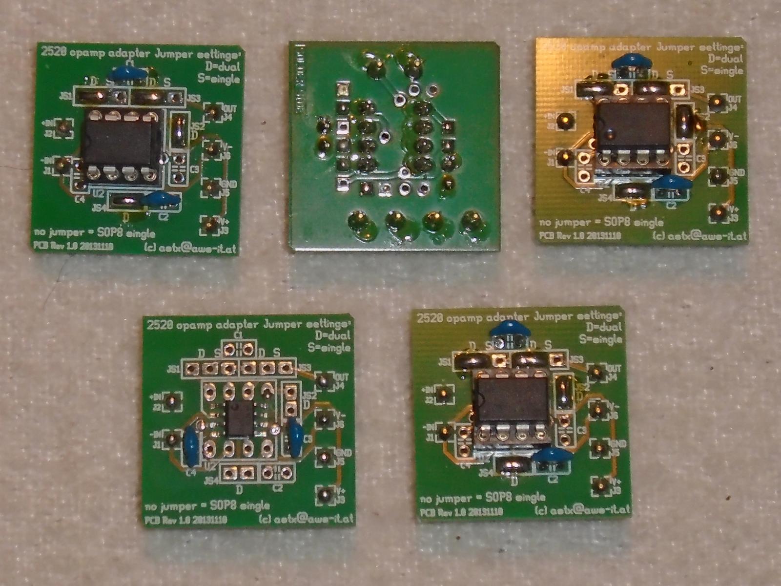

Gerber files ffor your MyDOA-V3.1 PCB's
Can you post the gerber files for your two test MyDOA-V3.1 PCB's? I would like to have some made up for my use. Take care.🙂
today the final MyDOA-V3.1 pcb's arrived.
I have designed and ordered some 2520 adapter pcb's to be easily able to compare MyDOA with standard opamps.
BR, Toni
MyDOA v3.1 final
Attached MyDOA v3.1 schematic and gerber files.
NOTE: Only for private and non commercial usage!
Have fun!
BR, Toni
Have fun!
BR, Toni
