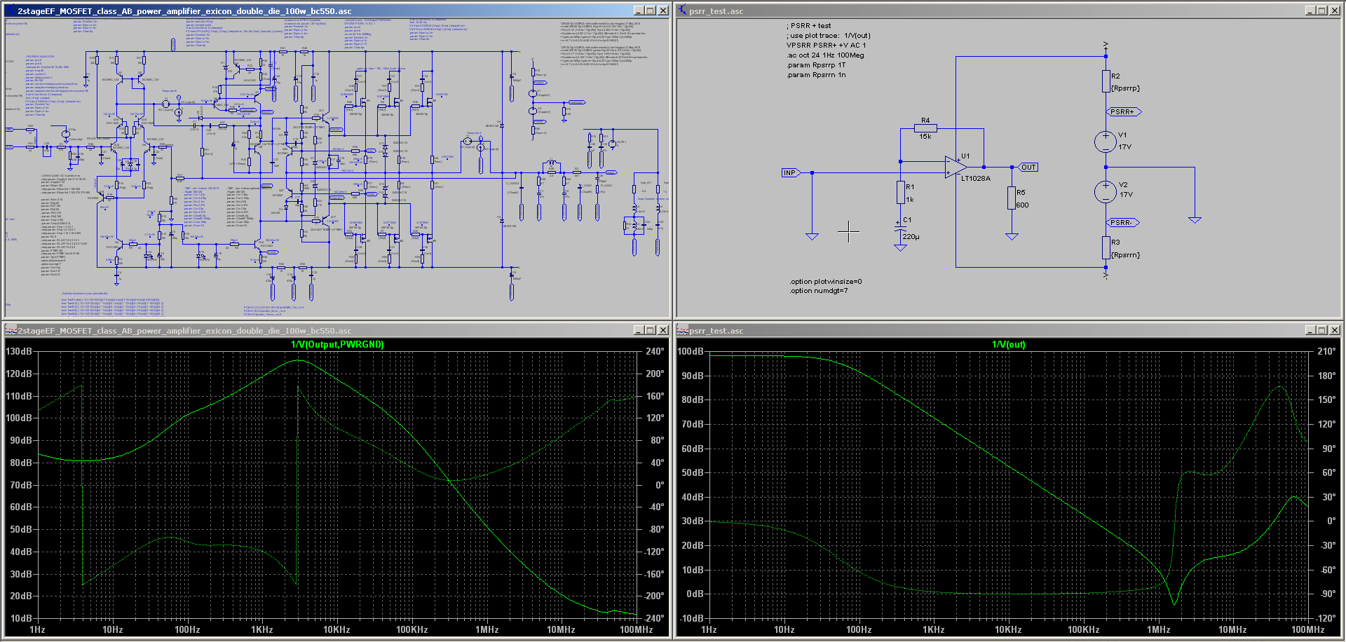

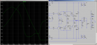

You need those switches because VPSRR as a 1V sinus source is added between 50V power source and V+ from amplifier.
Input needs to be grounded during this test.
BR, Toni
Sir Toni,
Connecting the input to ground I get a blank plot.
I tried switching to different functions at Voltage source (input) i.e. none, Pulse, Sine no response but if I put 1 at the AC amplitude, I get a reading. A little different from my other post, Is this valid?
Input voltage source is set to none. AC amplitude = 1.

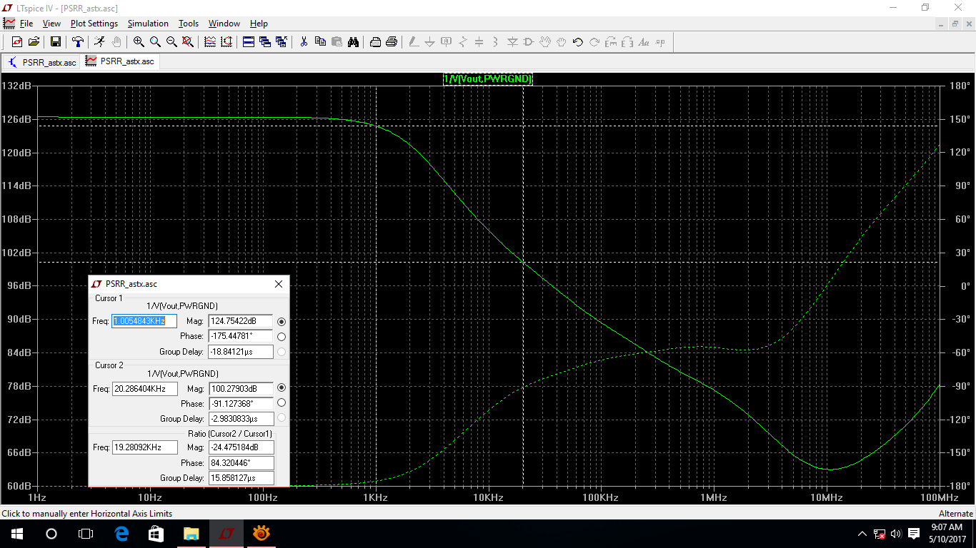

Hmmm...my plot seems to look like the opamp test I even replaced all ground symbol to bi-directional PWRGND net label.
Revert it and remove PWRGND as shown in the simple opamp circuit.
Input signal source must be removed and input short circuit to ground.

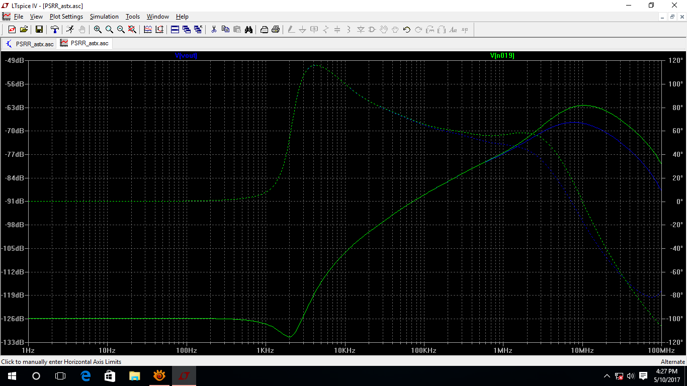

This one perhaps? V(n019) is before the zobel.

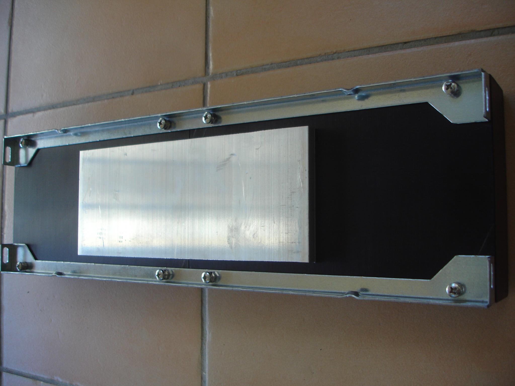

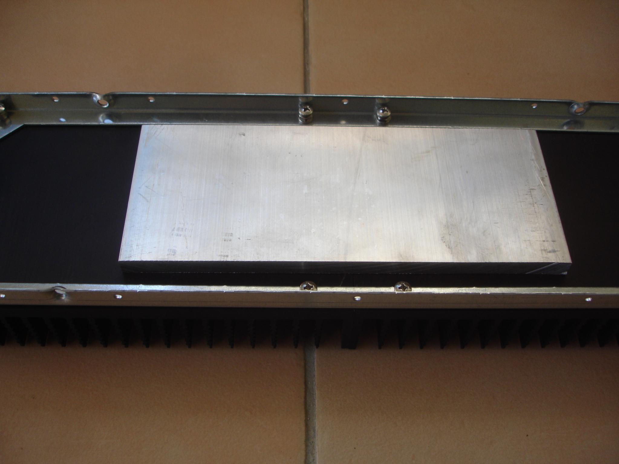

Good news!Dear Timios,
you may need a heatspreader. Operating the amplifier modules at about 450mA total bias dissipates 38W per side.
The modu heatsinks have 0.5 K/W for your 200x40x120mm sized heatsink parts. So the temperature rise above ambient will be minimum 19 degree. If you don't like up to 60 degree hot heatsinks in summer you can ask a local supplier for 2 pieces 200x80x6mm aluminium parts to build your own heatspreader.
(Will have a look into bin if I can find some suitable parts ... will send you an email soon.)
BR, Toni

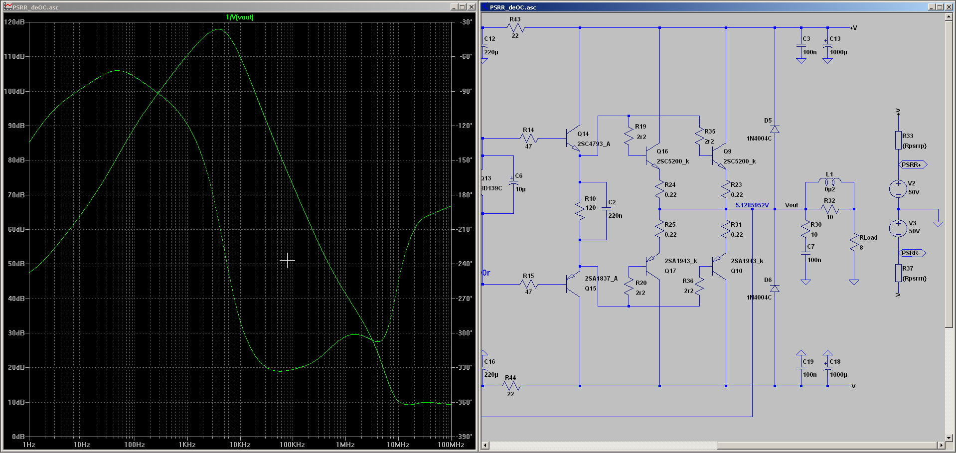

Sir Toni,
I am attaching the spice files of my amp, I know you are a very busy man but when you find the time please have a look at it.
Thank you!
Voltage sources naming is wrong. "V+" is not the same as "+V"
BR, Toni
BR, Toni
My bad, that was a small detail that I neglected to double check.
Got it this time. Thank you!
Good news!
I found this 200mmx80mm thickness 10mm.

Good news again.
Aluminium received today!!!
Really fast!!!
This is the seller.CNC cutting machines
All screws by modushop will be replaced with inox screws and safety washers.
Really fast!!!
