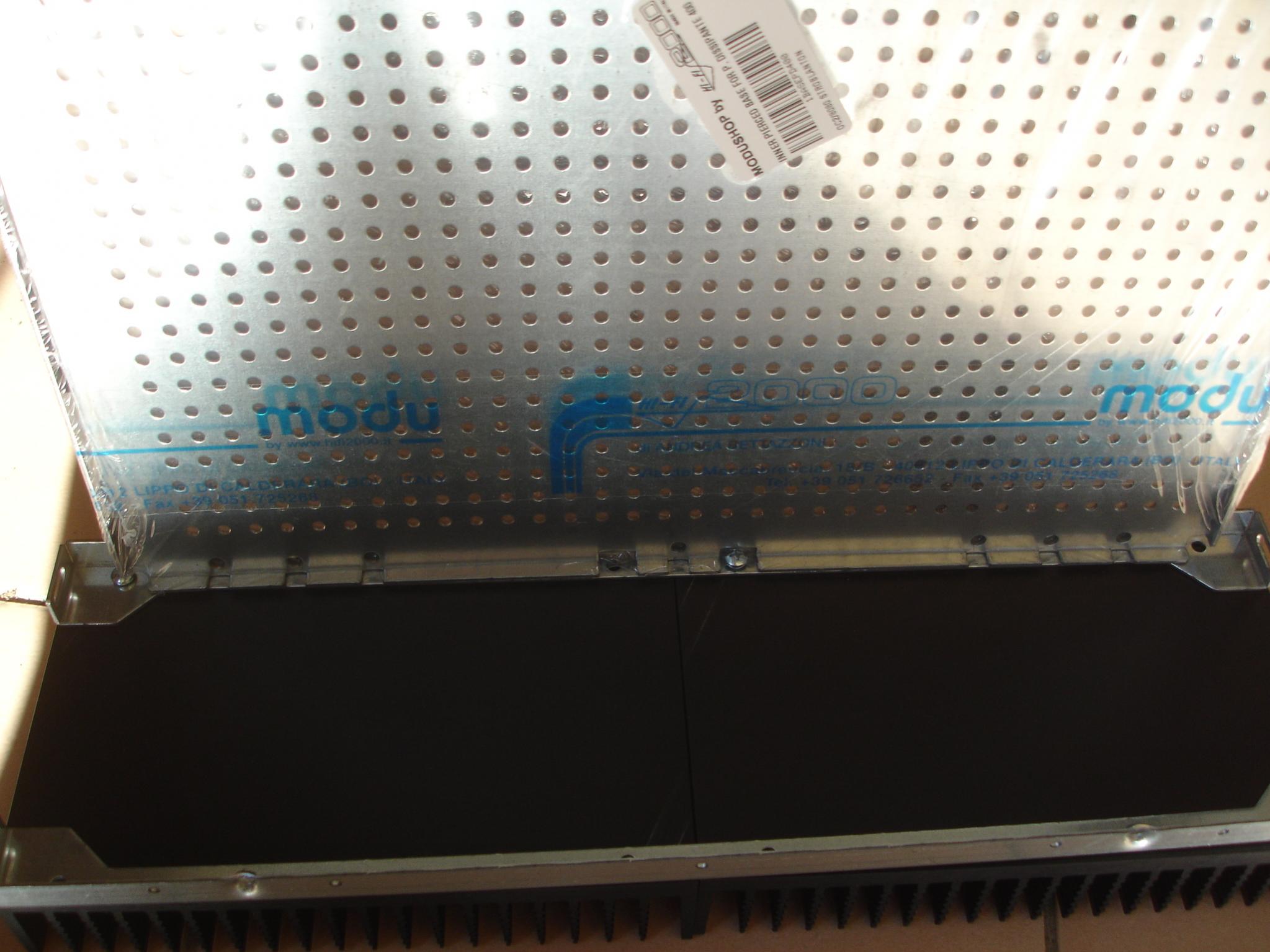

it will help equalise the heatsink backplate temperatures. But not much because the thermal goop is not squeezed down to metal to metal contact.
I can't see how you could bolt these together.
the best would be a very thick cover plate between the two above and below the active devices. But even that will have significant thermal resistance.
This way.it will help equalise the heatsink backplate temperatures. But not much because the thermal goop is not squeezed down to metal to metal contact.
It is a part of dissipante3U from Modushop.https://www.modushop.biz/site/index.php?route=product/product&path=66_96_105&product_id=208
That does even less. Can you calculate the thermal resistance of that small area steel coupling?
No i can't.That does even less. Can you calculate the thermal resistance of that small area steel coupling?
It's so high it is not worth trying.No i can't.
Dear Timios,
you may need a heatspreader. Operating the amplifier modules at about 450mA total bias dissipates 38W per side.
The modu heatsinks have 0.5 K/W for your 200x40x120mm sized heatsink parts. So the temperature rise above ambient will be minimum 19 degree. If you don't like up to 60 degree hot heatsinks in summer you can ask a local supplier for 2 pieces 200x80x6mm aluminium parts to build your own heatspreader.
(Will have a look into bin if I can find some suitable parts ... will send you an email soon.)
BR, Toni

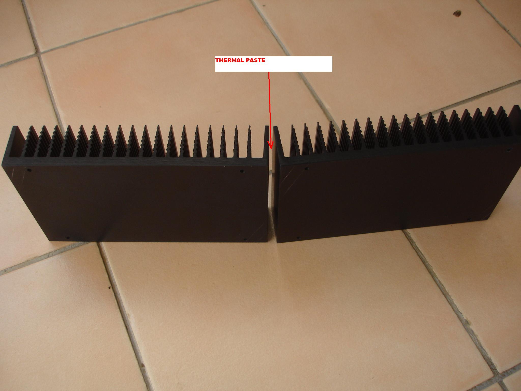

My previous attempt was unsuccessful.
Sorry,i know this is off topic but i want your opinion.
Is it a good solution some thermal paste applied between two pieces of heatsink in dissipante 3U?
Hi Thimios,
I encountered the same, what I actually did is clip them together by a sturdy stainless steel clip. [top & bottom] DIY because I can't find one in the local hardware shop. AndrewT is correct joining them together with a bolt is a tough job. Apply a small amount of thermal grease because when you clip them the pressure will push the grease out.[provided the corner edges are perfectly flat] When you mount the output trannies make sure to evenly space them. For example, for 4 pairs 2 trannies on the left and 2 on the right making the joined edges at the center position of the 4 outputs. That is if you plan to mount the output trannies directly to the heatsink, same applies if you will be using angular aluminum bar [L shape].
