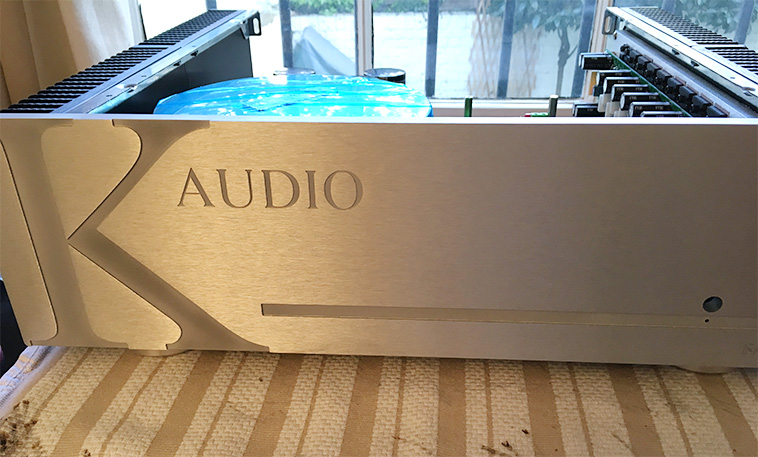

2stageEF high performance class AB power amp / 200W8R / 400W4R

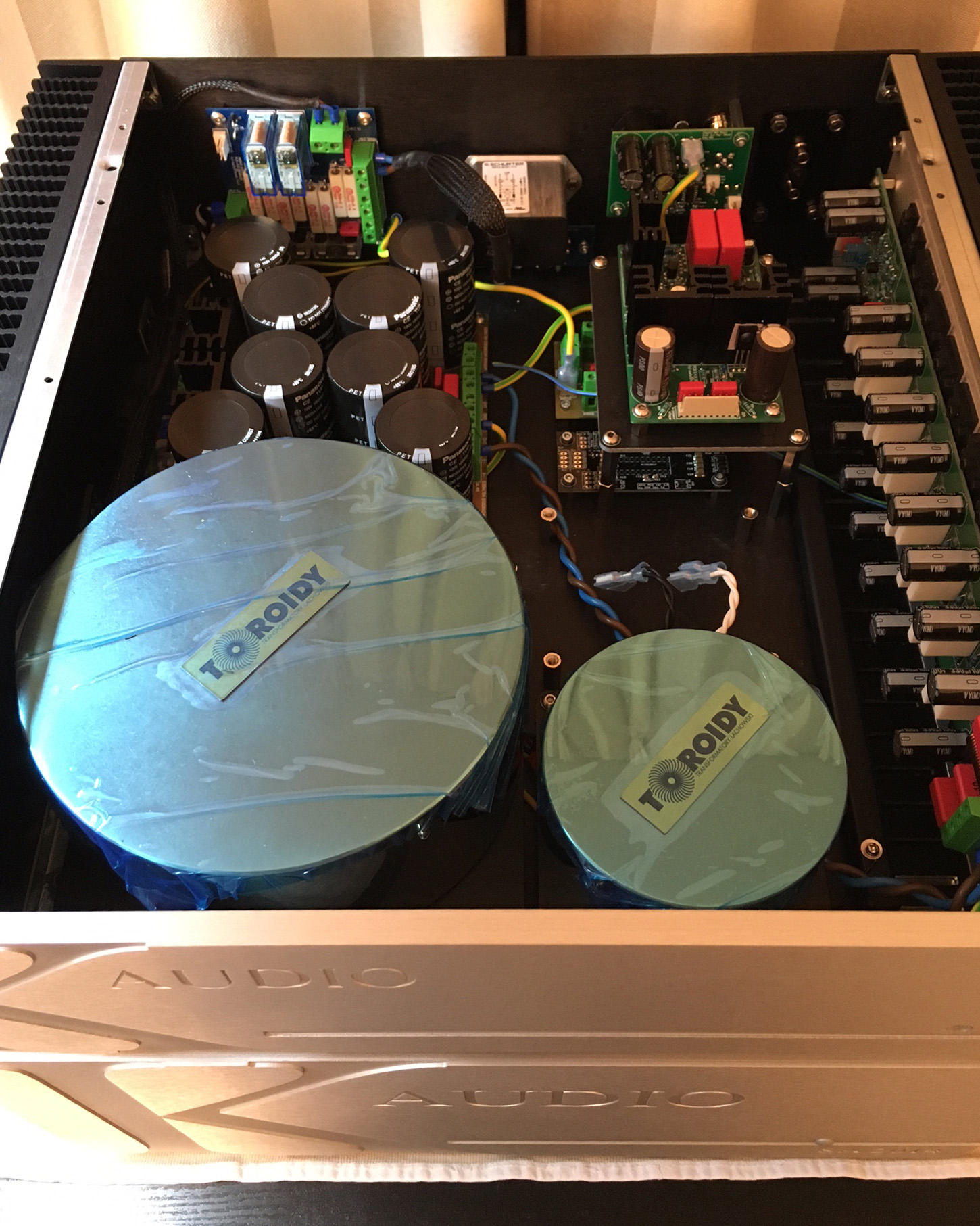

Long way to go and not going to finish before it gets packed up but plan is to have all the electronics installed within the enclosure even if not fully wired.
Cool. Here it will be about 20cm or so. It's not fully wired up but this is about as far as I'm going to get this side of the Atlantic. I just hope I can remember how to finish it when I finally get the chance to start again. 😱

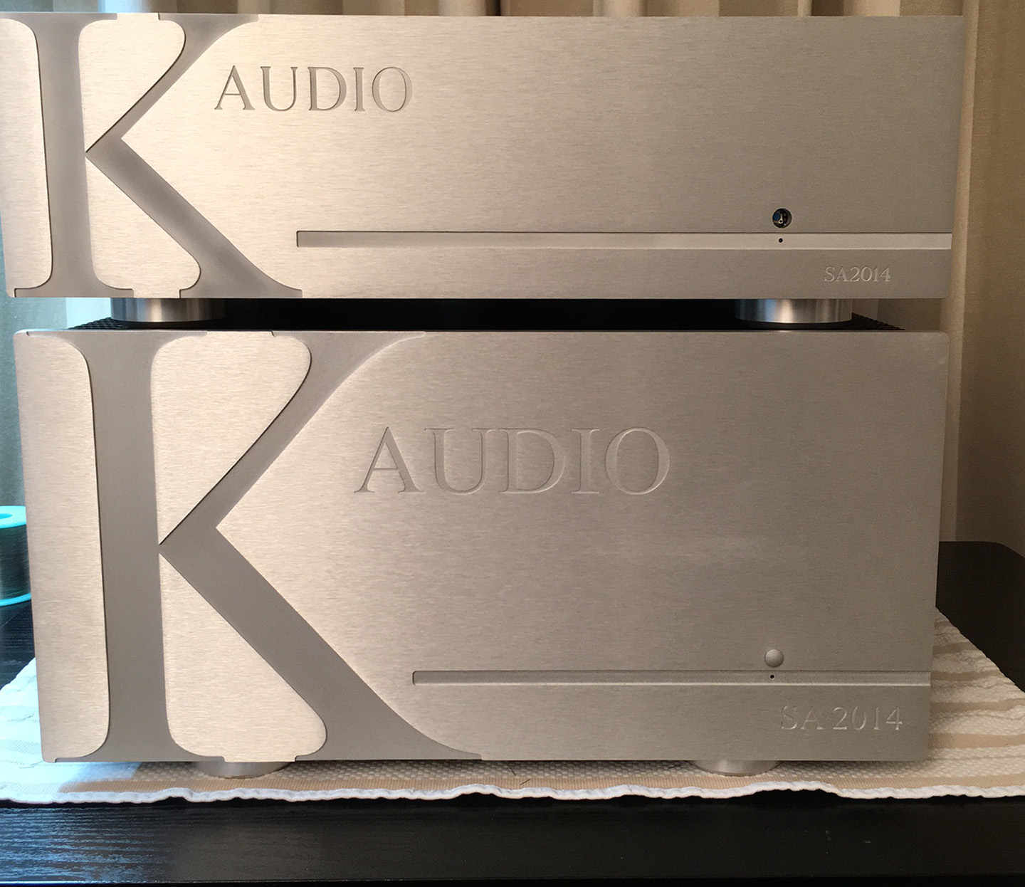

Here's the duo (or should I say trio of channels)! 😀

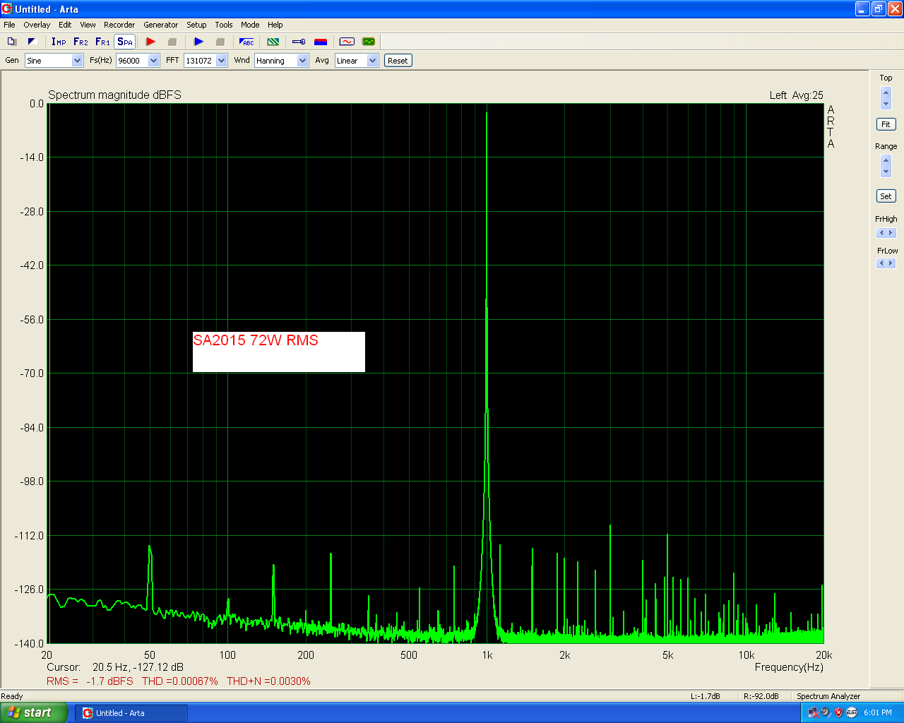

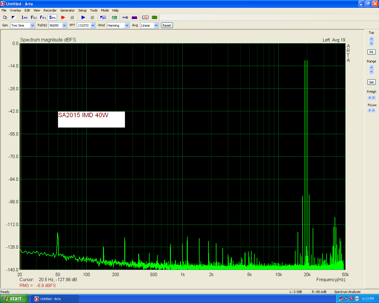

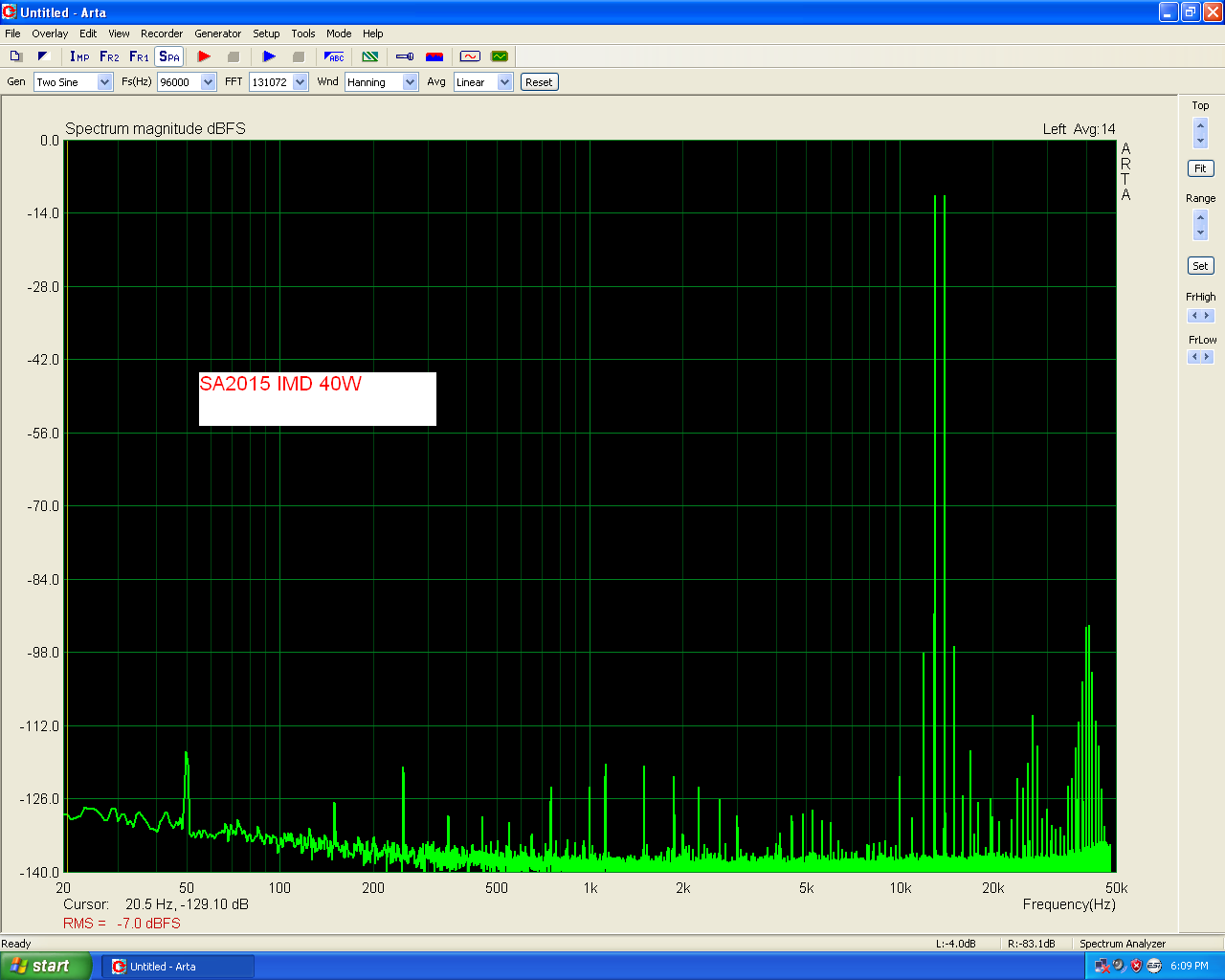

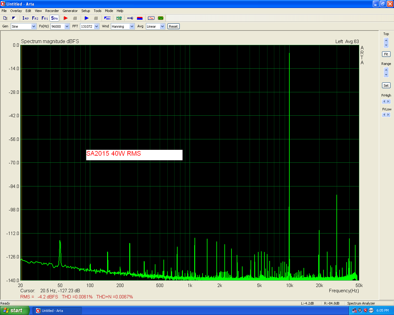

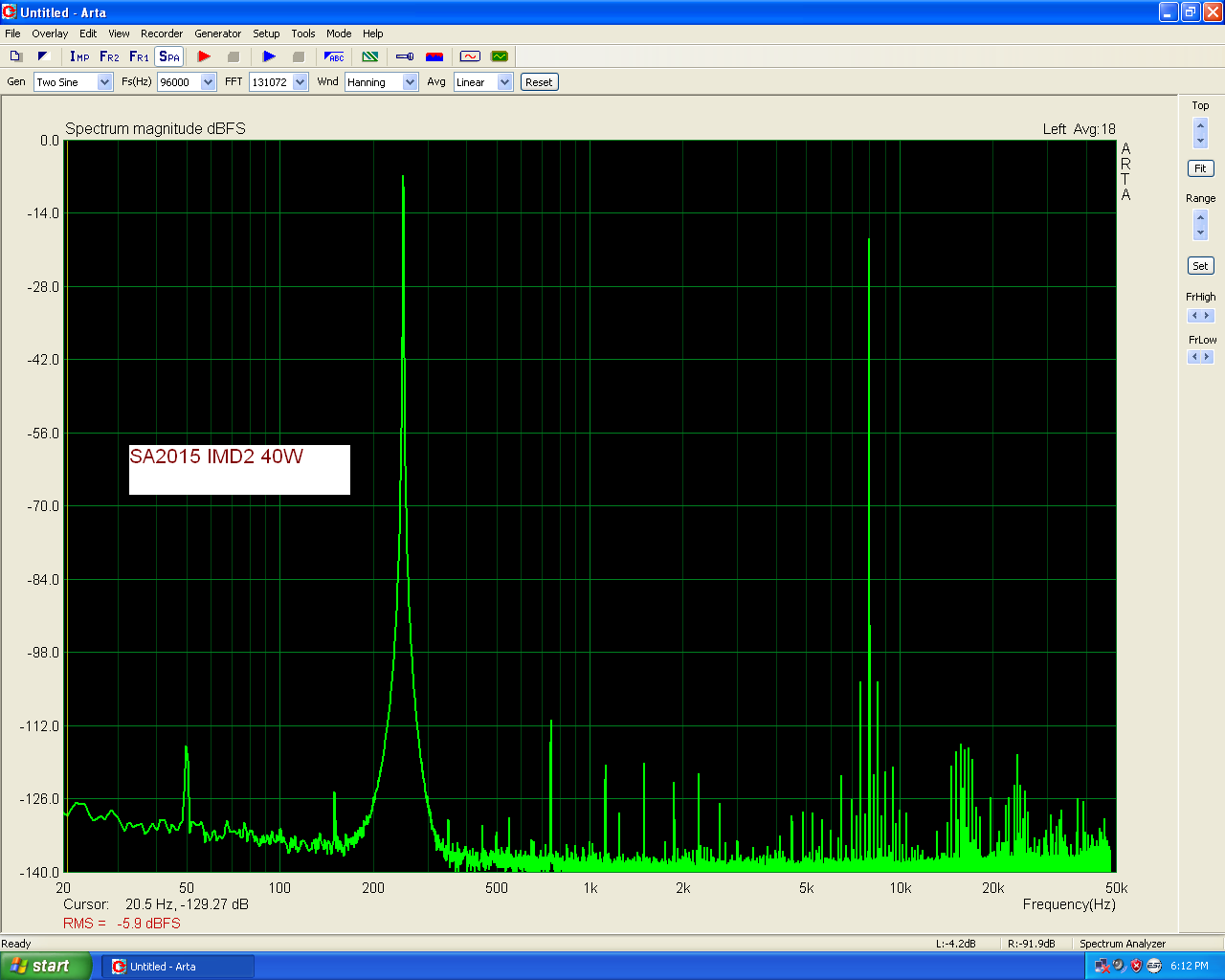

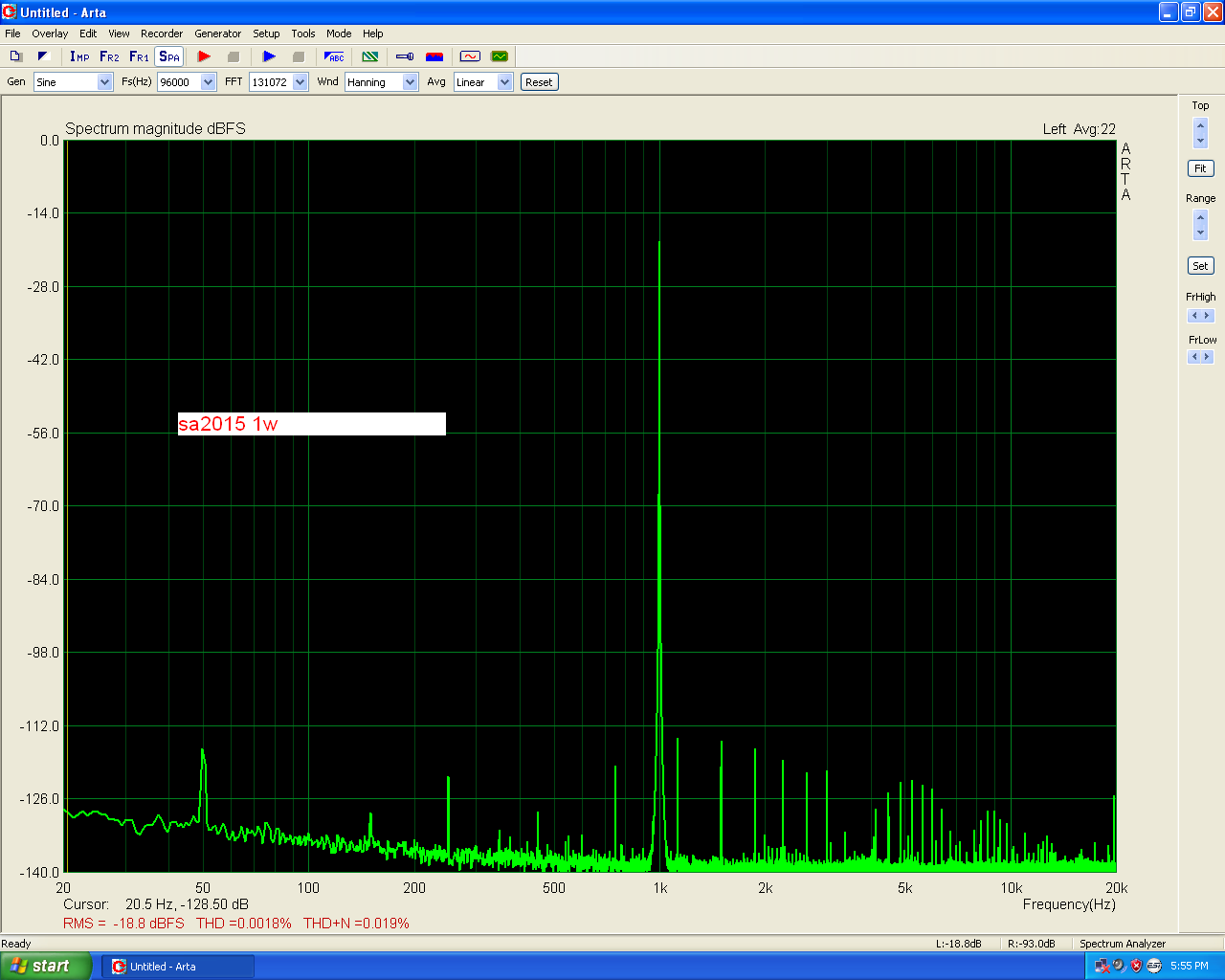

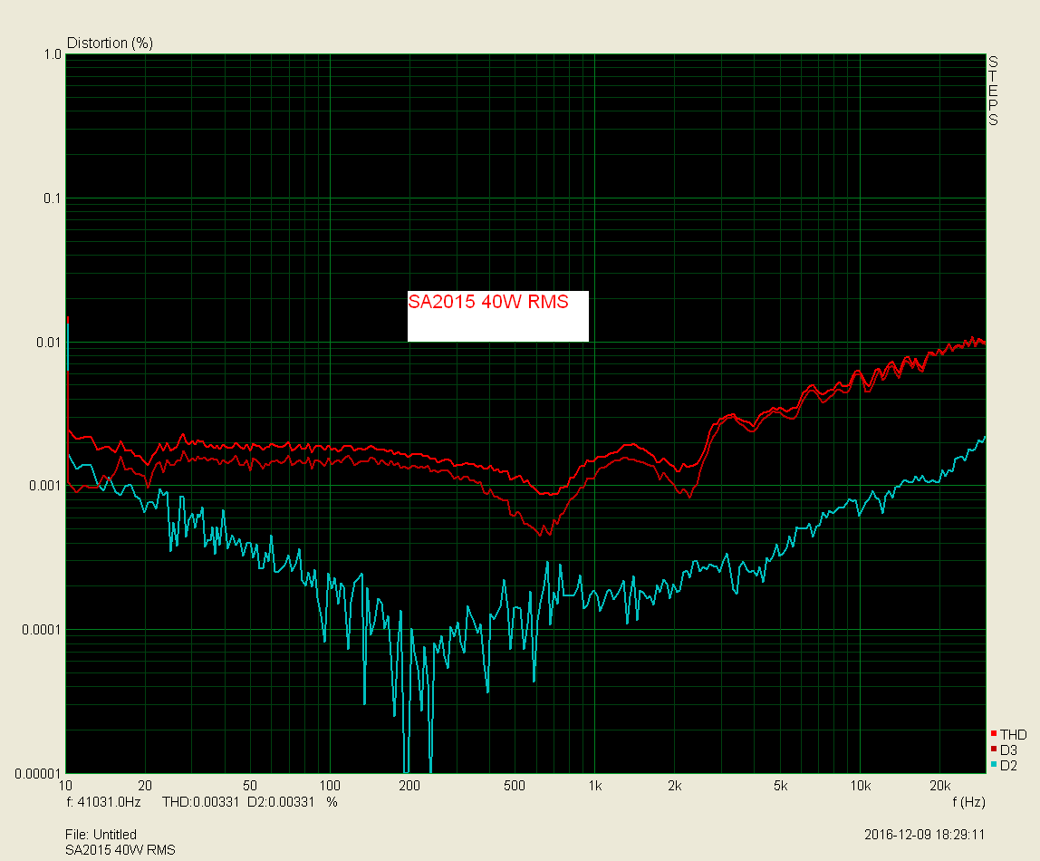

SA2015 FFT TEST
Looking back on my test i see that never i had publish my SA2015 fft test.
+/-42v
46000uf/rail
All test using esi julia pci sound card.
Here are the results.

That looks pretty good! I know that it's hard to get those low distortion readings with the PC soundcard method. You get the cabling never really hum free.
What me wonders is that my ARTA version is able to print the IMD values in percent on bottom of the IMD pictures. Whats your ARTA version? Or is this the free edition?
BR, Toni

Yes Toni it is a free edition.
I will see what the version tomorrow when i'm in test room again.

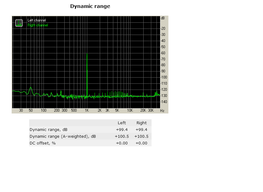

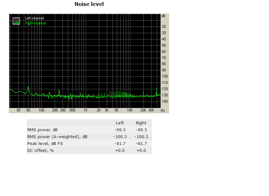

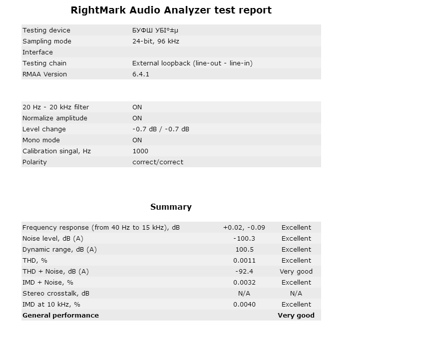

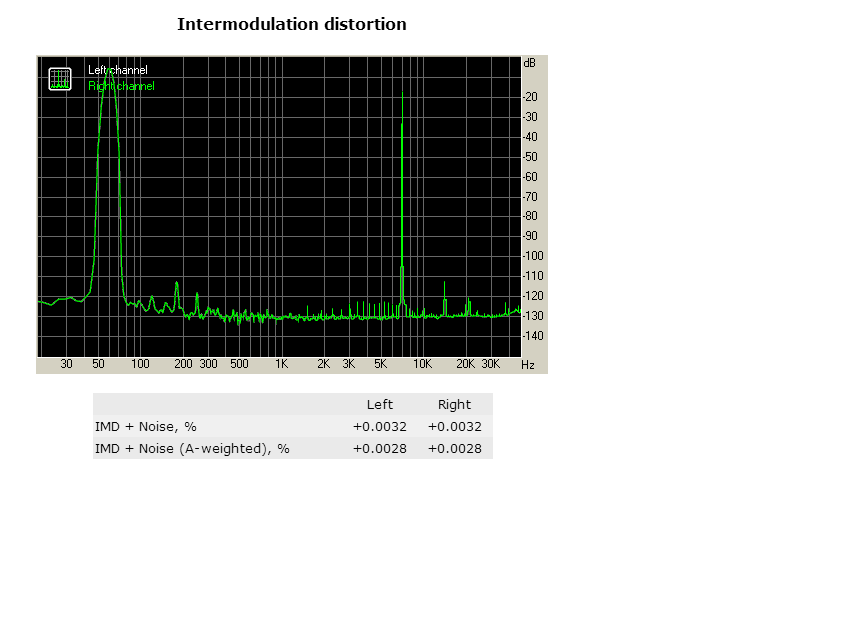

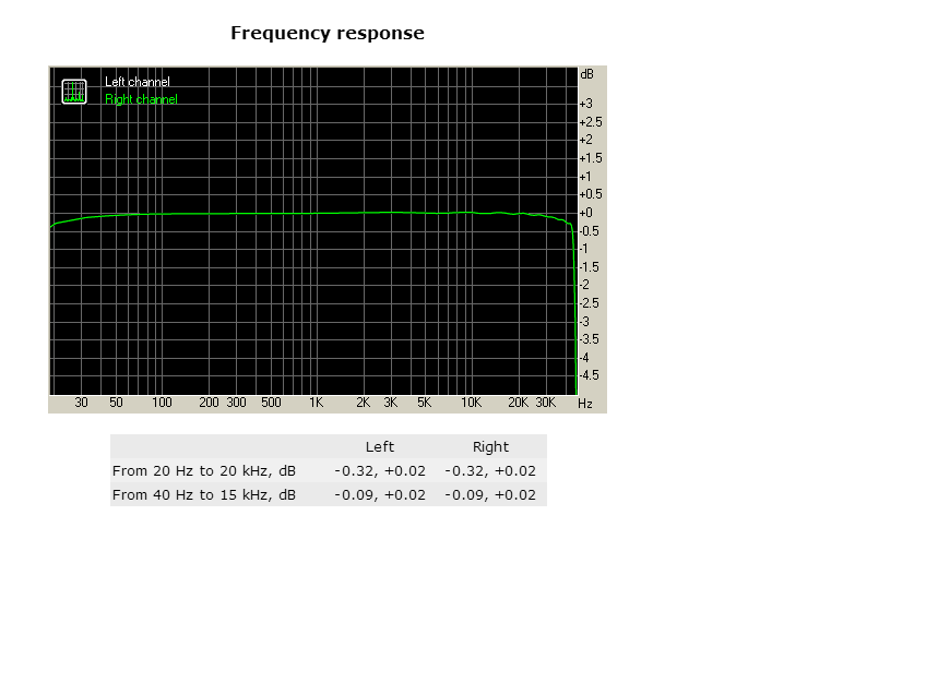

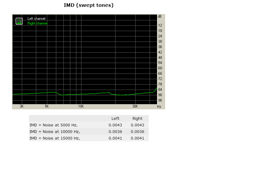

I have tested this using RMAA too.

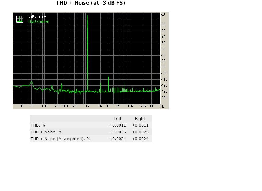

using RMAA
Results using RMAA.

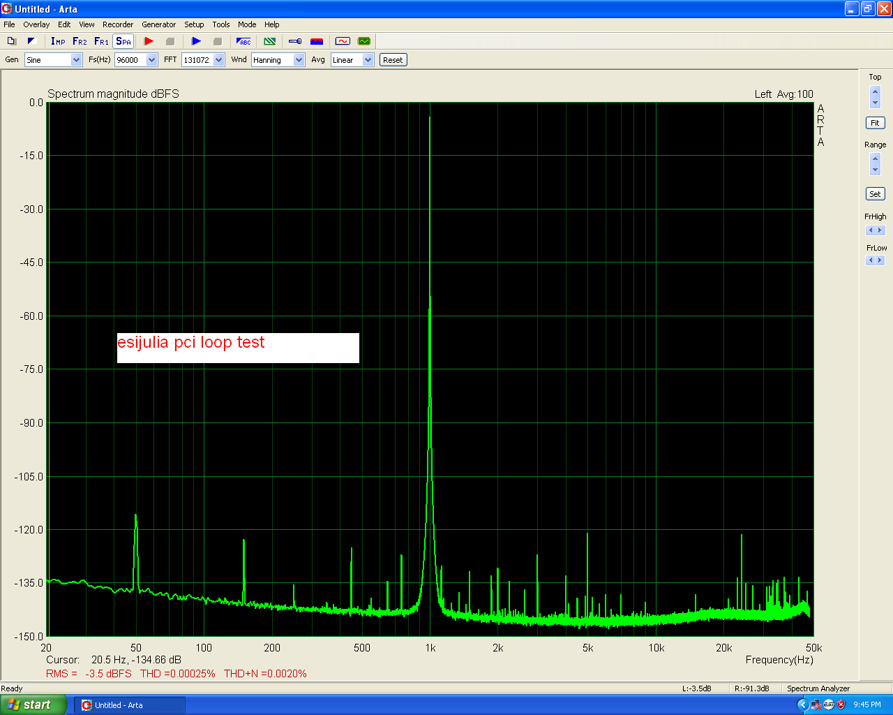

thimios what hardware are you using with ARTA?
Looks like you are testing your soundcard in loop mode...
Time to put the SA2015 power amplifiers in a case
Exactly!
All measurements are close enough to sound card limits.😉

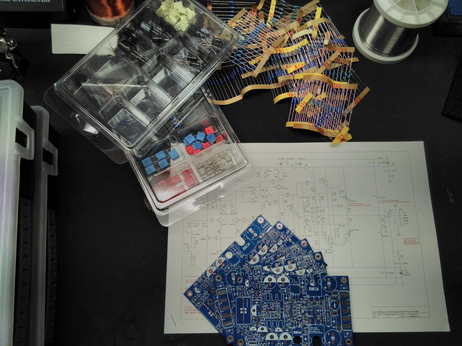

SA2015: using vertical mosfets IXTH80N20L and IXTH48P20P
... parts collected, prepared for soldering 5 power amplifier modules but sometimes it seems to be bewitched: no 18V Z diodes on stock 😱
