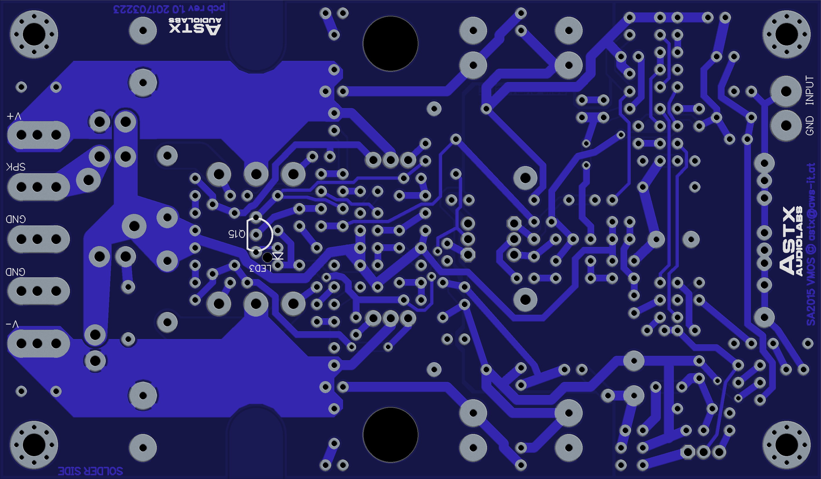

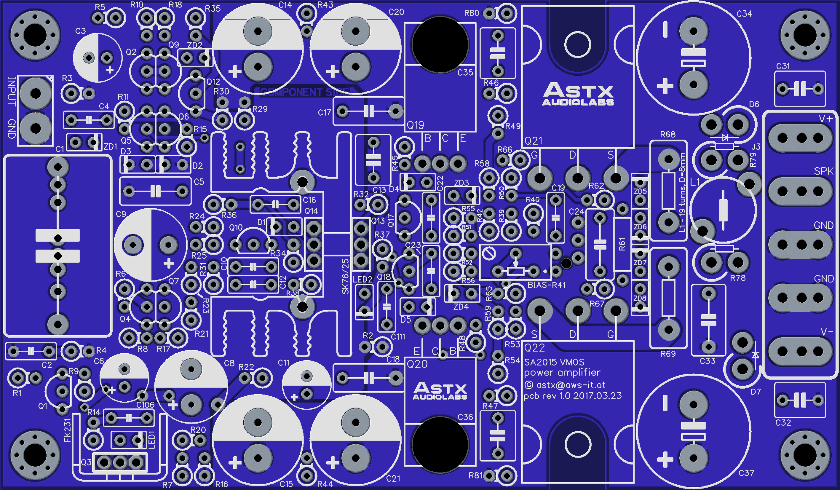

SA2015: using vertical mosfets IXTH80N20L and IXTH48P20P
just sent this to fab. Hopefully no routing errors.
This time a have placed the ground planes on top. The SK76 heatsink can be mounted without isolation washers.
BR, Toni

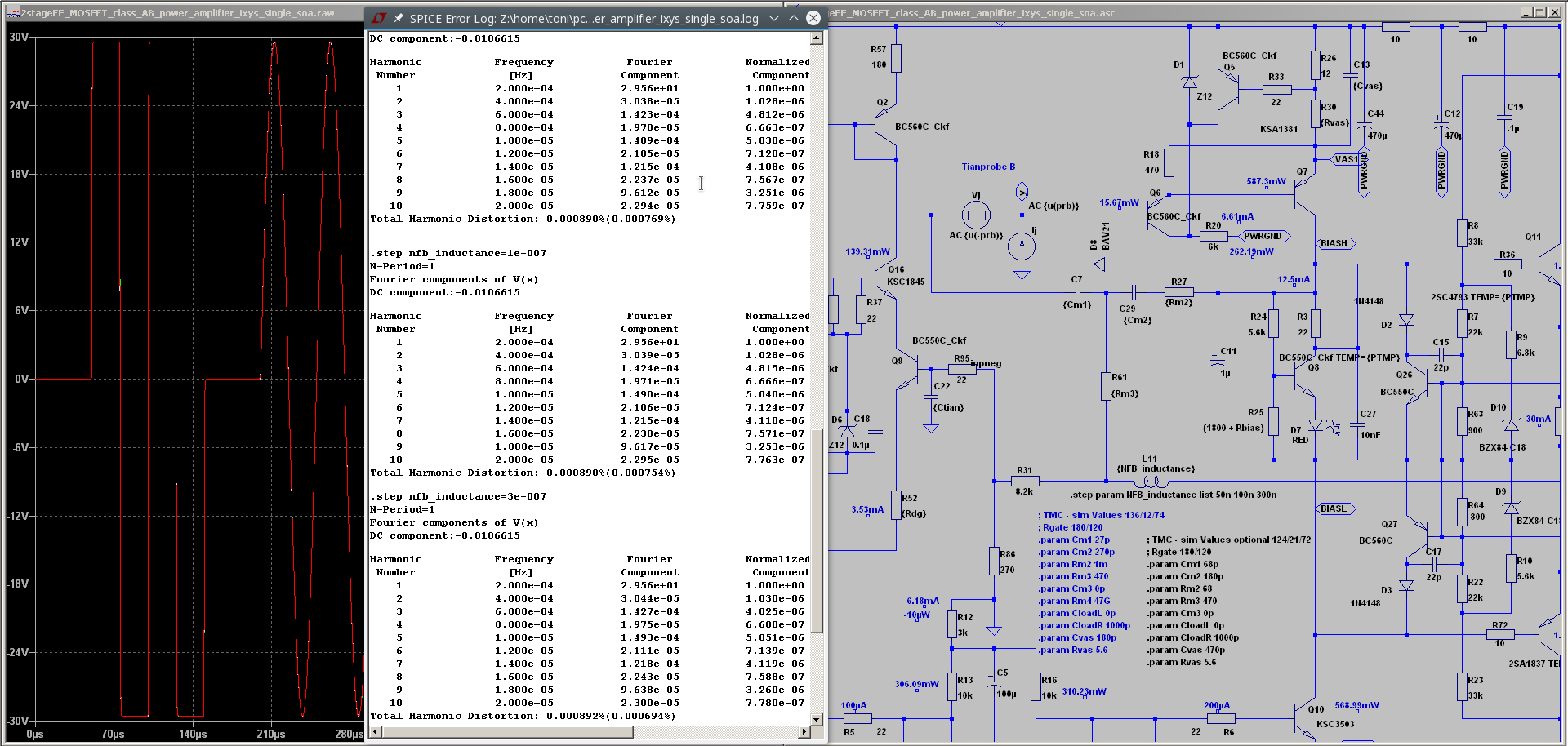

Test sample using 1 pair of IXTH80N20L and IXTH48P20P up und running!
Quick THD+N tests (80k bw) with SOA circuit in situ:
THD+N 20k@100W@8R: 0.0035%
THD+N 20k@200W@4R: 0.0042%

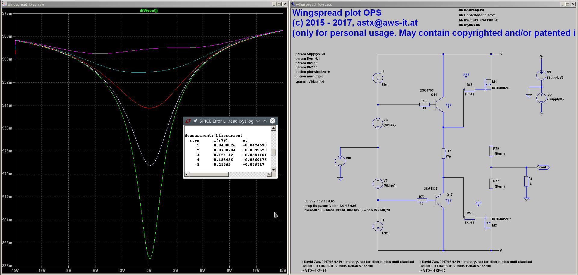

You can go for lower bias but THD will increase especially at crossover region. For the SA2016 using L-MOSFETS I have done some test with very low bias. See table at post#1765
For V-MOSFETs you will need always higher bias to get respectable values. Maybe I have some sparetime to repeat measurements also for SA2015/V-MOSFET variants at low bias currents.
BR, Toni
BR, Toni

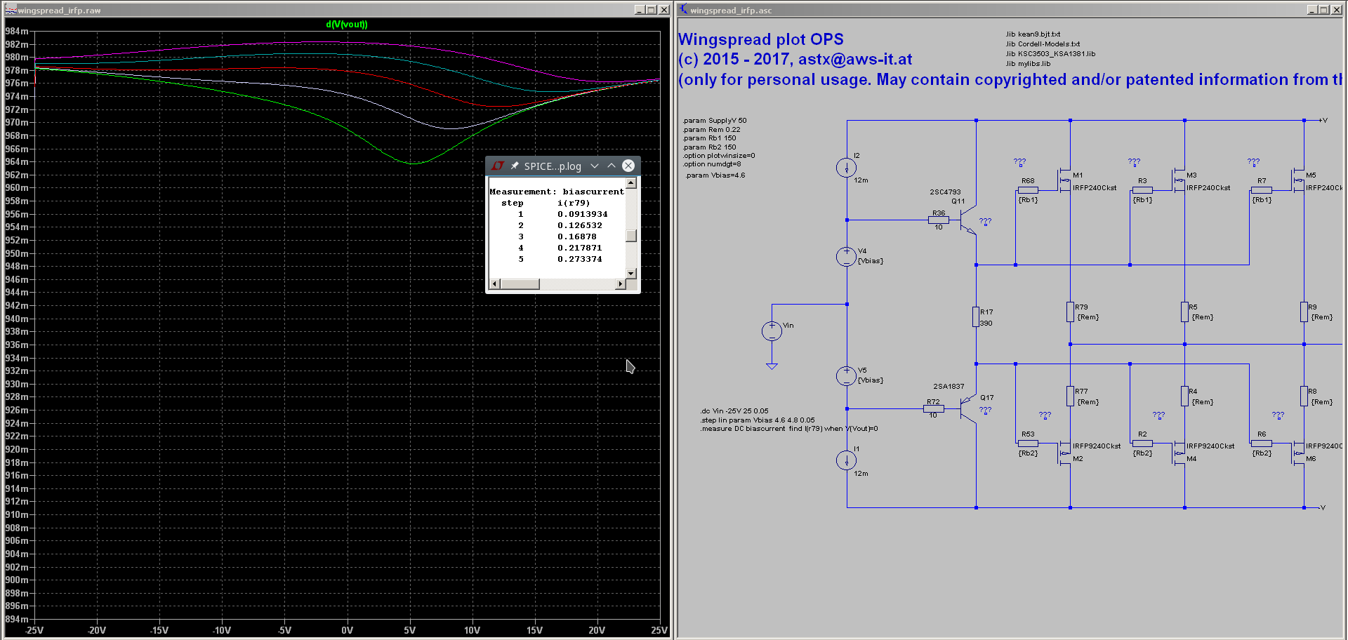

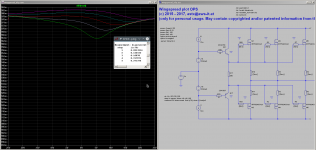

Is the 100mA per device, or total stage bias current?Outputstage linearity versus bias:
A bias not lower as 100mA is recommended for good OPS linearity.
It is per device.Is the 100mA per device, or total stage bias current?
BR, Toni
So the LatFET, single big vertFET and multiple VertFET are all getting close too Borbely's recommendation of >=500mA of output stage bias for FET outputs.
... a good rule of thumb!So the LatFET, single big vertFET and multiple VertFET are all getting close too Borbely's recommendation of >=500mA of output stage bias for FET outputs.
