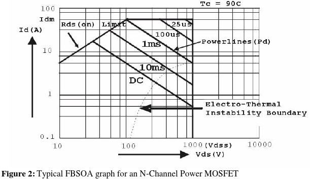

But maybe the effect has more to do with something like this:
  • V-MOSFET thermal coefficient changes rapid if junction temperature reaches e.g. 70 degree celsius?
During my tests the heatsink has had about 50 degree so the junction easily could have had 70 degrees ...
Complicated stuff and not helped by the usual mosfet charts showing -55, 25 and 150 charts. This paper has some nice explanations about why this is a little more complex than just carrier mobility effect. http://www.springer.com/cda/content...407478-c1.pdf?SGWID=0-0-45-1268751-p174130080
In practice I found that around 70 degrees is where vertical mosfets start behaving a bit more stable from a bias and temp runaway perspective. In other words I want to set my bias such that the sinks are around 50-60 degrees. Still risky without some sort of compensation though.
Joined 2011
Vertical MOSFET - Electro-Thermal Instability (ETI)
It has to do with the thermal time constant of the junction to case.
Thanks for reply. Maybe I found the explanation. As the heatsink was already very hot during longer test cycles the ETI curve may have moved to the left side (lower Vds). Also the mosfet's where not optimally thermally mounted with cheap and many times reused keratherm pads.
An AN from Ixys:
http://www.ixys.com/Documents/AppNotes/IXAN0068.pdf
Electro-Thermal Instability (ETI) can be understood as a result of positive feedback mechanism on the surface of the Power MOSFET forced into linear mode of operation:
- There is a local increase of junction temperature;
- This causes local decrease of Vgs(th) (MOSFET threshold voltage has negative temperature coefficient);
- This causes increase of local current density, Jds ~ (Vgs - V gs(th))2 ;
- Increase of local current density causes increase of local power dissipation and further increase of local temperature.
BR, Toni

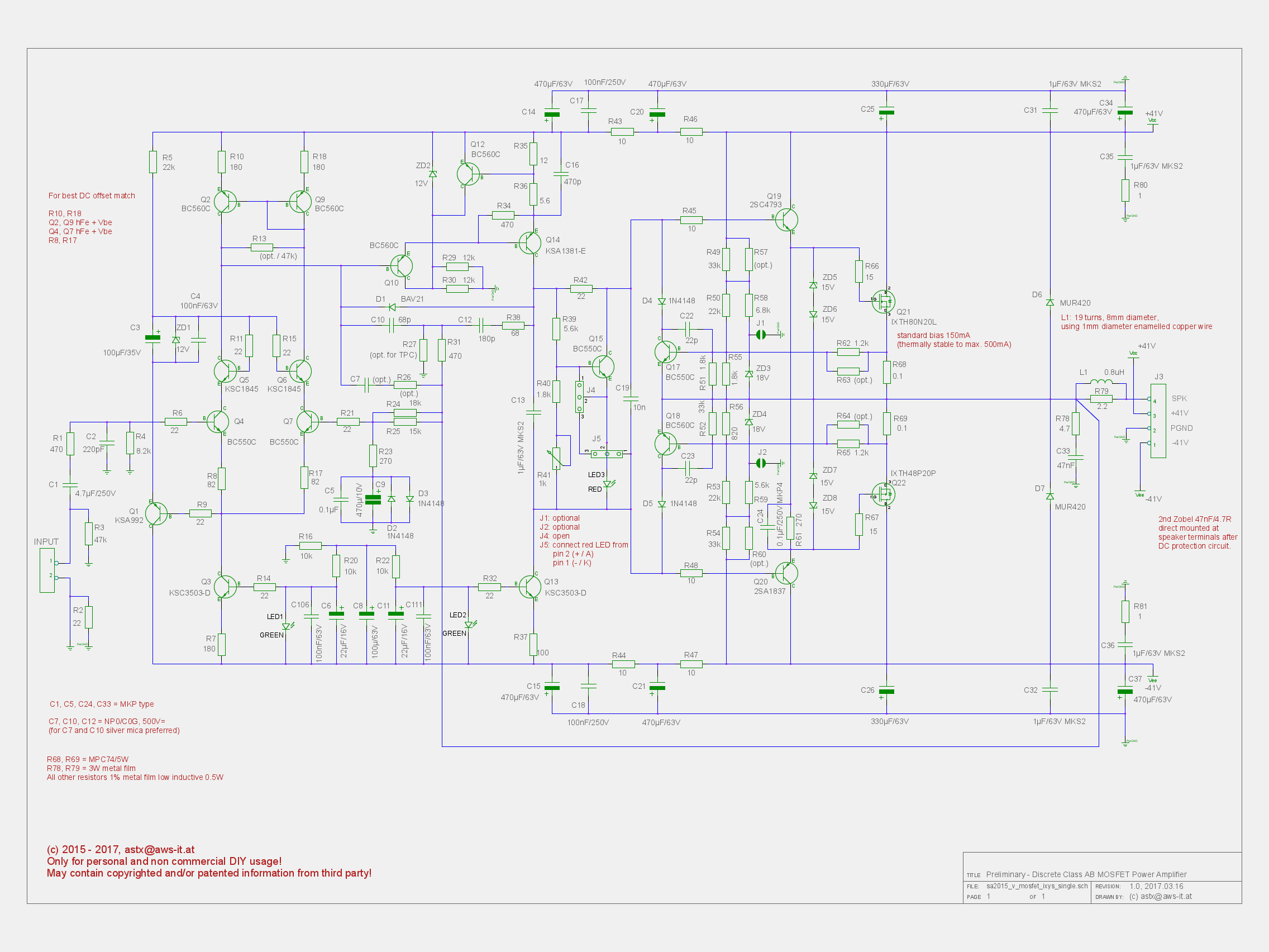

SA2015: using vertical mosfets IXTH80N20L and IXTH48P20P
... attached the schematic of the working sample.
First measurements see post # 2171 and post # 2174 above.
Note: Schematic free to use only for non commercial DIY projects.
WARNING: this circuit is using high DC voltages and is therefore dangerous. I am not responsible for any costs, damage and/or injury using these schematics and BOM. Do not use this schematics if you do not have the necessary experience and knowledge.

Test sample using 1 pair of IXTH80N20L and IXTH48P20P up und running!
Quick THD+N tests (80k bw) with SOA circuit in situ:
  • THD+N 20k@100W@8R: 0.0035%
  • THD+N 20k@200W@4R: 0.0042%
Rgate 15R. No oscillations detected. No signs of instability at +/-50V supply.
More tests and tuning data will follow as soon as I have repaired my test sample (a f...y short circuit during a f...y screw driver accident during tests :eek:)
Dave Zan's simulation models seems to match pretty good with the devices in reality. Bias settings in reality as expected from spice design!
Bias temperature stability similar to SA2015 IRFP240/IRFP9240.
