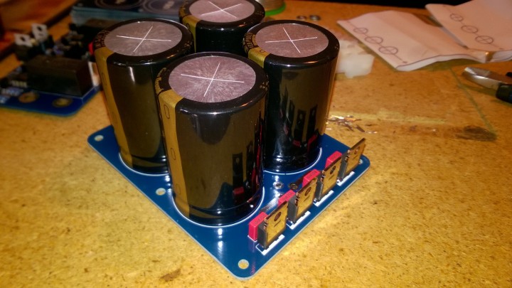

Is Epcos any good a brand for Capacitor. Or should it be BHC or Panasonic?
What rectifier bridge do you recommend, schottky or regular?
I use BC Components from Farnell, and Nichicon from Mouser. Nichicon is better, especially the Super Through, even it's bit expensive.
I built rectifier using HFA15TB60s. They sound much better than the common integrated bridges.

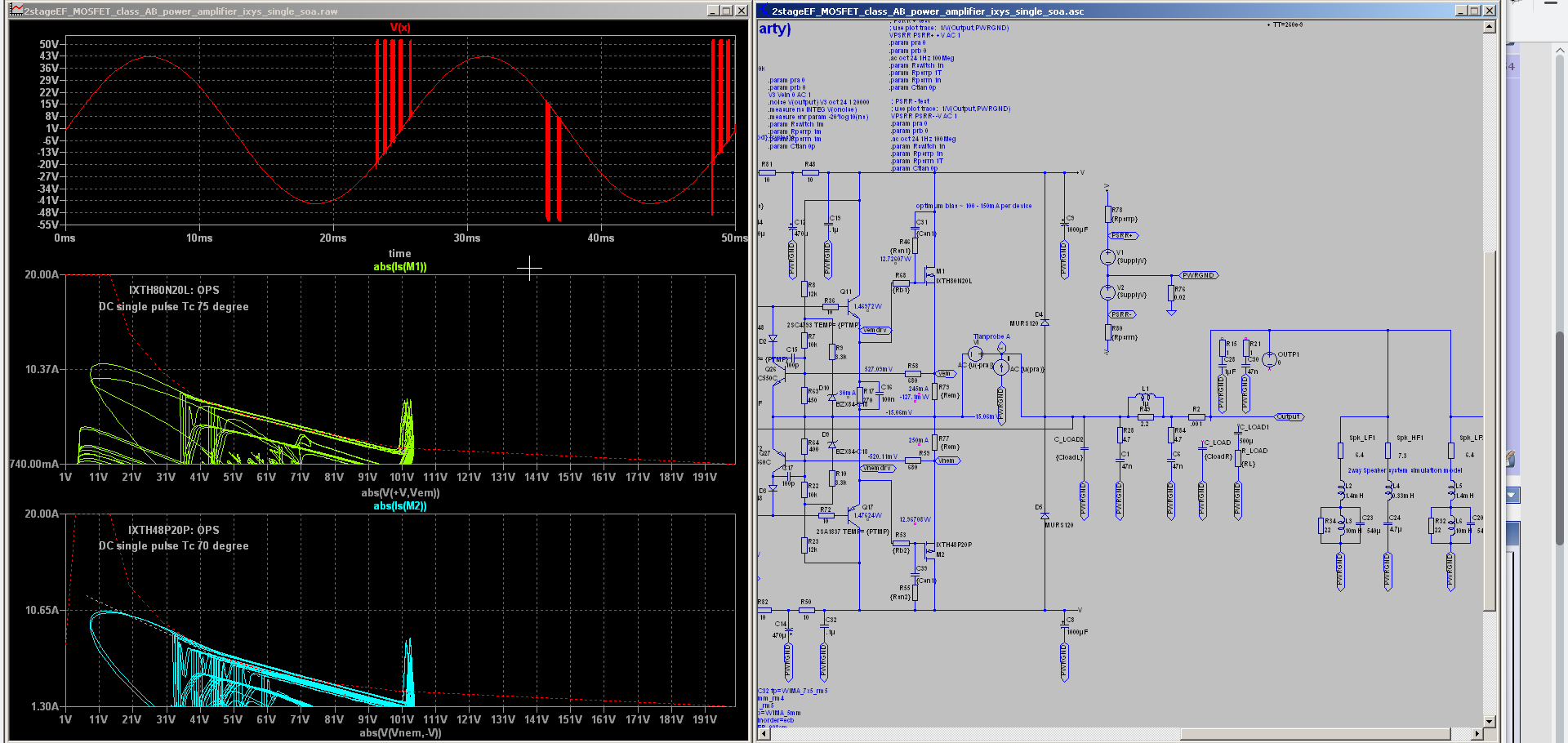

SA2015: using vertical mosfets IXTH80N20L and IXTH48P20P
SA2015 reloaded: using vertical mosfets from IXYS:
Dave Zan has provided some preliminary spice models. Here are first simulation results. Many thanks Dave for the models and the idea to use those power horses!
In the simulation the Rgate is as low as 22R - hopefully we have no oscillations here...
BR, Toni

SOA of the IXTH80N20L holds up to 80Vds
A 1pair output stage kept fairly cool with low bias could achieve a maximum power upto 250W.
If you go for a higher bias as needed by FETs, then a reasonable maximum power would be around 150W from a 1pair output stage biased to 200mA to 250mA
A 40-0-40Vac transformer should take that 1pair to around 130W to 150W into 8ohms.
Each of these brands are well reputed. Chose a capacitor of enough capacity, enough voltage rating, enough ripple current capability and low ESR. I don't believe in different »sounds« of capacitors of the same parameters.
On using Schottkys, you will observe some less dissipation.

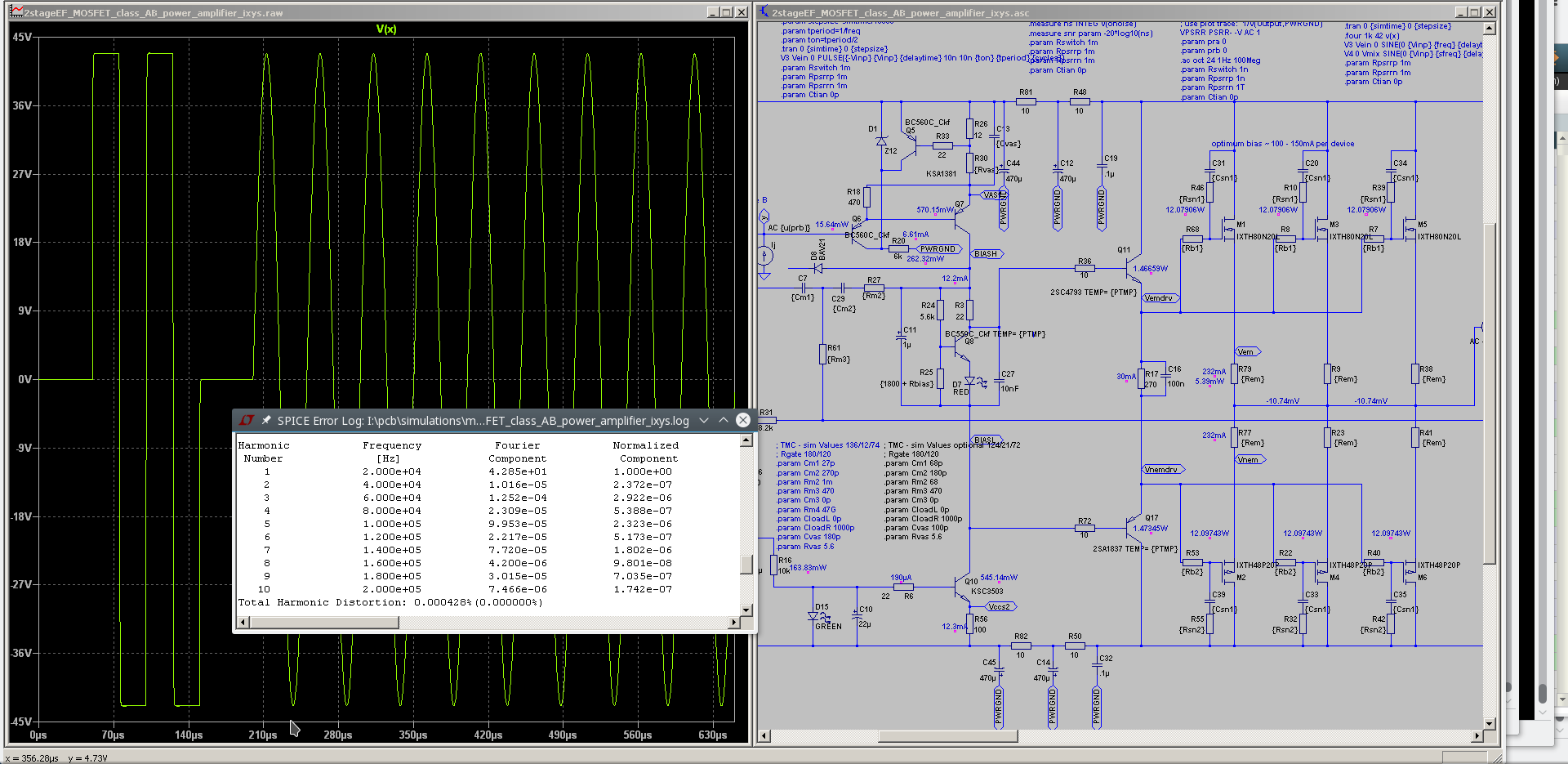

...IXTH80N20L and IXTH48P20P...
Here are first simulation results. Many thanks Dave for the models...
Your simulation looks broadly in line with mine, at 100 W @ 20 kHz THD is only a few PPM, pretty nice number🙂
In real life will be dominated by board layout etc. but should be exceptionally low.
Very pleased to be able to help with the models, I will test then more carefully in the next two days if you can wait a little.
SOA simulations
There is always something to learn new.
During design of the dual slope VI limiter for the new power mosfets I added 2 virtual "loudspeakers" parallel at outputs to simulate overload behaviour when too many speakers are attached. The VI limiter does it's work - but the speakers too. The back-EMF leads to short SOA violation pulses (see peaks around 101V). Not only this may kill your mid and treble speakers but may kill your OPS stage too...
A "normal" short circuit is no problem - the VI limiter does the work perfectly here.
SOA simulations
