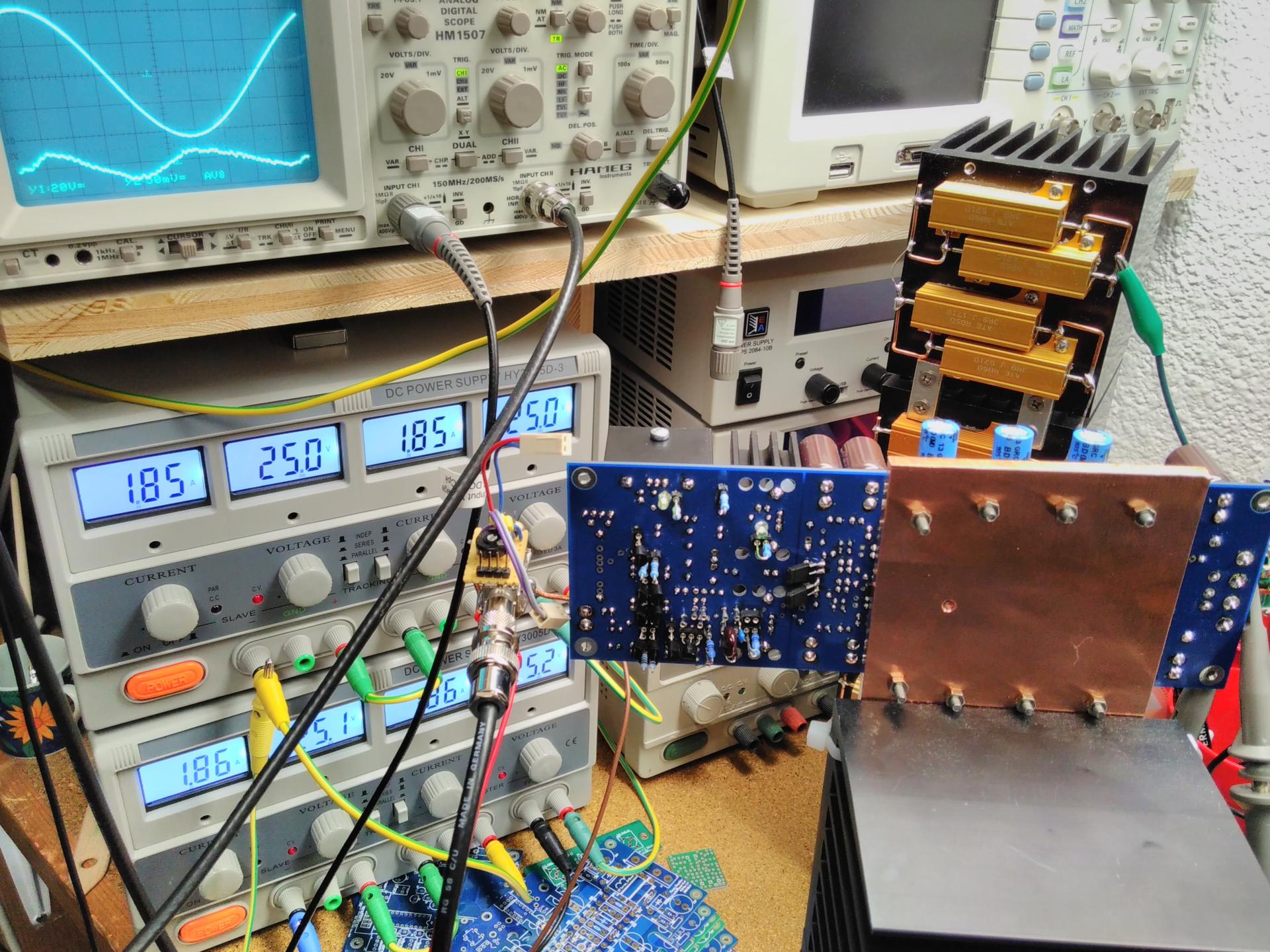

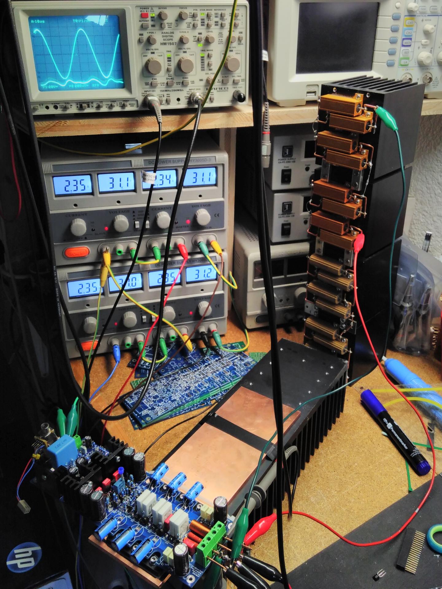

... attached some pictures showing the new test sample using double die MOSFETs ECW20N20 ECW20P20.
It is working as expected. 🙂 I only have matched the Exicons. All other transistors I have used from the same lot without further checking.
The calculated low value gate resistors of 150R/68R (see table some post ago) lead to the same oscillation problem as I have had testing the ECX10N20/EXC10P20 pairs. The OPS starts oscillating (~ 16Mhz) if total bias is over 700mA (about 230mA Bias per pair). A quick test using 330R/220R gate resistors stopped oscillations. Even with 3A total bias no more oscillations. The next days more test will follow.
Test conditions: Power supply +/- 50V stabilized. Total Bias 450mA. Right picture shows 1kHz@120W@8R performance and distortion residual (Ch2).

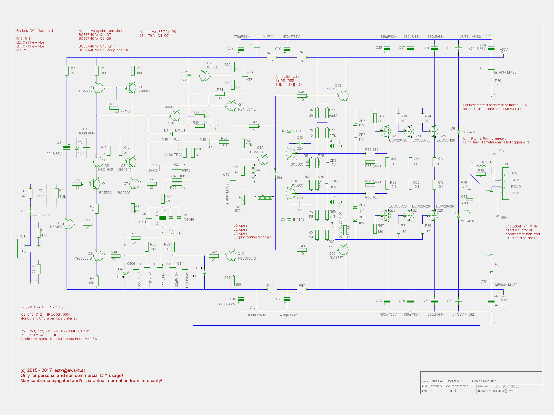

Attached the preliminary schematic!
BR, Toni
Note: Schematics are free to use only for non commercial DIY projects.
WARNING: the circuit is using and providing very high AC and DC voltages and is therefore very dangerous and can be lethal. I am not responsible for any costs, damage and/or injury using these schematics. Do not use this schematics if you do not have the necessary experience and knowledge.
