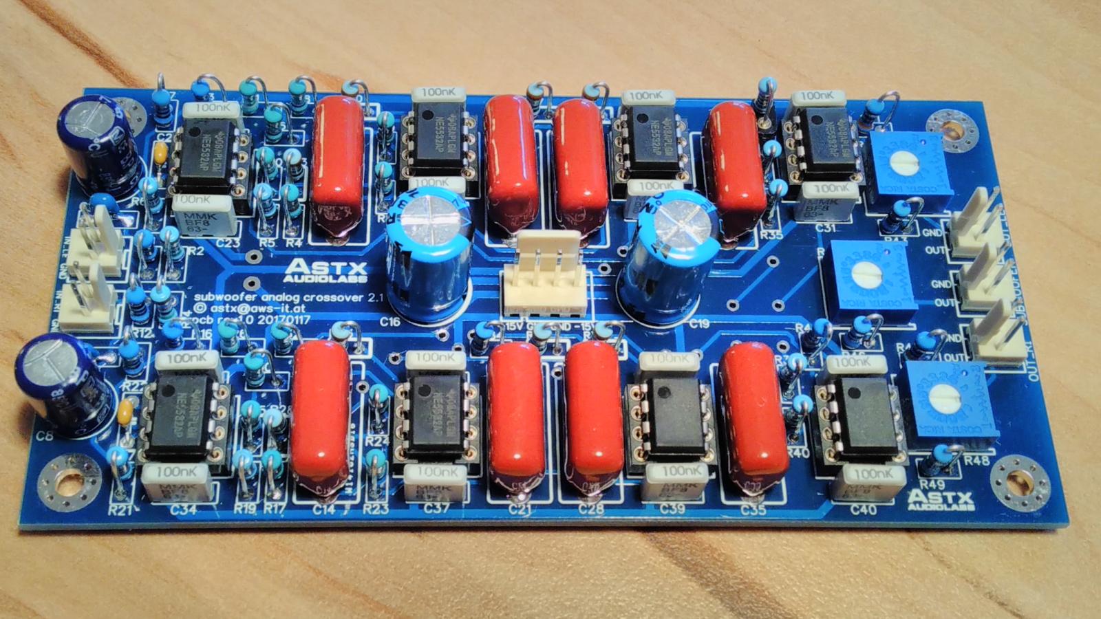

Ok I think this matches. Perhaps you can double check...
Pin1 - 4 order seems to be correct in respect to the housekeeping V4 pcb versions.
BR, Toni
cool - pin 1 at the top. (and the power pins don't matter)
I have ordered a sample of the switch. Mouser part number: 611-PTS645SM50SMTR92. When it arrives I will double-check the footprint and if ok will order the boards.

Is this circuit shareable?
I'm unsure - think it is copyrighted. Most of the circuit and part values are from page 248 of the book of D. Self "The design of active crossovers" with some changes/additions from me. I have added a mono summer for the subwoofer channel and output buffers. These parts I can provide freely.
The LR24 circuit itself is downloadable from "rane":
http://www.rane.com/pdf/old/ac22ssch07.pdf
D. Self has reduced the LR24 relevant resistor part values by a factor of 4 and added a 10dB gain buffer in front of the circuit.
BR, Toni
BR, Toni

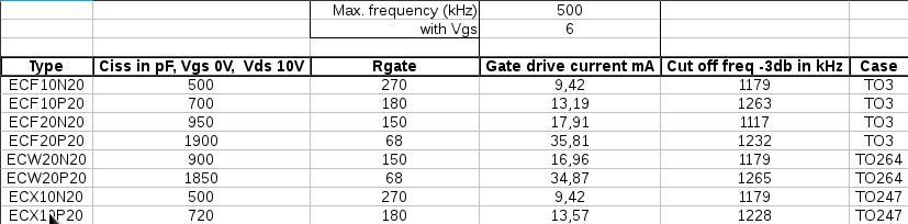

Gate resistor calculations:
Has anybody experience using lowered gate resistor values using double die lateral mosfets?
Attached a calculation table which compares the different gate resistors versus cut off frequencies.
BR, Toni

I used the double die in the 2014 PCB, but never thought about changing the gate resistor values.Gate resistor calculations:
BR, Toni
The question is: will the double die mosfets be stable using such low resistor values: 150R for N-Channel and 68R for P-channel mosfets. The calculated cut off frequencies are nearly the same as the single die mosfets which are stable using 270R and 150R gate resistors.
Will test this on my modified PCB how low we can go in this design without oscillations...
BR, Toni
P.S.: of course you mean the SA2015 pcb's - do you? 😉
OK - that was the pcb "SA2015 rev. 1.4 2016.06.17" - wrong named (name was reserved for the vertical mosfet "SA2015" amp) and with trace error but can be made working using a knife and is after-wards electrical identical with the corrected pcb "SA2016 rev 1.6.2 2016.08.07".I have the PCBs with the trace error, that you gave away for testing.
Many Alfet and Exicon circuit examples are showing 330R for N-channel and 220R for P-channel gate resistors for single die mosfets.
A double die chip has 2 times the Ciss and the questions is: will the mosfet be stable if we reduce the gate resistor to represent the same cut off frequency?
BR, Toni
