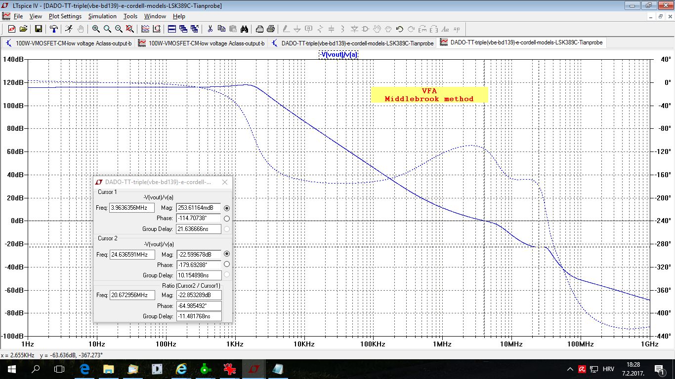

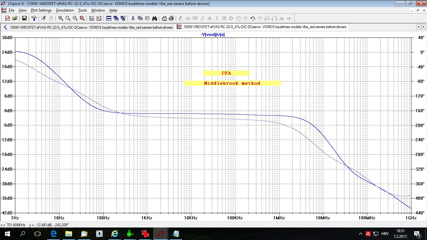

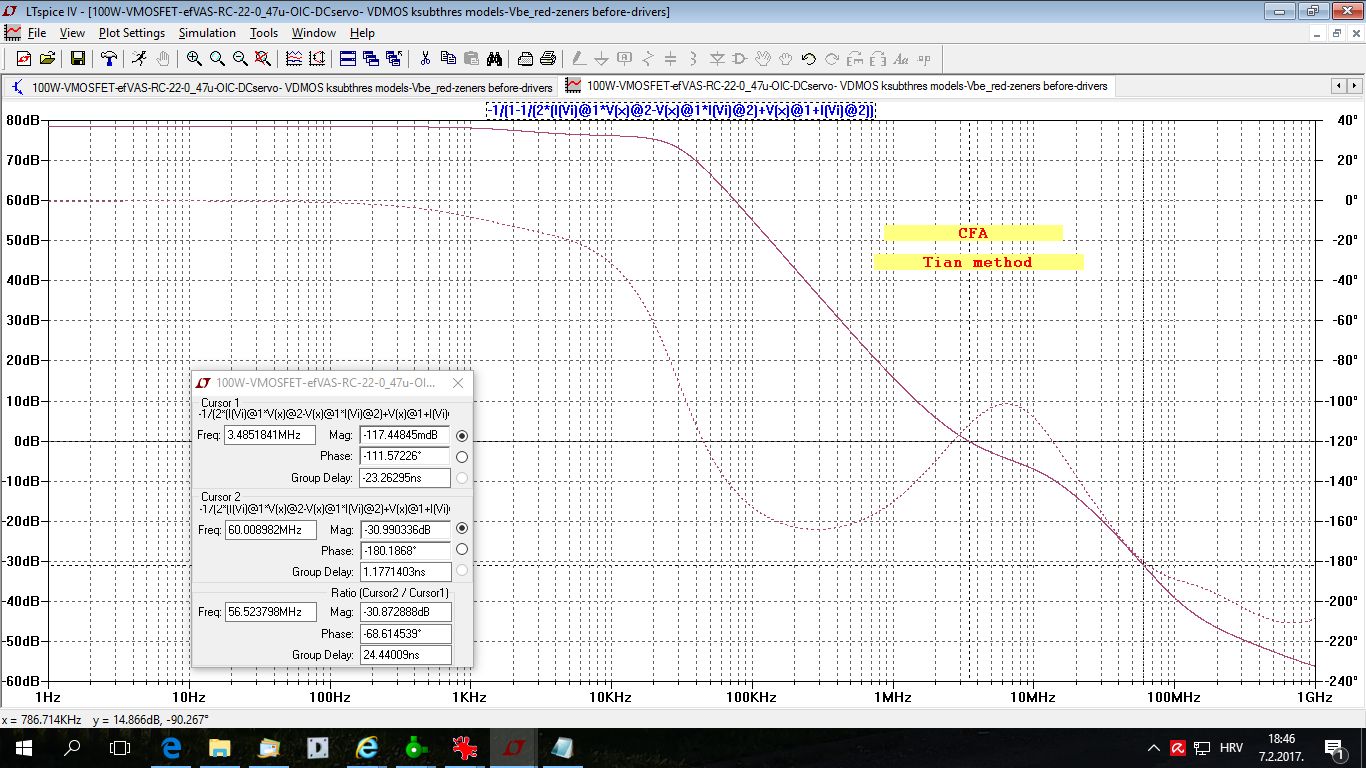

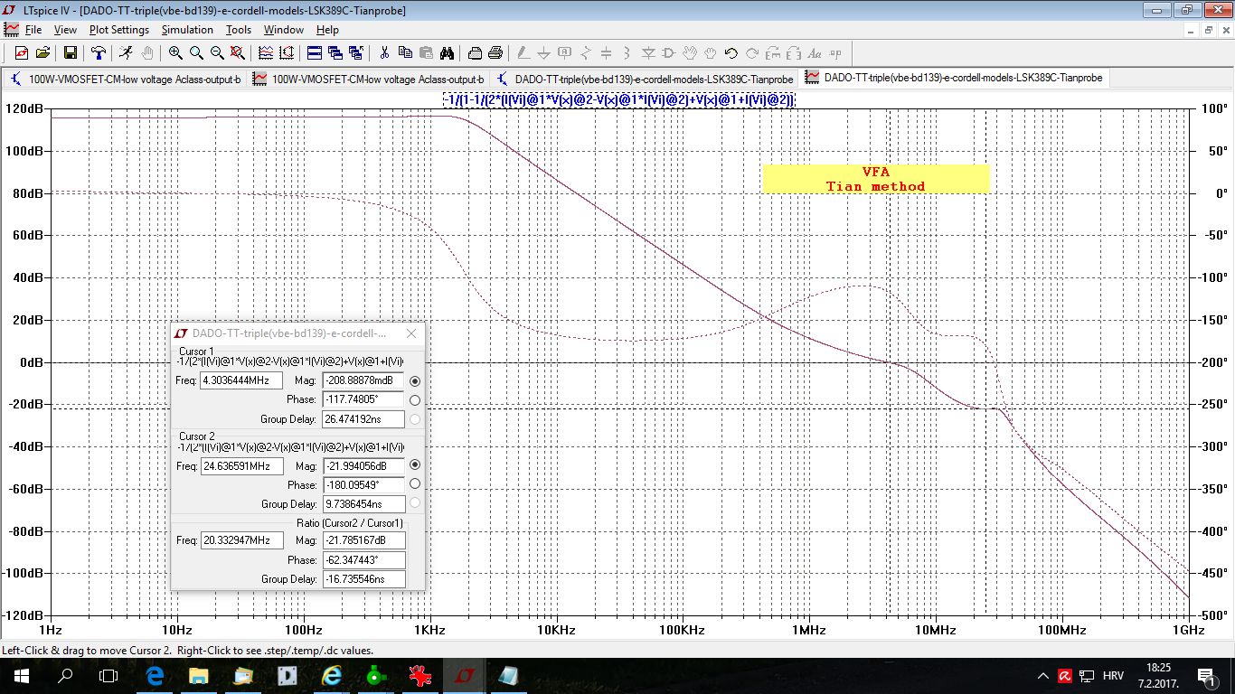

Hi Toni,
Some time ago in other thread I tried to explain to B. Cordell that the method with high impedance inductor is useless to get Loop Gain plot for some kind of amplifiers and used compensation. The same is valid for Middlebrook method.
Attached are four LGs, for VFA were the Middlebrook produces acceptable error, but for CFA (in this case my CFA) is completely useless.
Damir

Hi Toni,
Damir

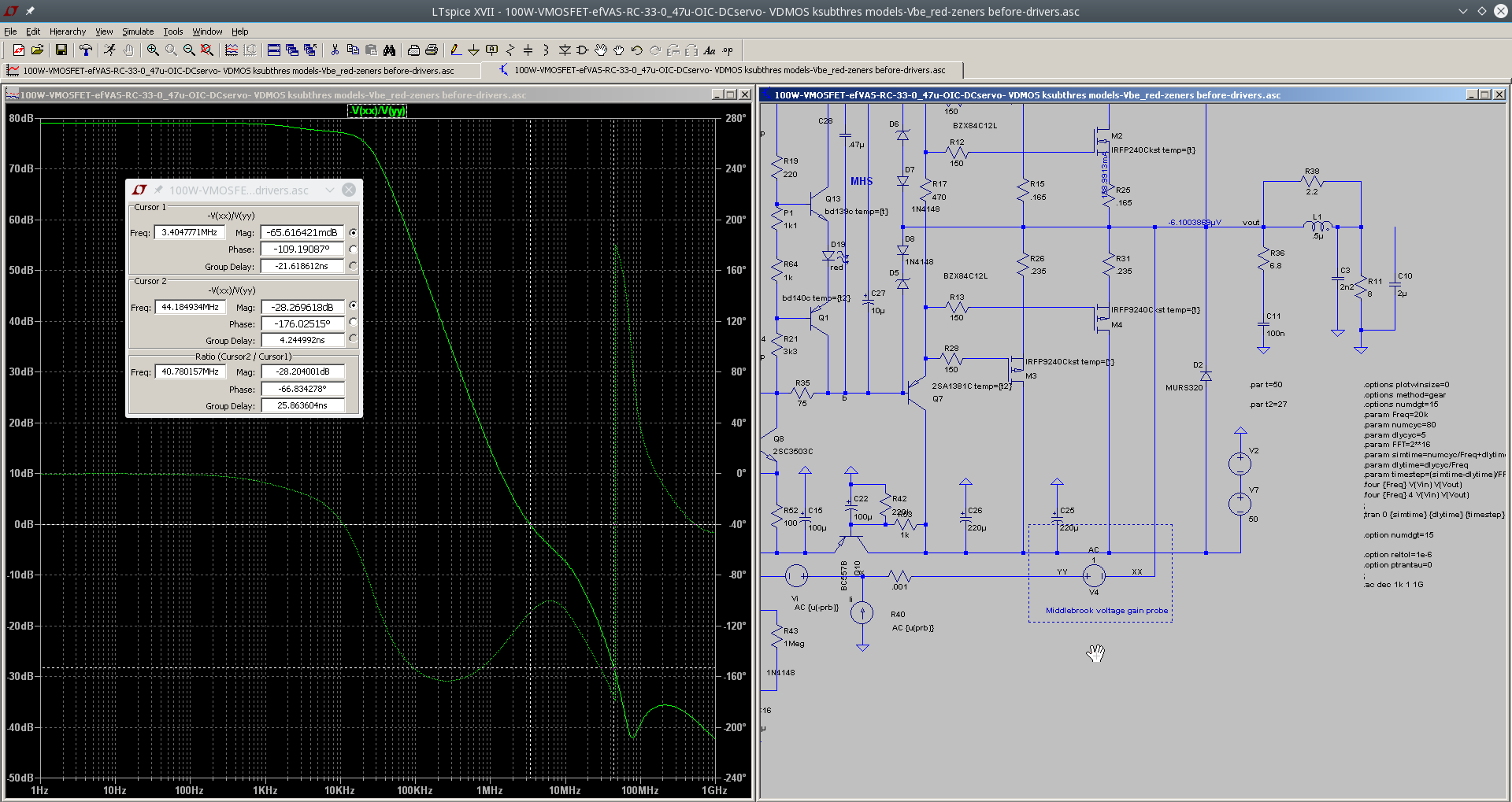

Hi Damir,
could you post your asc file of your last loopgain sim which was broken - from the right most picture?
Thx in advance,
Toni

I think I posted my .asc files for different CFAs in my CFA tread, but it' here again. You have 200W version boards.
BR Damir

Oh, just replace Tian with Middlebrook. I don't use Middlebrook for long time now, and just temporary used it for this demonstration.
Here "Middlebrook" voltage gain probe is working with acceptable results.
BR, Toni

Hi Toni,
I've found very strange thing now. Before, when I used Middlebrook I always used net name (in this case on the left side of the probe) A. You used XX and result is OK with it, so I tried A and got wrong result, I used B wrong result, used C and it's OK. Try this, it's very strange and I don't see explanation at the moment, maybe you can see.
A was OK with my VFA, strange.
Damir
edit: I see it now, I used A and B in other network positions, and that confuse the LTspice.

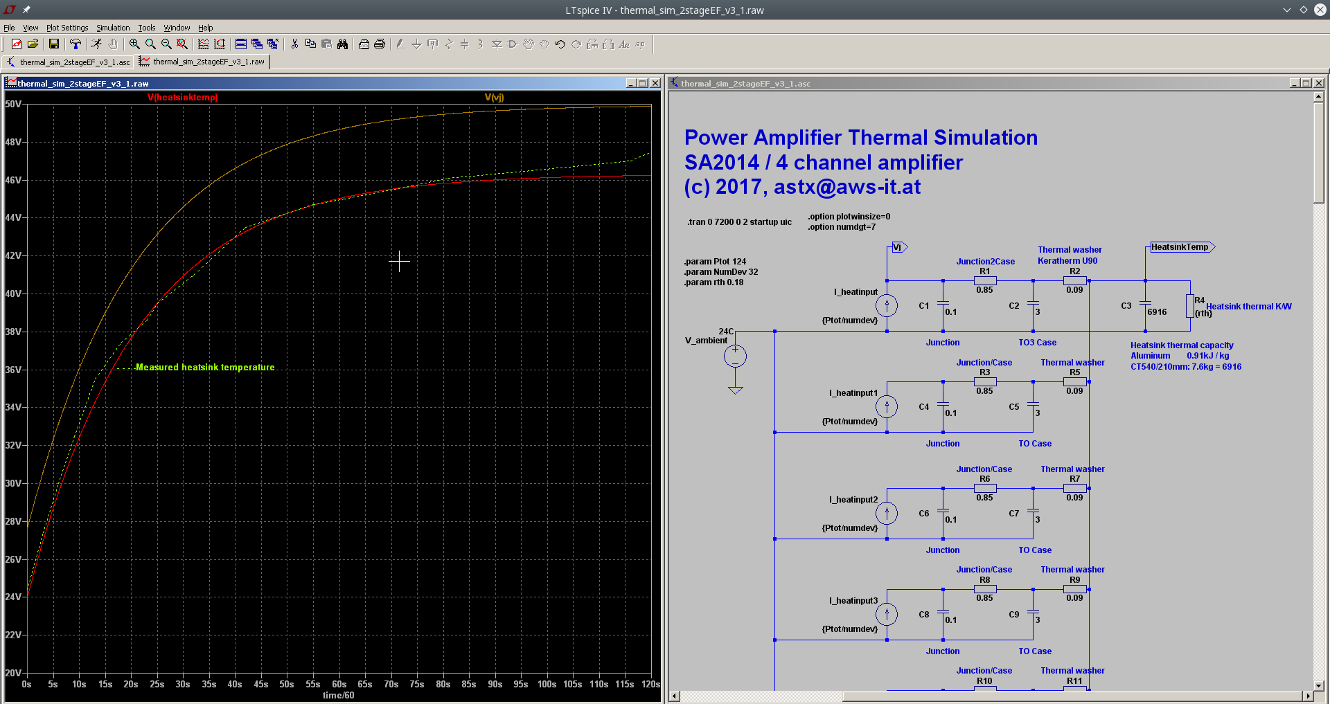

SA2014 heatsink simulation
... a first try to use LTSpice for heatsink simulation.
The calculated values correspond very good to real world measurements (light green lines on picture) done yesterday evening.
X-Axis : minutes (not seconds)
Y-Axis: degree celsius (not volts)
After 2 hours the room gets warmer too - we could add V_ambient sweep here ...
BR, Toni

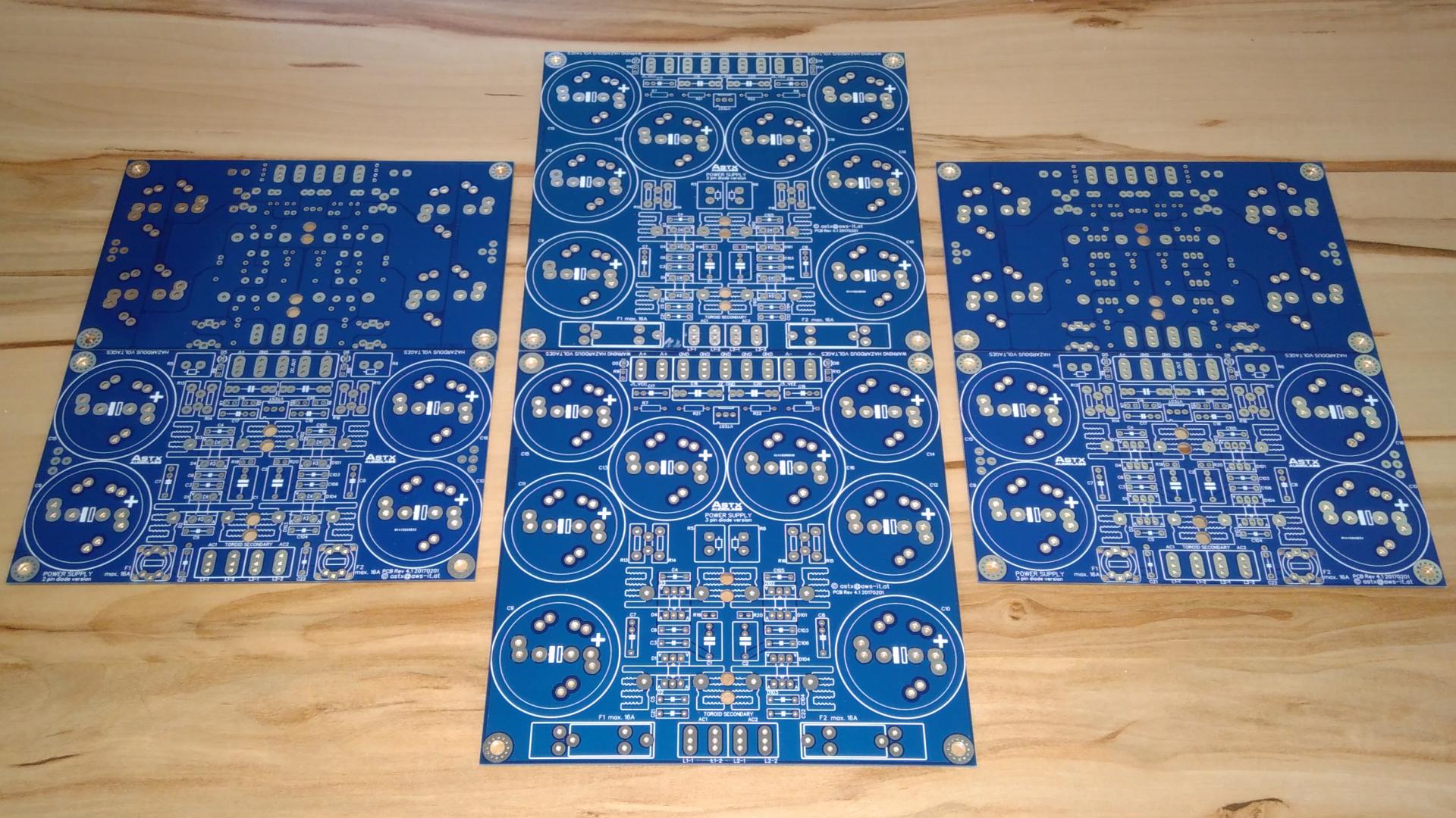

SA2014/SA2015/SA2016 power supply ...
Today got new pcb samples and 5 pin lytics. Unfortunately there is a BIG mistake in all the 5 pin layouts :eek:
Unfortunately I have erroneously mirrored the pcb layout of the 5 pin lytics. Need to rework all 4 pcb types. The ordered samples can still be used for all other kinds of 4 pin and 2 pin lytics. 5 pin can also be used if you cut off pin A ... Grmmml Aaaaaargh :eek::confused::mad::(:rolleyes::):eek::p:D:rolleyes::happy2:
During design phase I always have had a 5 pin lytic in front of me but sometimes one can't see the wood because of so much trees ...
Corrected pcb versions will follow the next days... but first I have to make sure there are no other errors on the pcb.
BR, Toni
