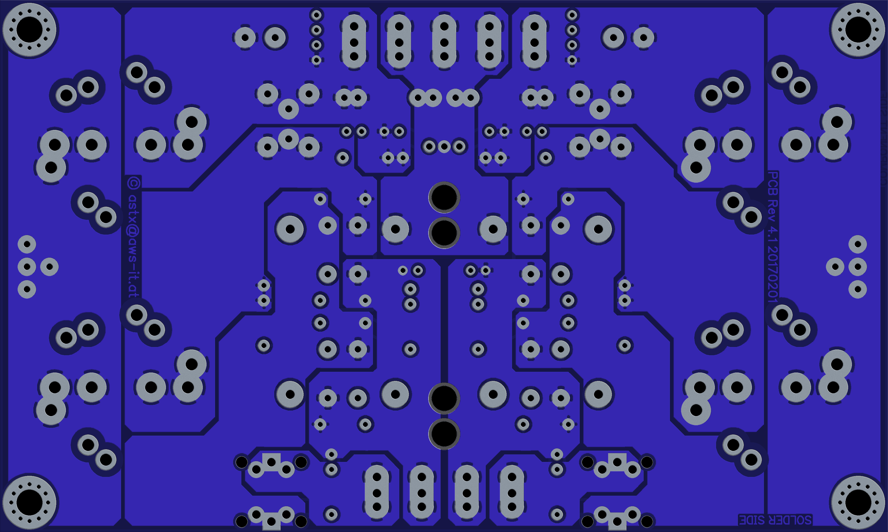

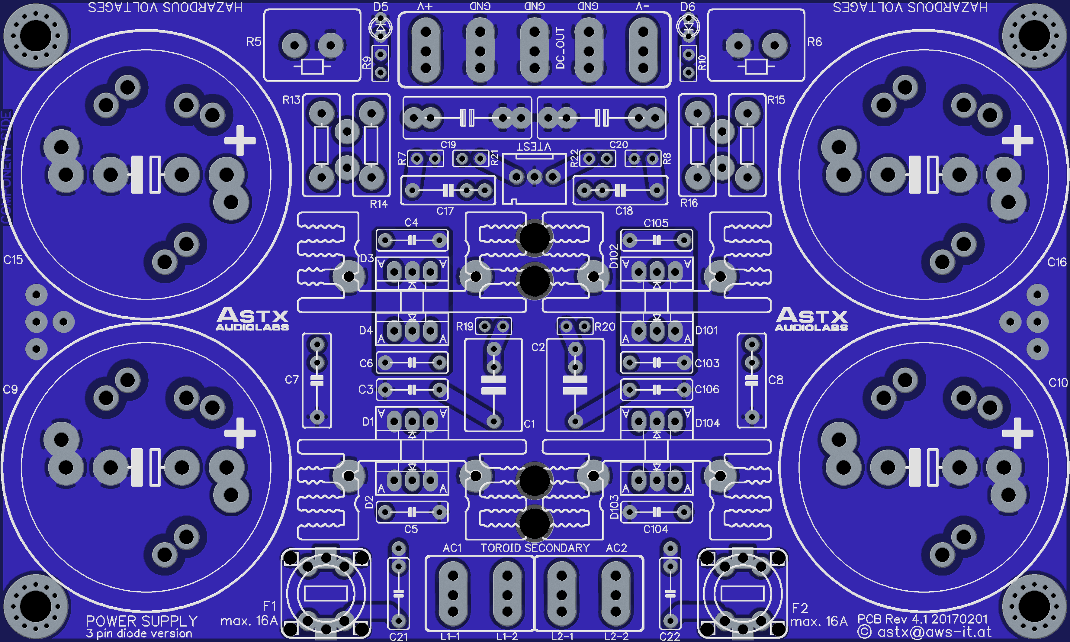

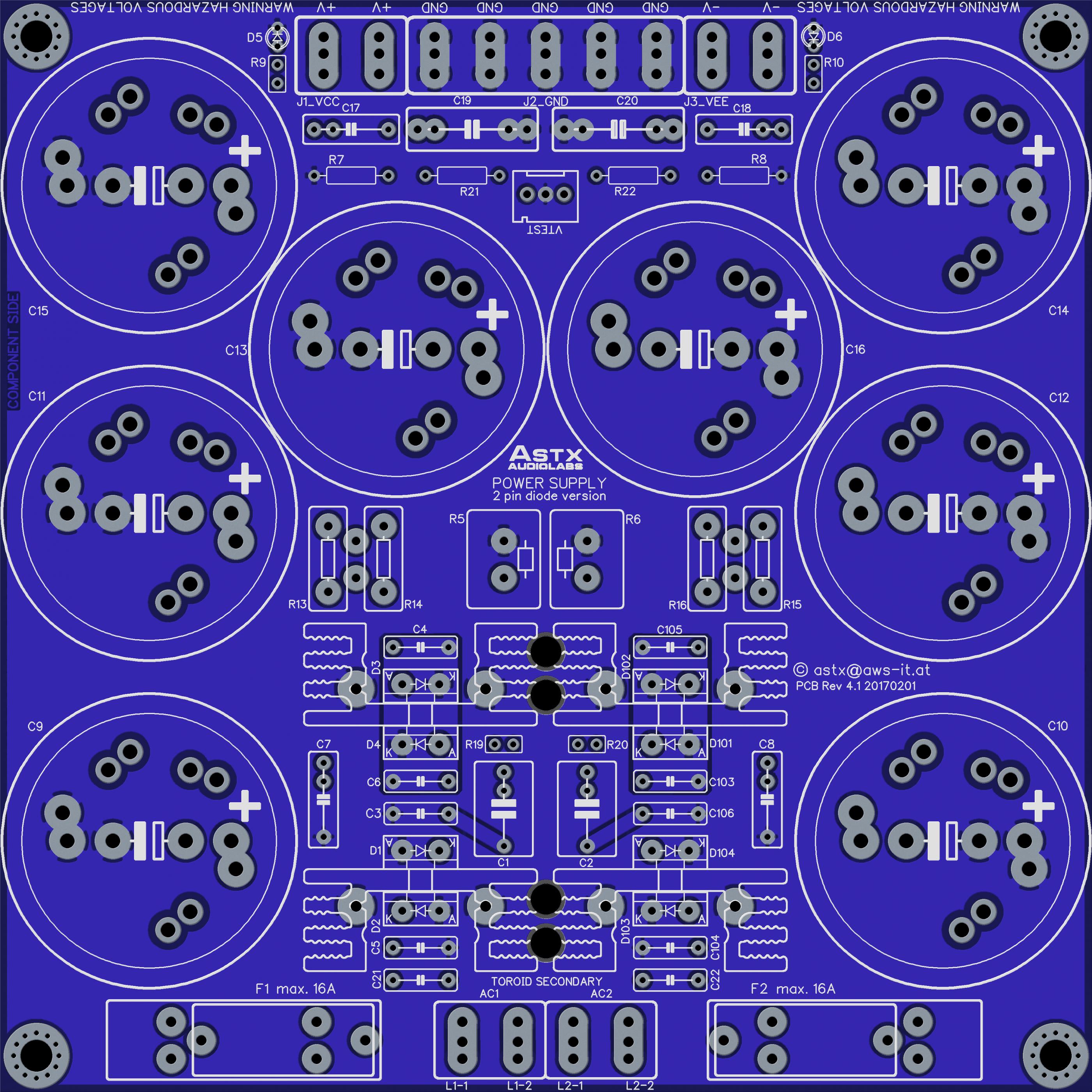

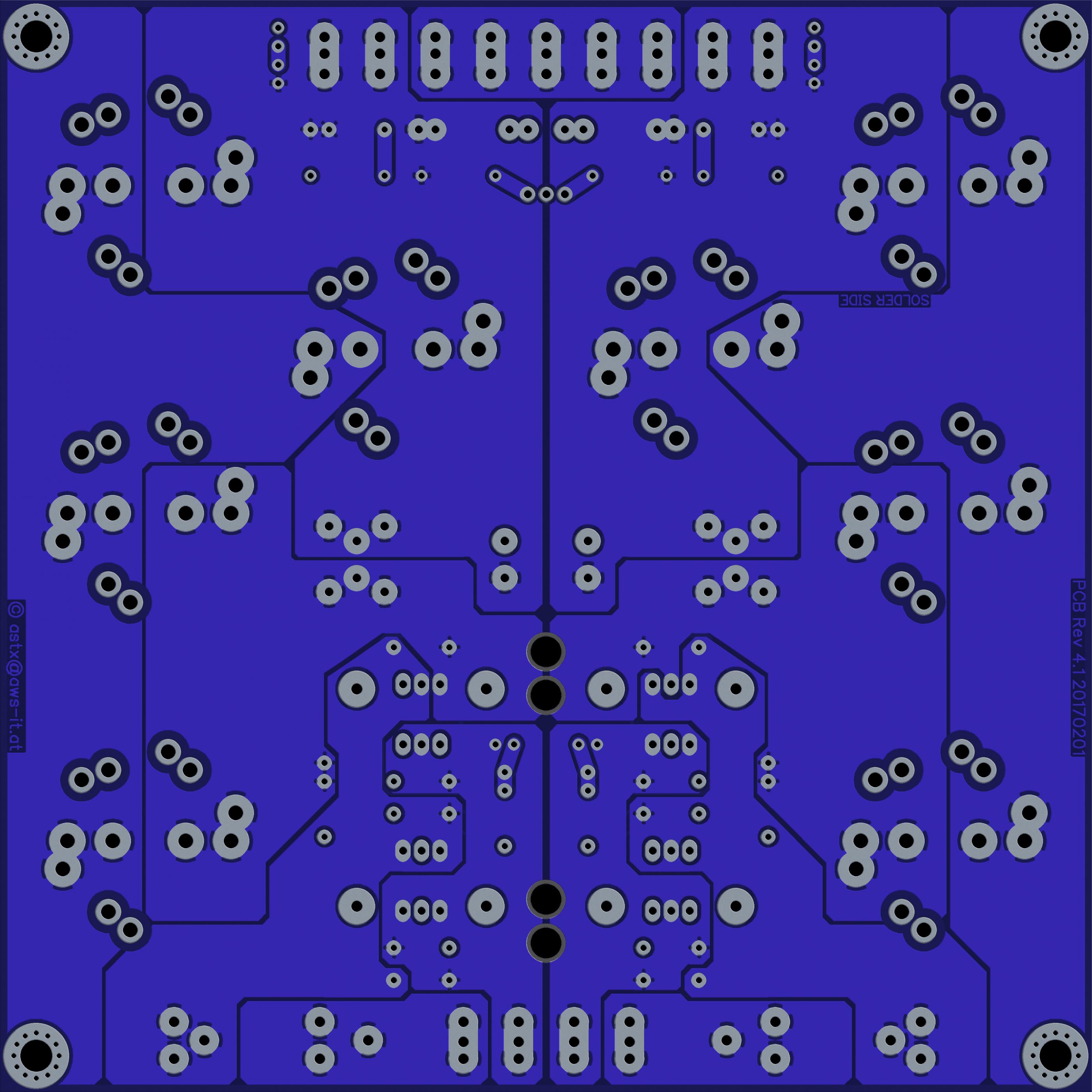

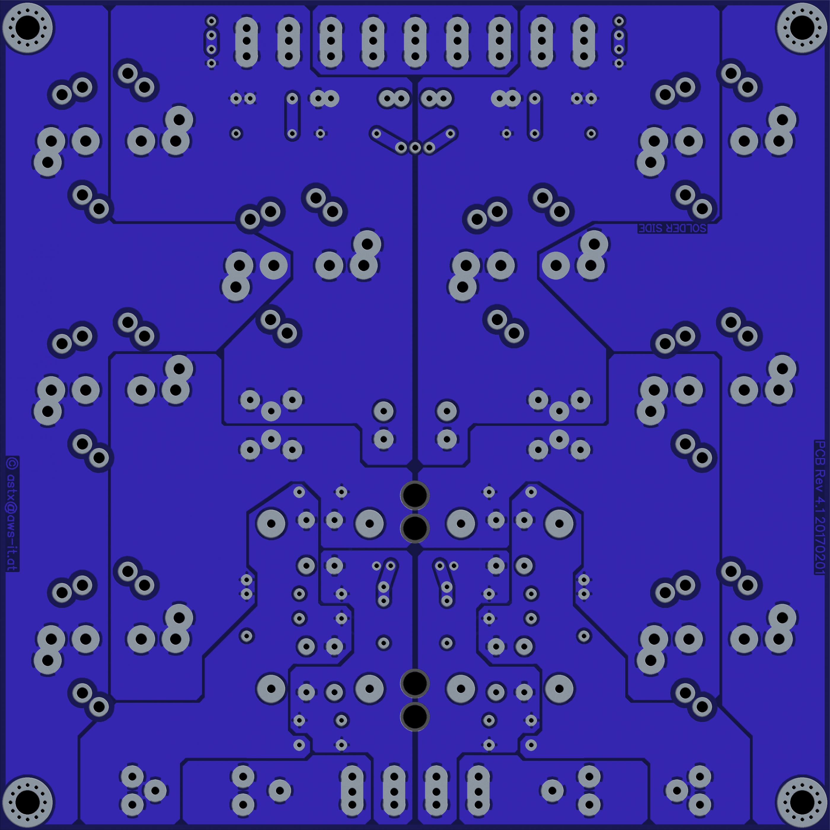

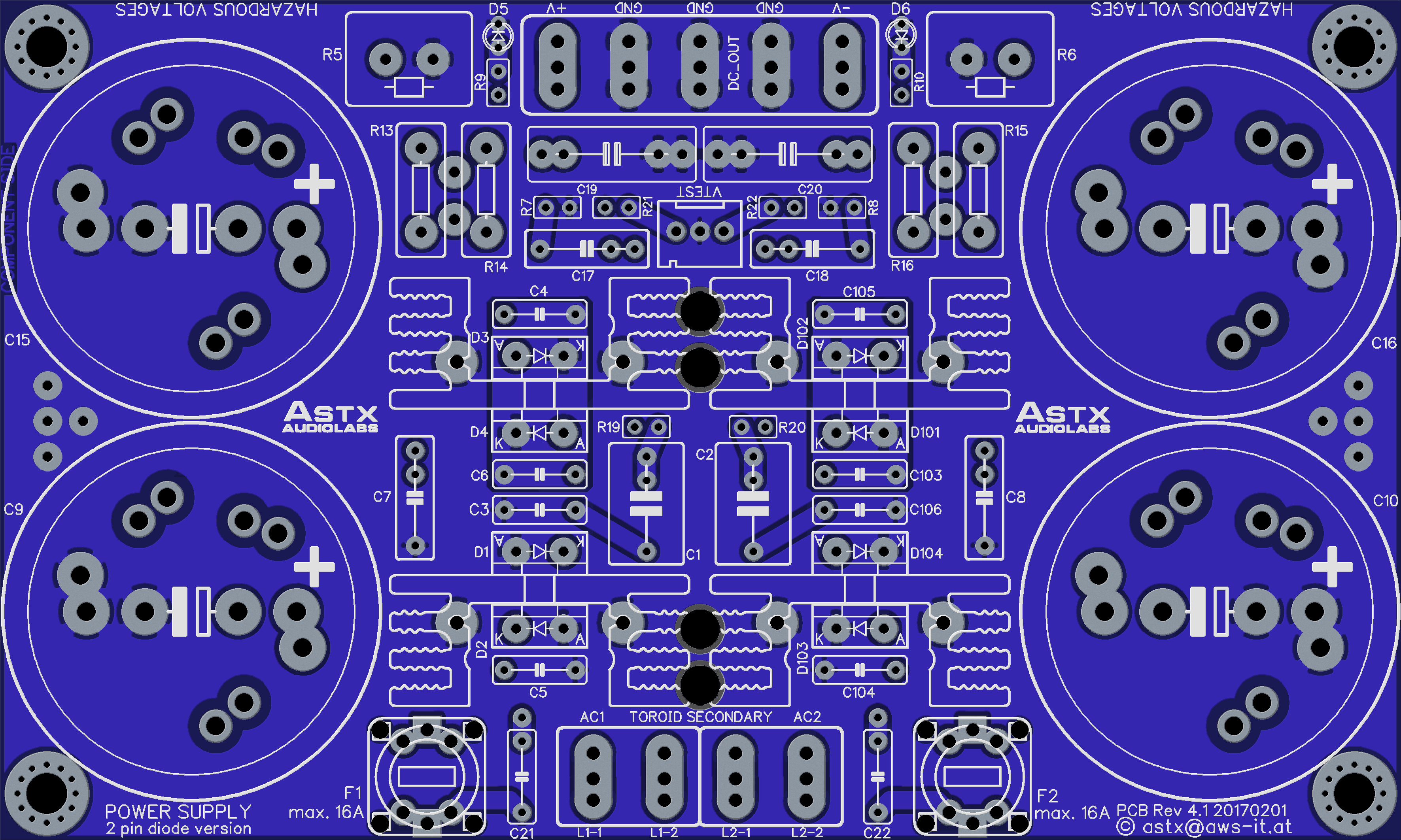

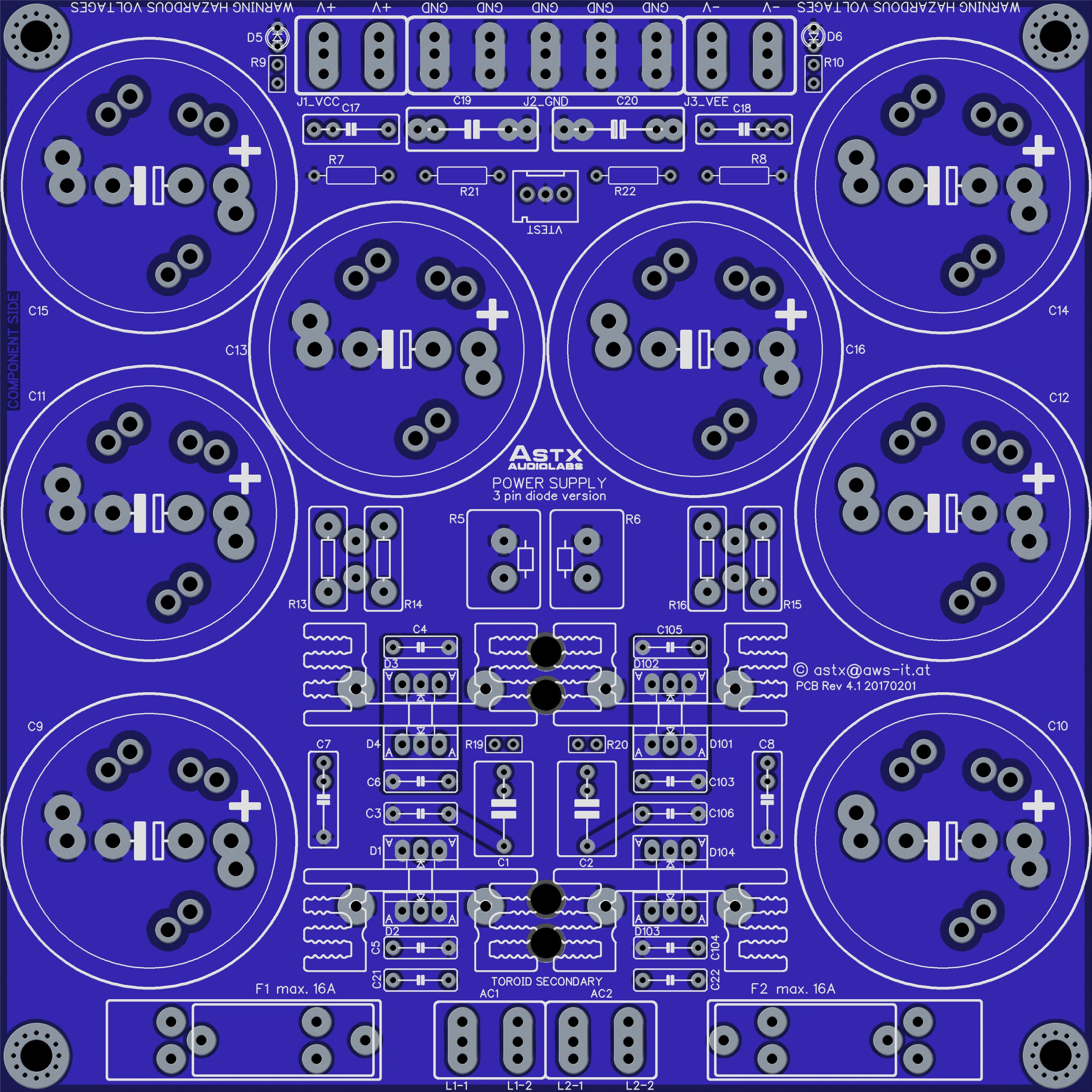

SA2014/SA2015/SA2016 power supply ...
0.45mm clearance/creepage minimum ...
Note: Gerbers are free to use only for non commercial DIY projects.

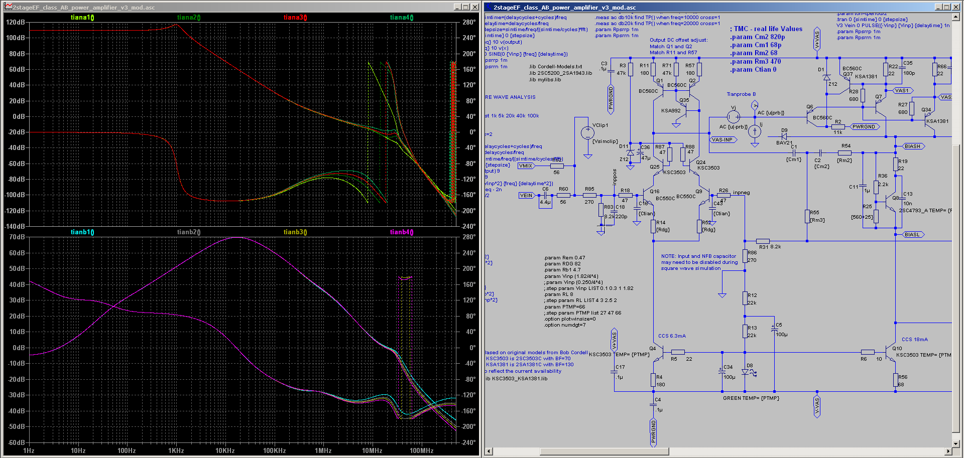

SA2014 IPS reloaded ...
A small mod of the input stage helps to stabilize the CCS currents for a wide temperature range:
Replaced the 2 x 1N4148 for the CCS sources by one green LED (D1=LED; D2=wire).
R7=180R and R27=68R emitter resistors at CCS sources instead of
R7=82R and R27=27R
Note: part numbers refer to schematic post 1145.
Attached a stability simulation result.

Hi Toni. I was curious as to how you selected the size of the base stopper resistors. From SA2014 to SA2015 some went from 47R to 22R even with the same transistors. I thought base stoppers resistor sizing essentially transistor dependent.
Also, have you ever looked at how dependent output quality is on the 12V bias supply for the differential pair? (I should have a fiddle with your .asc myself...)

How do we use the .txt to get the various simulations to run?
... rename it to 4tian.plt, run the simulation and load the "plt"-file in graph viewer ...A sophisticated .asc

Perhaps first ask why use the Tian probe method for loop gain/stability assessment - I've never seen anyone on the LTspice forums recommend this method in LTspice.
I thought you had to look at the open loop to see the feedback ratios.Perhaps first ask why use the Tian probe method for loop gain/stability assessment - I've never seen anyone on the LTspice forums recommend this method in LTspice.
The "Tian probe" is one method of plotting loop gain for phase and gain margin assessment. Bob Cordell provides another 'method' of breaking the loop. The method of choice for the LTspice forum gurus (and Linear Technologies in their tutorials) is even simpler to implement. I once asked Helmut Sennewald (the keeper of the Yahoo LTspice forum) why "their" method was different from Cordell's.** He aligned both versions of the analysis for the regulator circuit I provided. Annoyingly I lost the analysis on my local computer and I suspect the circuits are long-gone from the LTspice forum's temp files section. I've not seen the Tian probe method discussed outside of these forums - not that this means anything, it merely prompts the question I posed above.
EDIT: ** if I recall correctly the differences in the plots between the two methods were well below the areas of interest and it was not necessary to break the loop with a 1GN inductor and inject via a 1GF cap.
I have choosen the values in dependence of base current, simulation results (square wave), examples and gut feeling
12V bias: AFAIR yes. The results are shown in my schematics. The 12V Bias is fixed in SA2014 and floats with input signal in SA2015/SA2016. The difference is minimal and maybe not worth the extra transistor.
BR, Toni
Thanks. Interesting as I understood the base stopper was used to combat parasitics not often modelled.
Ah, I was wondering also why Q1 was added in SA2015. I hadn't appreciated that it might be better to have the bias float with the signal and was more focused on whether a better regulator than a Zener would be beneficial. I'll have to chew on why...
Thanks for the (here well known) links.
I can't exactly remember what the decision was to use the Tian probe. Maybe because the Middlebrook method wasn't direction independent and the GFT probe needed 3 simulation runs instead of 2 simulation runs compared to Tian's method. As you know I found a method for a simple parameter stepping during using of the tian which makes it more versatile. 😉
BR, Toni
