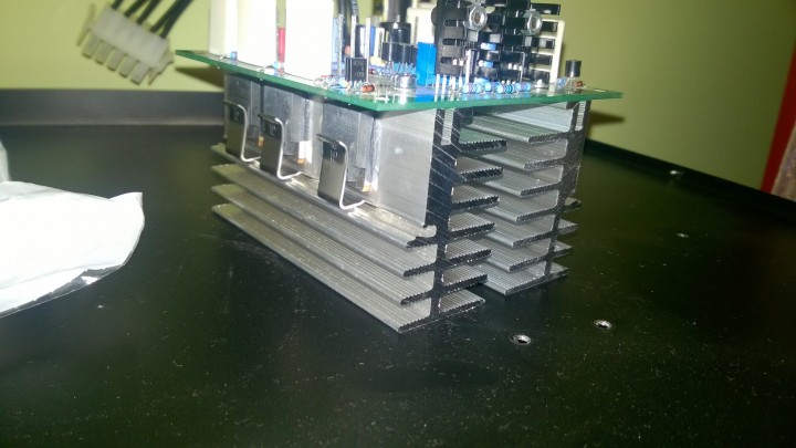

BTW: have tested clip mount using SK481, MBR40250 and a THFU1. Very hard to insert the clip, even harder to remove it. For the SK489 variant we would need 8 clips ... 😱
BR, Toni
I use clip mounted output devices, and I agree. It's hard to mount, and You need to take it into consideration in the planning phase. I use some tools to remove the force from the PCB.
Sajti
I use some tools to remove the force from the PCB. ...
Special tools or just standard tools?
This is special, as it was planned especially for SK514, and the pcb I use. I put picture about the pcb above.
Sajti
A nice variant for (forced) cooling of small power amplifiers.😉
Not very small power amplifier, as it gives about 150W/8ohms, and 250W/4ohms 🙂 As I use no insulators for the output devices I can enable the heatsink temperature up to 100C.
Sajti
The power de-rating for elevated Tc must be pretty severe !..............the output devices I can enable the heatsink temperature up to 100C..............

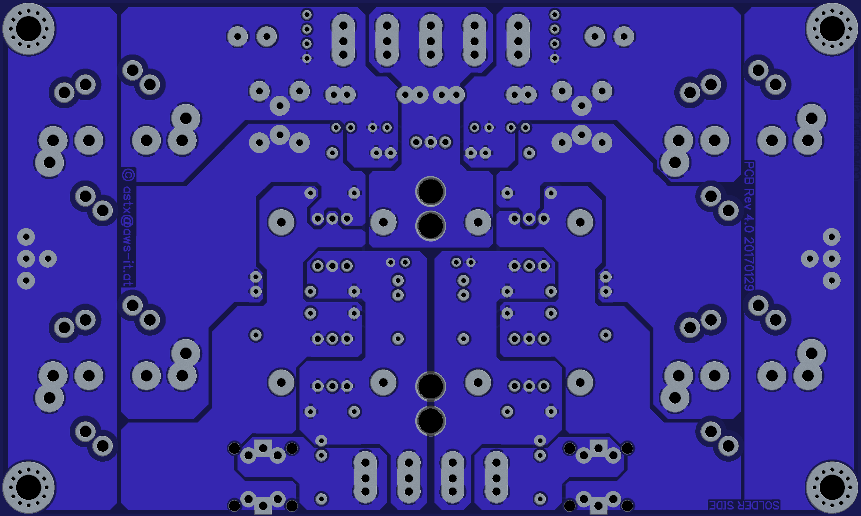

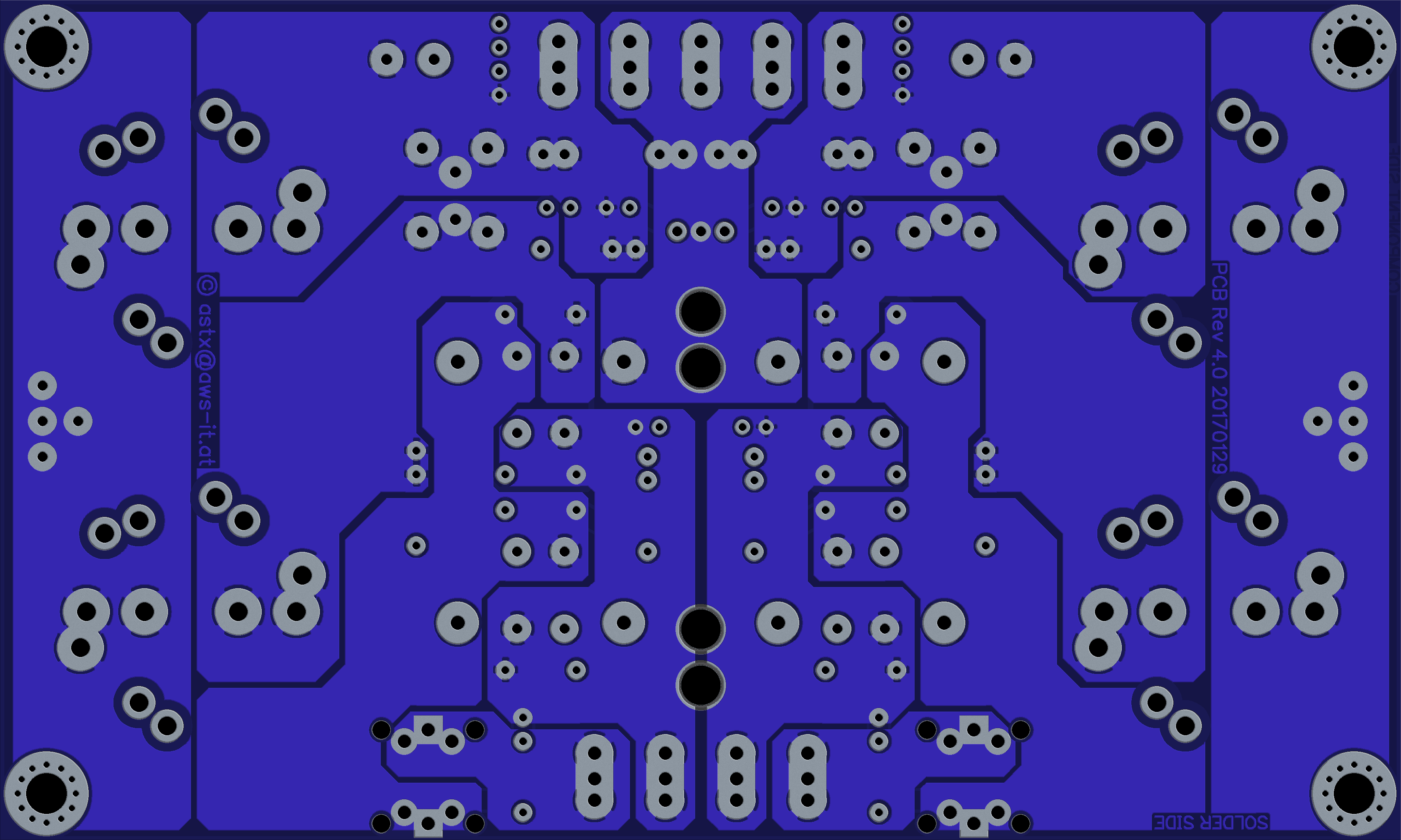

SA2014/SA2015/SA2016 power supply ...
Final 2 pin diode variant (MBR40250G) variant ...
IMHO: ready for fab.
Note: Schematics and Gerbers are free to use only for non commercial DIY projects.
WARNING: the circuit is using and providing very high AC and DC voltages and is therefore very dangerous and can be lethal. I am not responsible for any costs, damage and/or injury using these schematics. Do not use this schematics if you do not have the necessary experience and knowledge.
BR, Toni
BR, Toni

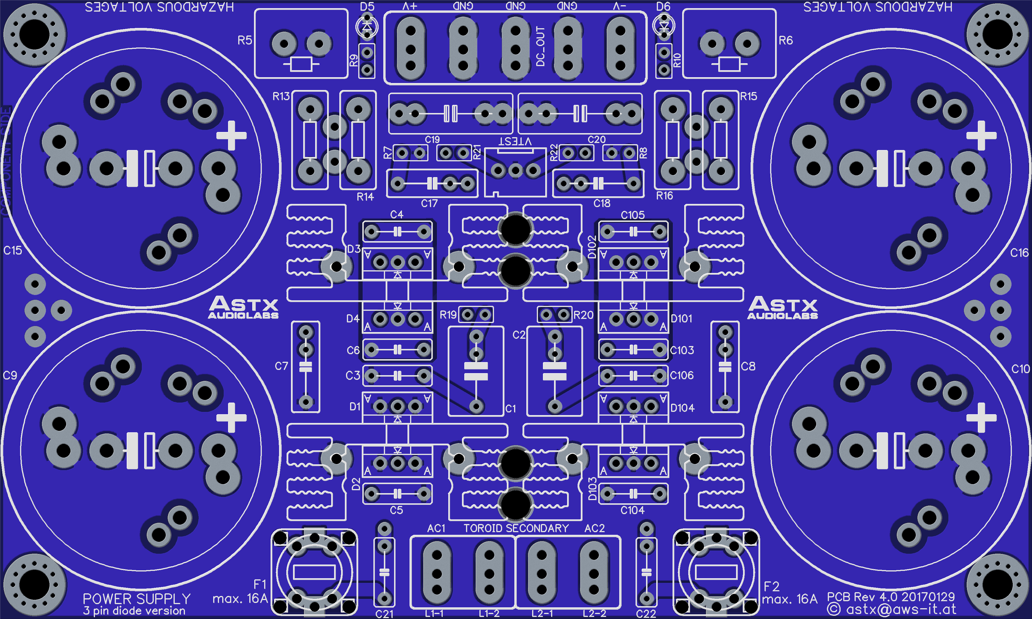

Final 3 pin diode variant (MBR40250TG) variant ...
BR, Toni
BR, Toni
Not really. The case to sink thermal resistance is much less, than with insulator. So the junction temperature is not higher, comparing to the insulated solution, with 80 degree heatsink.
Sajti
Not really. The case to sink thermal resistance is much less, than with insulator. So the junction temperature is not higher, comparing to the insulated solution, with 80 degree heatsink....
During design I go for max. 55 - 60 degree heatsink temperature - even for summer - so you can touch it with your fingers ...
Using modern keratherm pads you do not have a big thermal loss.
IMHO: the power derating is galactical if you go for 100degree Tc
BR, Toni
I do not believe you.Not really. The case to sink thermal resistance is much less, than with insulator. So the junction temperature is not higher, comparing to the insulated solution, with 80 degree heatsink.
Sajti
20C degrees difference by omitting the insulator ! What were you proposing to use, a sheet of plywood?
What is the power de-rating factor for Tc when heatsink is @ 80°C?
BR, Toni
The maximum dissipation of each device is about 25W with 4 ohms load. The junction to case thermal resistance is 0.78K/W, and case to sink is 0.1K/W. This is totally 0.9K/W. This means 122.5C maximum junction temperature. The 2SC6145A is rated to 30W at Tj=125C.
In normal music apllication the fan is rarely speed up to the maximum, which means 70C heatsink temperature.
Sajti
OK - you design your cooling with respect to the audio crest factor.😎
I try to design it - even if many think this is nonsense - for continuous output power. 😎 too - isn't it?
BR, Toni
BR, Toni
BR, Toni
Yeah, that is overdesigned, but safe 🙂

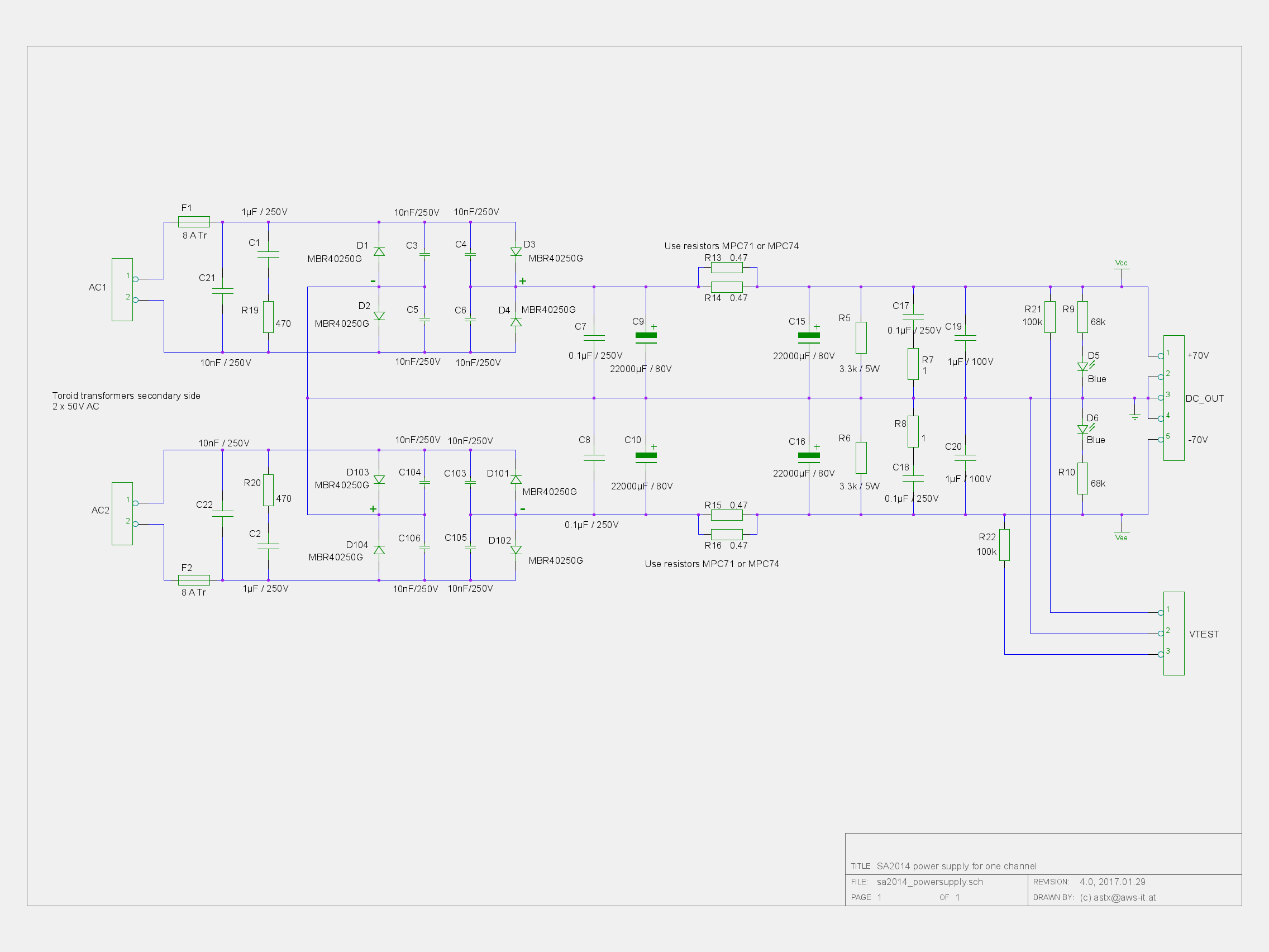

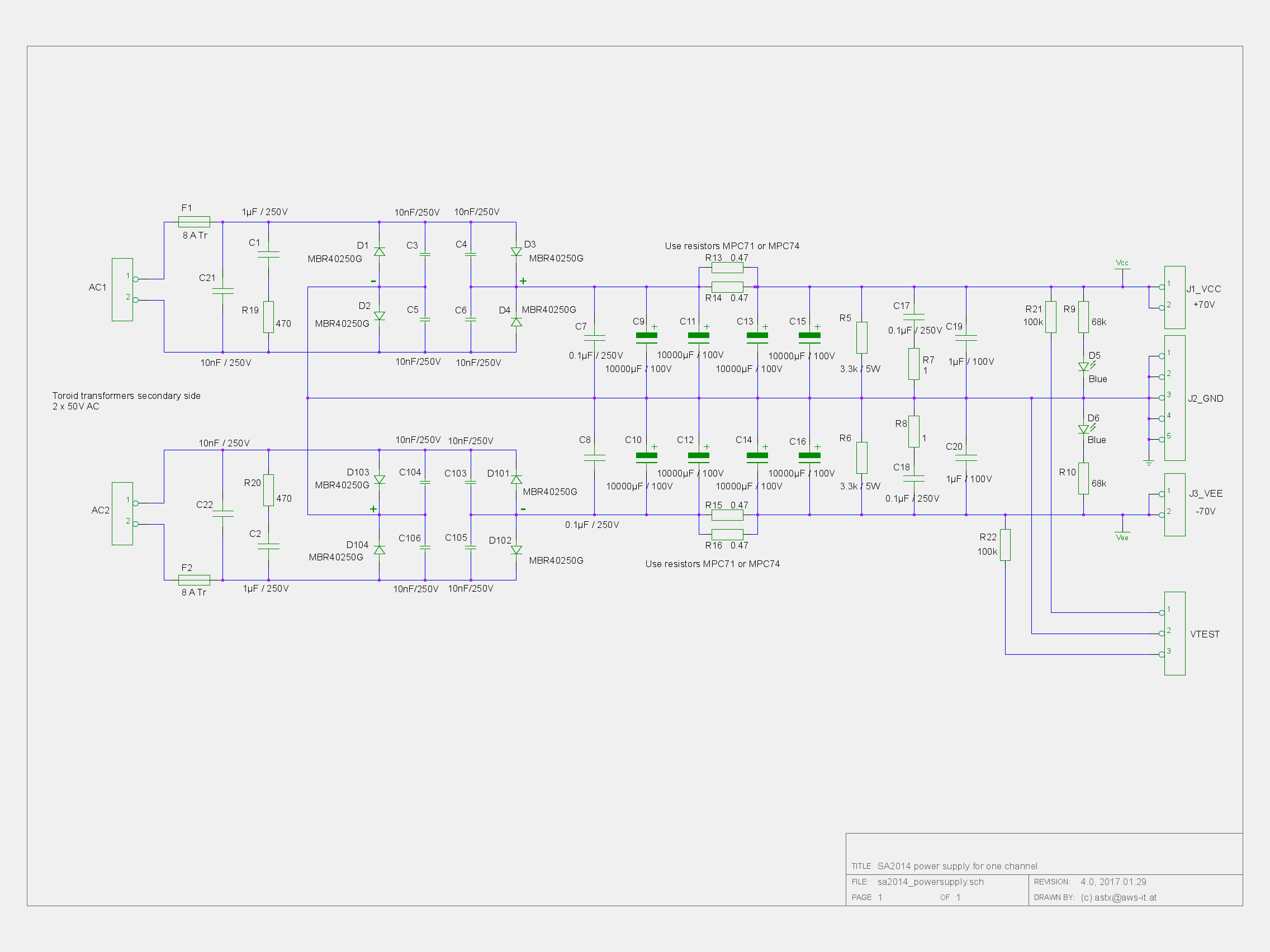

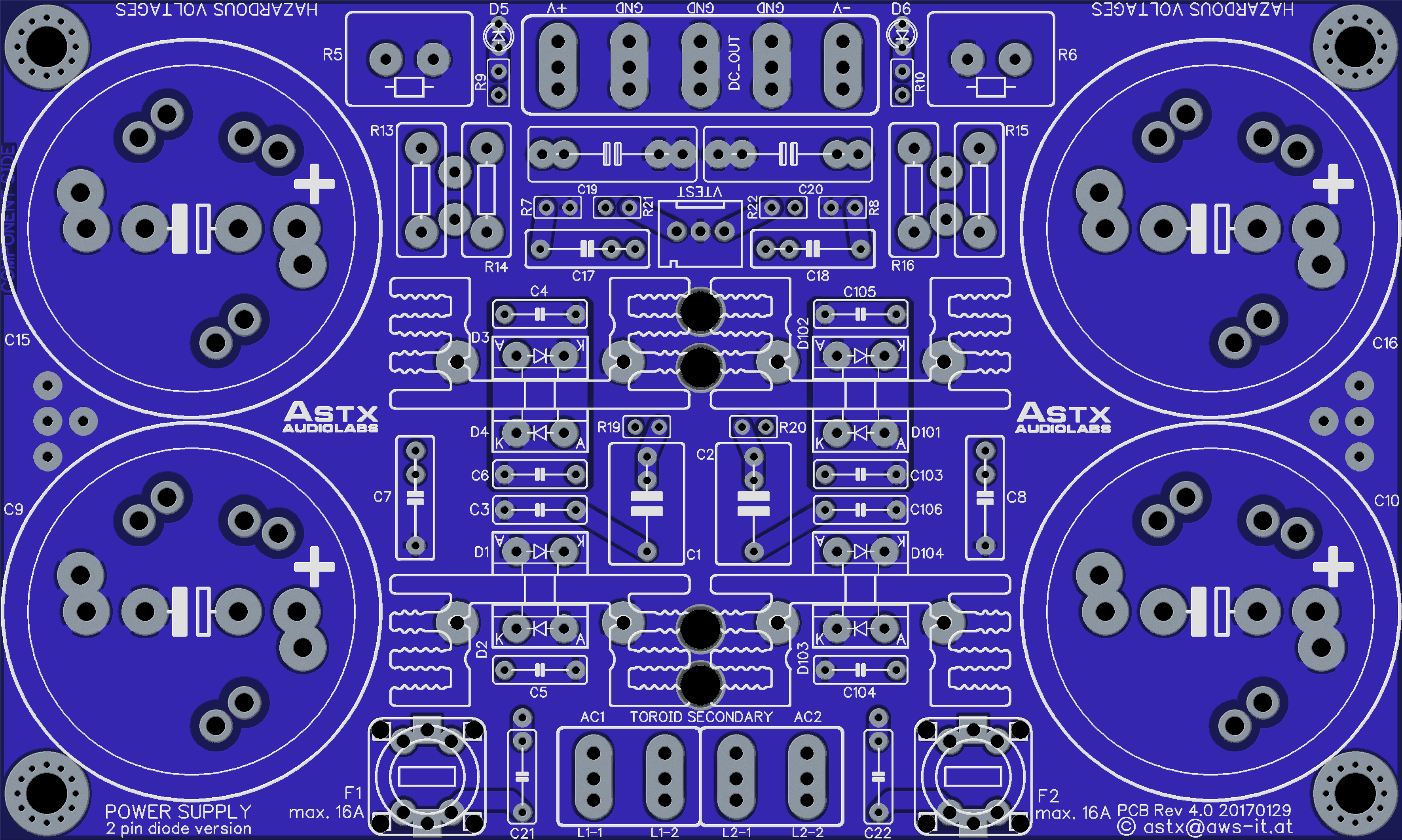

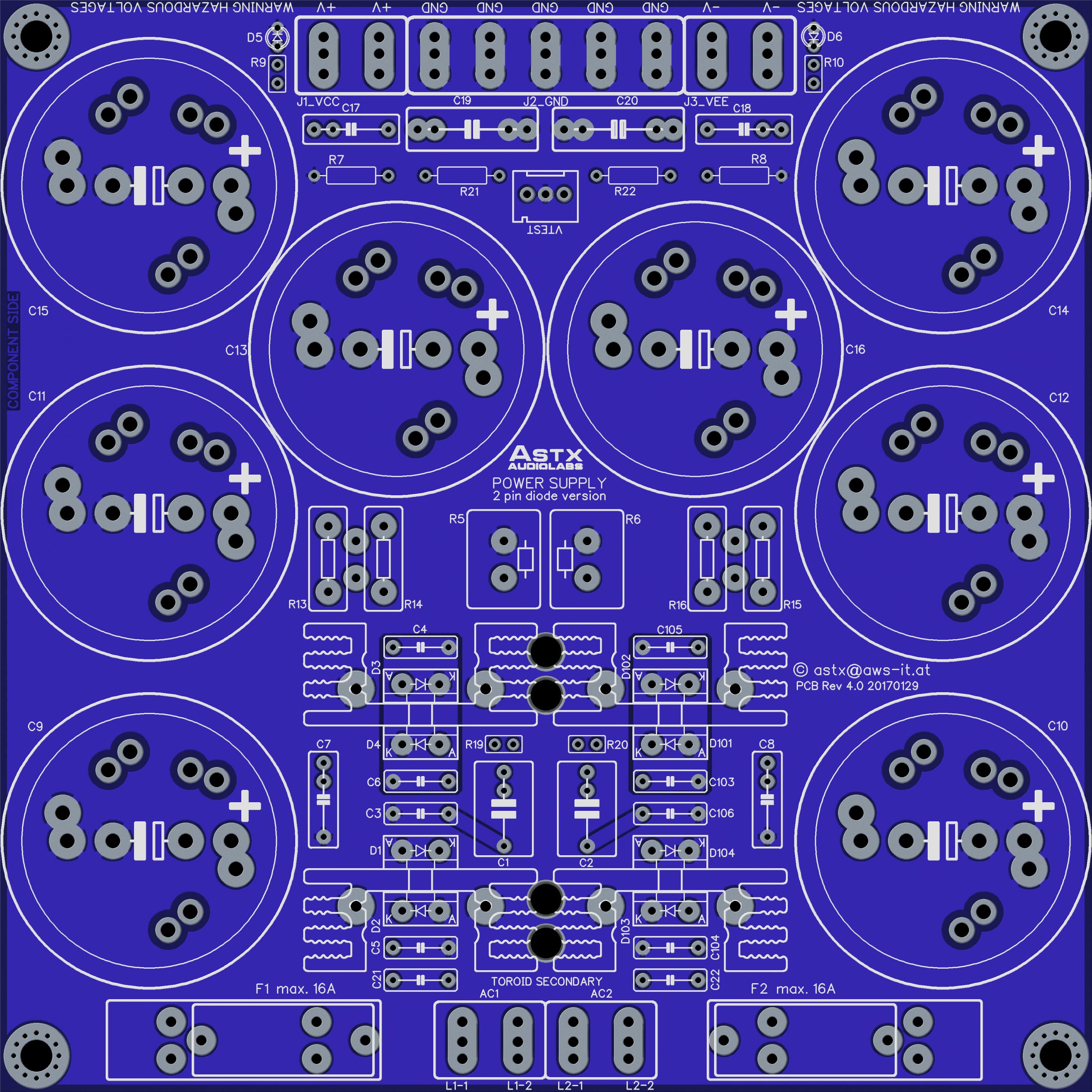

SA2014 power supply reloaded ...
BR, Toni
BR, Toni
