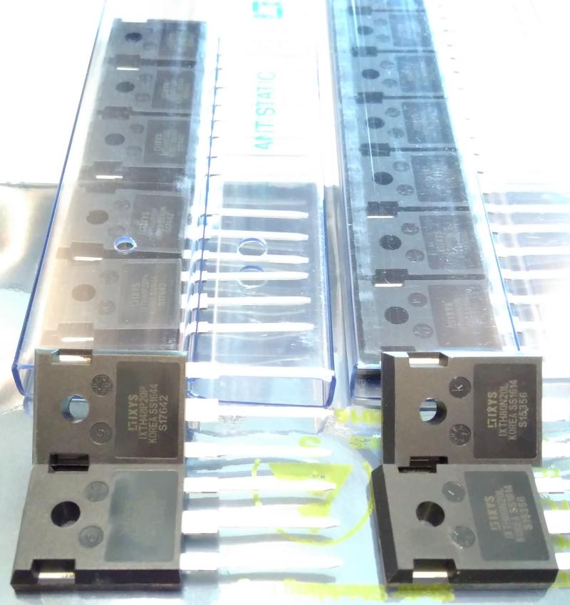

P.S.: spice models wanted for IXYS vertical mosfets:
- IXTH80N20L (200V, 80A, 0.032Rdson)
- IXTH48P20P (200V, 48A, 0.085Rdson)
OK, you took a leap and ordered some😉 the least I can do is develop some models based on the specification data.
Maybe we can tune it later based on actual measurements.
It will take a little while, I need to study a bit, when are they due?

when are they due?
IXYS models -
Parts should be available upcoming weekend...😉
BR, Toni
IXYS models -!..
I'm on it, not so hard after all, well before the weekend.
