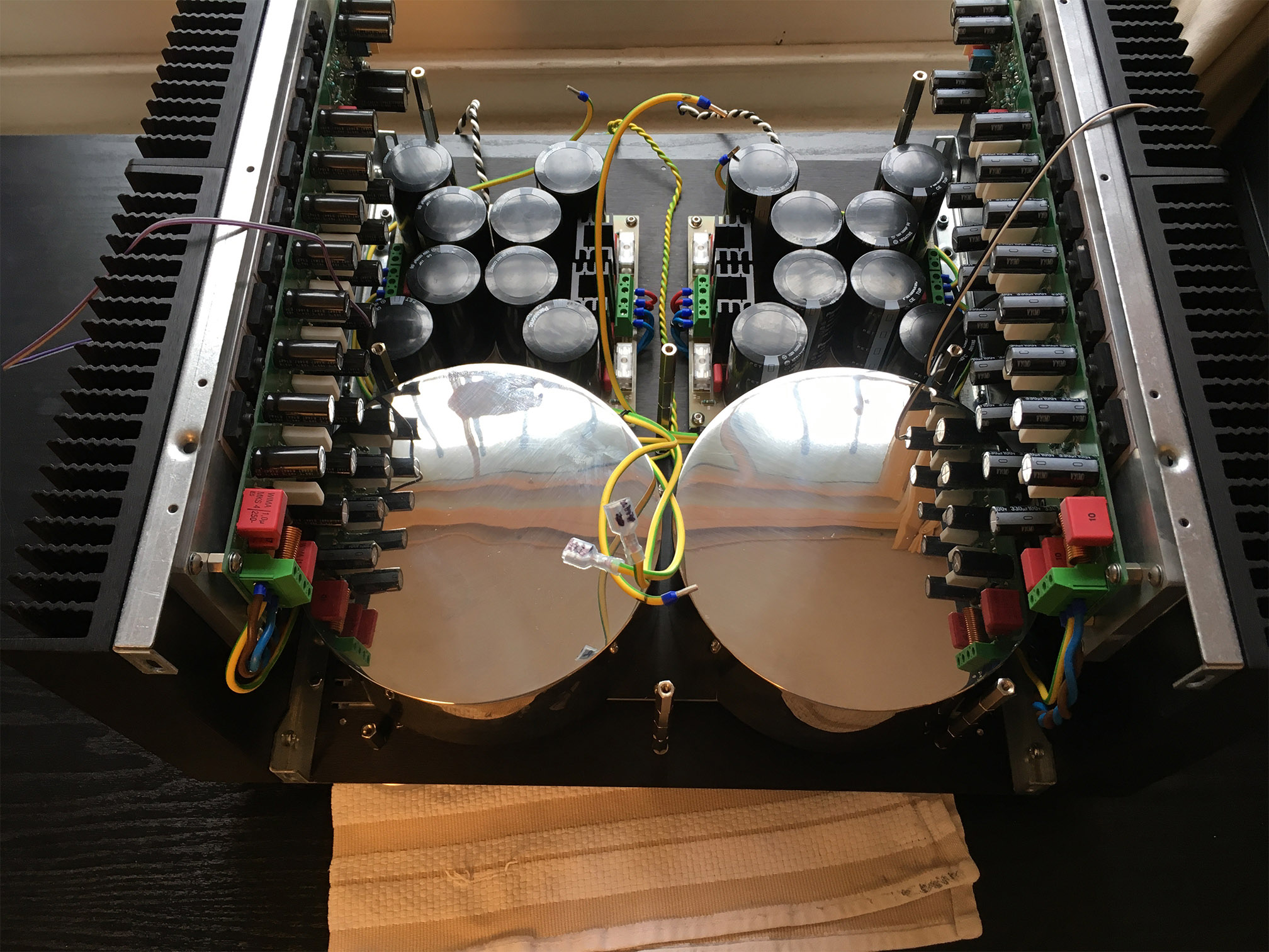

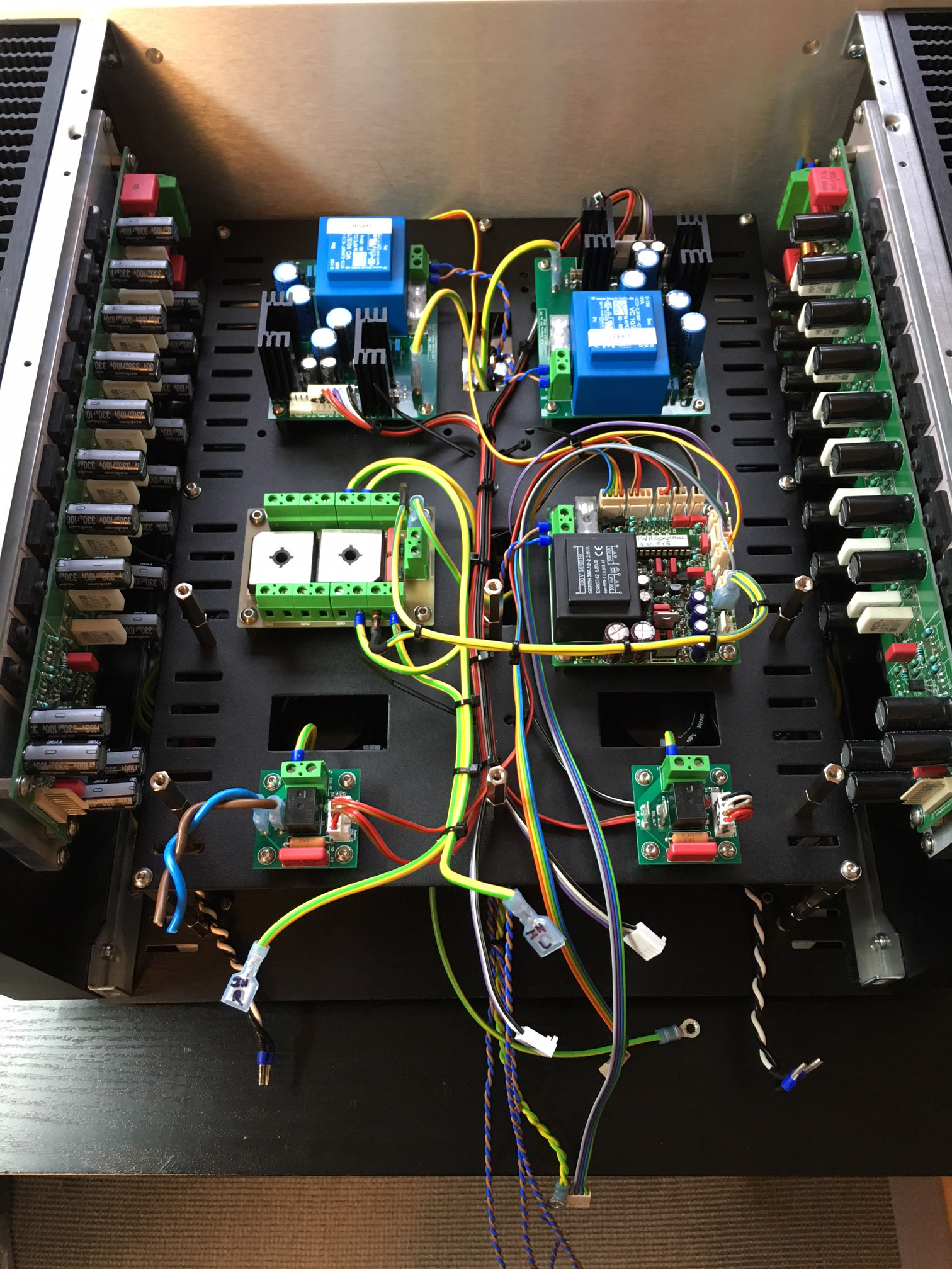

Here is the new SMD Main Control Unit wired up. (The IPS/VAS boards sit on a shelf above the 2-channel star/silent ground board - removed for the pic.) I now have just one "aux" PSU powering the MCU, input boards, output relays and inrush relays. Previously there were three PSUs (1 aux psu per channel and the MCU itself). The high performance PSU board installed now is complete overkill for this application, but I had it to hand and perhaps it helps the BAL-SE input boards perform better.
I also added drain wires to chassis from the soft iron tubes through which output wires run.
(The aux PSU toroid is shielded and potted, and it sits on an iron base plate. Should be better than 3 unshielded PCB transformers. At one point I had made the shelf they all sat on, with 10mm spacers, in powder coated iron with a view that it would shield the twin main PSU toroids below. However, I could clip leads to this shelf and observe in ARTA the increase in radiated EMI as each of these PCB transformers powered up.)
EDIT: I added an earlier pic of the previous setup
Awesome! Absolutely awesome!
I'm sure you will get the additional noise headroom as expected!

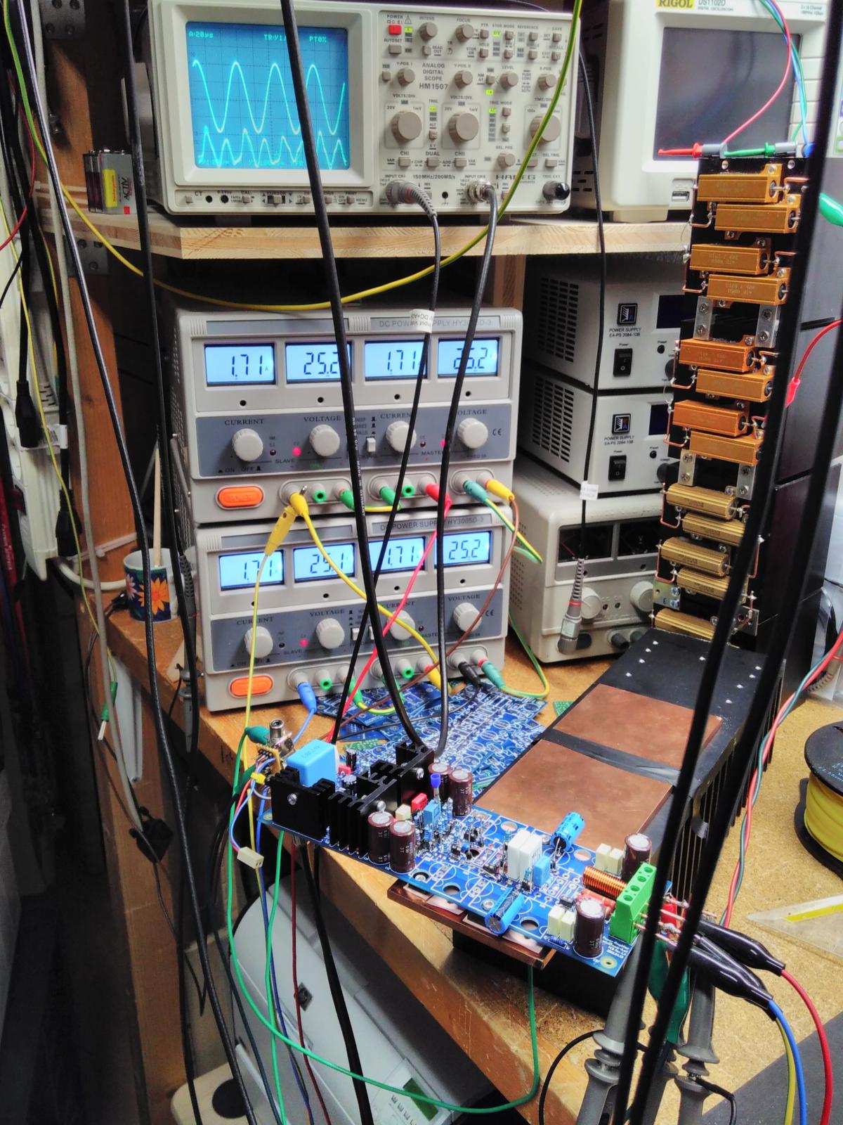

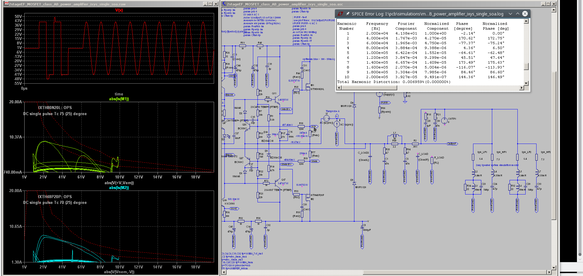

SA2015: using vertical mosfets IXTH80N20L and IXTH48P20P
Test sample using 1 pair of IXTH80N20L and IXTH48P20P up und running!
Quick THD+N tests (80k bw) with SOA circuit in situ:
Rgate 15R. No oscillations detected. No signs of instability at +/-50V supply.
More tests and tuning data will follow as soon as I have repaired my test sample (a f...y short circuit during a f...y screw driver accident during tests 😱)
Dave Zan's simulation models seems to match pretty good with the devices in reality. Bias settings in reality as expected from spice design!
Bias temperature stability similar to SA2015 IRFP240/IRFP9240.
Have fun,
Toni
- THD+N 20k@100W@8R: 0.0035%
- THD+N 20k@200W@4R: 0.0042%
Have fun,
Toni
(The aux PSU toroid is shielded and potted, and it sits on an iron base plate...
The whole installation looks nice, especially the shielded toroid, where is that from?

Dave Zan's simulation models seems to match...reality
And that's nice too😉
Some of the parameters of a FET can vary quite a bit from nominal datasheet values, which makes it difficult to be accurate without some adjustments to match measured results.
So this is excellent news.
Best wishes
David
Thanks! I purchase my toroids from https://sklep.toroidy.pl/en_US/c/Toroidal-transformers-SUPREME-AUDIO-GRADE-V2/99
The service and pricing is excellent. I have had a number of custom ones made as well. They make each to order anyway.
There are two big guys underneath that little one...
After repair - IXTH48P20P has past away with a short circuit between drain/source ~ 200 mOhm - I started some additional tests.
SOA circuit disabled, +/-40V, VAS-diode removed, Bias 150mA
THD+N 20k@60W@8R: 0.0018% (80k bw)
- Rgate 15R
- no oscillations detected
- no signs of instability at +/-40V supply.
- small signal square wave: nearly same as previous amplifiers (SA2014/SA2015 and SA2016 variants).
- slew rate 100V/µs
- 131 µV - no bw limit
- 56 µV - 80k bw
- 31 µV - 20k bw
- 23 µV - A-w
Bias circuit/stability: thermal runaway starts above 650mA bias. Above 650mA this may destroy your MOSFET very quickly! This behaviour seems to be exponentially.
BR, Toni
