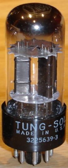

Another question I have is about the dual triode. Obviously they work, but when electrons flow from the cathode(s). how do they "go" to the correct plate?
Most twin triodes are 2 separate systems, that share the base, bottle, and heater connections. Notice that each of the plates surrounds the grid and cathode.
Construction
I get it, so really the plate in the case shown is really a oval containing sleeve for the cathode, then the grid must also then be a smaller containing sleeve with the cathode being inside of both.
That makes sense.
Thank you sir.
Ron

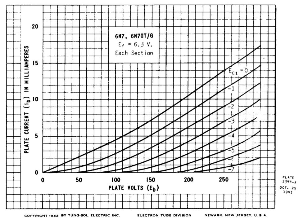

Yes. but acc. to datas for 6N7 mu=35, Ri=11K per section.
One section is just enough?
with sectopns in parallel the same thing about Cdyn is present, this time for input tube, but double. 🙂
And somehow looking at the datas, this tube is main for +Ug region?
But it could set also in -Ug region, at the first site, it is linear with -2V Ug.
that giving room for 4V p-p input signal... 🙂
One section isn't enough. Have a look at the curves of each section again at Va=150. Mu/gm.
35/.0015=23,000
The 11k=Ri is for both sections in parallel.
