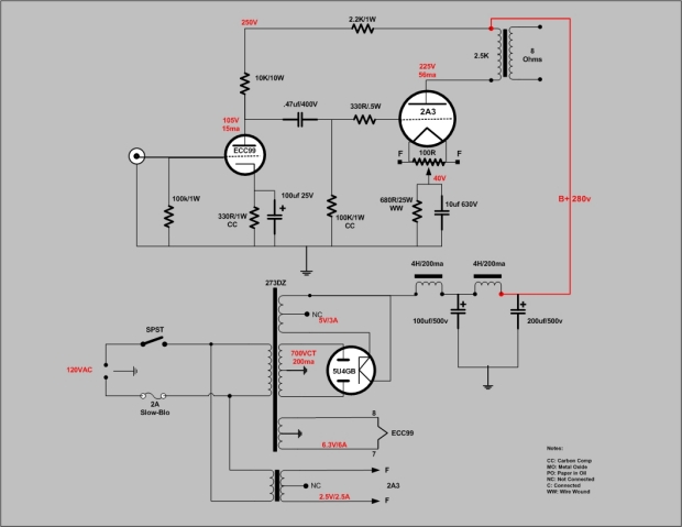

Here is another schematic with Power supply using a choke IP.
The nice thing about the ECC99 driver its higher GM and Low Rp and for this application it's ideal.I don't know if you are gunho on octals but the ECC99 and the 6H30 and the 5687 are all marvels IMHO.

I hear you on that..PP has much lower 2nd order harmonic distortion and it's my favorite.This last pair of SET amps I got I traded for a pair of Dyna Mk3s I upgraded with VTA boards using 12Bh7s and a partial film cap supply..The amps I got are the Da Lites and they use an all film cap supply with a 5687 driving a 310a into a 300b and they really have the dynamics of PP amps in their power rating. They make 17 watts on measurement and if I use a KR 300bxl they will make more yet. I'm push/pull vintage guy tho..Give me a Citation 2 or an Mc275 or a pair of Mc60s any day.

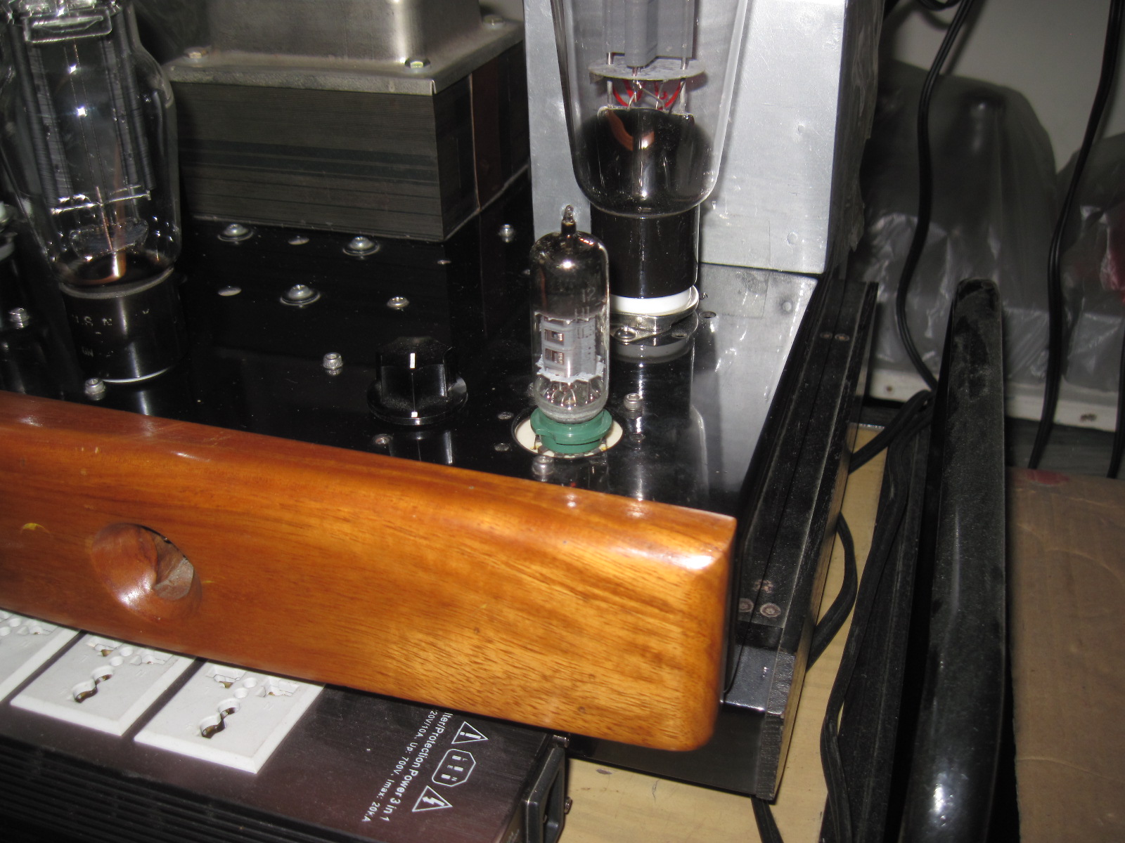

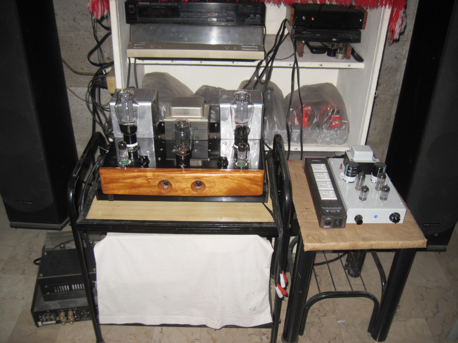

this is my recent 2A3 rebuild, used the 26 dht driver before and now i replaced with 12HL7...
the owner wanted more oomph, so i removed about 10lbs of chokes and traffos. replaced the OPT's with Tango copy locally would OPT's.....beefed up the psu filtering...

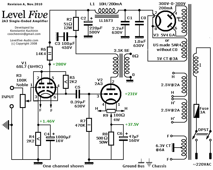

Hi All,
Thanks for all your help. For several reasons I need to get this amplifier right the first time. I have tentatively decided to make the Level 5 2A3 and lose the 56 triodes.
Any thoughts good or bad on this circuit? I know some voltages will need to change if I use the 6SN7 suggested in this thread. Would that be worth doing over the 6SL7 used in the design as depicted. I will start a build thread if anyone is interested.

If you use a 6SN7 with that design the gain wouldn't be enough to drive the 2A3. The thing with an SRPP is it can dri e heavy loads, why not optimize the stage to drive a 10k load and reduce the 2A3's grid resistance to 10k and go with the battery bias as initially intended?

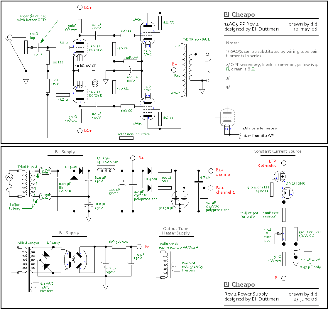

Even with SRPP, asking a high RP/low gm 6SL7 to drive a 2A3's Miller capacitance is (IMO) asking for trouble. Like its Noval relation, the 12AX7, the 6SL7 can't fight its way out of a wet paper bag. OTOH, the 6SL7 is an excellent high μ voltage amplifier. Again, a MOSFET buffer solves the problem. Given the 6SL7's wimpy nature, the FET to use is the ZVN0545A, as its capacitances are tiny. I strongly suggest you go with FET buffered, common cathode, small signal circuitry. A single twin triode will serve in a stereoblock amp.
If, like many members (including yours truly), you are financially constrained, you can save a fair amount of cash by employing the voltage doubler B+ PSU used in "El Cheapo". High performance at modest expense is (IMO) nothing to sneer at.
Another way to save money is using the 7F7, which is the Loctal equivalent of the 6SL7. Loctal tubes are a good way to obtain quality NOS at reasonable cost.
There is very little new under the sun in tubed circuitry. In a number of ways, building is like ordering from a neighborhood Chinese restaurant. "Pick 1 from column A and 2 from column B."

I just had a look at the 2A3 datasheet and the miller capacitance isn't all that high at 80pF. For a sine wave of 45v peak @ 20kHz you only need .45mA of current. I will have to look through my notes but if you take the output from the upper triodes cathode in the SRPP the output Z would be fairly low, <1k?
To clarify I am in agreement in that the mosfet buffer is a great way to go but I don't think driving the 2A3 is as tough as most suggest.
