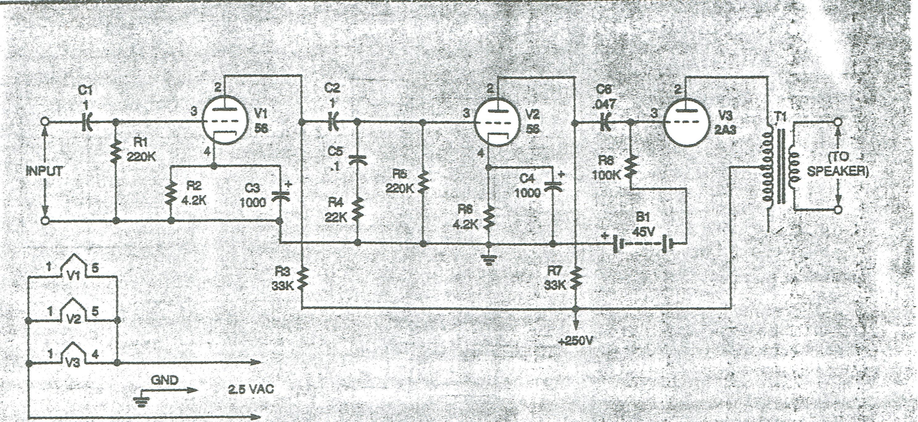

I am collecting the parts needed for a 2a3 build. The schematic I have uses 2 Type 56 triode driver tubes for the 2a3. I have reviewed many of the drawing on this site and elseware, yet have not seen one using these tubes as drivers. Must be a good reason? Does anyone know about this?

I would guess that the gain of them is so low that one isn't enough to drive the 2A3 and two is too much gain for todays sources. You can get enough gain from just one triode stage with a better tube choice. Also you probably want something with an operating point that has a bit more current in front of the 2A3.
Most SE enthusiast prefer two gain stages. The 56 has such a low mu that it's a bit impractical for that. This might explain the lack of examples.
For some other tubes the 56 might be enough of a driver, but 2A3 requires such a high input that you won't get full drive out of it, with a line level input signal.
Could you post your schematic?

Here is what I am planning on for my build. It seems simple with a minimum of components. Seems a good start for me. Please throw in all your advise.
Thanks for your help!!!

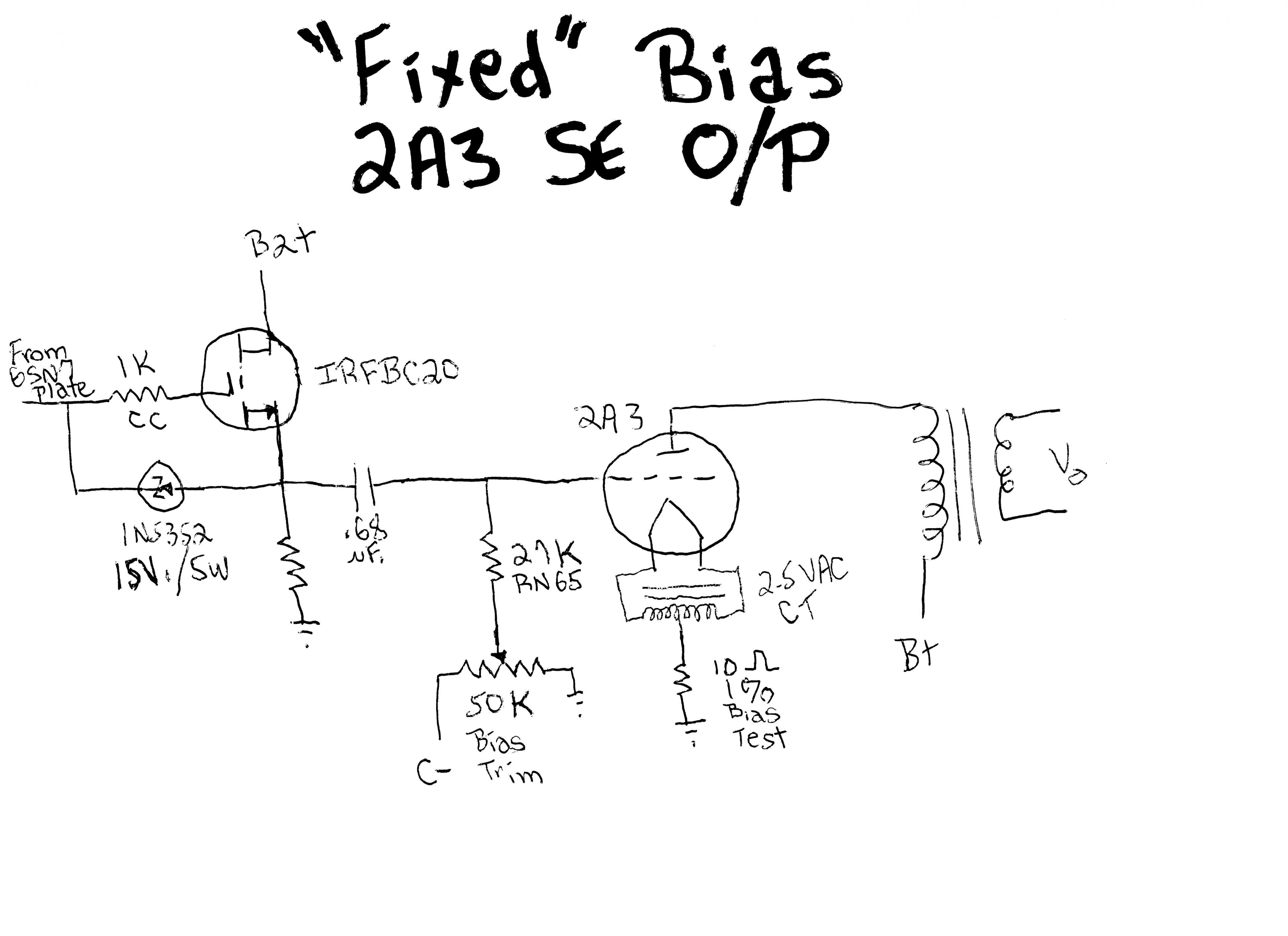

You can, more or less, retain the topology by using a 6SN7 twin triode for voltage amplification. The circuit shows truly fixed, battery, bias on the 2A3's grid. As DHTs, like the 2A3, are particularly vulnerable to runaway, when fixed bias is employed, I'd like to see the value of the 2A3's grid resistor reduced. To prevent voltage amplifier gain loss, insert a DC coupled IRFBC20 source follower between the voltage gain circuitry and the 2A3. Think of the FET as a heaterless pentode. For several reasons, including great ease of use, a well selected FET makes a superior voltage follower. Read MOSFET Follies. Experience has shown that protective 15 V. Zener diode between the gate and source electrodes of the IRFBC20 is important protection against start up transients.
Build a SS rectified negative supply for 2A3 bias and use trim pots., to exactly control O/P tube "idle" current.
Source follower driving 2A3 grid is an excellent idea, I also recommend that. The source follower gate can have a very high bias resistor, 1M is fine. This will help with the low end response wrt coupling cap.
No coupling cap., whatsoever, between the voltage amplification circuitry and the FET. Only a gate stopper is between the 2nd gain block's anode and the FET gate. DC coupling enhancement mode MOSFET source followers is pretty darned easy. 🙂 5 mA. of drain current will surely bring the follower's O/P impedance below 1000 Ω. A 0.68 μF. cap. coupling the source follower to the 2A3 allows that tube's grid resistor to be a safe (for "fixed" bias) 47 Kohms.
Why would you be driving the 2A3 grid thru a capacitor load with the follower, when you could simply be driving the grid with the follower?
There are pluses and minuses to both approaches. DC coupling the FET to the voltage amplifier circuitry makes for PSU simplicity and there is no chance of dragging the 2A3's grid too far into positive territory. DC coupling the FET to the 2A3's grid allows for some A2 action and is immune to blocking distortion, but the overdrive risk is present and PSU complexity is a given. Refer to Tubelab's PowerDrive.

I'll work up a "hen scratch" schematic for the FET buffer and O/P stage. It will be uploaded, soon.

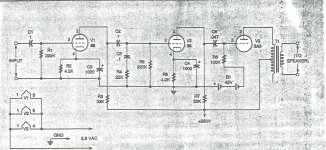

Ron
