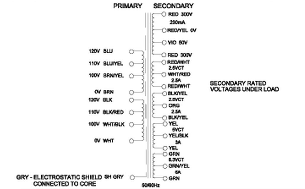

Lots of good info. is contained in the Hammond 302AX power trafo wiring diagram.
The 2.5 VAC windings have center taps. Those CTs allow a builder to dispense with hum balance trim potentiometers. For the most part, other than single 2A3 "finals" in each channel, you will follow the schematic of the PSE amp, insofar as signal topology is concerned. Connect the ends of the 2.5 VAC windings to the 2A3 filaments. Connect the 100 μF./1 Kohm bias networks to the CTs and ground.

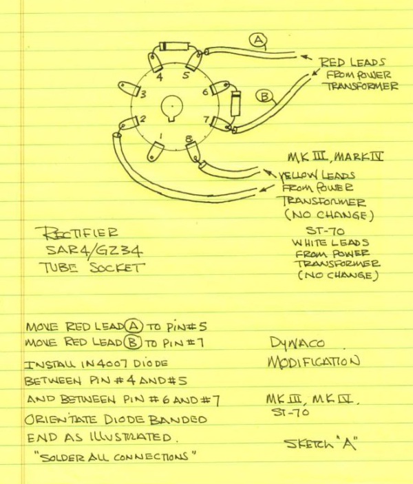

Remember what I said about mix/match and pick/choose. The "Level 5" amp provides the B+ PSU. 😉 Use an inexpensive Sovtek 5AR4 as the rectifier, but install the SS diode tweak, according to the uploaded diagram. Use UF4007s, instead of 1N4007s, as they are inherently less noisy.
Here is where I am at, I have (1) - 302ax, (2) Sophia Electric 2a3-05 OPT, (2) - EML 2a3's. (My kids got together this holiday season).

I wouldn't push those 2A3's. For your first build I would suggest do something simple and get the basics right anyway. Good layout and lead dress, proper grounding etc... I am thinking a two stage design, cathode biased. Use a 220k grid leak resistor and that will give you plenty of choices for drivers, anything with a plate resistance of 10k and under is fine. Spend the time on the power supply and get that right it will make a big difference.
I am working on something for you and will add it to the list of schematics for you to pick from.
