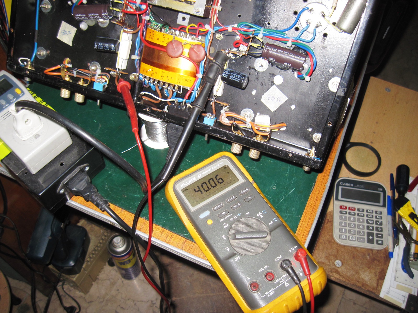

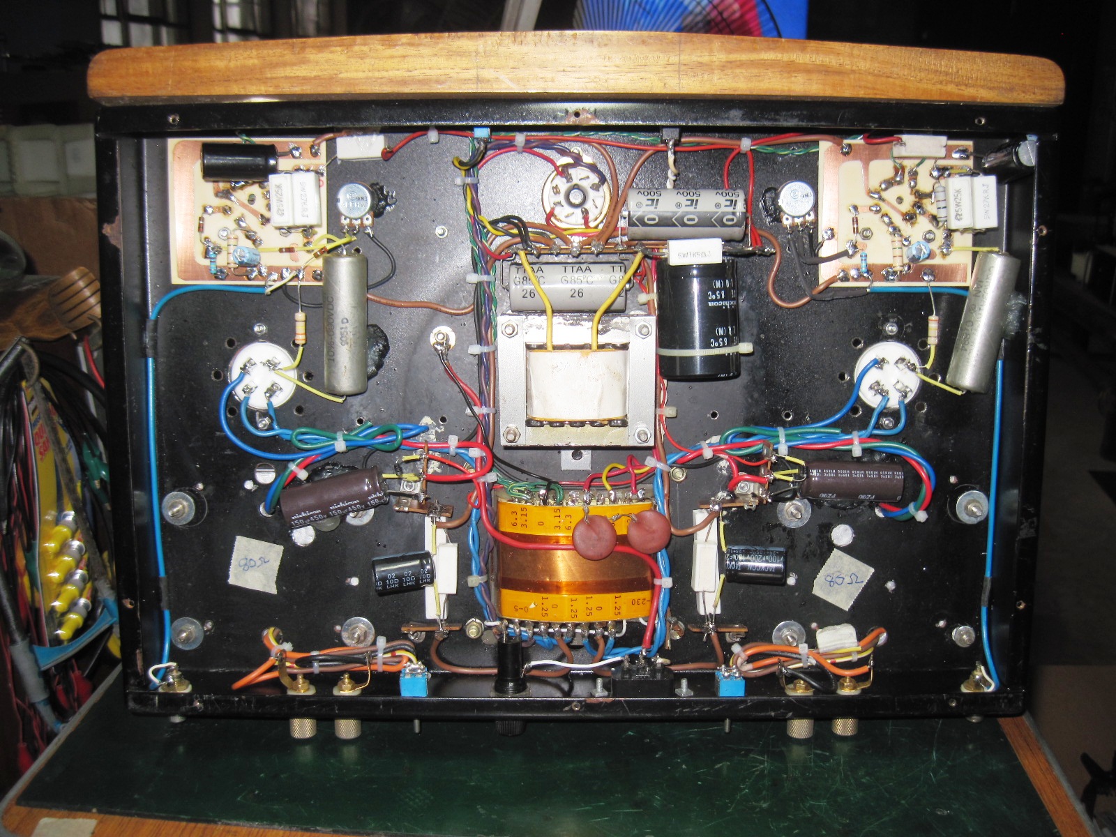

2A3 driver
this is the underside of my 2A3 using the 12HL7 driver....

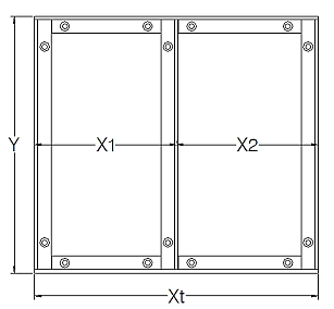

Well, aluminum it shall be. I'll draw up a layout, because I assume that placement is important. Electrical fields and such. And hopefully you all might point me in the right direction. (again)
I'm going to get the case from these guys https://www.landfallsystems.com/index.php
Anyone used them before?
Thanks!
Ron
you are lucky to be living in there....great chassis...
Ron,
Get something pretty darned big, both in terms of top plate area and depth. You need room to work in. Save "shoehorn" tactics for the future, when you have experience under your belt.
The model with the front to back divider is (IMO) a good idea. Build the PSU on 1 side of the divider and the signal circuitry on the other. Aside from some shielding, the divider increases plate strength and heavy magnetics will mounted to the plate(s).
You mentioned layout. Does the term orthogonal mean anything to you? The coils of the O/P trafos can be in the same spatial plane and the coils of the power transformer should be in a different plane rotated 90o from the O/P magnetics. Ideally, a PSU filter choke will be mounted orthogonally to both the power and signal transformers. That usually works out to being on a side wall.
Ongoing
Yes, big with things arranged as you say, orthogonal. I also like the front and back split. PS in the back as you suggest. Looking at some of the commercial products online gives a point to start. I was thinking 18 left to right by 12 front to back, at least 3 deep (inches all).
I'm going to make a cardboard and arrange the xformers, sockets, choke and things an take a snapshot. Wanting to get the spacing right for no noise and such.

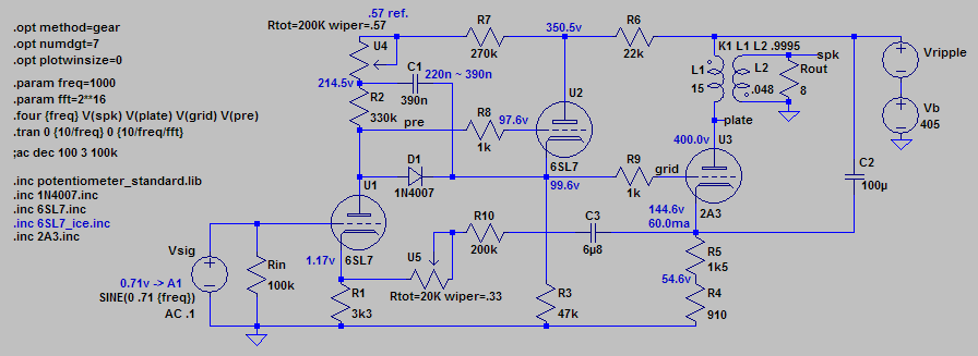

Another option just to confuse things, and as long as you don't mind burning off some energy in the output cathode resistor. It's a direct coupled amp, with very effective ps ripple cancellation. The whole amp is self regulation, once set up. Takes a while to wrap your head around the concept, but I can confirm that the design works very well. A 12AX7 can be substituted for the 6SL7 in the input position or follower position or both, with adjustments to plate and cathode resistors. Can use a pretty simple power supply and all film caps.
http://www.diyaudio.com/forums/atta...422360010-3-direct-coupled-2a3-amps-v9-lw.png
From here: http://www.diyaudio.com/forums/tubes-valves/258790-3-direct-coupled-2a3-amps-15.html#post4201171

I don't think the 300-0-300 winding in the power trafo the OP already possesses will be good for direct coupled circuitry, as the B+ rail will be too "short".
Don't waste any money or time on boutique capacitors, in fact they probably get outperformed by normal film caps. For the power supply you want some ESR so electrolyic is a good choice, but what I have had good experience with is using inexpensive motor run caps to parallel the electrolytic at the node where the 2A3 is decoupled (where you tie the output transformer to the B+). You can see them in my amp, they are huge! I will echo Eli in that the Orange Drop 716p's are good, I also like Wima MKP a lot and used them on my last build.

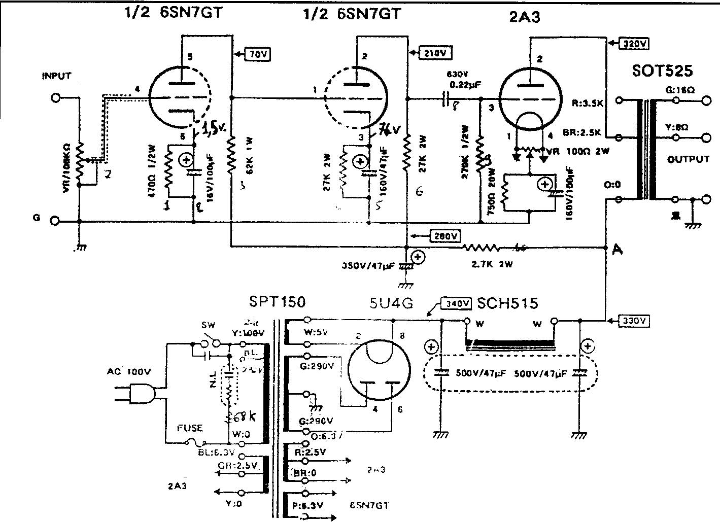

I think that this circuit (image below) might be a better choice for a first project. The tubes are easier to get hold of and are cheaper. Also battery bias is a bit awkward. This is actually a very generic circuit (its sold by Sun audio for about $3000 !) but it has a wonderfully full sound.
You can, more or less, retain the topology by using a 6SN7 twin triode for voltage amplification. The circuit shows truly fixed, battery, bias on the 2A3's grid. As DHTs, like the 2A3, are particularly vulnerable to runaway, when fixed bias is employed, I'd like to see the value of the 2A3's grid resistor reduced. To prevent voltage amplifier gain loss, insert a DC coupled IRFBC20 source follower between the voltage gain circuitry and the 2A3. Think of the FET as a heaterless pentode. For several reasons, including great ease of use, a well selected FET makes a superior voltage follower. Read MOSFET Follies. Experience has shown that protective 15 V. Zener diode between the gate and source electrodes of the IRFBC20 is important protection against start up transients.
Build a SS rectified negative supply for 2A3 bias and use trim pots., to exactly control O/P tube "idle" current.
