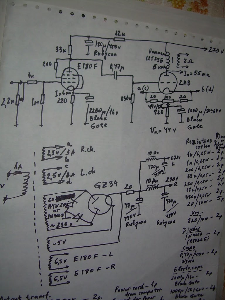

I wouldn't advise copying a schematc. A two stage amp will be easy enough to design from scratch with the help from everyone on here. At the end of the day you will hold your head higher knowing you didn't just copy a schematic. Don't worry it will sound lovely.
So instead of taking a proven design, we're going to have folk here, who he doesn't know, never met, decide how he's going to design his 'once in a lifetime' project here on the internet, and the thread is already talking about guitars amp chokes.🙄
Joined 2009
A member on this forum, Azazello (Nikola Nikolov), built a simple 2 stage amp that he was very pleased with, perhaps his input would be good if the plan is to have the forum 'team' design this amp 😀
I've taken the liberty of posting his design - a schematic from his blog. Note: "Now 33 kom is 15 kom and 12 kom is 3 kohm, +U is 316 v, not 270 v"
I remind the members that the OP has, among other things, a Hammond power trafo in hand and its rectifier winding is 300-0-300. IMO, what is needed is well proven, good performing, circuitry that fits stuff already on hand. Selecting suitable portions from existing designs meets the need and is unlikely to result in (horrors) failure.

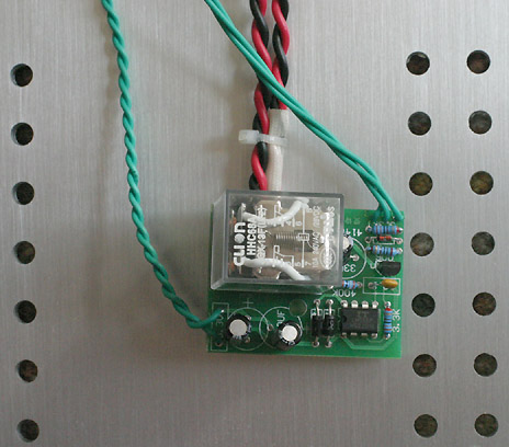

Hi, I have been reading again, (bad). And I am considering the supposed impact of immediate b+ without the tubes heating up. The 3 approaches I have found and surely there are more are-
for the PS rectifier:
http://www.situbes.com/File_Downloads/SiTDR.pdf
or a circuit board (pic attached)
info for the circuit board:
This board would permit to warm up vacuum tube filament first, and then switch to high plate voltage in about 20 - 30 seconds later. To protect your expensive output vacuum tubes such as 300B/2A3/845, KT88/El34 ... to achieve longer lifespan, you need to get this delay action board (assembled, ready for use). Buy it today!
Price: $30 each + $5 shipping for the first board, $2 for each additional board
any thoughts?

Ron,
Cathode stripping is a problem at very high anode voltages, well above those employed with 2A3s. Being directly heated, 2A3s turn on very quickly. A 5AR4s slow startup time is more than adequate to protect your costly EML tubes. You could opt for instant on, SS rectified, "fixed bias" and electrostatically protect the 2A3s' filaments.
In short, there is nothing to obsess over. I'm keen on the cascaded, cap. coupled, 6SN7 small signal circuitry because it adheres to the KISS (keep it simple stupid) principle and is very well proven. Paraphrasing Einstein, simple, but not too simple, is good. I want you to succeed.

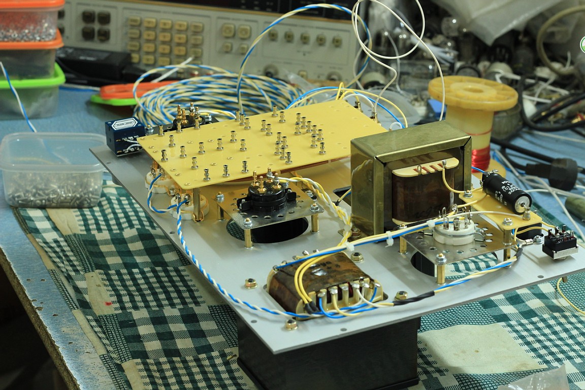

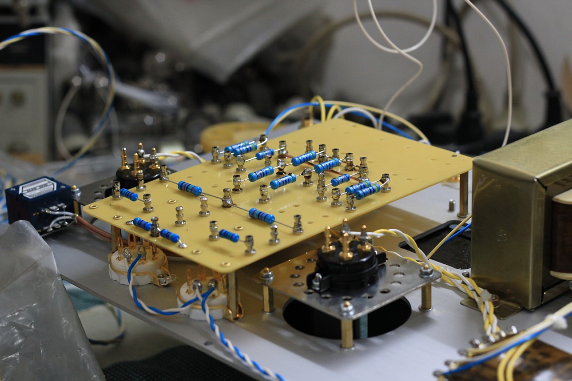

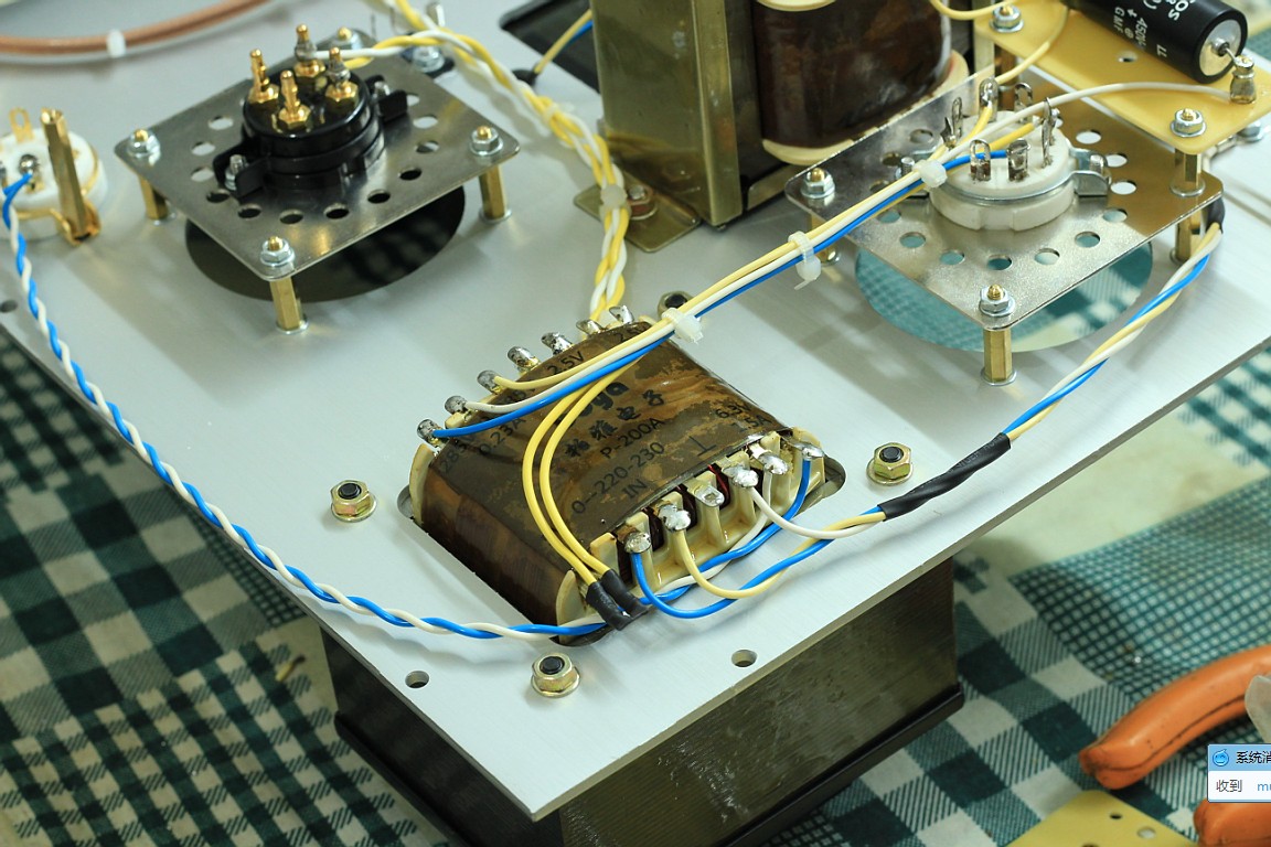

Impressed
This looks good to me as something I want to try to have in this build.
Does using turret posts on a board cause any problems? Just seems like a more neat and organized way to do things as opposed to the snap of my 300b commercial amp.
thoughts?
thanks,
Ron
