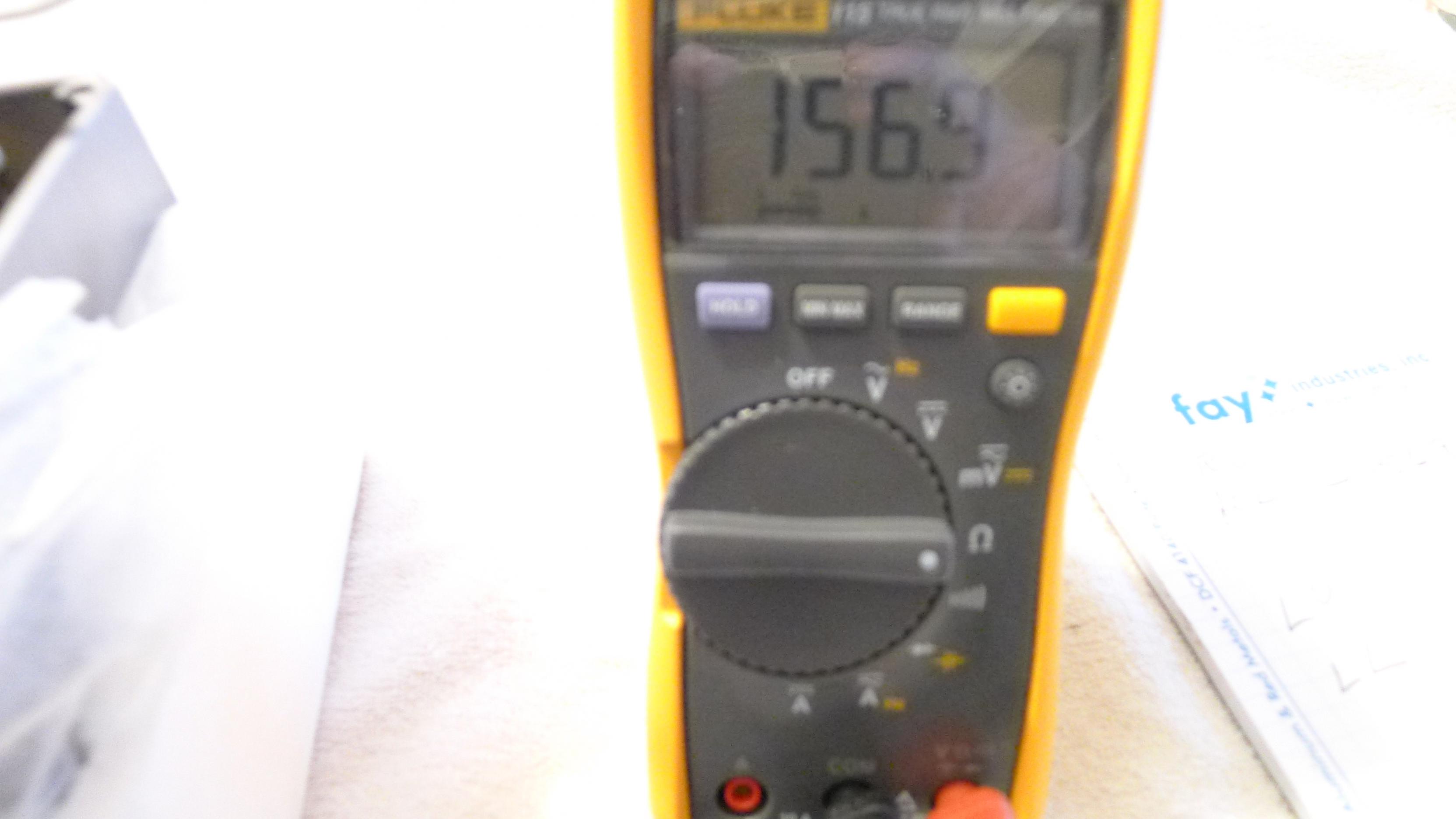

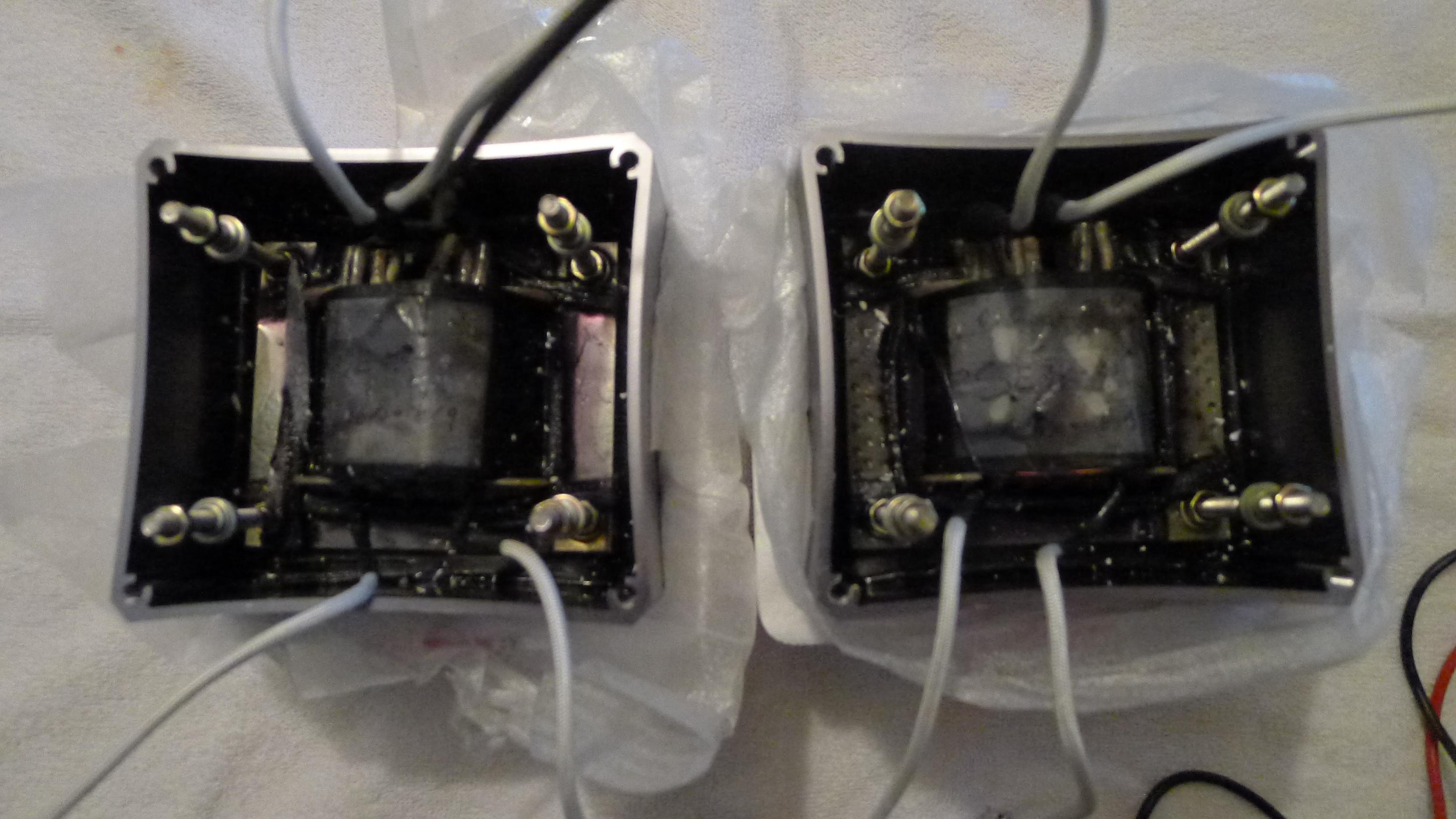

DCR
Hi FMB,
You asked me to measure the DCR of the OPTs.
As pictured in the photo there are 4 wires coming from each one.
2 wires are what we will call the upper ones and 2 wires the lower ones.
The resistance was measured across the upper and lower pairs.
Left upper = 1.3, Left lower = 164.7
Right upper = 1.2, Right lower = 156.9
So its Greek to me but there you go for the simulation.

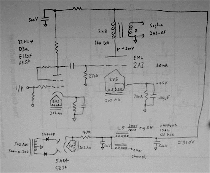

Here's a sketch of what I had in my head based on the thread so far.
With the standard -45V grid-cathode bias of the 2A3 and an operating point of 250V plate-cathode at 60mA you'll need a cathode bias resistor of 750R and you'll want 295V on the plate. With a nominal 10V drop across the DCR of the OPT you'll want 305V on the B+ supply (I suggested 310V in my sketch).
Your power transformer has 300-0-300 windings at > 200mA so in normal operation you'll see a bit more than this as you won't be drawing the nominal design current but once rectified you'll lose voltage through the tube rectifier (perhaps 12V with a 5AR4) and you'll lose voltage through the choke filter. I prefer a choke input filter after a tube rectifier but this won't get you to the B+ you want. So, perhaps you'll want to consider a small cap after the tube rectifier which will elevate the voltage and a series resistor to reduce the stress on the rectifier.
The first cap in the power supply, after the rectifier, has to be adjusted to get the voltage you want WHEN the amplifier is warm and drawing the correct idle current. I've not used this trick - there maybe reasons why it is to be avoided.
I've sketched the use of a single input / voltage amplifier tube, with a few options listed out. The idea is to connect the input tube screen grid to the plate, this linearizes the tube and reduces it's output impedance - some folk refer to it as 'triode wired'.

Looks good Bigun! Yes 750R for the cathode resistor | | 100uF. I would lower the grid resistance below 200k, especially with a low rp driver. I believe Ron wants to use cascading 6SN7's, he already has an amp with similar topology and he really likes it. I personally like two stage designs myself. The schematic he likes is posted somewhere in this thread, I will repost it here. I am still working on some revisions for people to look over. The sensitivity is high, 34db gain I believe. You can drop the gain down to 26db by dropping the first stage cathode bypass cap. I would leave the second 6SN7 triode's cathode bypass cap in there to keep the rp low to drive the 2A3, that value cap is 220uF and can be lowered to 33uF without any loss of low end response. The first coupling cap can be reduced to .1uF. Current draw per 6SN7 triode is 2.5mA, so 5mA per bottle. That's 65mA per channel or 130mA total. The values for the power supply can be realized as soon as which rectifier is chosen.

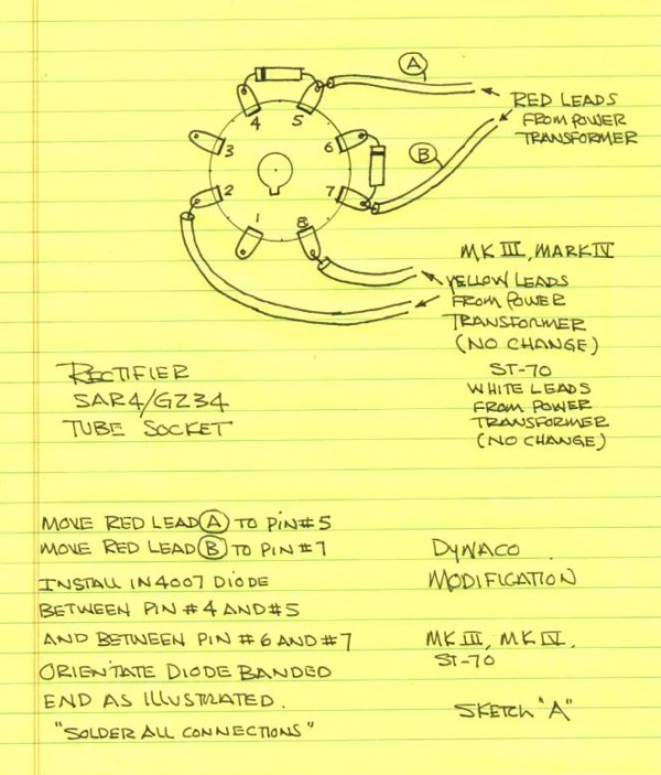

I am not a fan of using SS diodes in series with VR tube plates, if you want SS rectification then just use SS rectification and don't waste a tube.
The Hammond power transformer has 110v and 100v primary taps so in theory he can get the HT secondary up to 360vac.
Personally I think the 5U4GB is a tougher tube and will handle the repetitive peak forward current better than the 5AR4. You will get more of a voltage drop across it but that can be made up elsewhere, like with a large C input (50uF) or using the other primary taps etc......I also only like to use 1 choke so I share a choke between channels and then branch off after via RC filters. The 5U4GB's higher ratings allow the use of more capacitance which gives better filtering. If you use the 5AR4 use less capacitance and more chokes, pick your poison. Good 5U4GB's can be had for cheap where as good vintage 5AR4's cost a fortune these days, I know I just sold some out of my stash, I built an entire guitar amp for the price of two Mullard GZ34's I sold.

AJT, you'll get no argument from me about SS B+ rectification. However, the OP already has a Hammond power trafo that's configured for FWCT/vacuum B+ rectification.
I'm a big fan of high PIV Schottky diodes. They are every bit as quiet as vacuum rectifiers, while retaining the established SS diode virtues. More than 1 scheme exists for delaying B+ rise, should it be required.

I thought a tube rectifier was preferred by the OP, but otherwise I would recommend SS diodes too. The existing power transformer is fine, just use a pair of SS diodes in place of the tube rectifier. I don't worry about the instant B+ on either, just ensure the voltage rating for the power rail caps is 500V.
Where this is a Class A amplifier I wouldn't get too hung up on the dynamic resistance of the rectifier. Since it's basically running at max current all the time I would use a very rugged type. If you go the modern 5AR4 route the serial diodes is a very good thing, I don't like the modern 5AR4s.

Hey you guys, if you all think I should go SS instead of the tube rectifier. I'm good with that, with all the thought you guys are putting into this. You all certainly have a substantial vote. I'll build it anyway you all recommend. I'll save the 302ax for another day Say a maybe a 2a3 build with dual 56s driving it....hah! I'm not opposed to the purchase of a different power transformer. I really want to do this right.
Thank you all so much for you efforts!

All PN junction diodes exhibit a reverse recovery spike, AKA switching noise. Newer diode types, like FREDs and ultra-fast (UFnnnn), produce very little noise. Techniques exist for suppressing that stuff. OTOH, Schottky diodes, being majority carrier only, don't produce the trash. Until a few years ago, Schottky diodes were strictly low voltage devices. That is no longer the case. High PIV Schottky diodes made from silicon carbide (SiC) are available.
Us tubeheads will speak of "sand", when referring to SS parts. We have to add "grit" to the vocabulary, as SiC is a popular abrasive. 😀
Joined 2009

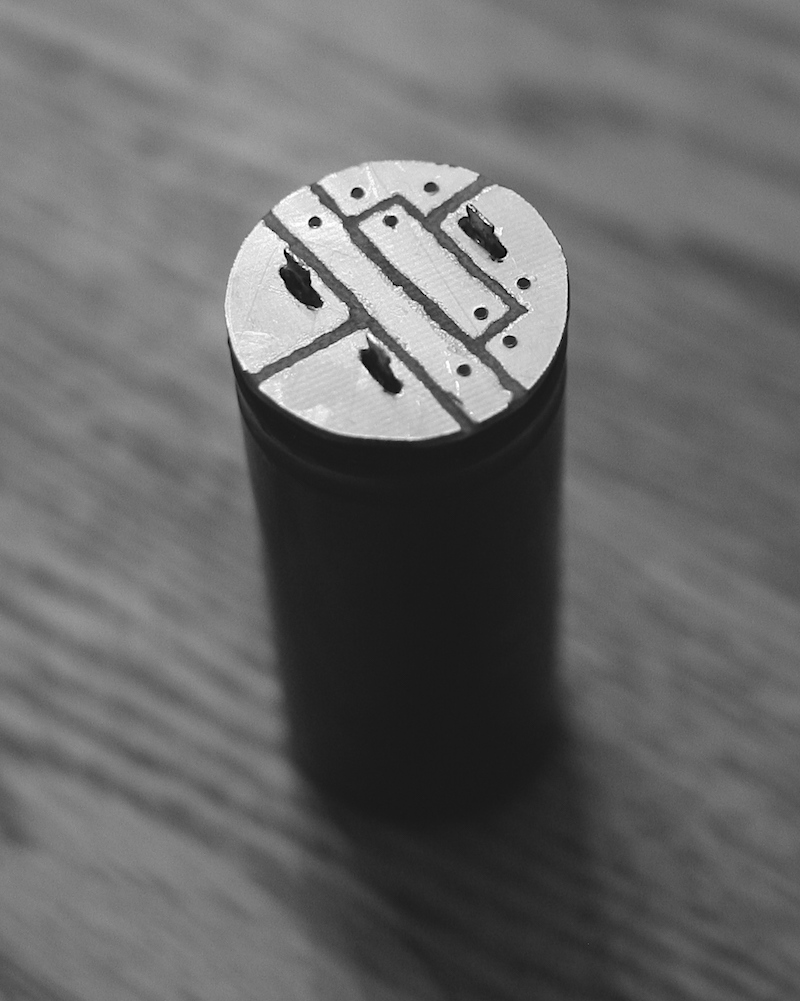

They can be quite compact too - the attached image shows a small PCB that I made which sits over the terminals of the power supply capacitor and holds 4 of the SiC rectifier diodes in a full bridge configuration.
