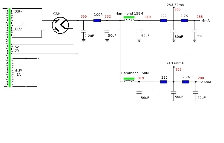

5AR4/GZ34 it is! 🙂
Remember that the 5V winding on the 302AX is 5V@3A, using a 2A rectifier will result in high heater voltage, .22-.47 ohm resistor in series will drop the voltage roughly .5v-1v. This will help extend the life of the 5AR4. You won't know until you have it all breadboarded, hooked up and running. Then when it's good and warmed up monitor both primary (mains) voltage and secondary voltage. This is worth the time, I know most hobbyist's just want to fire it up after soldering and be done. But dialing in the smallest of details will help the longevity of precious devices. Anyway back to the test. When monitoring your amp note a high and low on the primary also note the high and low on the secondary at the same time. You will see something like at 125vac on primary you get 5.9v on the secondary, with a low of 115vac on the primary you get 5.4v on the secondary. You know you can safely drop .5v. Why? You don't want to run the rectifier tube too low, a little high isn't terrible but in my opinion when you run modern 5AR4's at 6V on the heater they don't last very long.
If you do use a dropping resistor get at least 5 watters.
I run a 3A rectifier on my Hammond and with primary at 115 I am still a C hair over 5v.

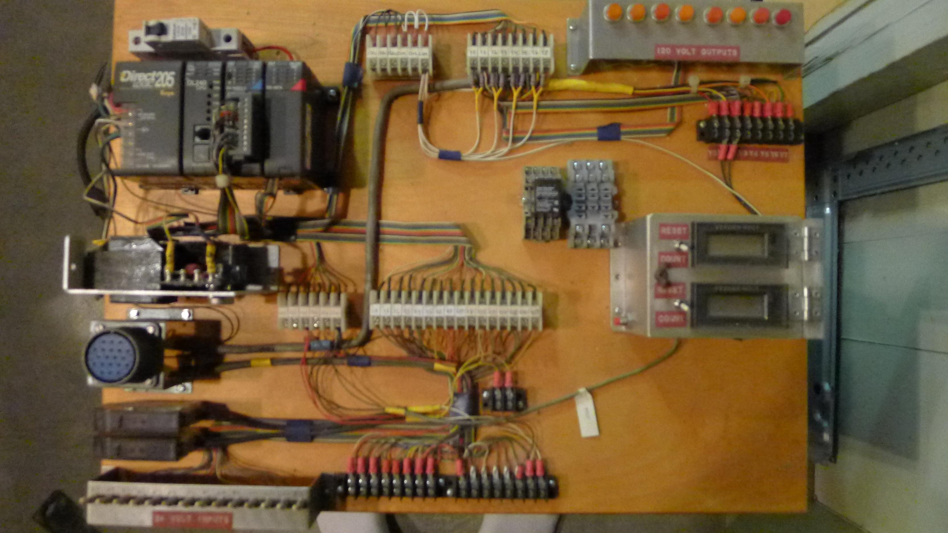

Prototype
I mean are we going to construct a test assembly?
I did so in the past as photo shown, very useful in what I was doing . If so I will
start making make a tube sort of one now as we decide the final circuit.
Sort of like what Tubelab has on one of his pages.
thanks!
Ron

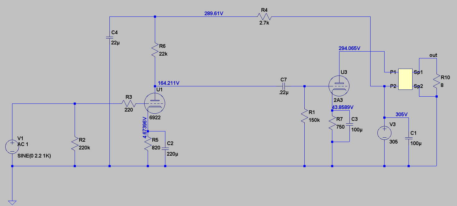

But if you don't need the gain ? and if you have enough B+ headroom I wonder why not use a high quality resistor. It may be old fashioned but it's simple, reliable and can sound wonderful. Mr. Ciuffoli has built more tube amps than I'll ever hear - he tried a CCS loaded triode-wired D3a driving a 2A3 and preferred the result with a resistor plate load instead.New 2A3
I would propose the next step is to get the experimental chasis under construction - there's a time for chit chat and a time for action, it's time to get hands dirty. There can be a lot of fun in trying things out, collectively we should recommend some options so that the parts can be ordered. I would propose trying 2 or 3 different driver tubes and to allow easy comparison you may like to have 2 or 3 sockets wired up so you can swap between them easily for listening tests. You'll want a selection of resistor values to go with. You'll want a selection of bypass and coupling caps too - I have noticed sound changes between Russion PIO and MKP film types - see which you like.

Also I forgot to mention you can fine tune the B+ voltage by adjusting the first cap 2.2uF. I crunched the numbers and simmed everything too so it should be accurate. If you can swing it I would try and get a NOS Mullard GZ34, they are expensive but they are bulletproof.
