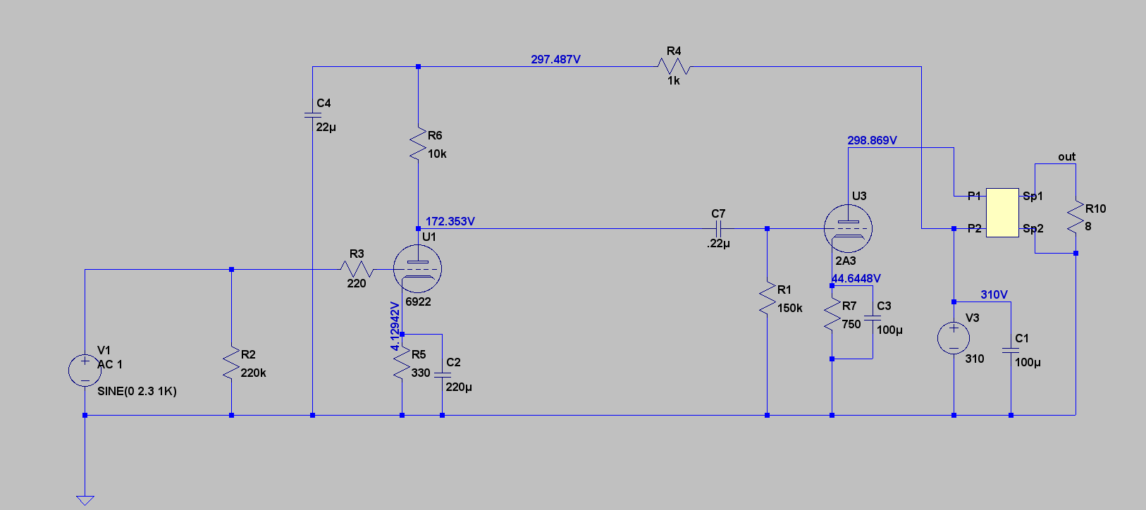

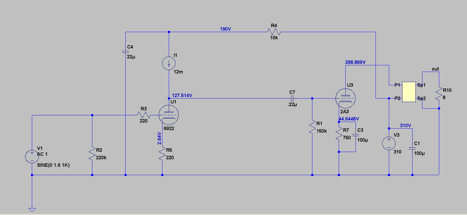

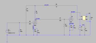

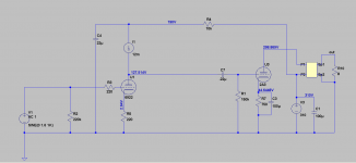

Running with Eli's idea of using a CCS loaded 6922. I use the 10M45S point to point without any issues. The driver has low rp and high gm, plenty of current.
Rough schematic of simulations so far. I also have the simulations for the cascaded 6SN7 approach. I like the idea of one stage driving the 2A3 for a two stage amp.

The CCS load brings the obvious advantage of a horizontal load line for the driver, which means you realize the maximum gain. If going the sand route, I'd look at the Wavebourn Gyrator as being a better option. But if you don't need the gain ? and if you have enough B+ headroom I wonder why not use a high quality resistor. It may be old fashioned but it's simple, reliable and can sound wonderful. Mr. Ciuffoli has built more tube amps than I'll ever hear - he tried a CCS loaded triode-wired D3a driving a 2A3 and preferred the result with a resistor plate load instead.http://www.audiodesignguide.com/New2A3/new2A3.html
Ron will need a source that puts out 2Vrms or a preamp to get max output with this configuration. I don't have much experience for designing around the 6922 so if anyone has any better operating points let me know. Gain is 10db. 2% THD @ 3 watts out.
Joined 2009
That's probably fine for a modern CD player, but might be too low otherwise, depending on what source Ron plans to use. The grid of a 2a3 doesn't need gobs of current, a higher plate load resistor and lower anode current through the driver maybe?
