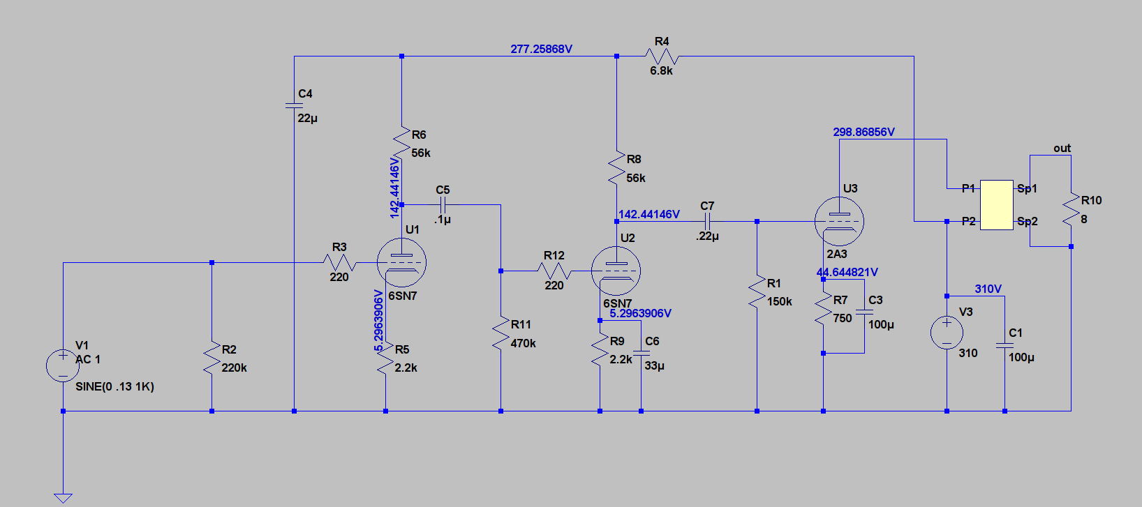

2A3 driver
IBM
Yes Bigun, I agree with the IBM PC (and NASA), they arugably got the entire world where it is in the current mainstream technology today. Not that that is entirely a good thing, I miss the afternoon paper. But all that aside guys, please enumerate the tube sockets I am installing on this prototype build. I have the 4 pins.

Forget PSE. Your O/P "iron" is for single 2A3s.
Sadly, local stores, for parts, are a thing of the past. :bawling: As a youngster, I spent a fair amount of time and money at the real Lafayette Radio located at 100 Avenue of the Americas, in Manhattan (NYC). The Canal St. stores had their uses too. All of the above are gone. IIRC, Sylvan/Wellington was the last holdout.
So I'm good if I order the parts for the circuit you mention as a start for the driver stage?

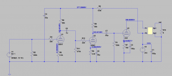

Yes. Check out the attachment. Removing the first stage's cathode bypass cap will lower the gain and distortion of the amp. C5 and C6 don't need to be so large so they get lowered in value.
And the same goes for the first 2A3? Eliminating the parts for the second 2A3. Correct?
Yes you don't want to run parallel 2A3's, all of your transformers will be unhappy unless you plan to bias the 2A3's very cold. So order parts for one 2A3 per channel. And it's not in the schematic but you will want to use another 220 ohm resistor at the grid of the 2A3, you want carbon composition resistors, so that's 6 220R carbon comp resistors.
