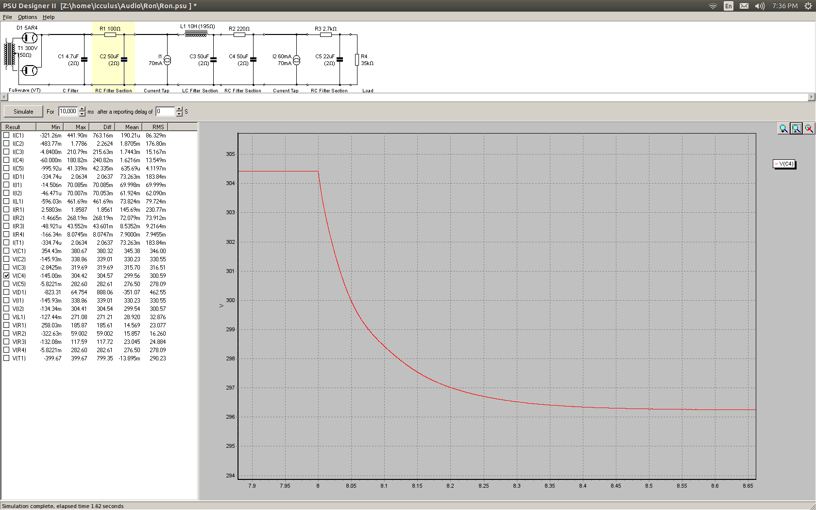

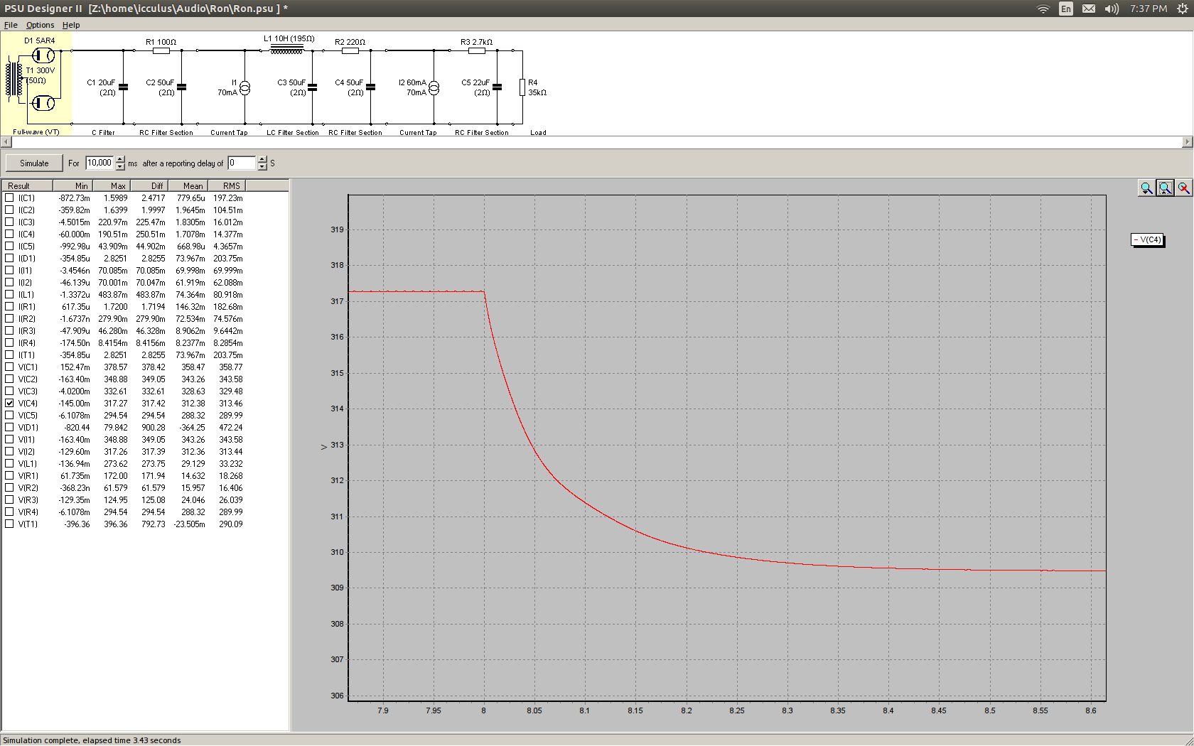

I looked through the thread and and can't find Michaels proposed PSU for this amp. If everyone is all for a revised edition of the PSU then I don't mind drawing up other options.
I did a stepped load at 8 seconds on the simulation and as I thought the 20uF gets you zero improvement in regard to transient load. The cool thing about the "pseudo choke input" is that instead of having to swap a bunch of resistors for both channels to increase/decrease voltage one cap will do it 🙂

Here is the thing
The spice programs only get you in the ball park and they don't assume real world conditions much of the time. I have seen people build their projects to the exact value of the spice only to have them hum or have excessive distortion afterward. I would never use a small value lytic as a first stage charging cap because even my 1953 Pederson amps which use a 4uf pio in a cap I/P filter wouldn't use a lytic even back then. Your implementation may work but you are coming out of a GZ34 that typically has a minimum of 22uf to 35uf..I'm not saying what your proposing can't work,but it looks like the first cap is an 8uf to 10uf and then goes into 100 ohm resistor and then into a choke..Why not just go for a choke I/P filter and be done with it and then it will regulate as well?.That would make more sense..
Spice can't prevent someone from implementing terrible grounding etiquette and or layout design and lead dress. So yes hum is possible with a perfect schematic.
Not enough voltage for a choke input filter, and besides load regulation isn't going to help as much as you would think with a class A amplifier, if this was a class A/B or B amp then I would agree.

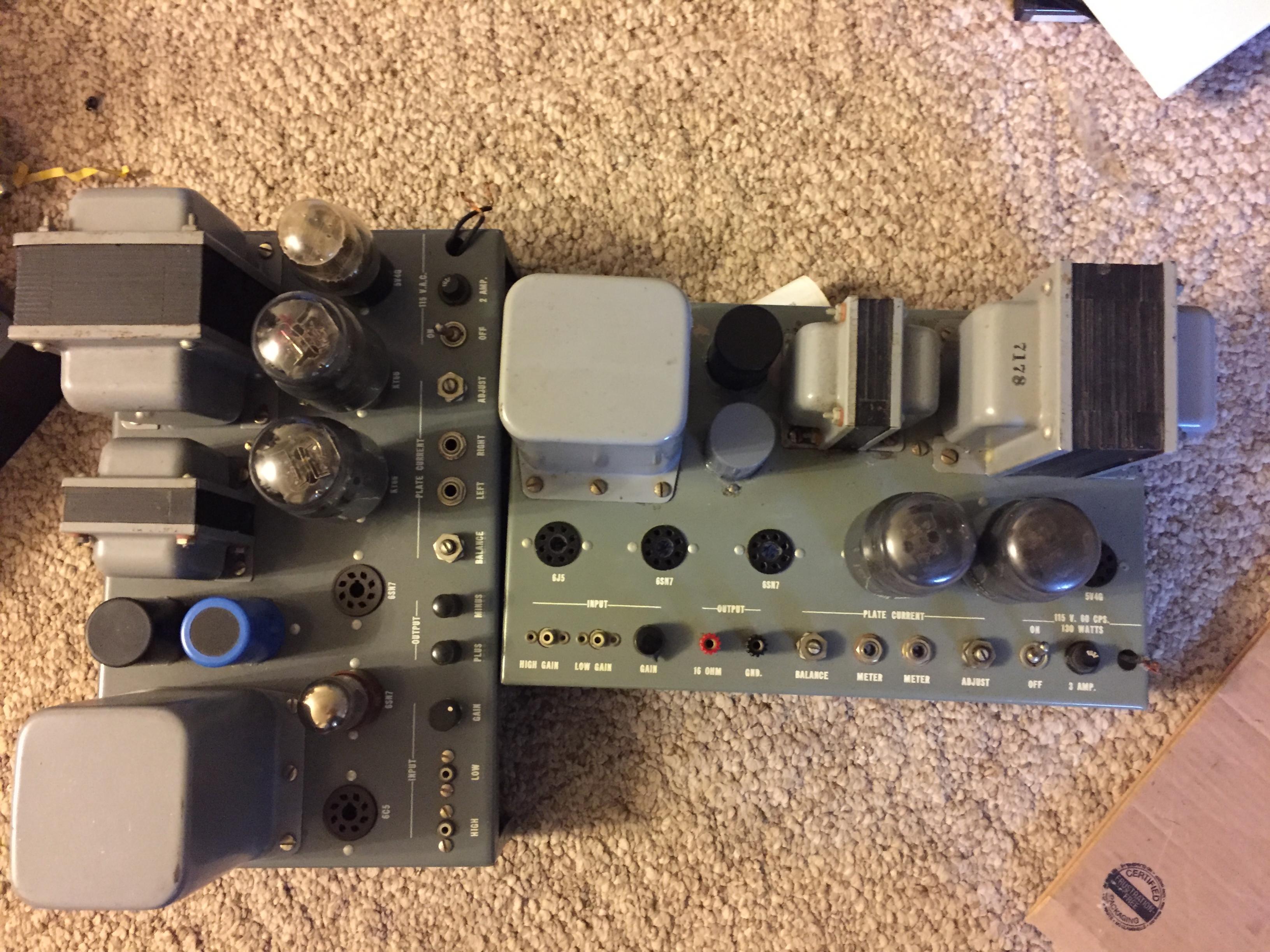

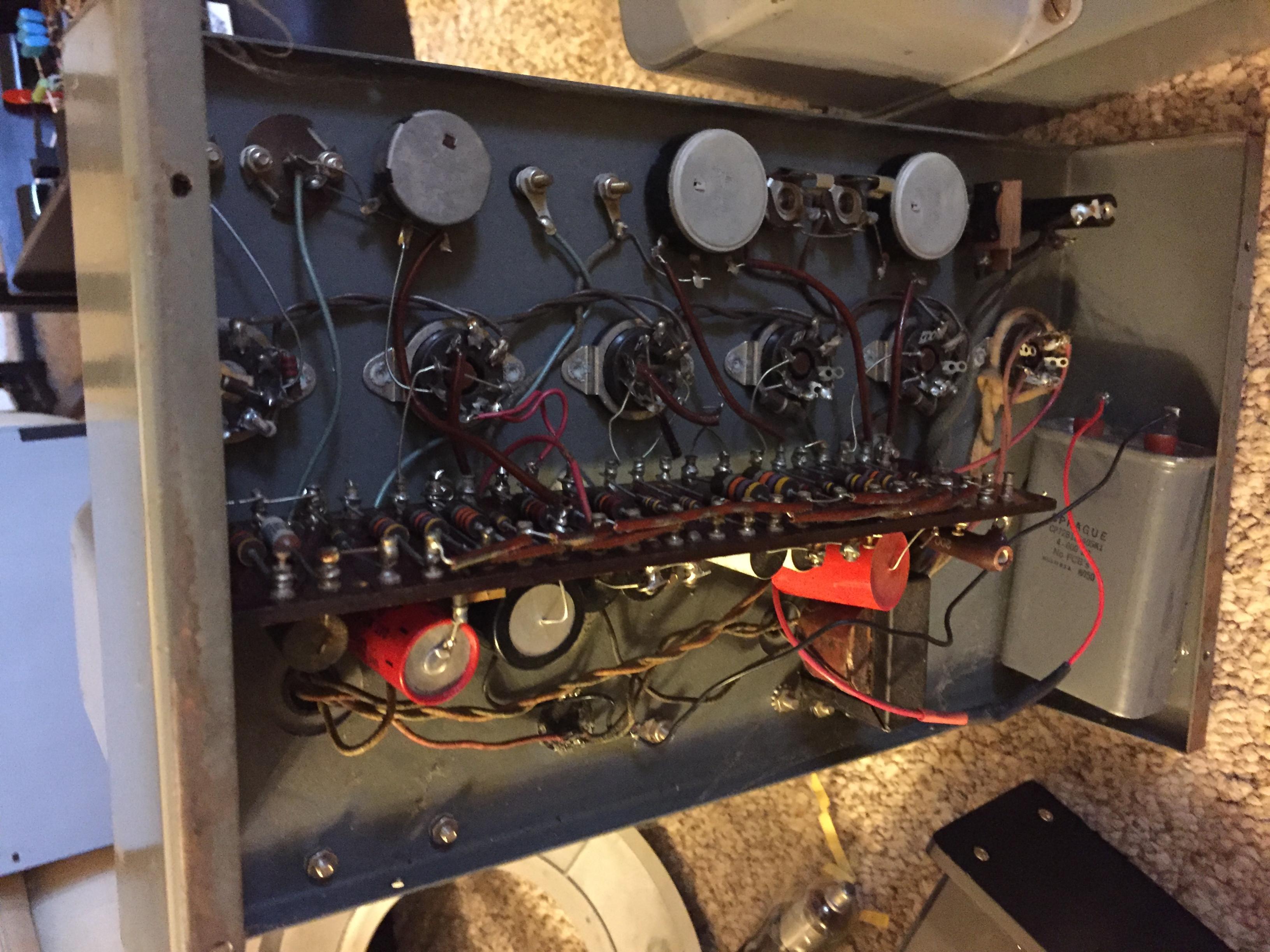

These are Pedersen amps and there is quite a story behind these.
Since we are basically talking so much about power supplies right now,what the hell..Anyway,these came from Charlie Kittelson's estate. When I first got them they actually worked and all original components including the 1st stage oil cap which was 4uf..Anyway I stuck in a 30uf at 600v poly and upon doing that the first choke started buzzing because due to the implementation of this design with two chokes,the 30uf sent the charging current up too high for the size of choke causing it to saturate and therefore buzz. I took it out and put in the 4uf at 600v Vitamin Q and then made the choke happy but what I did do was put in a 35uf poly between the first and second choke and a dual 100uf lytic after that..I'm now going to remove the lytic and go with two more film caps instead for comparison..
These amps have surprisingly large output trafos and I'm talking about 20% larger in size than the T0-300 Acrosounds. They are only 16 watt amps but I was going to wire them in pentode to see how well they would work..Pentode is easier to drive then triode so that won't be a problem..I just want to do this for a test.
Anyway,the reason I mention this is,even tho these amps are just watt triode connected amps,the sound is unbelievably large,dynamic,and pure. This is driving some big NewForm Research ribbons. It shows that power supplies sure make the amp.
