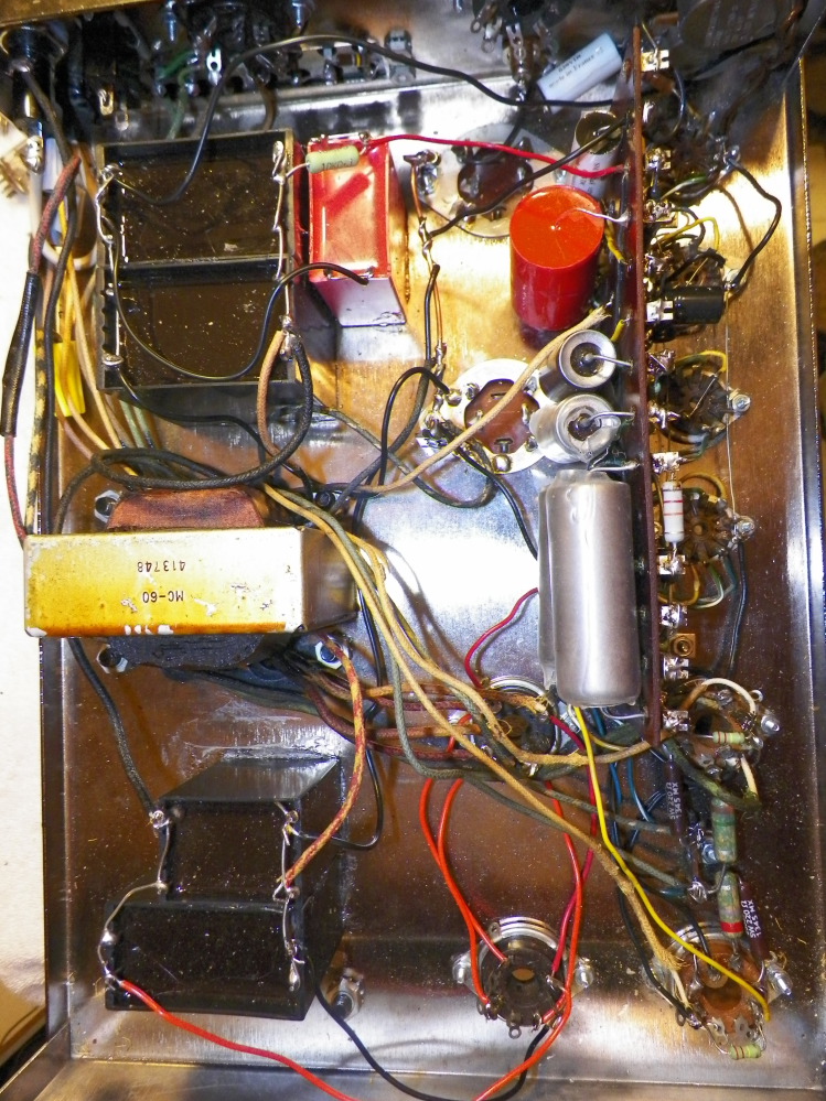

The most important cap in that power supply cap is the first stage charging cap and if you are using a GZ34 you want at least 20 to 30uf..I use a 35uf in all the vintage sherwood,scott,fisher,and Eico as the first cap off the GZ34 and I have NEVER had any excessive draw or current or arcing on the rect.tube..Don't forget this tube is not a directly heated filament so it comes up slowly anyway and your not using a choke of any kind so this now becomes much more critical because you are depending on this cap for ripple reduction and storage and if you just use an 8uf cap,all you will do is reduce the ripple and almost no energy storage and the line will sag. The tube is rated for up to 60uf depending on where you run the B+ but to just put 8 or 10uf there is just going to be very anemic. I have rebuilt everything from Mc30s and to Mc60s with 100% film cap supplies and they use GZ34s in place of 5U4s a lot and then you can see some of the sherwoods with the 35uf off the GZ34 when you scroll up the page.

I don't subscribe to a "one size fits all" way of thinking. Honestly I don't think you looked over the proposed power supply because there are two chokes and plenty of filtering. Also comparing this class A amplifier to a bunch of vintage push pull class A/B amps with various topologies is by no means a very rational way to come up with a well designed power supply.

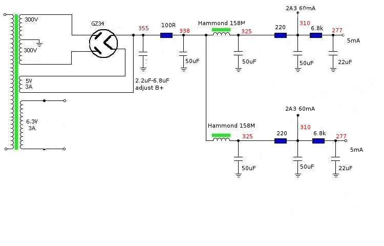

What value does your simulations say is needed to achieve the desired B+ voltage of around 310V ?
Between 2.2uF and 4.7uF depending on real world actual parameters. If he orders both values he should have a wide variety of options, if 2.2uF isn't enough use the 4.7uF, it should raise it about 10-12v. If that's still not enough he can parallel both and that should be plenty, simulations show 305 w/ 2.2uF and 318v w/ 4.7uF.

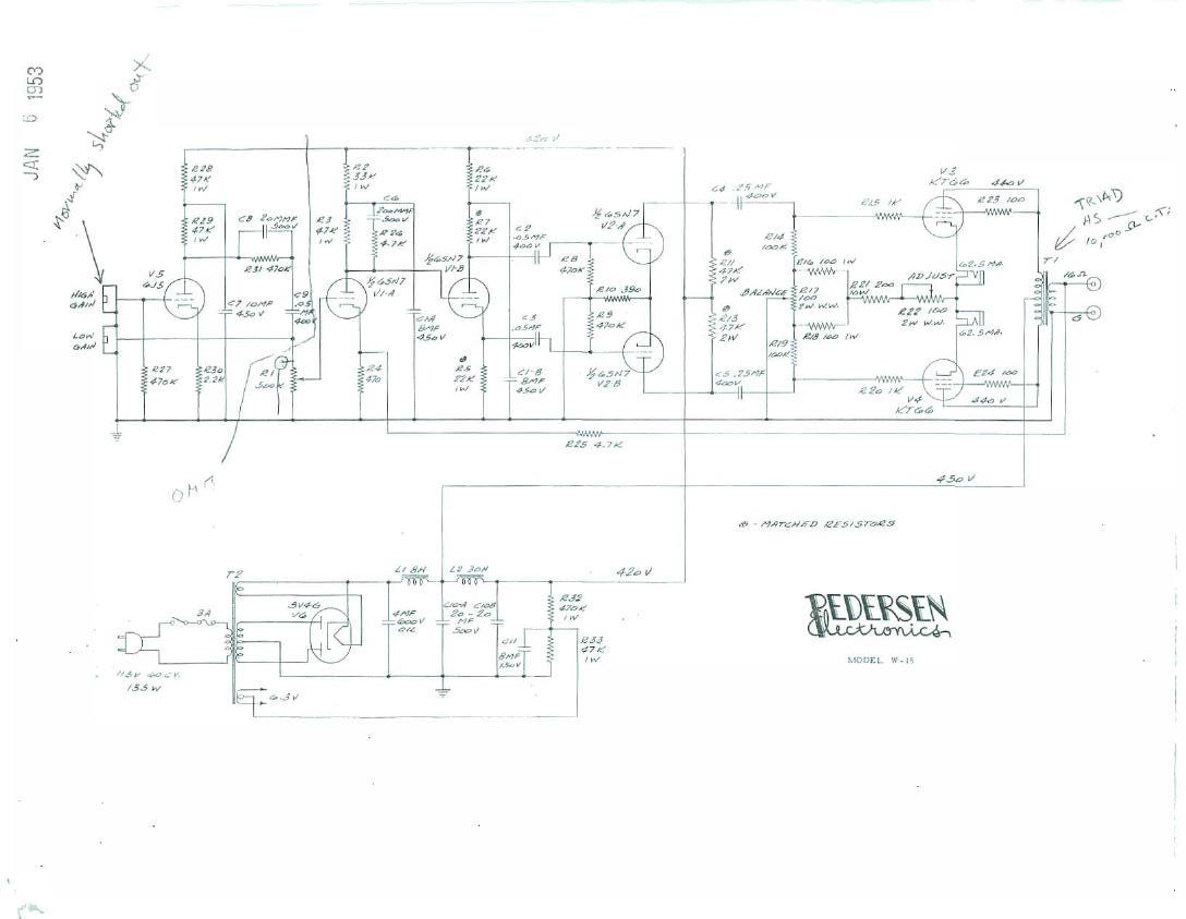

Where is the power supply schematic and which chokes are you using?
These are my Pedersen amps that use two chokes and 4uf pio as the charging cap into an 8hy choke then a 25uf poly and then into a 30hy choke followed by a 40uf poly.These amps are dead quiet and I don't run the 6j5 because I run them with a preamp..

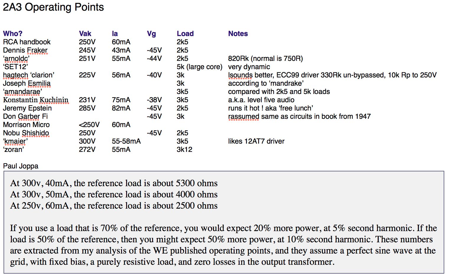

The human ear won't detect much, if any, difference between 3W and 4W because our ears operate more on a logarithmic scale - allowing us to perceive a much wider dynamic range from very soft to very loud. Pushing the 2A3 for every last drop of power won't bring that much benefit but it will stress the tube. The traditional operating point for 2A3 gives around 3.5W if I remember correctly ?
Your output transformer is designed so that when the secondary is connected to an 8 Ohm load it will reflect an impedance of 2k8 to the primary. Popular load impedance for the 2A3 varies between 2k5 and 3k so you're transformer is just right for operating the 2A3 in it's traditional range of 250V between anode and cathode with 55mA or so of idle current.
Here's some information I pulled together for my own 2A3 amplifier (attached)

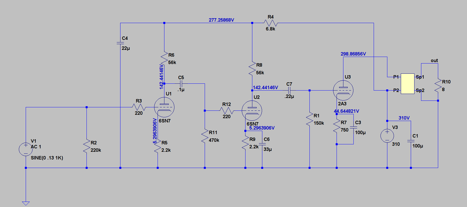

For everyone late to the party here is the power supply again. Good thing I reposted them because I noticed the last resistor wasn't correct, the 2.7k was for the 6922 pulling 8mA. The cascaded 6SN7 circuit will want a larger 6.8k resistor for the smaller 5mA draw.
There is 1.4mVrms of ripple at the 2A3 node, which should put about 15uVrms at the speaker. Basically the amp will be dead quiet. I also removed the first gain stage bypass cap to reduce gain, the ripple is so low that the decreased PSRR should not be an issue. I will repost the schematic too.

F/M/B,
The proposed PSU uses a CRC filter prior to the pseudo dual mono bifurcation via chokes. I suggest that the initial filter be CLC and that "check valve" UF4007 diodes be used at the bifurcation point. Both ripple and regulation behavior is better in CLC compared to CRC. IMO, space and performance favor a single inductor and 2X DO41 cased diodes.

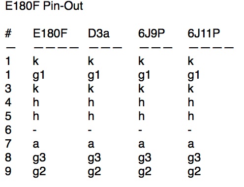

What would that tube be to use for a single tube gain stage?
There are a few choices around and although I haven't tried them I'd be the most curious about the E180F and equivalents. There are some Russian pentodes with compatible pin-out (see table, obviously 2nd row should be 'pin 2' !) that might be fun to try in the same socket as well as the European D3a (for highest gain). If you are lazy like me you could probably run them all at similar operating points in terms of Va (anode voltage) around 150V to 170V and with similar anode load resistors such as 15k.
