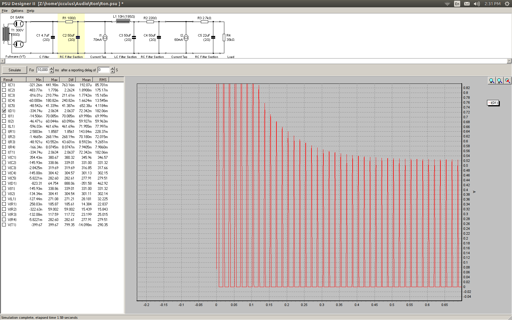

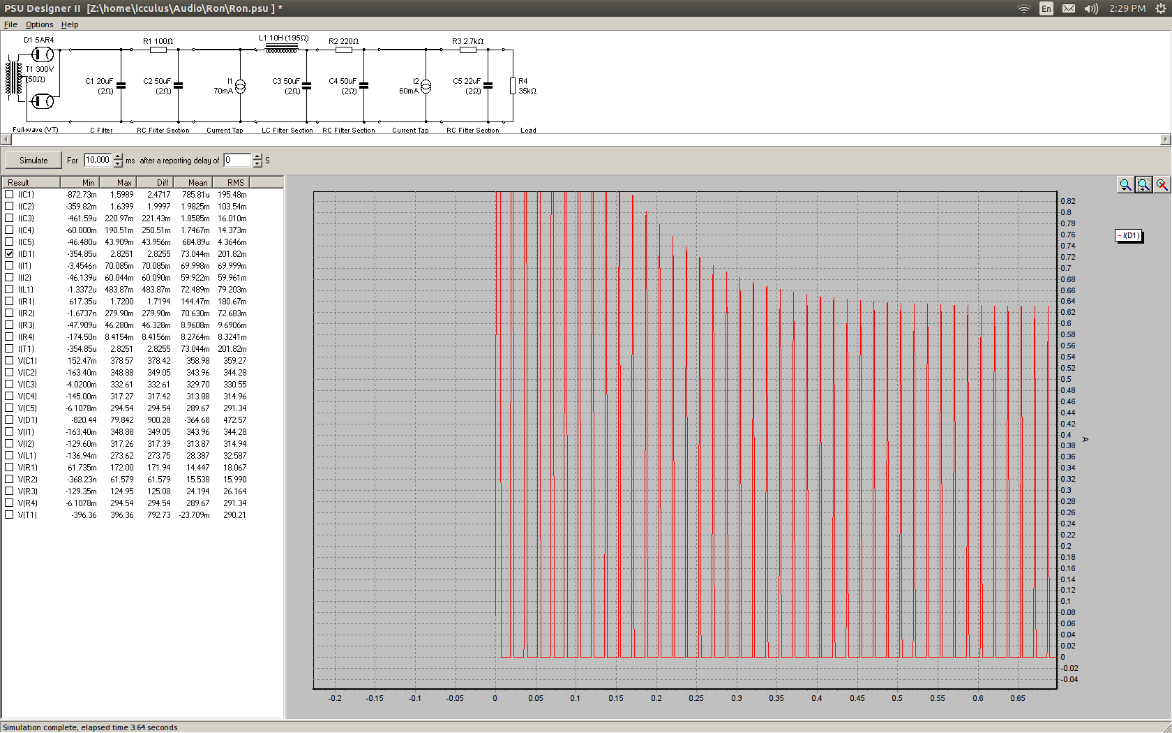

It will be cool when Ron gets this thing breadboarded and ready to do some listening comparisons and actual measurements between changing different component values. I still feel that raising the input filter cap beyond a certain point won't be advantageous, I try and not work the rectifier if I don't have to. I just did all this work between SS, 5AR4, and 5U4GB with a very similar Hammond power transformer and relatively similar loading conditions. Things to remember is the 5AR4 only likes 750mA steady state peak current. A 20uF will disobey this for about 200mS on start up but once the caps charge it will still run at 630mA which is close to it's maximum. So my feelings is that the tube will be stressed at start up and run close to max all the time.
Here is the difference between 20uF and 4.7uF. The 4.7uF doesn't disobey the 750mA draw for more than 100mS which is fine and it levels off at around 520mA. The rectifier will last longer. If you use a 4.7uF and still have to gain voltage you can lower the 220 ohm resistor after the chokes to 100 ohm but I don't think he will have to do that, in fact he might need to lower the value to 2.2uF. Like I said before that if Ron hears or measures a substantial difference with a 20uF by all means use a 20uF but I highly doubt there will be, the B+ ripple is so low with 4.7uF or even 2.2uF already.

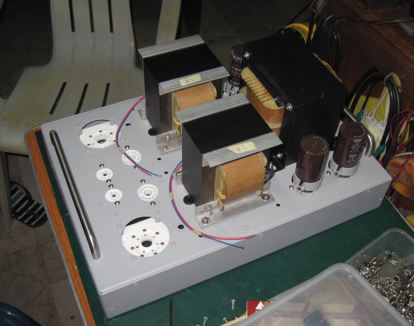

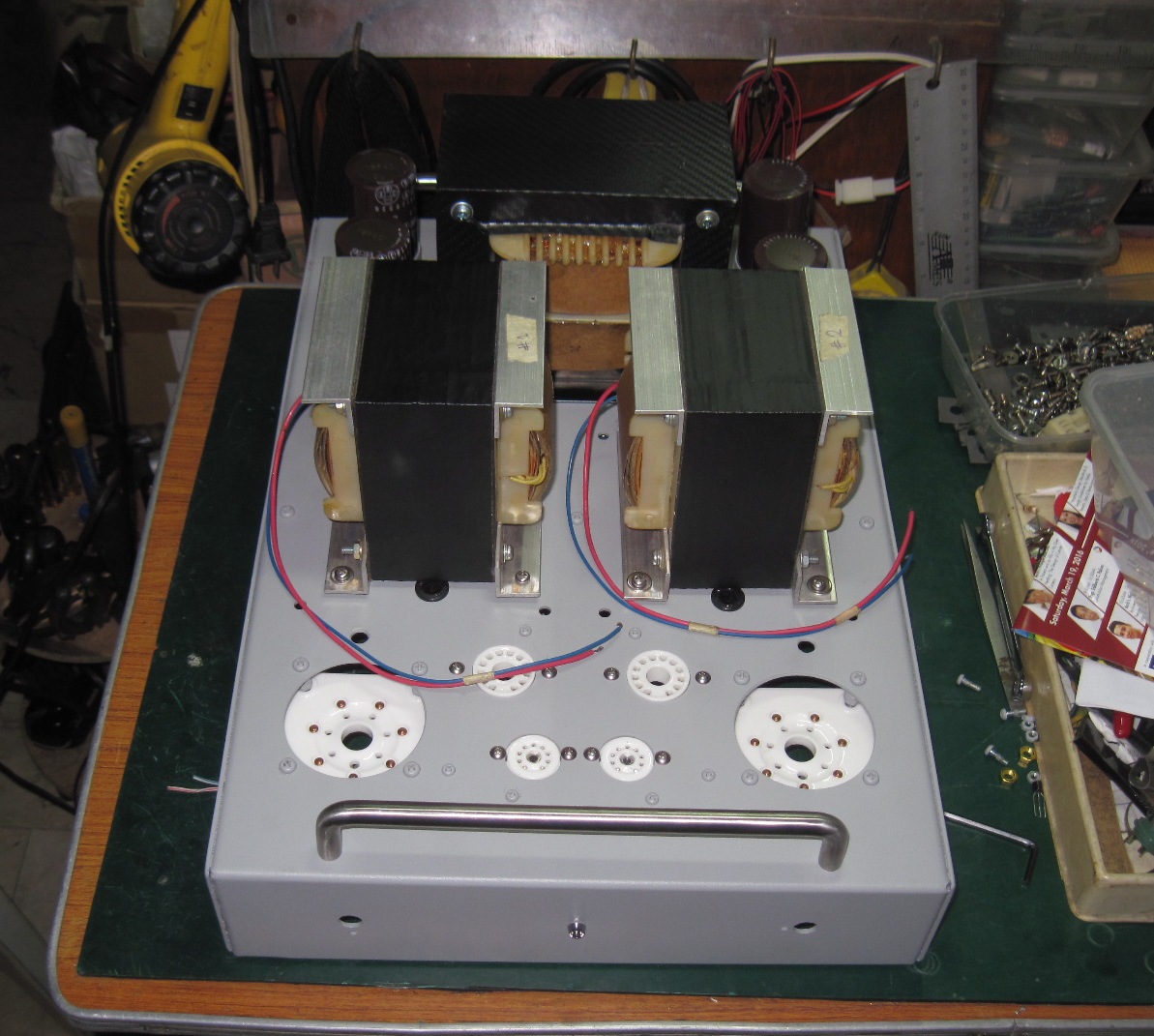

Layout
I have been looking at the 17 width x 12 depth platform that I initially chose for this project, I based it on a measured component size for what I have in house. And it seems a bit tight. I ask, what is the acceptable spacing placement for the components? Transformer to transformer, to choke to choke, tube to tube, etc. Is an inch between enough? Of should there be a greater distance, what is the standard accepted practice here? I don't want anything to be too close. And thanks to you all.

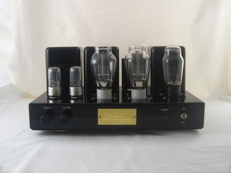

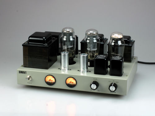

Here's a couple of commercial stereo 2A3 amplifiers you can find for sale on eBay (both less than $1k each) which have a fairly classical layout and chasis design.
The first one is a single Pentode driving a 2A3 and is sized 340W x 230D x 190H (mm)
The second one is a Russian 6SN7 cascade driving a 2A3 and is sized 390 X 320 X 190mm

I would think that 17" x 12" x 3" should be sufficient. I used 17" x 10" x 3" but I only used one choke. Keep in mind orienting the planes of the transformers by 90 degrees will help reduce electro motive force coupling. Keep hot tubes and resistors far enough away to reduce thermal coupling to capacitors and transformers etc.... Also I hide my chokes underneath so the plane is different, I mount it on the side walls of chassis.

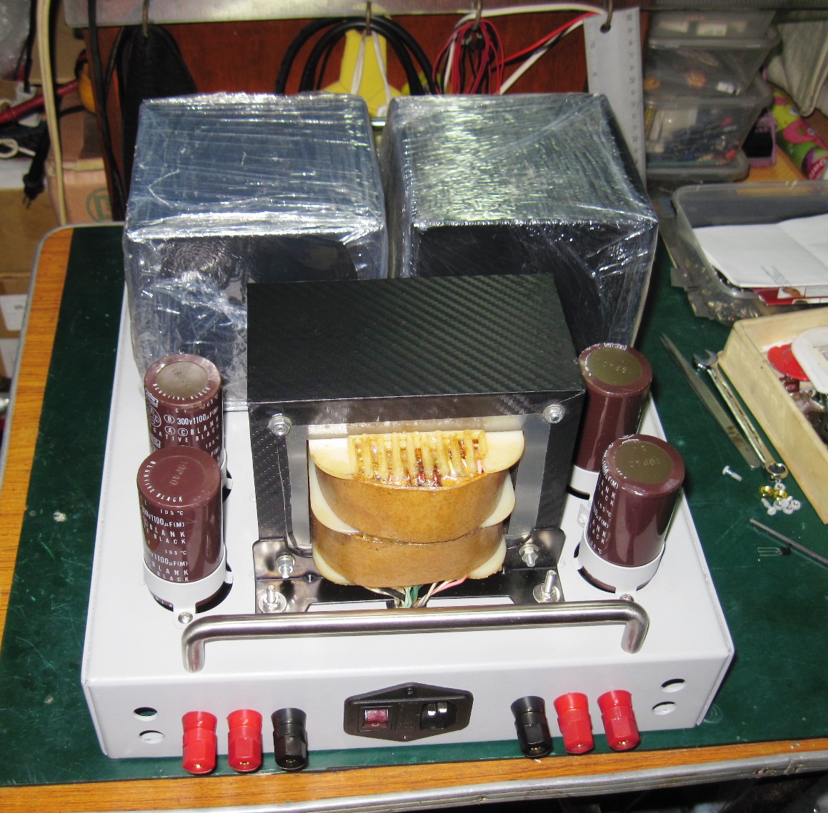

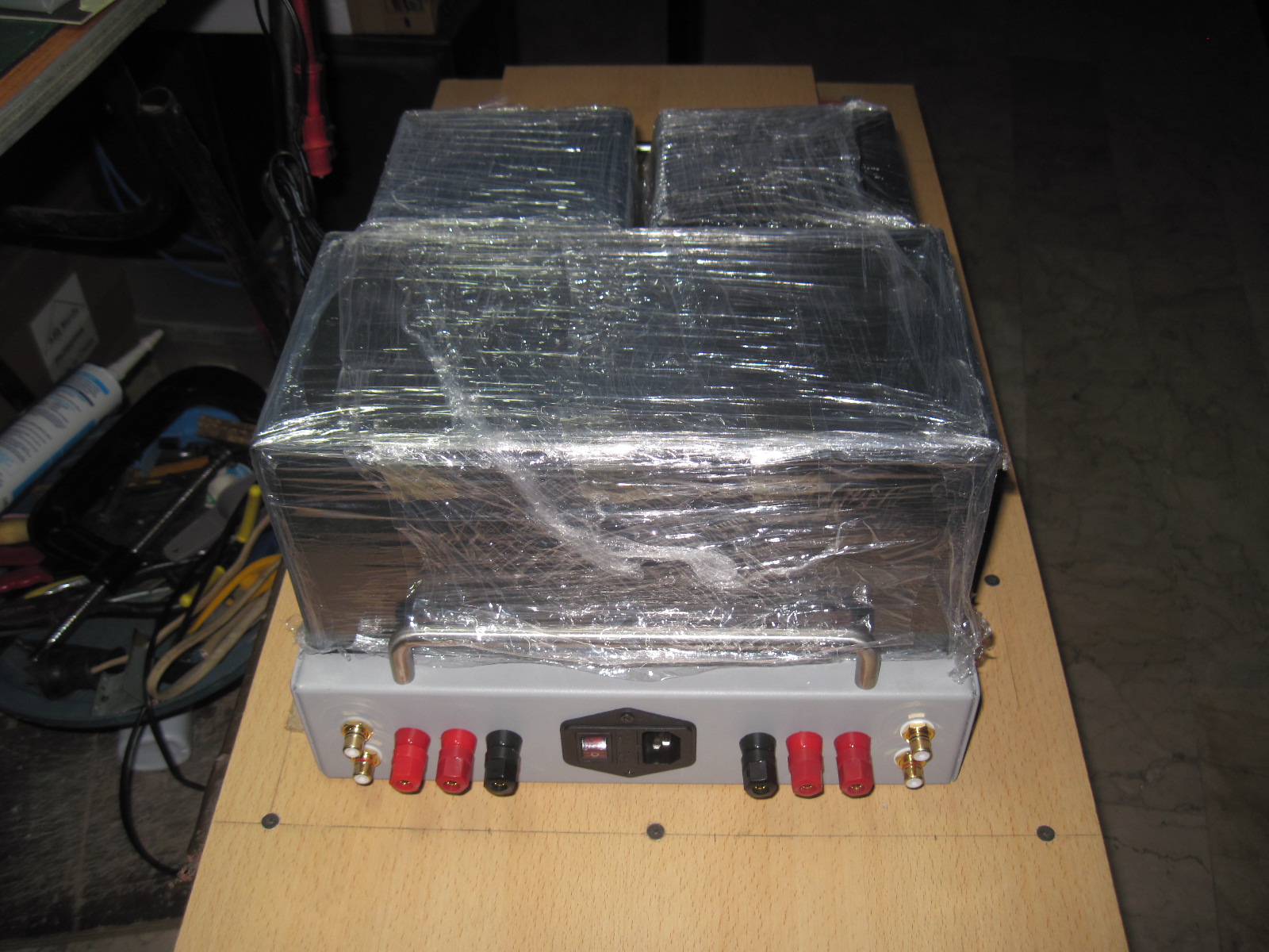

this is a 4d32 set that i am working on:
i had boxes made out of BI sheets gage 16 and then powder coated black...

for power traffos yes....i have seen amps humming because of the steel covers, and sometimes even end bells can hum....so aluminum covers can be used instead...in these cases potting helps in order to remove annoyances...

Hi AJT,
Looks great, nice construction, but as I ask, is there no regular spacing between the transformers and tubes? I measure on my Cary and the ASL that I have and it is at least 1 inch or greater. To All, Should I assume 1.5 inch spacing is good?
