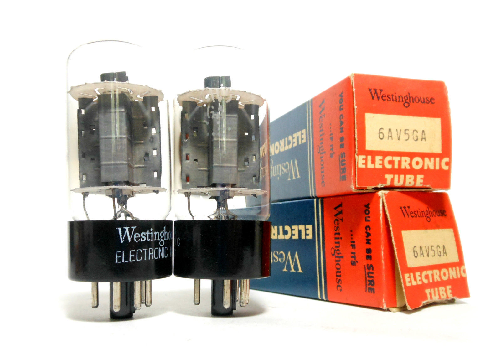

Hose 6c4c tubes I have will need DC filament supplies to avoid hum, which is another level of hassle, plus they each need a separate power transformer winding. I looked around my hobby room and I don't have a suitable power trafo. I don't know if I have patience to go with dc heating. So, next option is a different output tube with indirectly heated cathodes. I could grab a couple of those 6av5's. That would get me in the game here - using transformers that I already have on-hand.

Hi Bigun, I started another project and it too uses 6AV5GA's. Triode wired the curves look identical to the 2A3. I was thinking push pull, something like the Brook 12A.

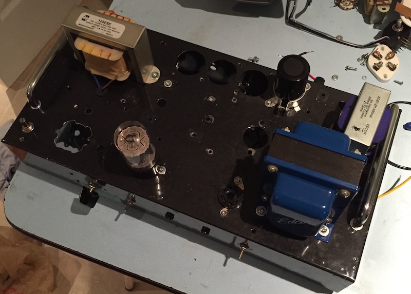

I dug up some bits n pieces and my experimental chasis - which is getting to be a bit of a mess.
I got an Edcor XPWR105 which provides 180-0-180 at 250mA and a single 6.3V winding good for 3A. I figure a SS bridge rectifier across the HT winding and fed into an inductor will give me a B+ of around 300V and I'll tweak it with a small input cap to get the voltage up if I want. I also got a Hammond 270FX 275-0-275 but it's wired into another amp right now - one which I don't mind stealing from if necessary.
I got an Edcor XC87-2H-300mA choke to use as the 'choke input' for the bridge rectifier. This might not be enough Henry's but I also have a pair of Hammond 158M's in the other amp which would give me 10H at 100mA. The Edcor has the benefit of being screwed onto chasis already and would suffice providing I'm drawing a decent current through the power output tubes.
And I got a Hammond 125ESE output transformer on there too, mounted well away from the power transformer and that choke - which will be the source of a nasty pulsed magnetic field so it's hiding over at the back corner there.
The one tube you can see there is a 6AV5 I got recently off ePay.
Nothing wired up yet though.
