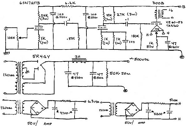

The three stage 6SN7 --> 6SN7 --> 2A3 (or 300B) has been done to death.
Flesh And Blood The Reichert 300B Article By Herb Reichert
I heard that amp on a number of occasions, with a 300B. I remember it was pretty good, but a little 'dry' sounding. Maybe that would be nice using a paralleled pair of 2A3's instead of the 300B, after optimizing the driver a bit.

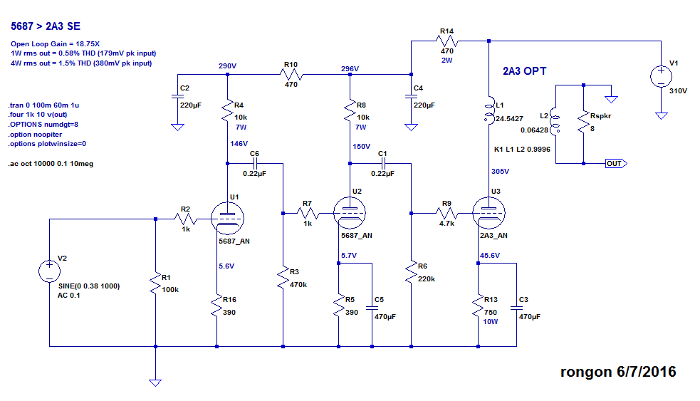

If you decide to do a simple, three-stage design like all the various ones that use a 6SN7 and a 2A3, think about changing that 6SN7 to a 5687 (or its Russian near-equivalent, the $4 6N6P, or the JJ ECC99 tube is also very similar). You will need more current from your power transformer, but not much more.
What's so great about the 5687? Nothing other than that it has quite low plate resistance and fairly high transconductance, so it will drive the 2A3's grid very well, even possibly goosing a little into grid current before it gives up.
A 6SN7 triode's plate resistance (rp) is about 10k ohms.
A 5687, 6N6P, or ECC99 triode's rp is about 3k ohms.
The other advantage the 5687 has over the 6SN7 is that the 5687 can work reasonably well with a much lower B+ voltage than can a 6SN7. 6SN7 works best with B+ of 350V or higher, while you will probably only have 300V available.
Two stages of 5687, each with a stage gain of about 10X, will give you about 100X gain. That means you'll be able to drive that 2A3 to full power with only about 0.5V signal input. That's a nice spot.
With a 5687 and a 300V B+, a 10k plate resistor, and plate current of 15mA, the 5687 plate voltage (plate to cathode) will be about 150V and grid bias will be about 6V (cathode resistor = 390 ohms or so).
6N6P or ECC99 would use similar values, but have different pinout (wiring).
I think that would make a pretty goof-proof circuit that should work well. The 5687 is almost like a little power tube, which makes it a really strong driver tube.
I whipped up a spice simulation of the circuit and it turned out really well. Or at least LTspice thinks it's good. Here's the circuit diagram (attached).

And an update...
I threw a 6SN7 into the circuit, both with about 7.5mA plate current. First stage has a 22k plate load resistor, second stage a 15k plate load resistor. The low value on the second stage is because of the low B+. In order to get enough voltage swing out of the second stage, the value of plate resistor had to be kept lower than optimal so that there's enough plate to cathode voltage (and thus a 'tall' enough bias voltage).
The end result is that the 6SN7 works, and spice actually predicts slightly lower THD, but there's more 3HD than with the 5687 doing the driving.
So, as predicted, the 5687 does better in this particular instance because of its lower rp and higher transconductance, which allow it to work better with the low B+ voltage available.
