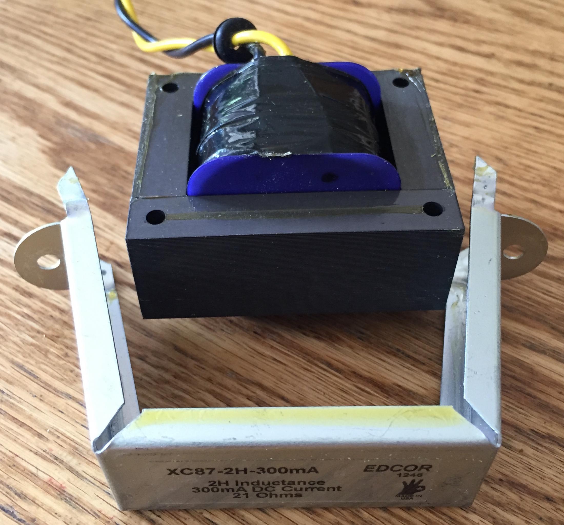

The hum is mechanical, I've only put together the power supply so far and the load is a resistor between B+ and ground.
I took the choke off the chassis and put it on the bench. It buzzes alright. But if I pick the choke up by grabbing the mounting flanges with some insulated pliers and suspend it in mid-air the noise almost disappears. So it's mechanical buz being transmitted from the choke to the chassis. It may be solved with some rubber grommets between the choke flanges and the chassis. I'll take a look at that after dinner....

I tried mounting the choke on rubber grommets but the hum is still too annoying - good enough for experiments but not for a final build out when the time comes. I used a pencil to probe for the vibrations, holding the wooden shaft and pressing the point against the choke at different places. There was one spot where the vibrations could be readily felt and no other spots that I could find. This one spot was on the ver top of the choke, on the metal strap with the manufacturers label. Holding the pencil point against the side of the laminations or the plastic bobbin didn't feel vibrations. I may take the choke apart tonight.

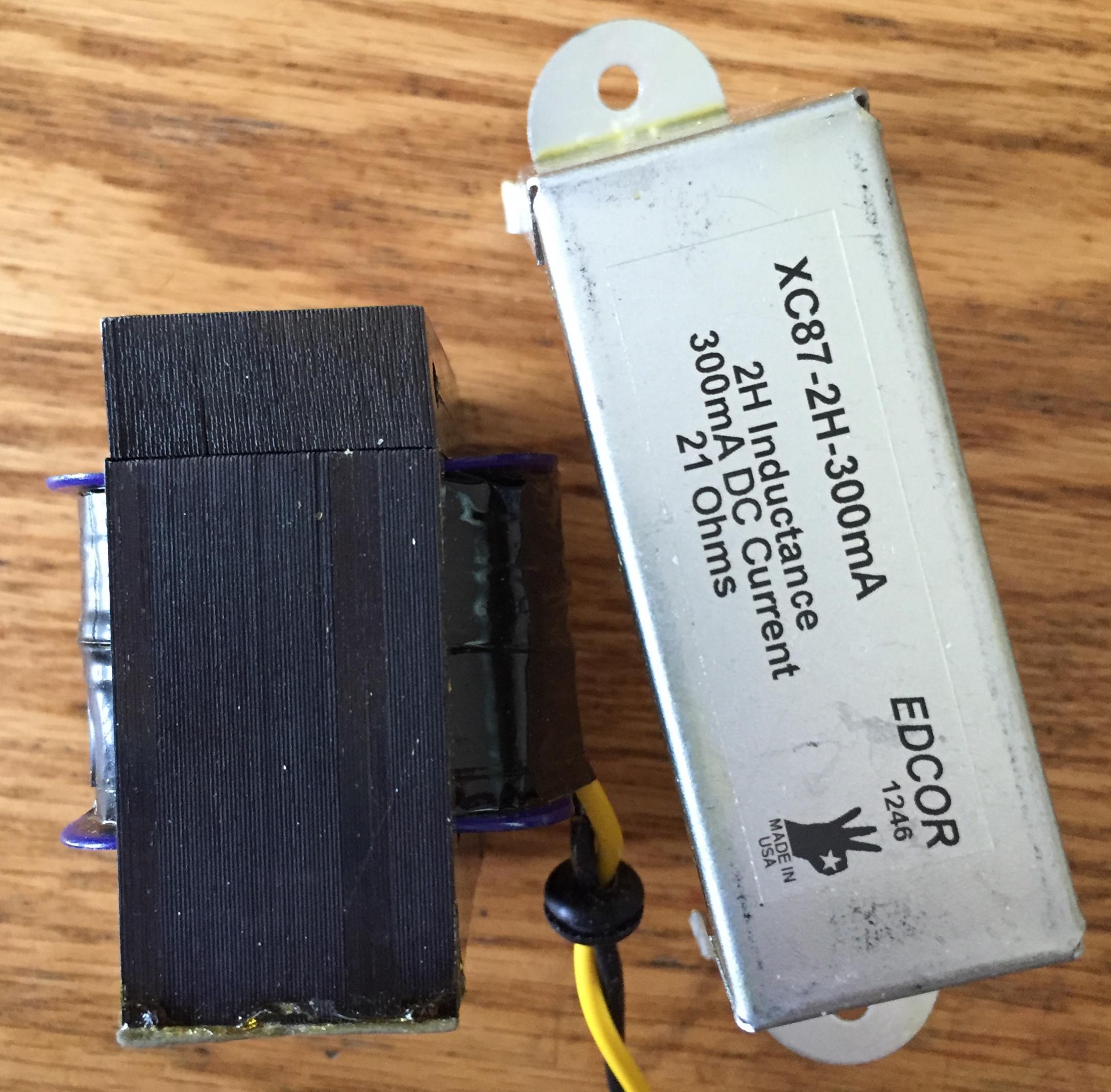

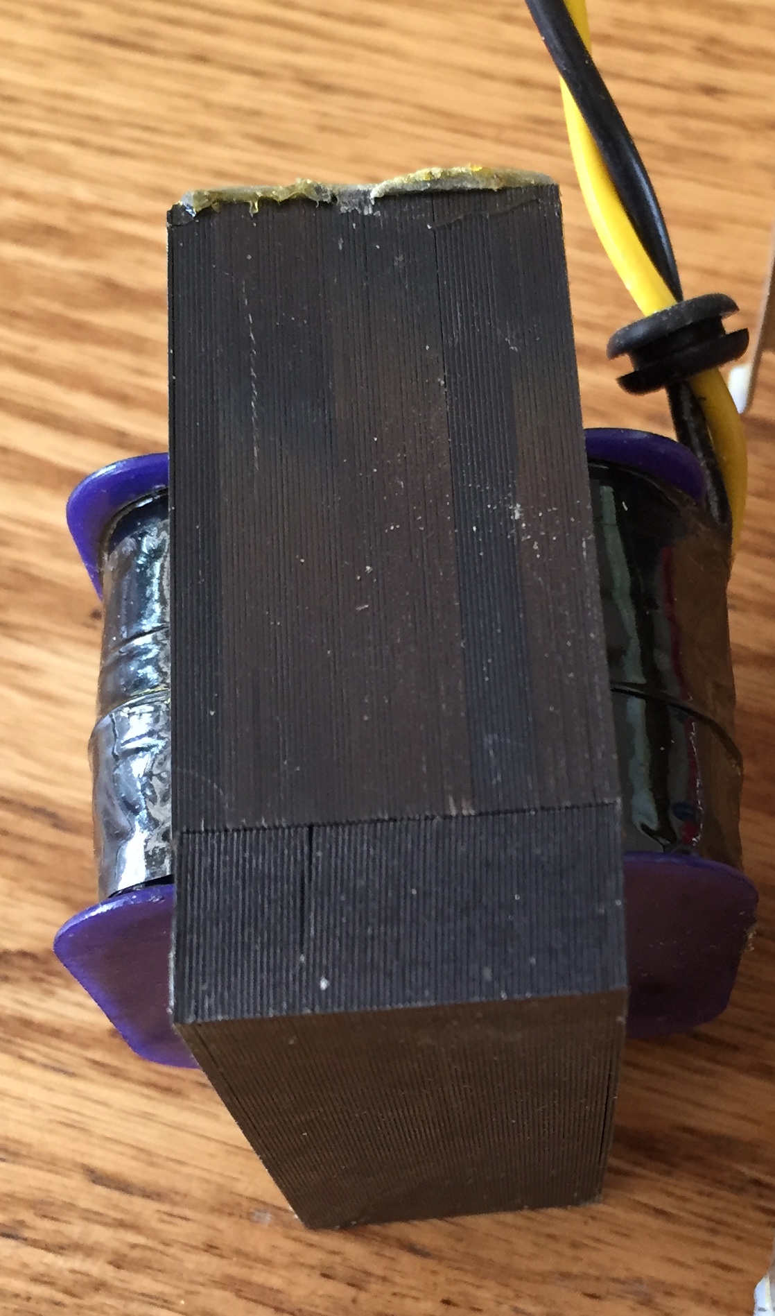

Well I took the mounting bracket/flange thing off the choke. Photo's show what I found inside. If you look carefully you'll see it isn't the best quality job you could imagine. The I-laminations are slanted sideways and there are a couple of places where they have internally delaminated.
I powered up the circuit with the 'naked' choke installed and sitting on a pair of rubber grommets on the bench top. It was quiet - so no issue with the 'naked' choke. Of course, I could still feel the vibrations on the top of the I-laminations through a pencil point.
I'm not sure a soaking in varnish will be beneficial, but I suspect that I need to fill the void between the laminations and the mounting bracket.

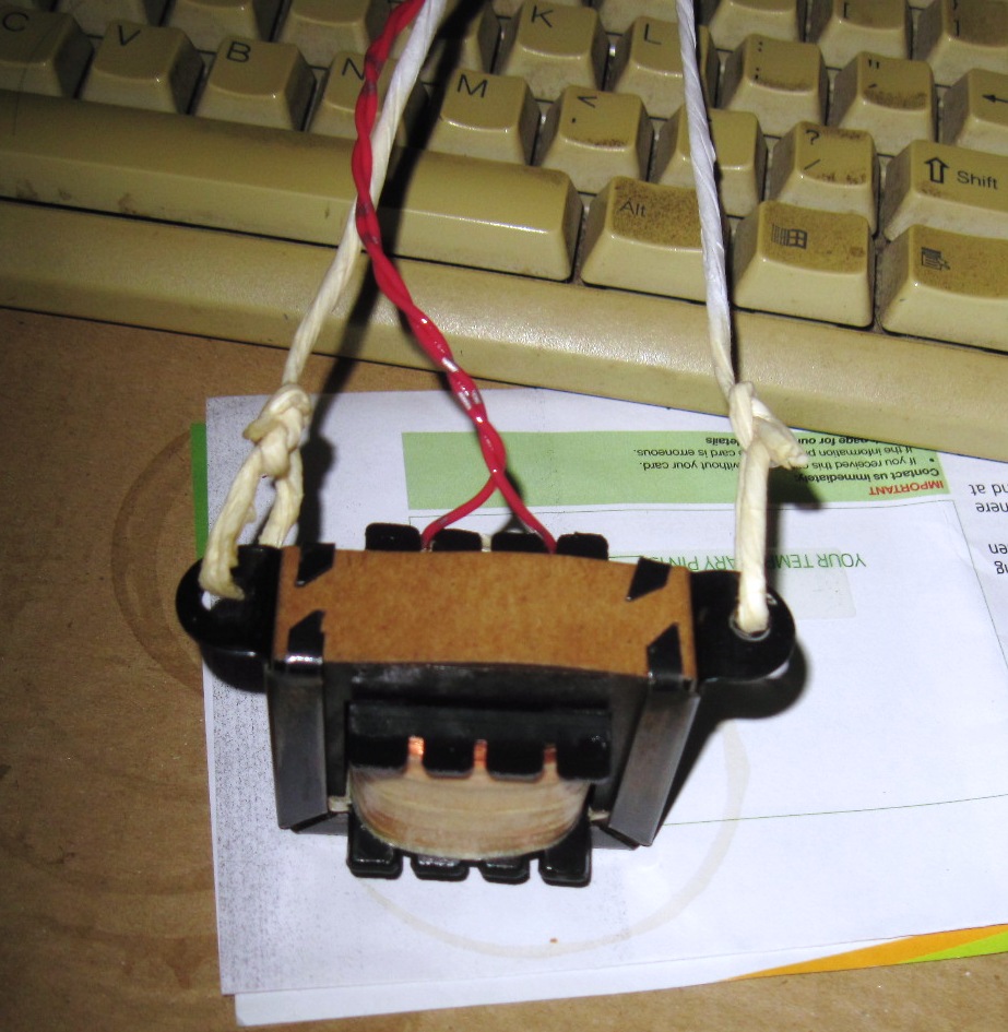

i do not see the slanting as a biggie...when you dip in varnish, make sure you complete the assembly.....
you may find out that the bracket does not hold well, so putting a cardboard cut to the size of the bottom side will help....
since your choke came off as a single piece, you can wrap the sides entirely with cardboard in such a manner that you are still able to put back the bracket...

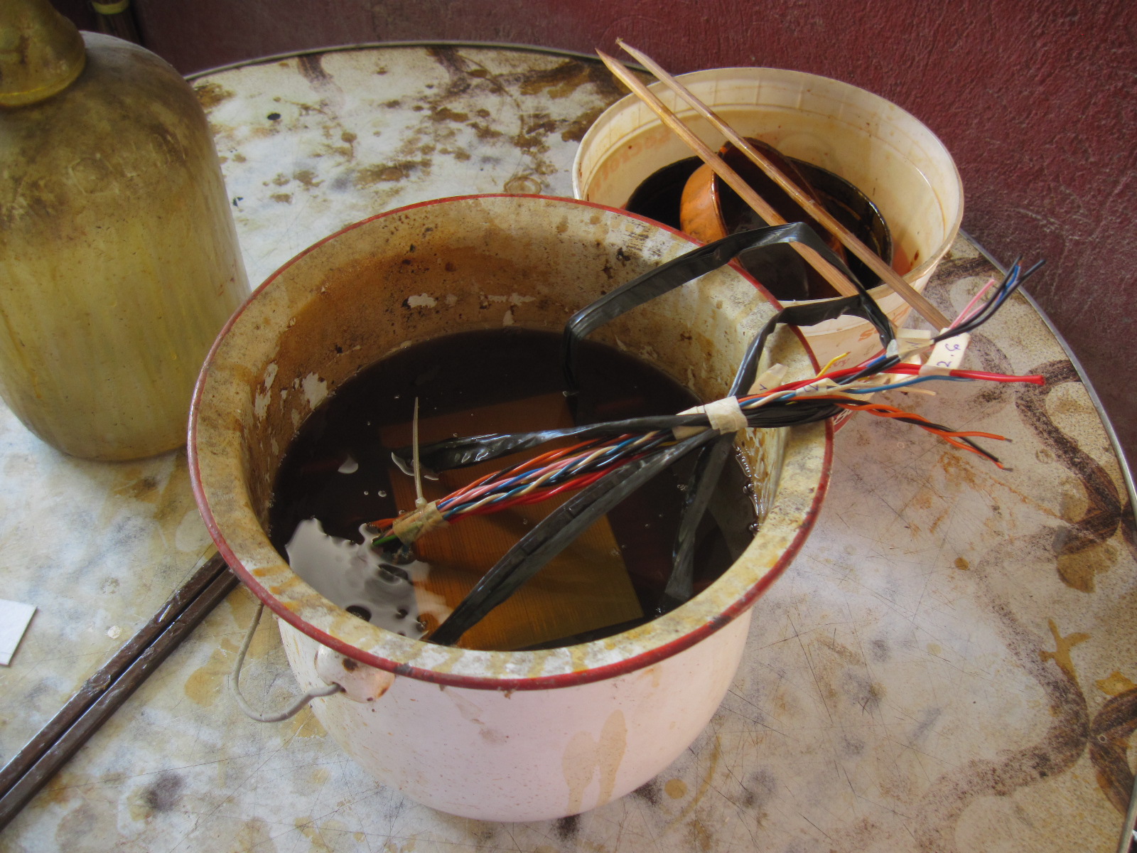

got to love the smell of that varnish 🙂
I have a VIP machine which is around -6 atm , still can put all your choke in a batch and bake it to 250 F
it sure is a lovely smell....😀
i hope to be able to diy a VIP machine someday....i'll get there soon...
but since the heat index here can be in the high 40's in summer, air drying polyurethane varnish is all i need...
