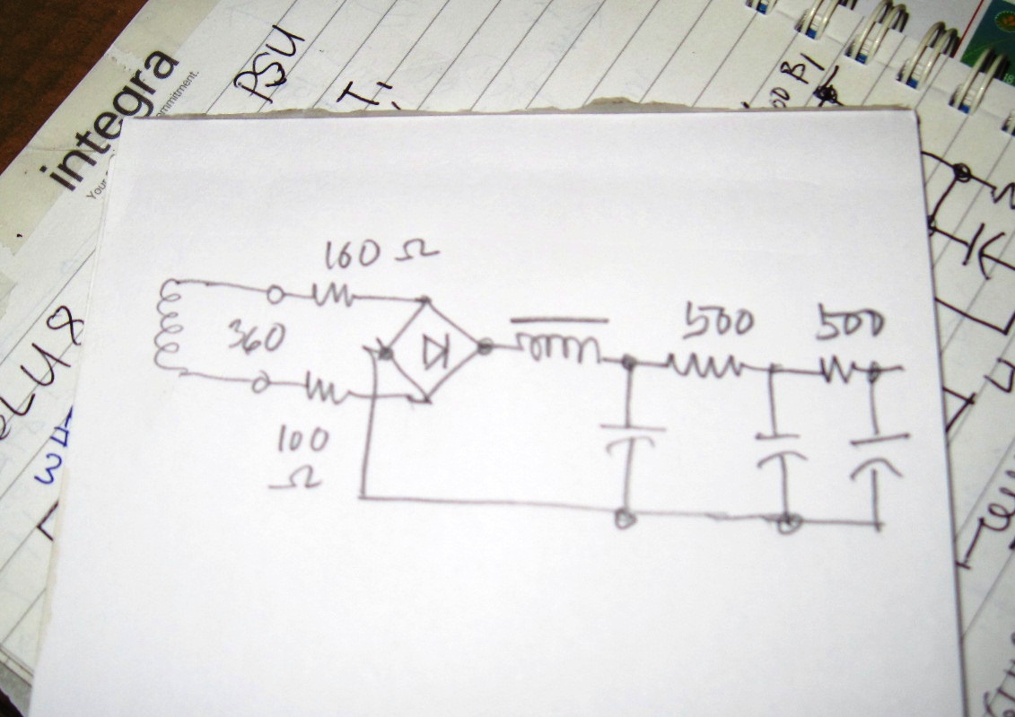

Bigun, this is what i would do with your transformer and psu....
you do not have to do all at the same time...
1. series resistor with the traffo secondary
2. RCRC filtering after the choke....start with one section and then add as needed
3. values shown are estimated, actual values can be different...

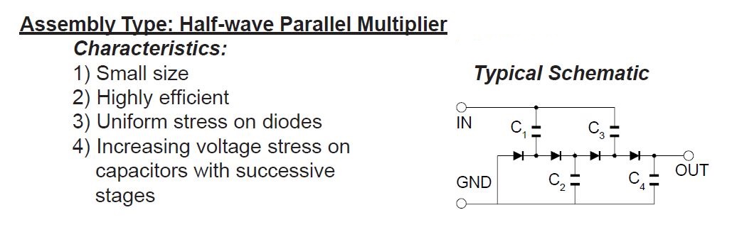

AJT,
You'll get no argument about the 2 diode "full wave" doubler from me. As it was good enough for Hegeman, McIntosh, Fisher, et al., it's quite good enough for me and I frequently employ it.
My concern lies with a multiplier that is tapped for more than 1 voltage. Having the same ripple freq. in all rails strikes me as being "best". The simplest, efficient, multi-tapped multiplier that exhibits a common ripple freq. is the 1/2 wave parallel configuration. Use good sized stage caps. and LC or RC sections at the taps and the results will be satisfactory.

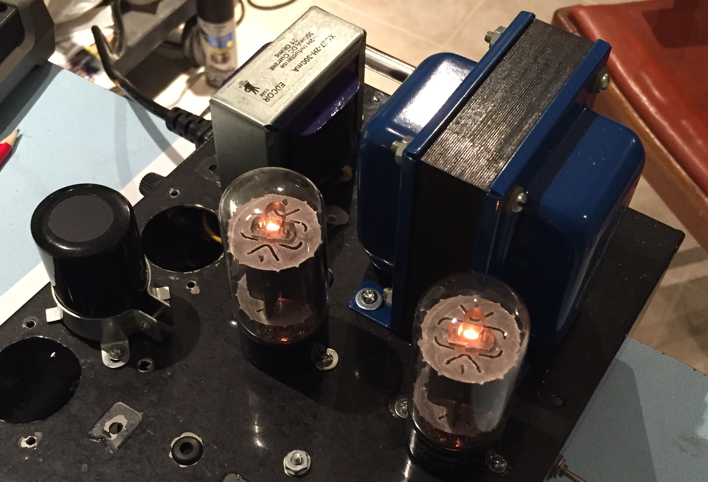

I have put the choke back on the chassis. I found that the varnish has all but fixed the problem - good call you guys in pushing me to try it. I've removed C1, it's a pure choke-input supply now.
The temporary B+ load resistor gets way too hot fast so I wasn't able to do much. So I decided to wire up the power tubes to provide a real load for the B+. I installed another Octal socket.
Both sockets are wired up with heaters, g2 is connected to plate through 100R or 200R resistors (i.e. triode-wired). Cathodes are wired to ground through 1k resistors and both g1 have 1k or 2k2 stoppers at the socket pins. As I have only one OPT on the chassis I have grounded the input of one tube, the other is wired with a 560k grid leak resistor to ground. No Ck's installed yet.
This set up gives me a chance to check that all is well at d.c.
Powered up I get 317V B+ under load. I get 44.7V / 47.7V across Rk, so I'm running at 44.7mA / 47.7mA respectively.
It's a start - nice to see something glowing.

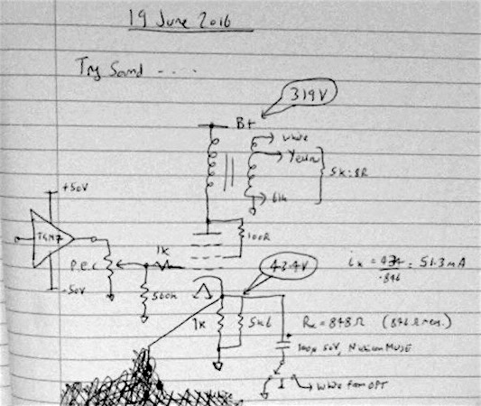

I made a hybrid amplifier, my first ever... so I wired up the RCA socket directly to the grid stopper, dc-coupled. This allows me to drive it from my SS amplifier which has +/- 50V rails so I can adequate swing on the grid. This is my TGM7 [http://www.diyaudio.com/forums/solid-state/239418-tgm7-amplifier-based-greg-ball-ska.html ]amplifier, minuscule distortion so it provides a nice way to test the output with the cleanest of cleanest driver stages.
I added a 5k6 resistor in parallel with the 1k already on the cathode to give me around 850R. This measures out at 51mA of cathode current - reasonable. Cathode bypass added was a Nichicon MUSE 100uF 50V electrolytic as I have a fondness for them.
A little hum could be heard on my Audio Nirvana [http://www.diyaudio.com/forums/full-range/217893-bigun-audio-nirvana-super-15-a.html ] mono speaker.
Compared with the TGM7 direct the sound was very good - bass was very strong, hard to tell if there's really any difference between the TGM7 direct and with the 6AV5 + Hammond 125ESE in the signal path. Wow, I didn't expect that.
