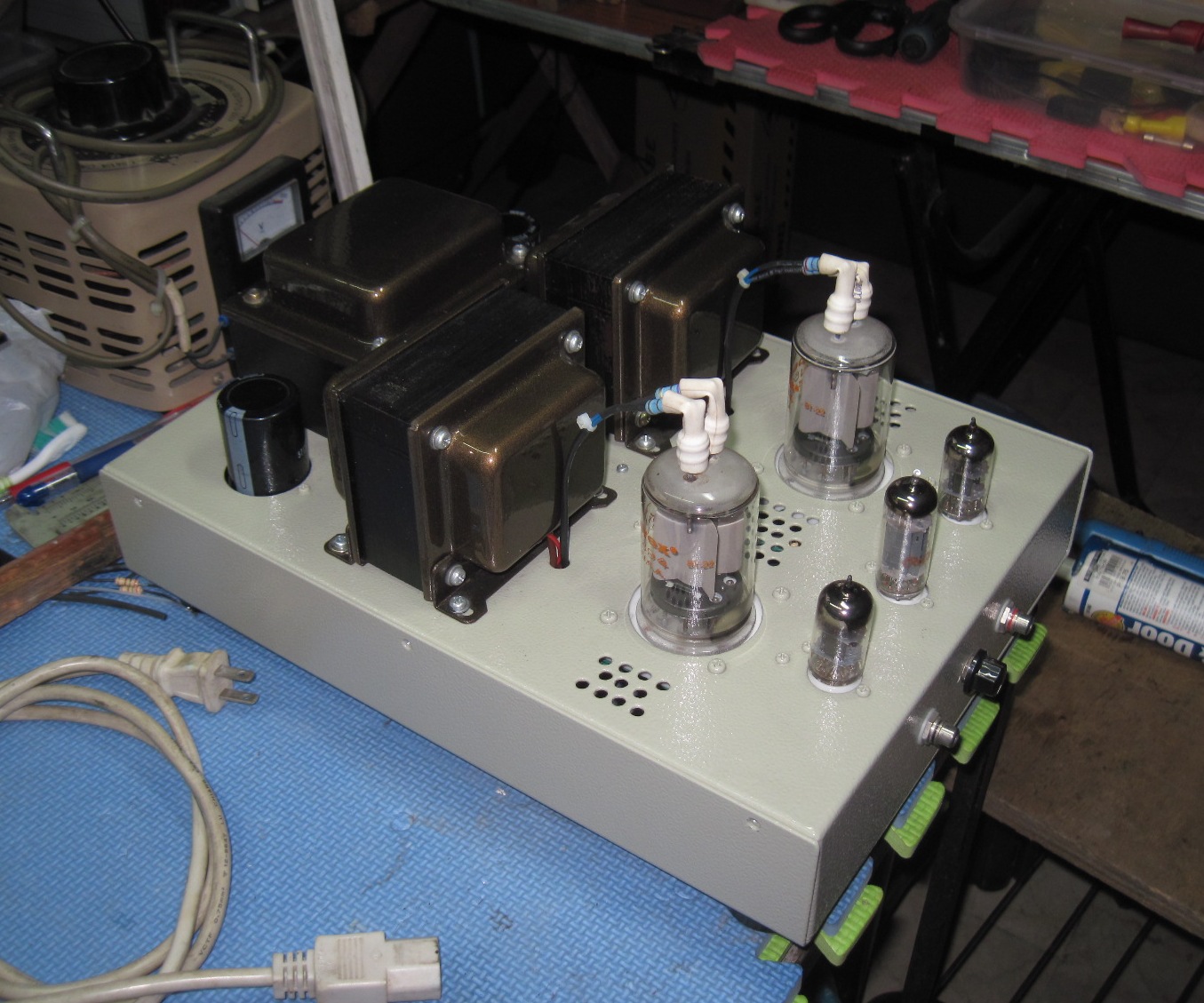

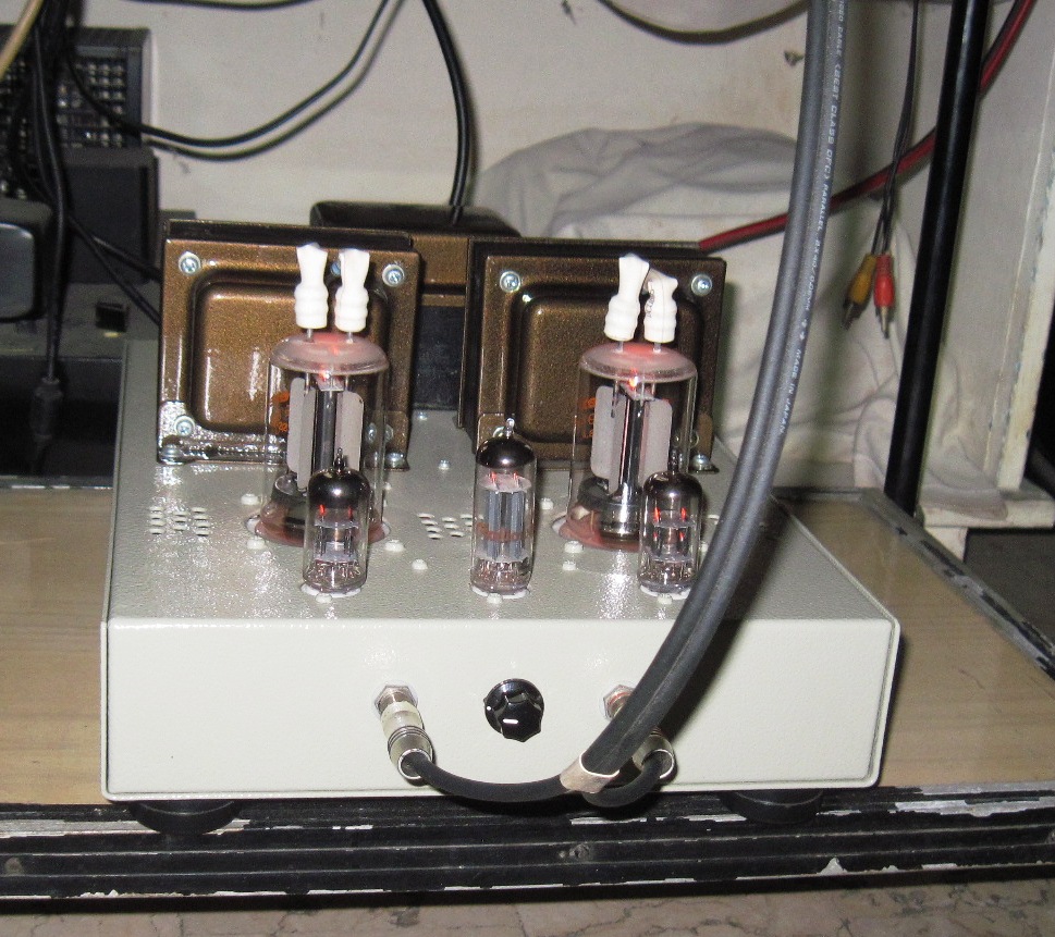

FWIW, in my 5894 set amp build, the output stage runs from a lower B+ than the drivers, a 12at7 aikido style voltage gain stage feeding a 6cg7 cathode follower running off a B+ of 420 volts dc....the output tube runs 30 watts plate dissipation......
