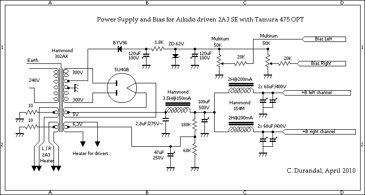

The output transformers you have are not optimal for parallel 2A3's, first they are designed for 60mA of current and also the load impedance would be too high, unless you have 4 ohm speakers you plan to use which would reflect a lower load. But still you would only be able to bias each 2A3 @ 30mA.
I use turret boards and I really like them a lot. My latest amp I used tag boards but most of the time I use turret boards.
I would just go ahead and use the Hammond transformer, it should work great for your application. The only thing I would think of doing is getting a separate filament transformer to power some DC regulator boards for the 2A3 filaments, this will help the Hammond 302AX run cooler too. Maybe an option is to run the two 2.5v windings on the Hammond in series and full wave rectify it, I believe the DC current would be equal to the rated AC current rating, A bridge rectifier would stress the windings too much.
Edit: I think for Rod's board the minimum voltage is 6.9v for one 2A3 which is 2.5A. For two you would need 5A which requires 13.5v min.

Thoughts
So FMB (famousmockingbird) , easier to type. I want to build the PSE posted. The 302ax is is not capable of supporting the build. What power transformer do you recommend to achieve what I would like to do? I could save the 302ax for another build.
Thanks,
Ron

This looks pretty good to me. Seems like a lot of smoothing in the PSU circuit. I also like the bias circuit. Gonna put together my purchase list next week. Any thoughts on this design?
thanks!
Ron
