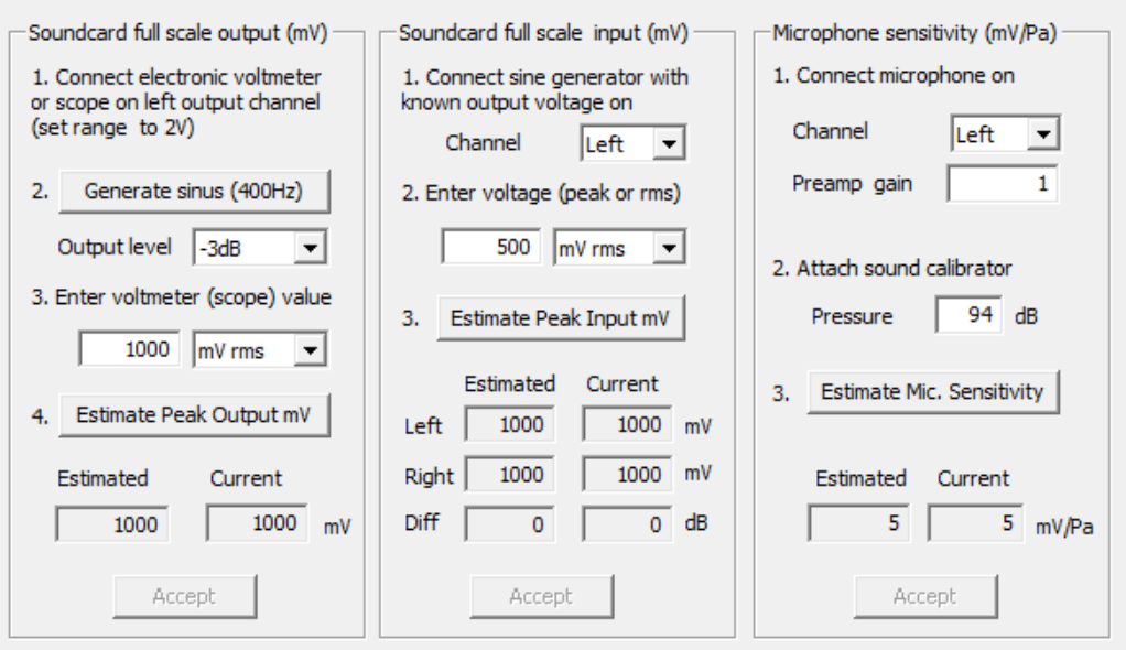

Im playing around with the calibration, i have no issues calibrating the sound card but i struggle a bit when it comes to "Microphone calibration"(Page 42):
http://www.artalabs.hr/AppNotes/ARTA Handbook Version 2.4 English.pdf
The box in ARTA states "Microphone sensitivity (mV/Pa)", is this something that i need to worry about if i don't care about absolute SPL? I guess that i don't care about that atm? HELP!!
Btw, i found a calibration file for WM61A:
http://www.holmacoustics.com/downloads/MicrophoneCalibration/Mic_WM61A.cal
http://www.diyaudio.com/forums/soft...lse-measuring-frequency-impulse-response.html
I know that this is not the exact calibration of my specific microphone but i guess its better than running without?

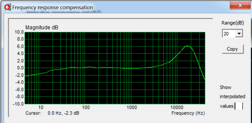

I added the microphone WM61A calibration data to ARTA and i got this graph showing the calibration curve:

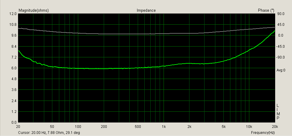

Okey, today i did another set of measurements with some further changes.

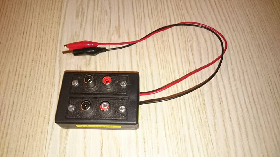

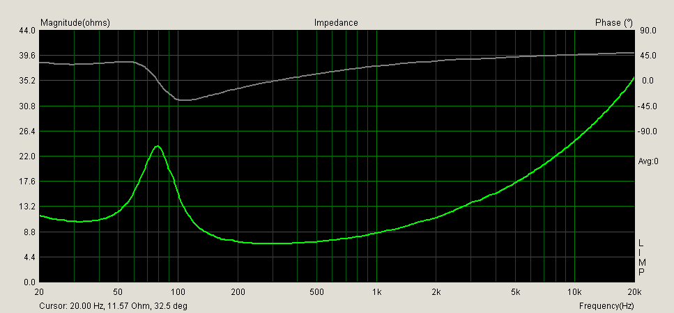

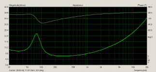

Impedance:
-I constructed a simple measurement box to get it all soldered in place and eliminate some of the resistance of the lousy cables i was using. Now i could lower the cable resistance to 0.9ohm.
-I also did a calibration in LIMP
Now im finally pleased with the impedance curves, if i compare the Tweeter curve to the one on the spec sheet http://spicaspeakers.com/pdfs/peerless-801730.pdf it is close to identical 😀

Impedance:

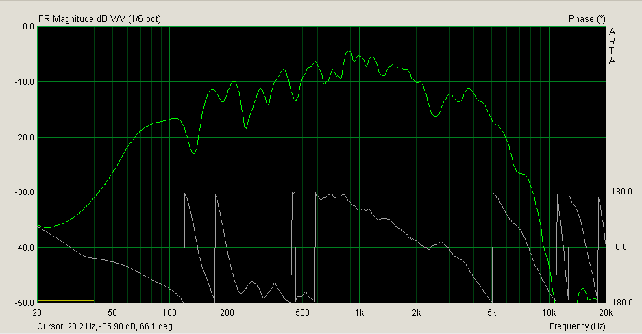

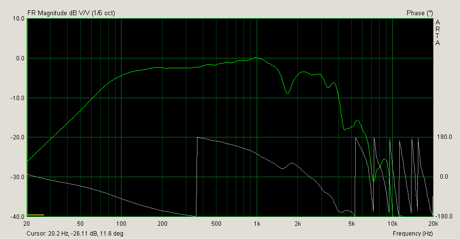

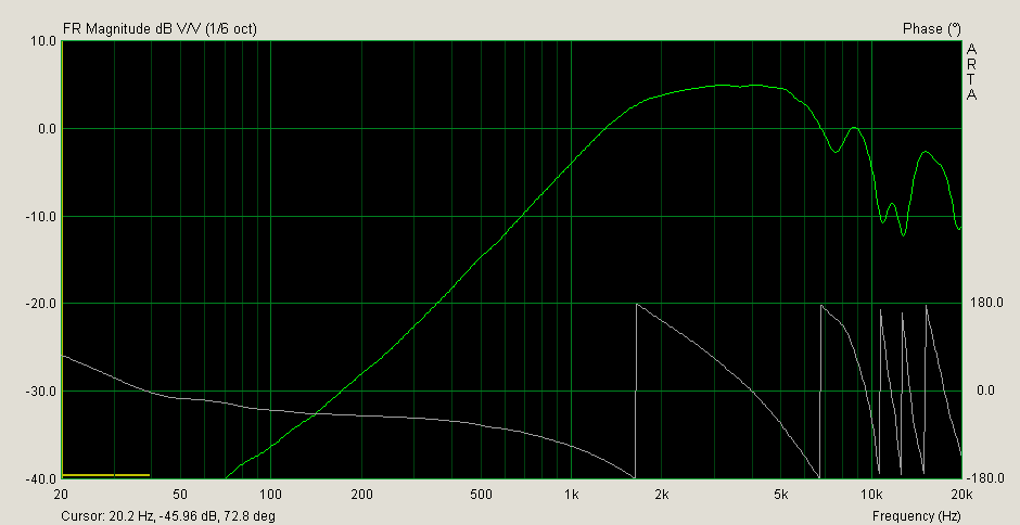

FR farfield measurements was also changed by:
-Calibration of output and input in ARTA(ignored mic sensitivity)
-Added the generic WM61A mic calibration file mentioned above.
-1/6 oct smooting
Farfield measurements at 2,83V gate started at 6,125ms, 1m. 102cm from floor.
Tweeter:
Woofer:
Tweeter+Woofer:
Woofer wall:

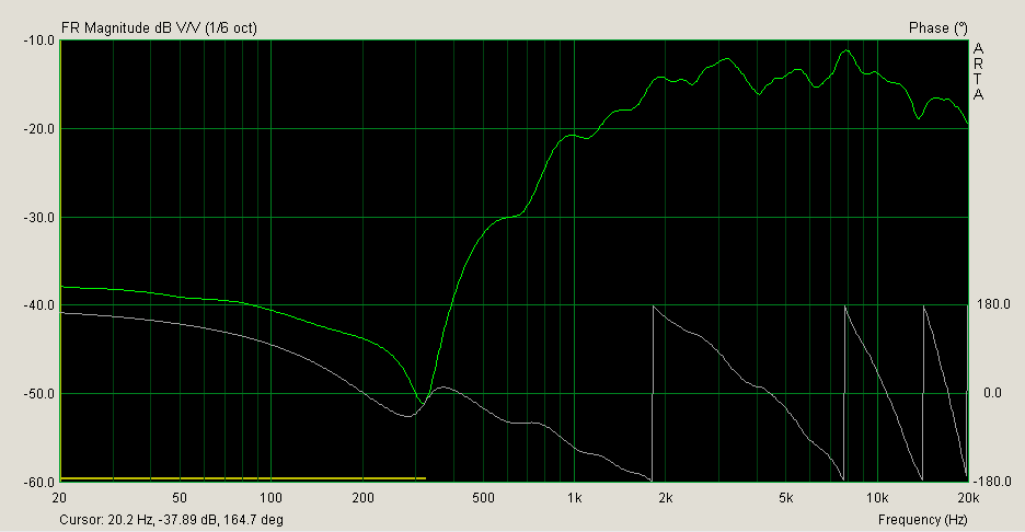

Woofer wall extended gate for farfield down to 40dB just as a test:

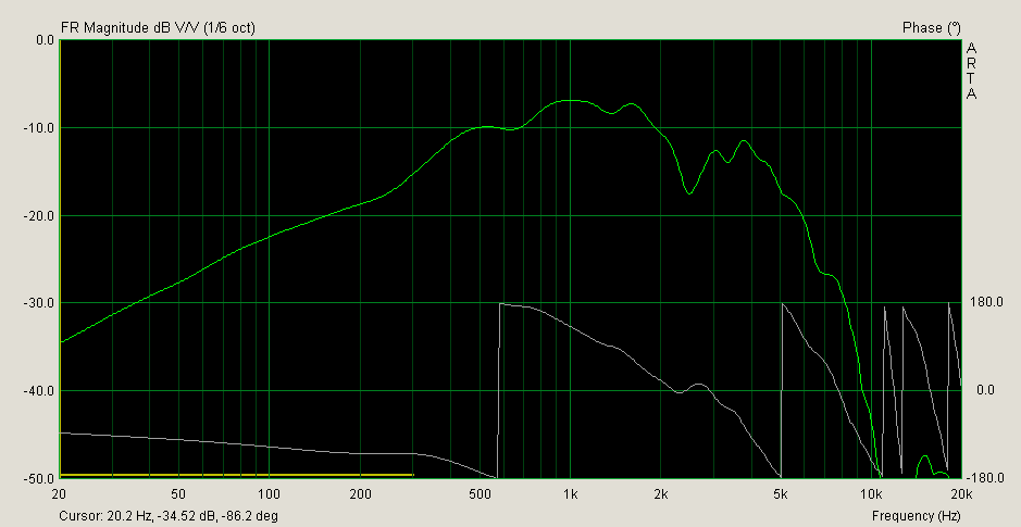

-1/6 oct smooting
-Lowered voltage to 0,226V due to clipping.

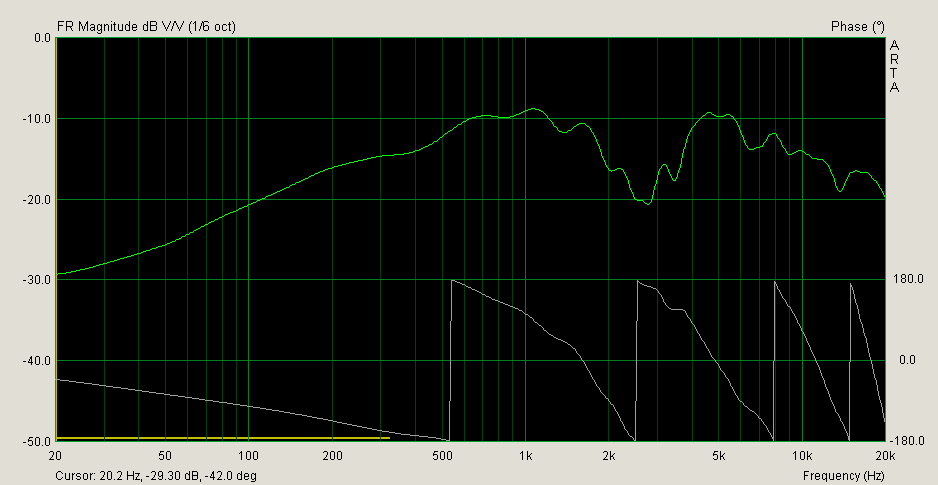

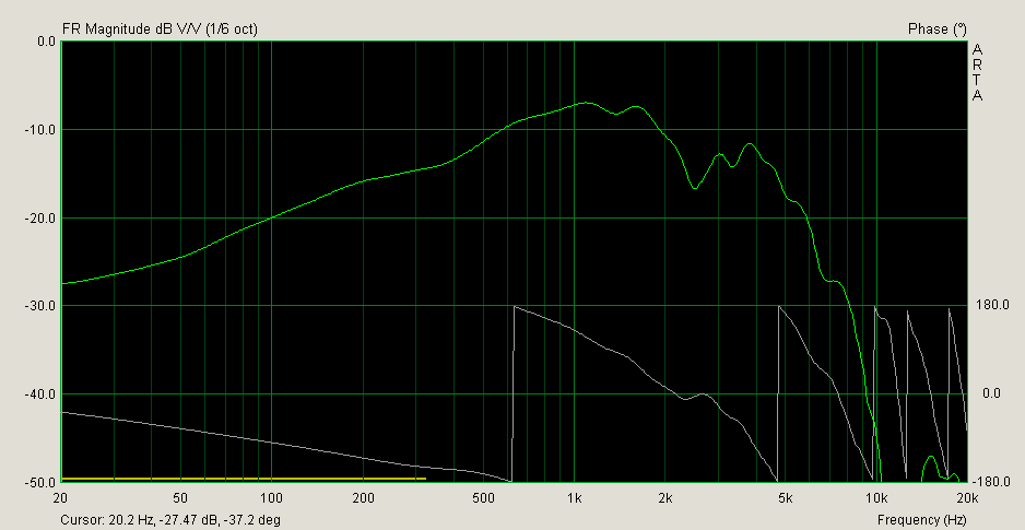

Nearfield measurements at 0,226V gate started at 6,125ms, 0,4cm from driver.
Tweeter:
Woofer:
-1/6 oct smooting
Tweeter:
Woofer:

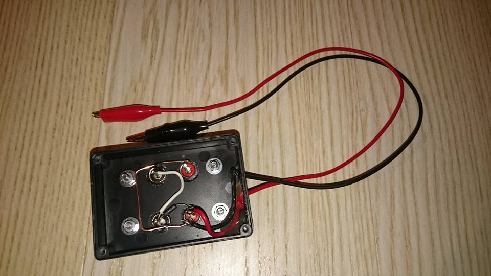

And my new little impedance tester, including a 100ohm 1% 1W resistor.
I actually think i might have something decent here. Next thing is to combine nearfield and farfield somehow 😛 Then maby, just maby, we can continue actually designing a crossover for this godforsaken speaker 😀

Thanks for posting the link for the WM61A mic calibration file. I hadn't seen that before. I will use it for my measurements.
One thing I noticed is that the shape of the calibration file curve is very close to the frequency response for the microphone in Fig III of John Conover's article but the level at 15kHZ is about 3dB up in Fig III and 6dB up in the calibration file.
Which one is best to use?
Have you decided how you will blend the Near and Far-field measurements?
A piece of software that might help you is The FRD Response Blender and Minimum Phase Extractor by Charlie Laub and Jeff Bagby.

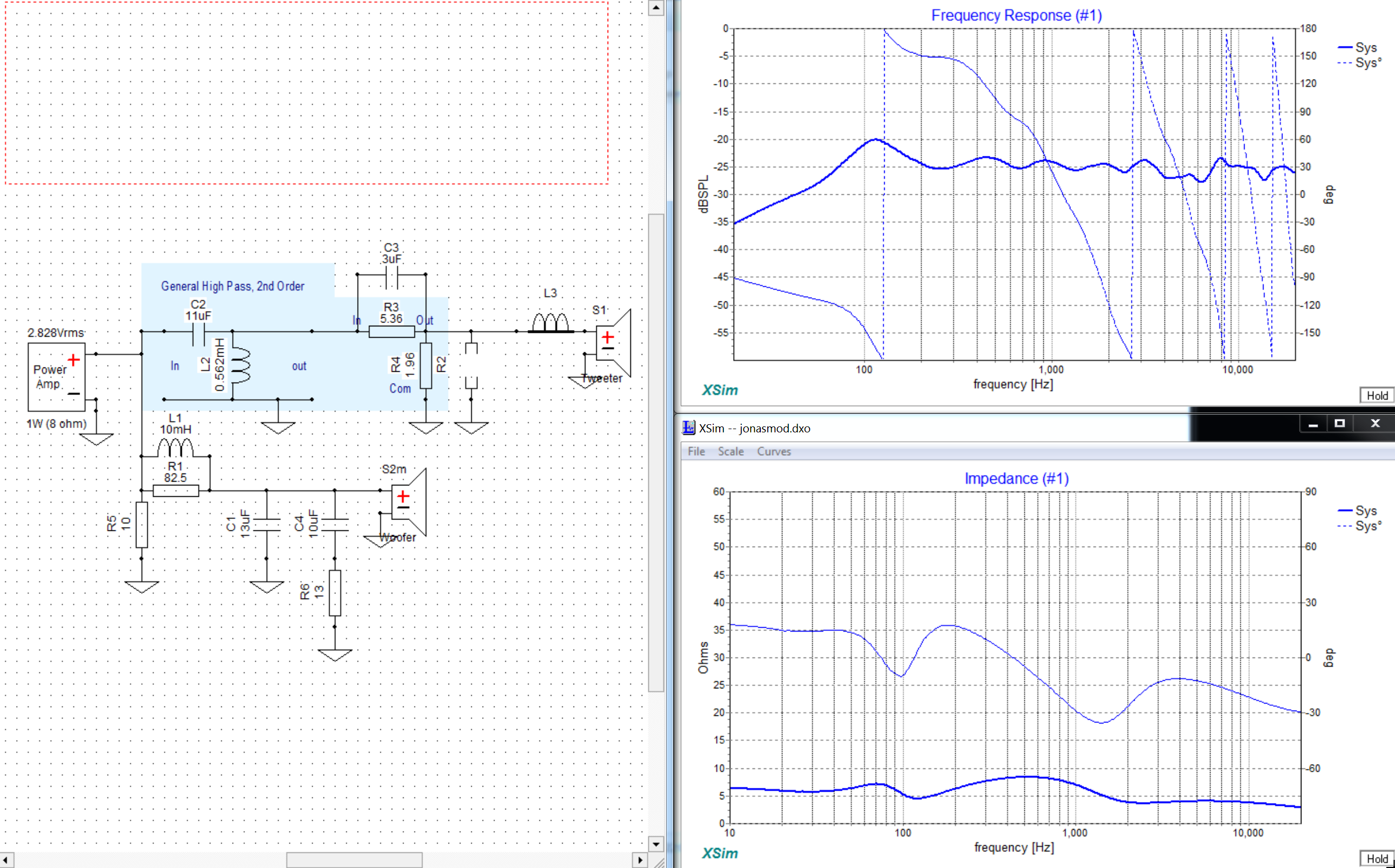

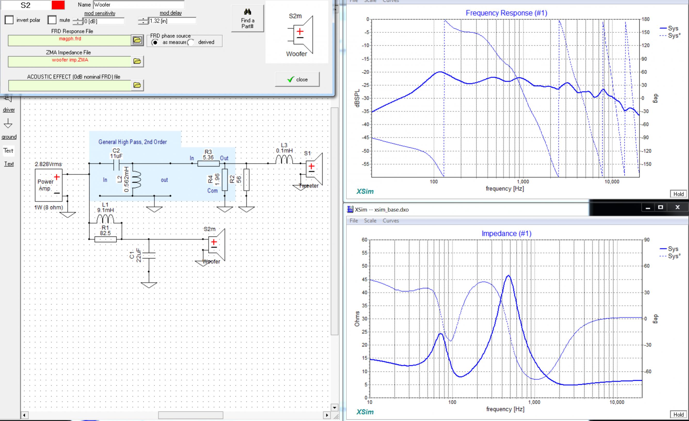

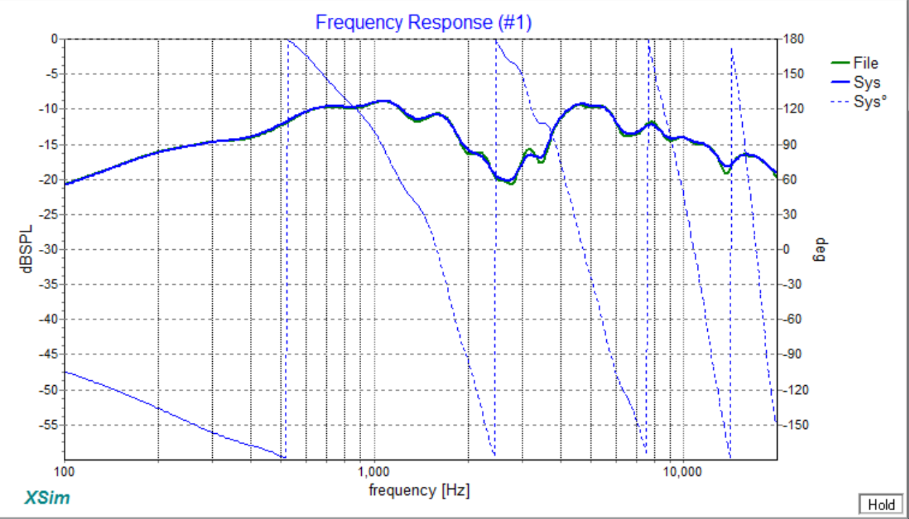

Okey, so i finally started to play around lite in XSim. First i started to find the correct woofer delay. Last time i did this i had to invert the polarity of the woofer and +0,77in delay.
This is what i got without inverting polarity and adjusting woofer delay to +1,32in 🙂
One question, in the delay adjustment above i used the woofer+tweeter data from the middle of the room and impedance, i figure thats correct but should i then change to the woofer data with the speaker in listening position(next to wall) for the remainder of the crossover design?
This is your crossover design unmodified but the following things changed:
New woofer(wall)+tweeter FRD files valid 300Hz+
New impedance ZMA files
Woofer delay no longer inverted and delay adjusted to +1.32in
Mod sensitivity changed from +20dB to 0dB on woofer and tweeter.
Changed output to 1W to match the measurements 🙂
eriksquires: I played around a little bit more adding some parts of your initial crossover design to the XSim project you uploaded. I also tuned some components with the goal of getting as close to the -35dB line as possible. I still have a dip in 4-6kHz that i don't know how to get rid of though.
I also removed the phony components in the tweeter circuit, i figured that they were unnecessary now when i have the correct impedance curve for the tweeter?
I also added back R5 to correct impedance, but i don't know how low i can set this, the lower the value of R5 the straighter the impedance curve but the lower the impedance, what is my goal here?
Very nice work! I think the overall design looks fairly good. I might say it's a litte bright, but you can adjust that by changing the speaker toe-in (left to right angle relative to your head).
The goal of the impedance equalizer is to keep the PEAKS from being outrageous (30 ohms or more) without lowering the impedance too much (1 Ohm or less change preferred). Staying above 4 Ohms is important, especially with most receivers. If you use a parallel resistor the usual values range from 60 to 100 Ohms. It's main use is for tube amps but also to ensure you don't get ultrasonic oscillations. Power stealing events that you can't hear directly. It really should be the very last thing you worry about in crossover design.
Yes, the phony components are not needed now that you have real Z (impedance) data. They were just there to assist with the modelling. Like masking tape you put on a floor to help understand where the bed should go. 😀
One more thing to check is the inverted tweeter response. Invert the tweeter and you should get a deep and symmetrical null. 10 dB or more, but also it should be a nice smooth dip, not a ragged valley.
