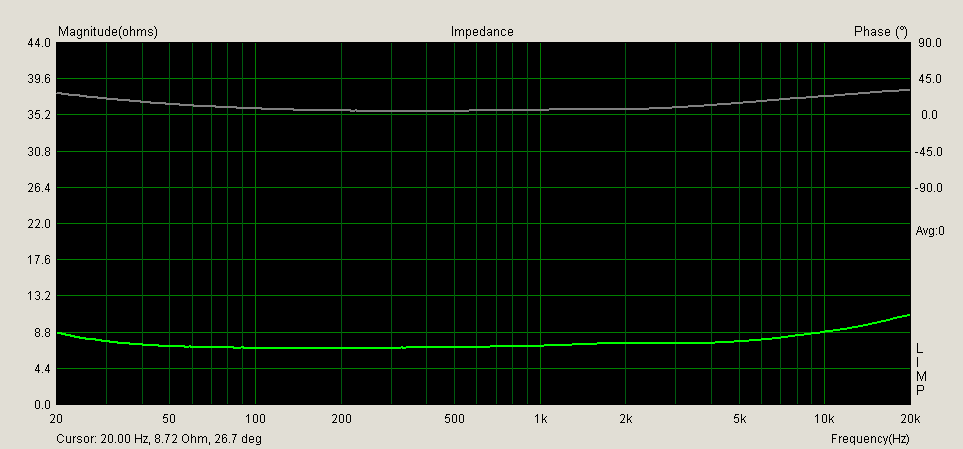

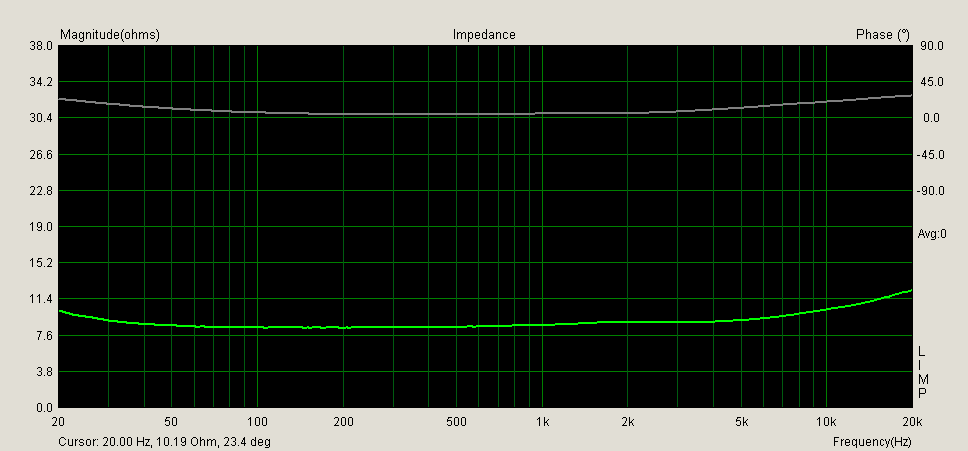

Haha, im cursed! What could be the reason for my high values? Im using a 99ohm resistor(measured by DMM) but its not a fancy high accuracy one. I still think that i should get closer to the correct values anyway

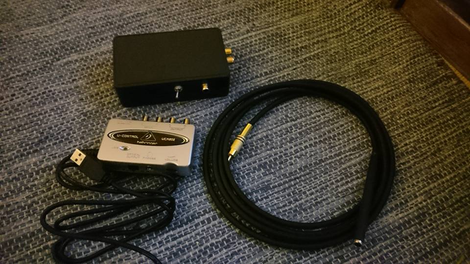

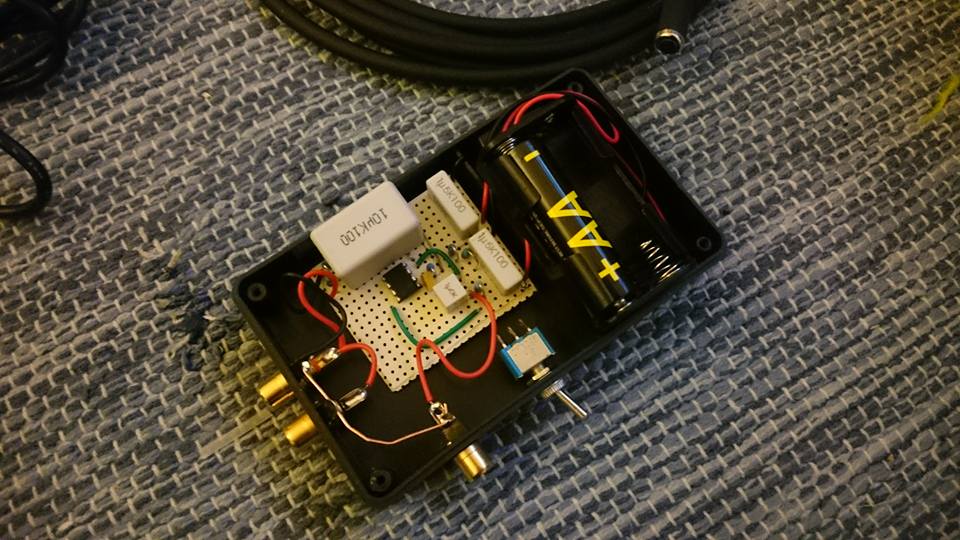

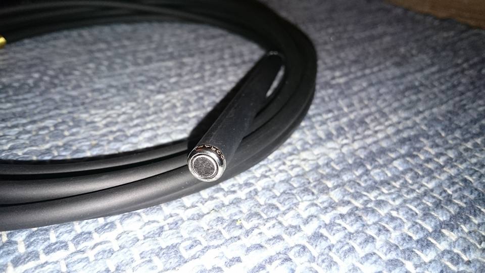

Tonight i got my WM61A mic + amp built. I think that im fairly pleased with the result and it looks surprisingly neat 😀. Have only tested that it works but will use it for measurements tomorrow 🙂
I used the VI schematics on John's page :John Conover: Using the Panasonic WM61A as a Measurement Microphone
The WM61A is unmodified and attached to a 3m microphone cable.

I like the presentation a lot! That's why I never make this stuff. 🙂
Erik
Thanks =) I hope everything works as expected to 😛 But that will have to wait until probably tomorrow, didn't have time to measure anything today. Valentines day after all ^^

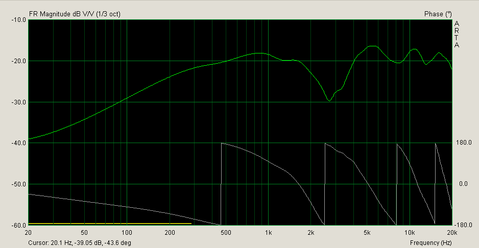

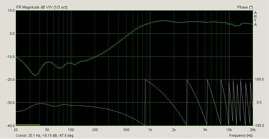

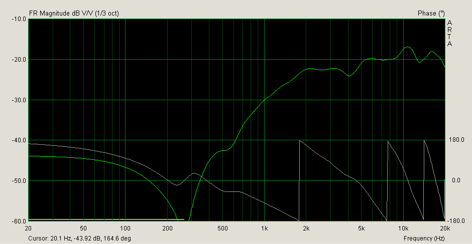

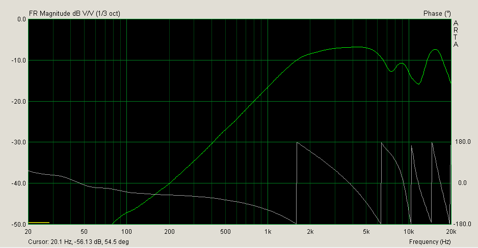

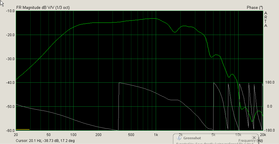

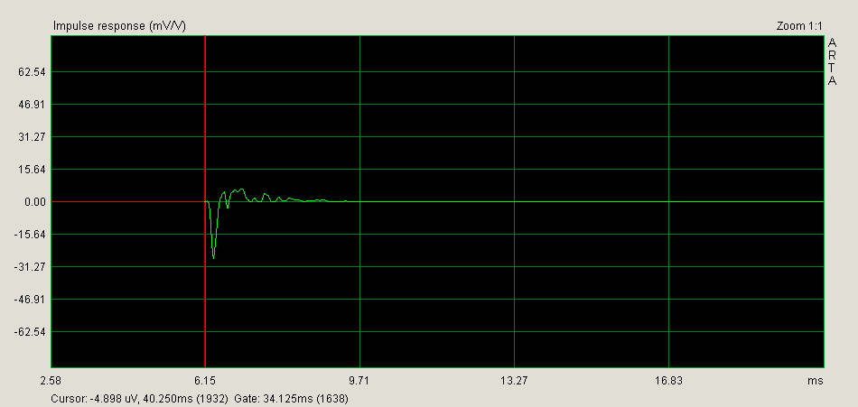

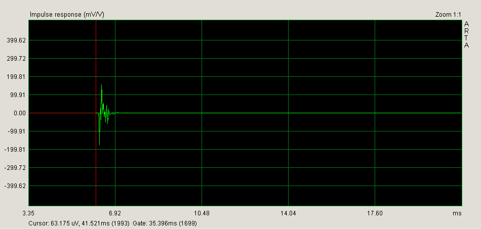

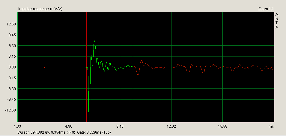

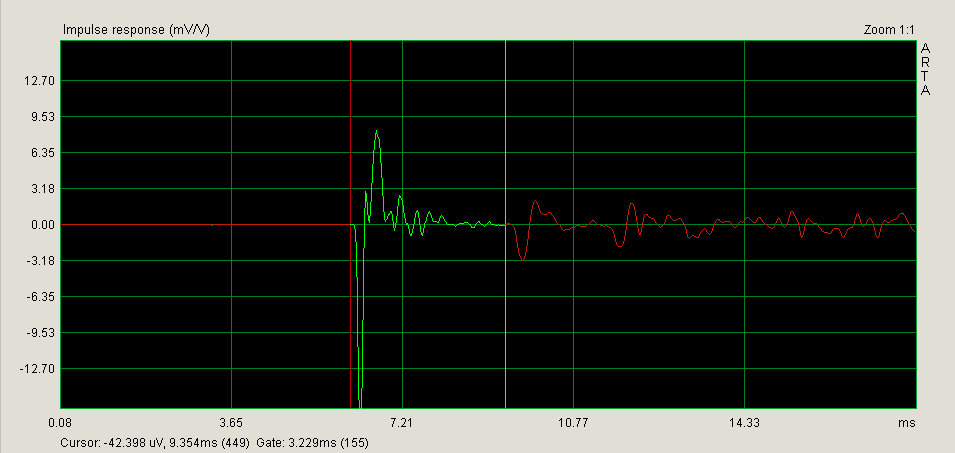

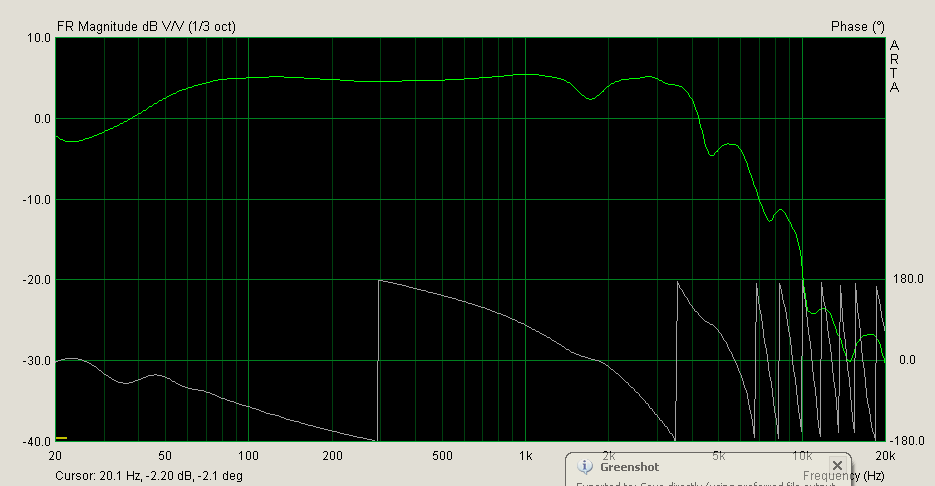

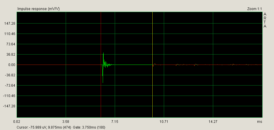

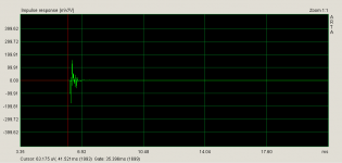

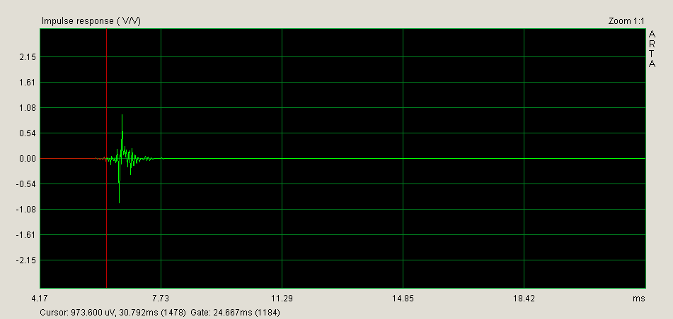

Okey, so iv'e done some new measurements with my new fancy mic+amp, here is what i got:
All measurements was made at 2,83V, tweeter was 102cm of the floor. All measurements was started at 6,125ms(both near and far field).
Far field 1m from speaker, never moved mic or speaker:
-Tweeter

-Woofer
attachment.php
attachment.php

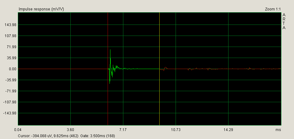

Near field 0.4cm from cone:
-Tweeter
attachment.php
attachment.php
-Woofer
attachment.php
attachment.php
Also attached FRD files in a ZIP here =)

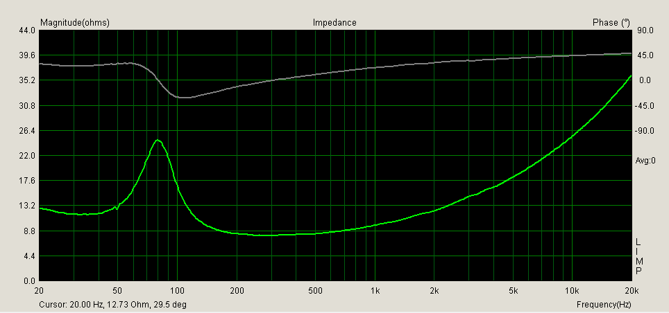

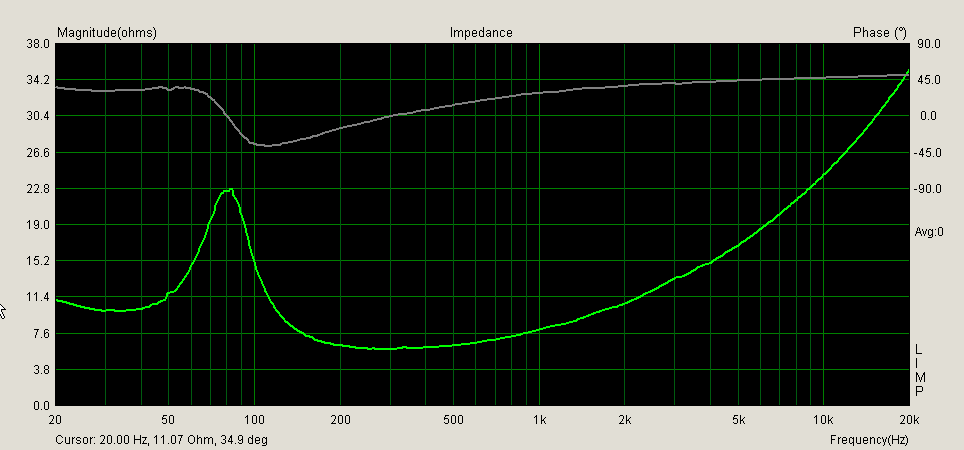

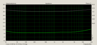

And now i did the impedance measurements with the combined resistance of the wires subtracted(line in+gnd, lineout + gnd, speaker+gnd) at 1,8ohm(yea i know thats crapy).
Tweeter
attachment.php
Woofer
attachment.php

Check the impedance graphs yourself, but they look much more realistic than before. 🙂
I would do the far field measurements no further than1m though. 6ms ~= 2 meters I think. 🙂 The response curves for the individual drivers look really good.
I'm surprised you aren't getting more of a lift from the wall for the woofer though. I thought for sure placing it against the wall would improve the reponse somewhat.
Anyway, they look great. Make sure you include phase in your impedance and fr if at all possible. Measure 3' from listening position and you should be ready to create a crossover in XSim. Er, wait, did you do driver distance already?

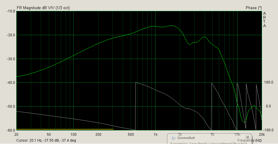

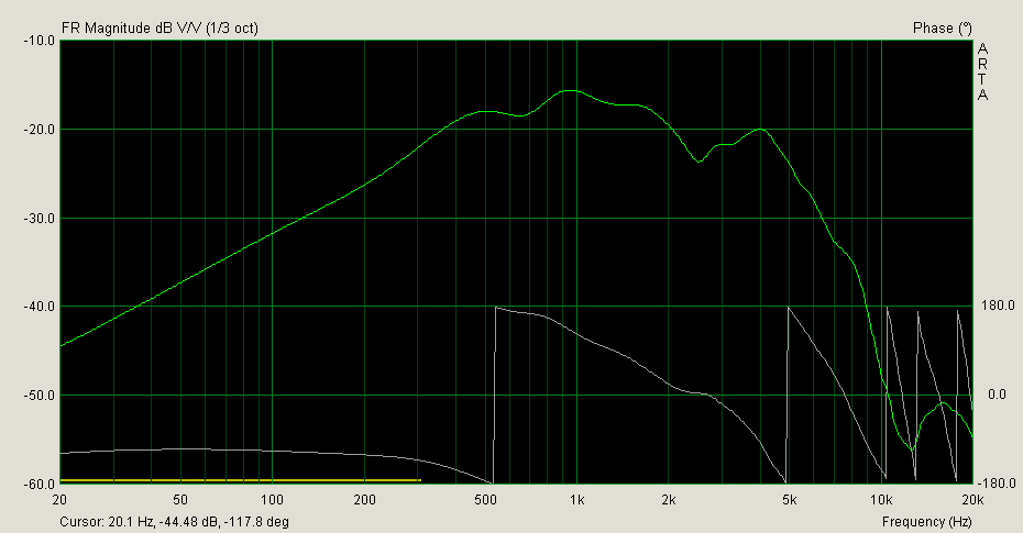

After taking a look at the near-field graphs i figure that they looked way to flat to be correct? I measured them at 2.83V as well. What i tried now was to lower the voltage to 1.41V.
Tweeter
attachment.php
attachment.php
Woofer
attachment.php
attachment.php
