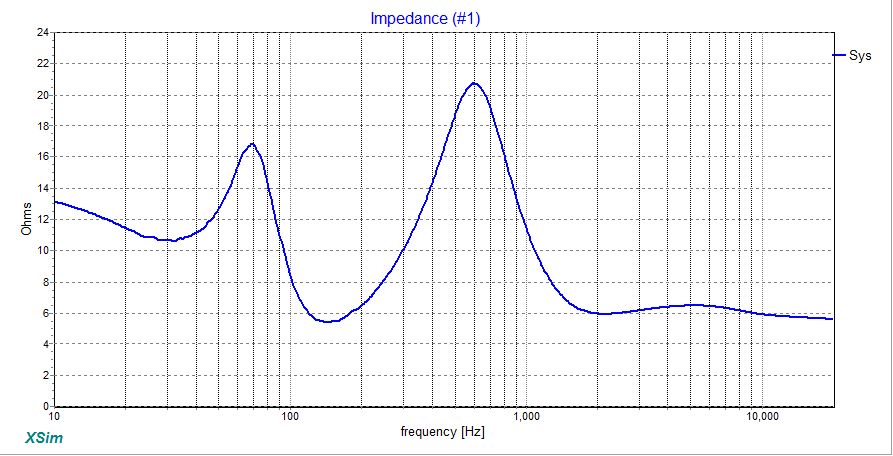

The goal of the impedance equalizer is to keep the PEAKS from being outrageous (30 ohms or more) without lowering the impedance too much (1 Ohm or less change preferred). Staying above 4 Ohms is important, especially with most receivers. If you use a parallel resistor the usual values range from 60 to 100 Ohms. It's main use is for tube amps but also to ensure you don't get ultrasonic oscillations. Power stealing events that you can't hear directly. It really should be the very last thing you worry about in crossover design.
Okey, i think that R5 at 20ohm looks good, it just reduces the peaks without reducing overall impedance to much 🙂
Yes, the phony components are not needed now that you have real Z (impedance) data. They were just there to assist with the modelling. Like masking tape you put on a floor to help understand where the bed should go. 😀
Haha, great explination 😀 They are gone now then 🙂

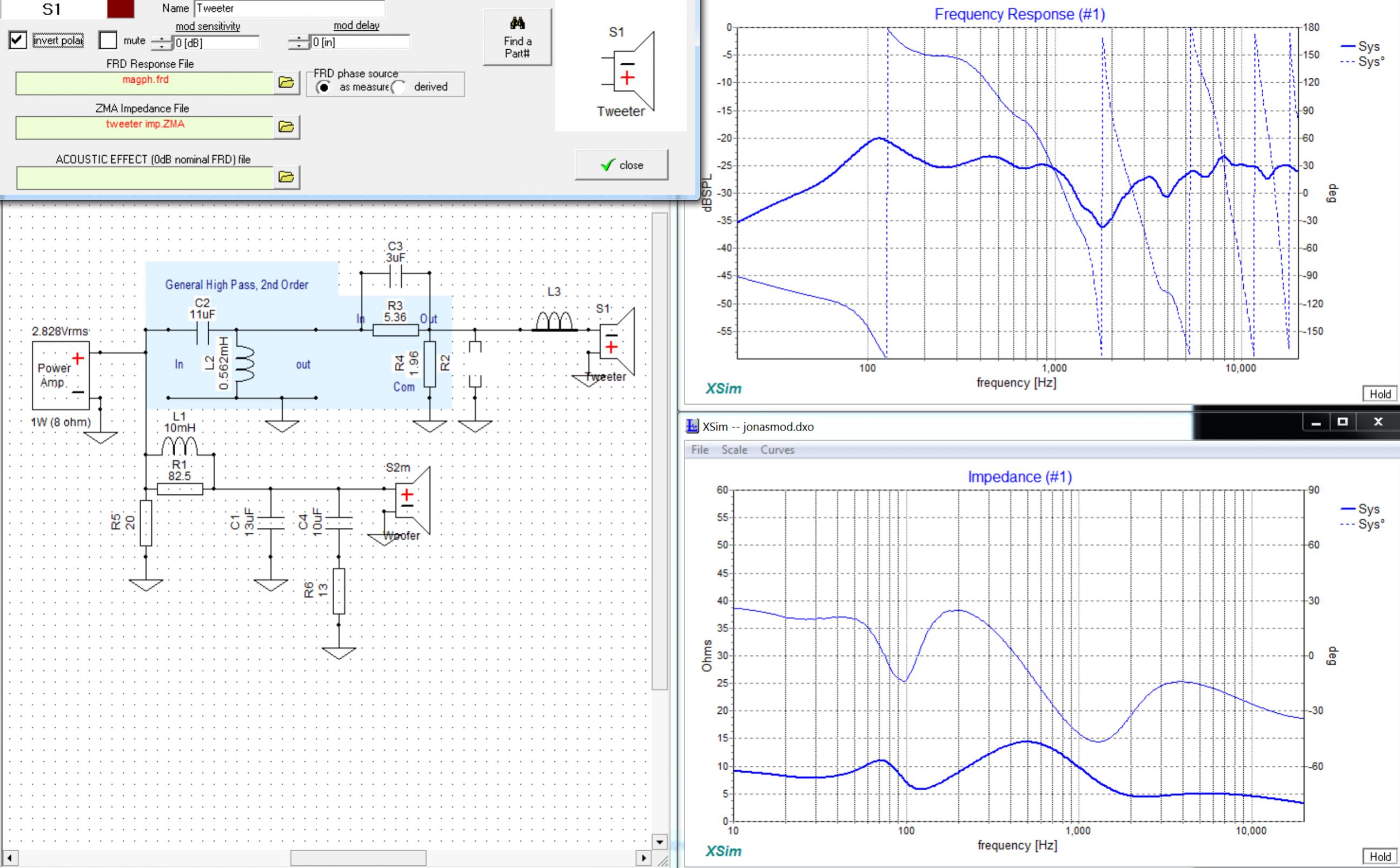

One more thing to check is the inverted tweeter response. Invert the tweeter and you should get a deep and symmetrical null. 10 dB or more, but also it should be a nice smooth dip, not a ragged valley.

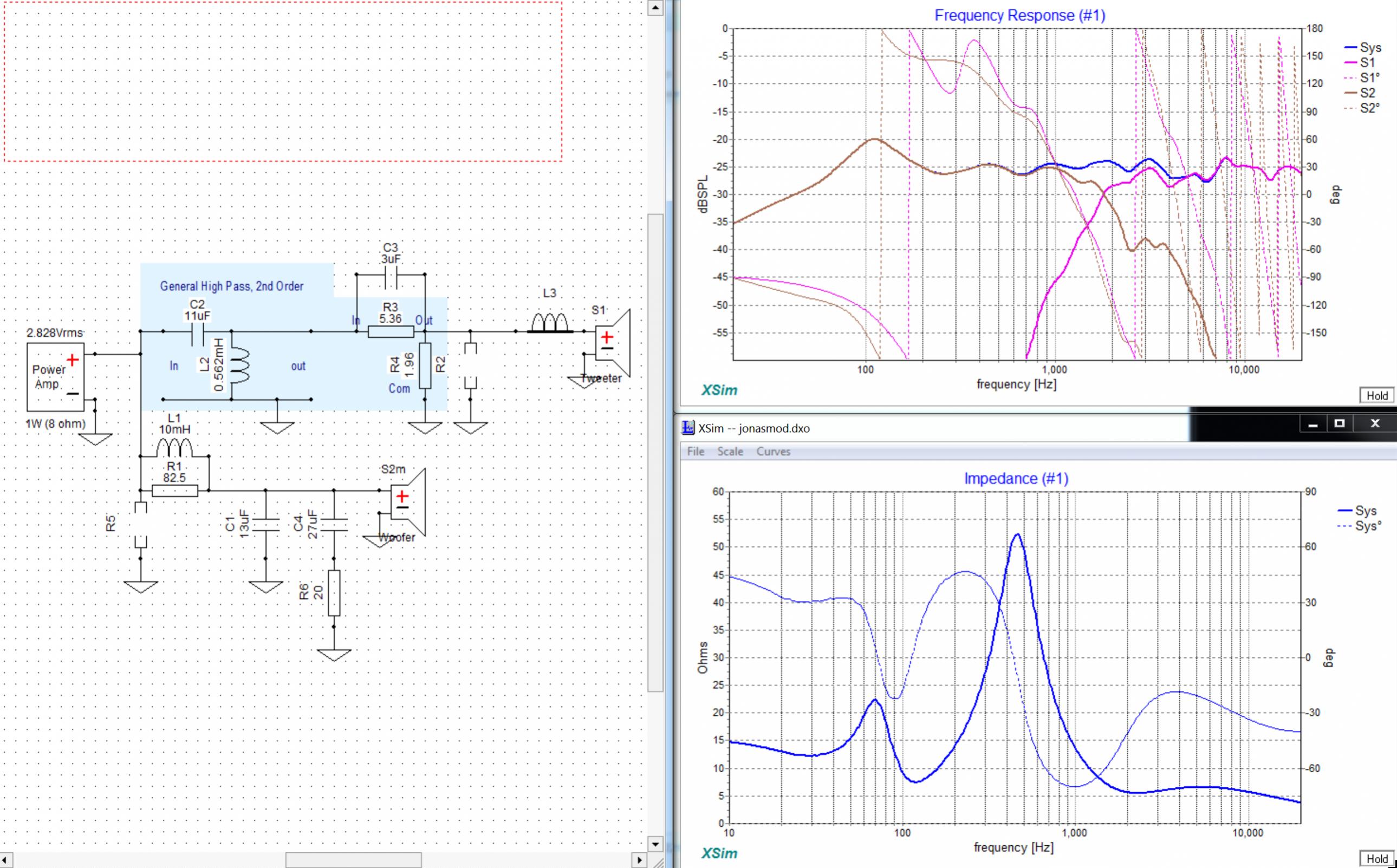

Hum, okey? Lets see then:
Tweeter inverted polarity and R5 adjusted to 20ohm

R5 is too small for impedance EQ. Take it out until you are 100 % done. Really you want the highest value R that will do the job, not the lowest. Leaving your impedance peaks around 20 Ohms is fine.
For now, take it out or you end up futzing with it every time you adjust something.

Okey, i've removed it until later =)

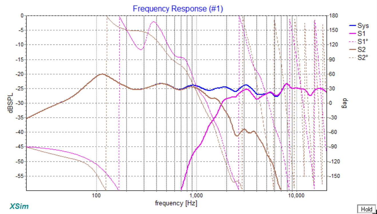

Yes, but remove system phase, add individual driver phase. 🙂 I would like to see the phase for the yellow and red curves. Blue not really right now.
Now i found out how to add the phase curve 😀

It's not exactly spot on, but the phase matches beautifully before and after the transition. 🙂
What I'm concerned about really is that valley in response you have around 5-6kHz. Try muting the woofer to see if that goes away. If it does, it is worth doing a little more to the woofer's filter to help the valley disapear.
There are a couple of things to try to do about the phase matching and the valley. Play with the values of the Zobel on the woofer, you could probably get better rolloff and better phase matching at the crossover point.
You can try this by watching the phase plots line up, or inverting the tweeter and watching the null deepen.
Another, similar approach is to add a notch filter for that plateau in the woofer. The Tune is wonky though, you should use single digit numbers until you get close. Otherwise the up/down arrows have too fine a gradient.

Muting the woofer does nothing to the valley, neither does playing with the values of the Zobel. But by adjusting Zobel i managed to get a little better phase machup before the crossover:
attachment.php
About the notchfilter, i could not get something decent here. Ill have to get some sleep now but i'm attaching the project here so you can play around with it if you have time? 🙂

Ok, the problem is that your original FRD files are 0 referenced! I wasnt' looking low enough. Check out this version. You get more overall output by reducing the coil on woofer.
I used the "farfield" frd files for the Xover, you may need to reload it. If you can set them to actual SPL levels it would be easier.
Added optional notch filter to tweeter. I'd say listen and add only if needed. Same thing for C3.

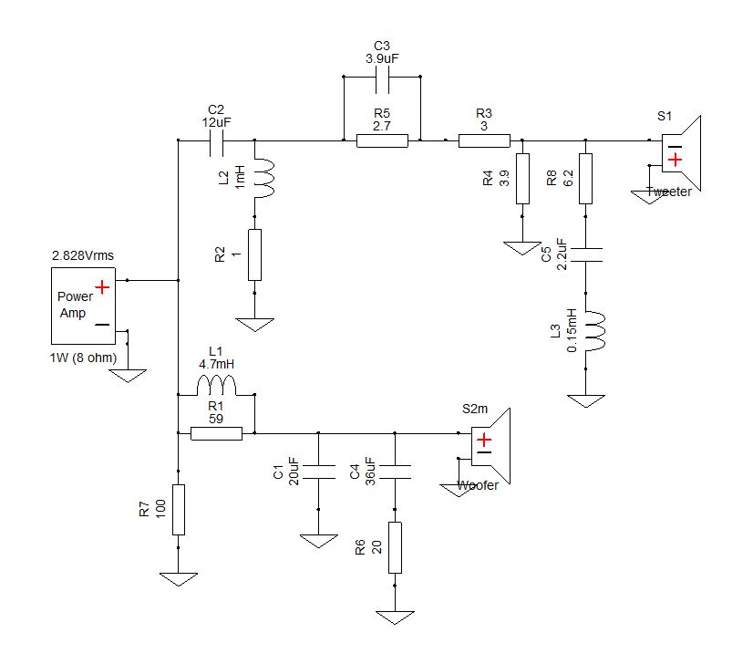

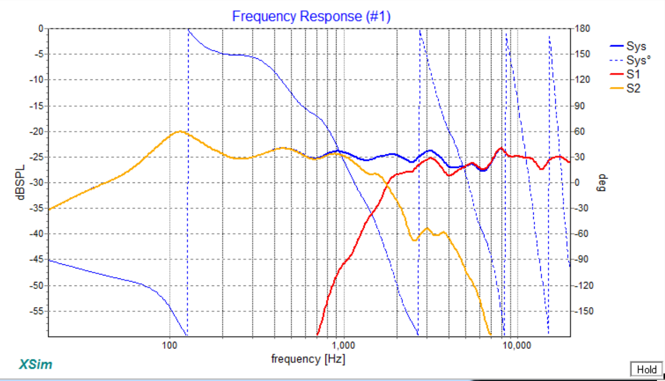

Here are some pretty pics to go along with that. First we have the FR, showing the normal and the inverted tweeter. This is using my own personal blended house curve. I suggest you start with this first, and adjust the tweeter level to taste afterwards by adjusting R3.
attachment.php

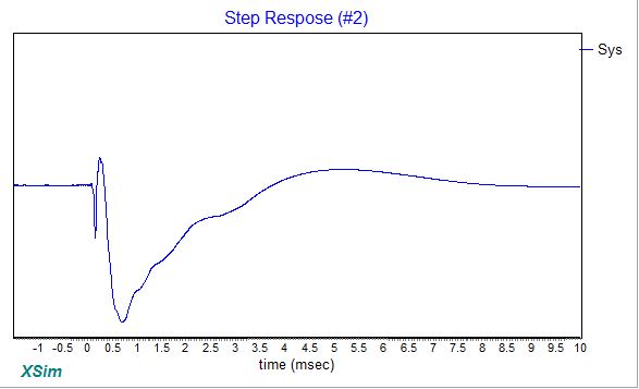

What's odd though is the step response. It shows that the "normal" graph has both drivers tweeter inverted! 😀 That's fine, so long as you wire it right. 🙂 You may want to re-measure after wiring to make sure you got this part right.
attachment.php
The step and phase aren't 100% perfect, but they are very very good.
Lastly, check out how completely easy to drive this speaker will be
attachment.php
The speaker stays above 5 Ohms at all places, a cakewalk for when you get to using Tube amps. 🙂
Not bad I say.
Erik

I'm sorry, I think I may have gotten carried away and done parts you wanted to do, and may have prevented you from learning as much as you could have from this experiment.
Well, you can still try to improve the phase matching, it's not perfect as the phase and step responses show. On the other hand, it will only be perfect exactly when your head is on tweeter axis. 🙂
Another thing to try is doing 30 degree off axis FRD measurements. This will give you a good idea of how the speaker will sound when your not exactly between them. A step I avoid being friendless. Only the Throne needs good sound here.
Once you are done tweaking the schematic to taste, there are some further steps.
- Convert part values to real one's.
- Go to your favorite parts shop (like Parts Express) and enter real DCR's for the inductors. Jantzen specs are usually dead-on.
- Set amp to 20 Watts, and examine the wattage of the resistors in the tweeter section. You'll want to make sure your resistors all exceed the maximum wattage.
- Set Amp to 100 Watts and repeat for woofer.
Best,
Erik

I would not invest in that notch filter unless you want to. 🙂 Yes, for R3 try that value and a few smaller, or buy 3 x 1 Ohm resistors, then you can use jumpers to play around with the value until you like it. 🙂
Usually the peaks in the step response goes positive. In this case they both go negative, showing that either your microphone or your speakers was inverted when measuring. Being consistent is 1,000,000 more important than absolute direction, but it would still drive me a little crazy. 😀

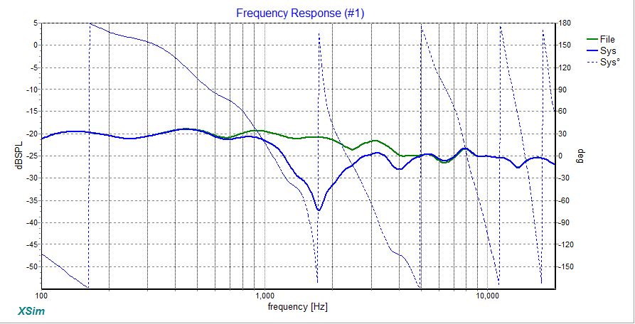

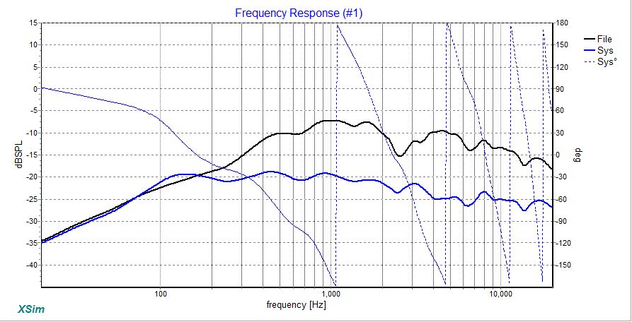

Oh, you asked about if the lack of bass would go away. Yes, as much as can be. The issue you had was your speakers had no baffle step compensation, so you were only really hearing the midrange to treble of them.
L1/R1 are the BSC (baffle step compensation) Plus L1 forms part of the low pass filter with C1 (2nd order-ish) as well.
This is a much better balanced speaker than you had before. Lets compare it to the original crossover with the FR down to 20 Hz. The black line is the original curve. The blue the new one. The output is decreased as a result of the EQ added, but look at the relative output at 100 Hz. vs. 1 kHz. Now the level is only -3 dB where before it was -16 dB down. Looked at it in relative terms, we have lifted up the 100 Hz level (and below it) by around 13 dB. That's about 8x the relative output power. 🙂
Bottom line: We've pushed the -3dB point (relative to 1 kHz) from 500 Hz to around 90 Hz! 🙂
Also the response is a lot smoother overall. Sadly, there are no free lunches however. We pay for the equalization with reduced overall sensitivity.
attachment.php
You might be able to get a little more bass (20 - 30 Hz lower -3dB) out of the boxes if you port them. Get WinISP and try out your driver, and cabinet combination. See if you can come up with a reasonable port in the 1.5" diameter to 2" diameter range for those speakers. 🙂
Otherwise, with the cut off being what it is, it's an ideal candidate for a subwoofer. 🙂 You should submit them for THX certification say I. 🙂
Best,
Erik
