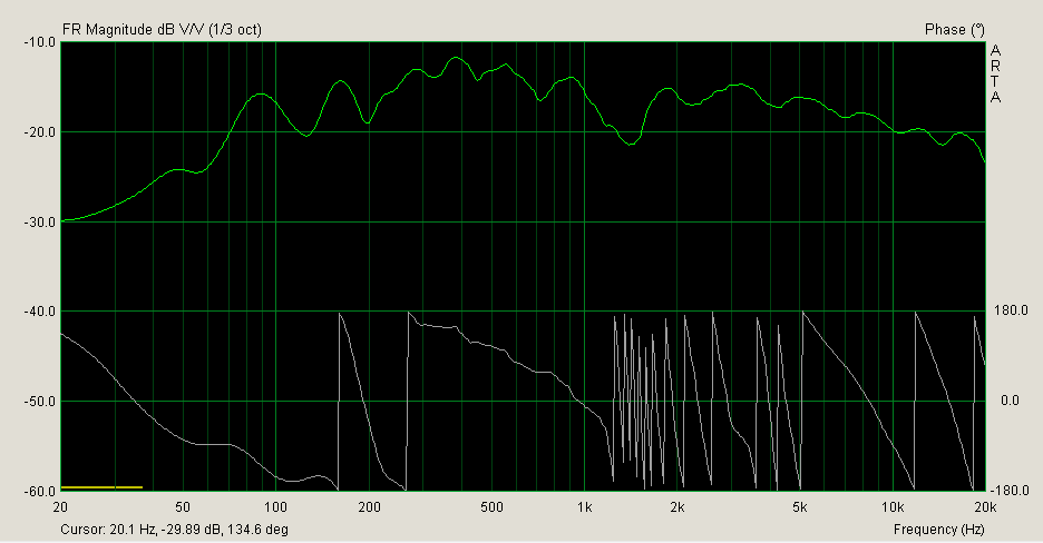

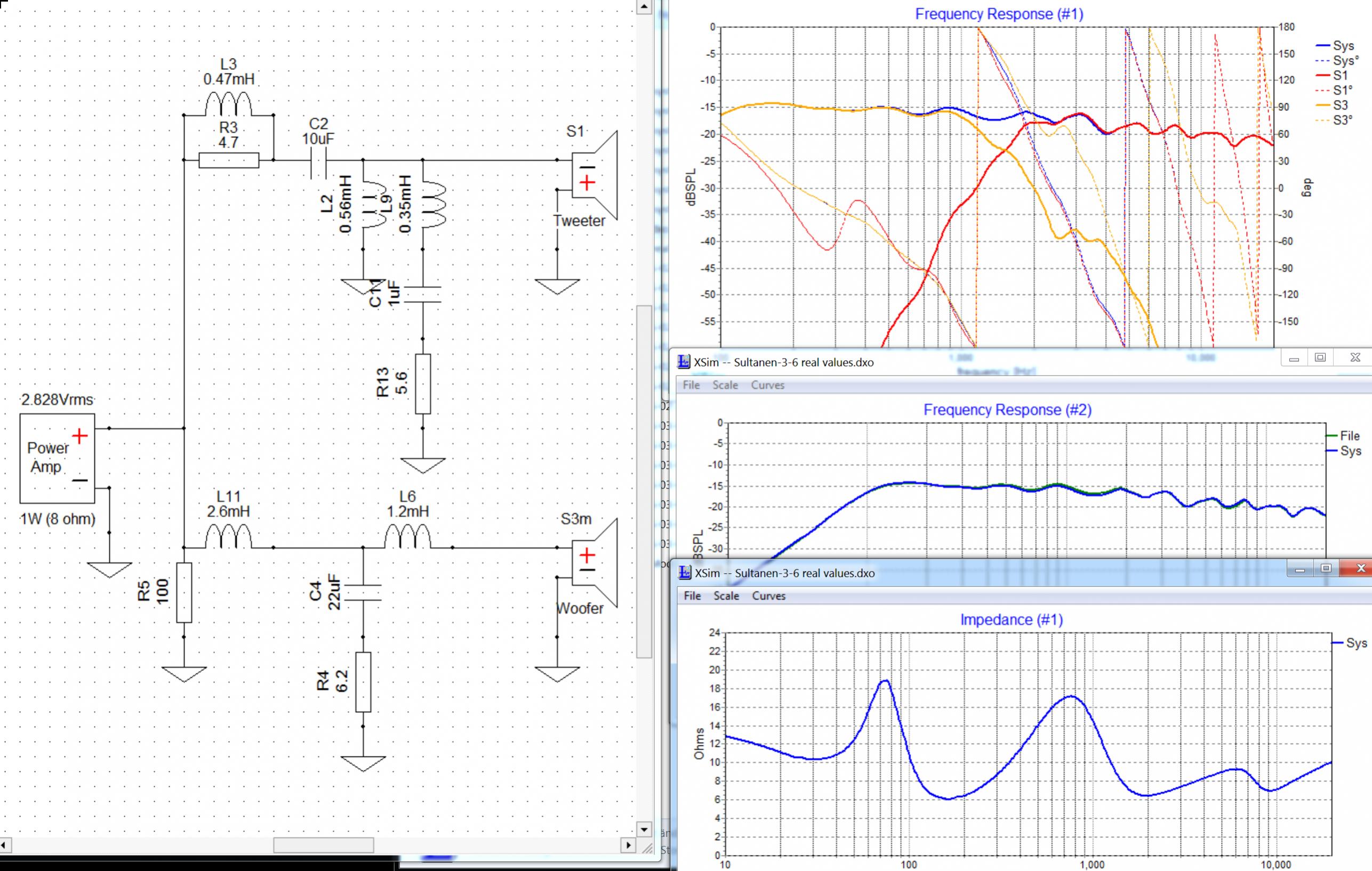

Thanks for the tips 🙂 I think i have something going now! Here are the first look at components and FR for these values.
I have listed a bunch of resistors to use for R3 tweeter level adjustment.
Tweeter:
Woofer:
Tweeter: 33,63eur
Woofer 36,88 eur
Total: 70,51 eur
FR - Green is my startingpoint before changing to real life component values

Thiose look really good. one trickhowever is to get a 1, 2 and 3 ohm resistor for the teeeter. that lets you try every value from 1 to six ohms, or 2, 3 and 6 ohms, letting you try 2,3,5, 6, 8, and 11. You get the idea. 😀

No need to go lower on that cap, at 70eur/crossover i can't say that i feel that the circuit is expensive 🙂 I have spent so many hours trying to learn now so spending a bit only fells good 😛Your choices look great to me. If you can find Axon or Bennic caps, they are even cheaper than the Jantzen Cross Caps. Great for the woofer. 🙂

You are absolutely correct that the biggest difference here is to introduce the coils or the crossover at all since its totally lacking now
Regarding system7's chooice of using straps its a really great idea and i will do this when i start mounting the parts to the plate 🙂
Thanks for the link, i have been reading a bit on your blog =)Also, I should point out that for the Leach Memorial speakers I'm blogging, I'm probably going to end up getting the Jantzen P-Core inductors for the woofers as being very high price/performance parts. Especially important considering the coils and high inductance values I'll be using there.
Im using the same now in the woofer, i choosed 13AWG mainly because it had the widest range of values.
Smart! I was thinking about buying a bunch of 1ohm resistors but this is really cleaver 🙂Thiose look really good. one trickhowever is to get a 1, 2 and 3 ohm resistor for the teeeter. that lets you try every value from 1 to six ohms, or 2, 3 and 6 ohms, letting you try 2,3,5, 6, 8, and 11. You get the idea. 😀
Updated partslist:
Tweeter:
- C2 10uF - Capacitor MKP Mundorf MCap 400 VDC 10 uF - Fidelity Components Shop 7,99eur
- C11 (1,21uF) 1uF - Capacitor MKP Mundorf MCap 400 VDC 1 uF - Fidelity Components Shop 3,19eur
- R3 4,7ohm - Resistor MOX Mundorf 10W 4.7 Ohm Metal Oxide - Fidelity Components Shop 1,29eur

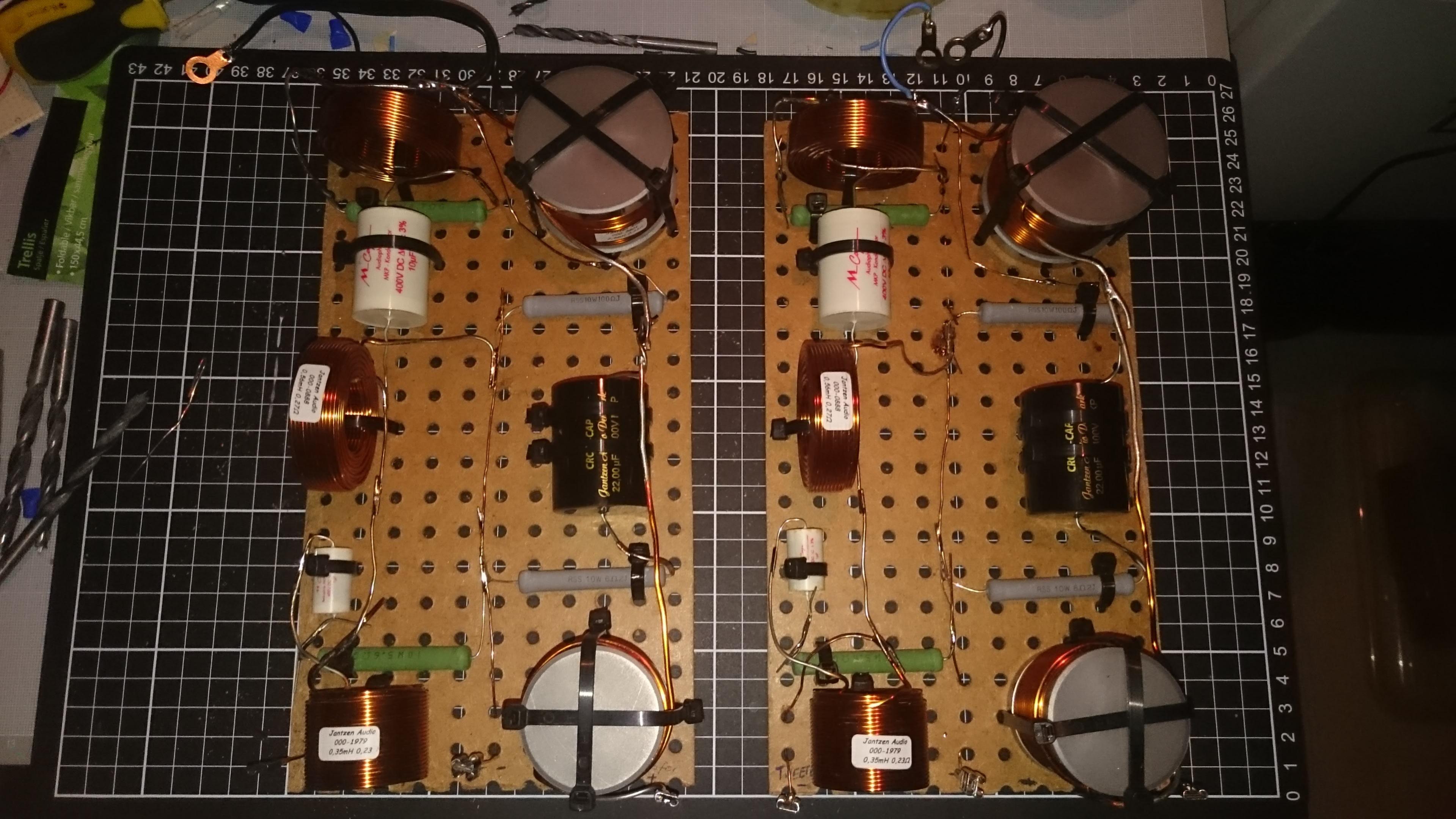

Hello again everyone!
I finally gathered some time to finish this projekt! A really good feeling to actually see it all the way through 😀
Tonight i was up until 03:30AM to finish the second speaker and today i put them to the test.
The crossovers are split up into two "parts", left is Tweeter and right is Woofer
The final result of the front and back with the gorgeous black allen head bolts, i really love that the changes are so subtile since i love the look of these speakers!

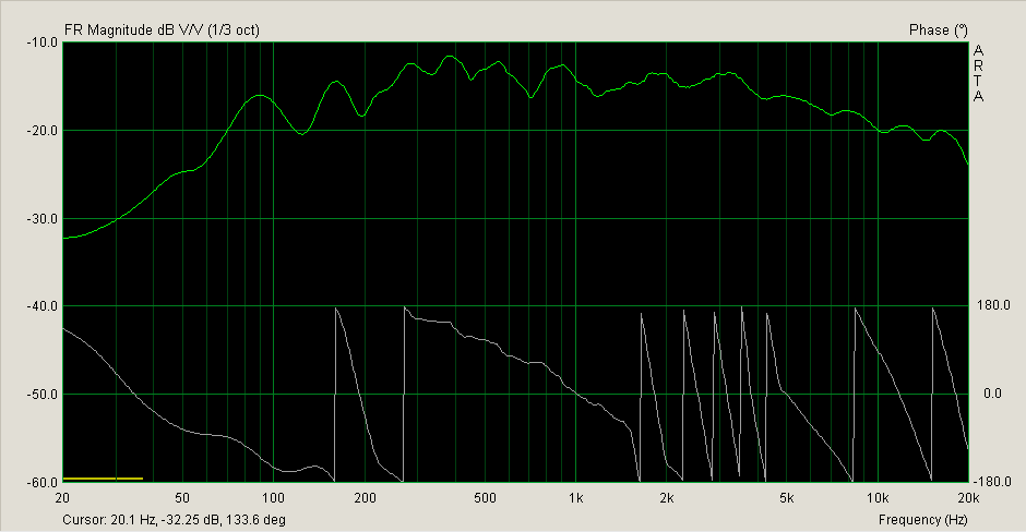

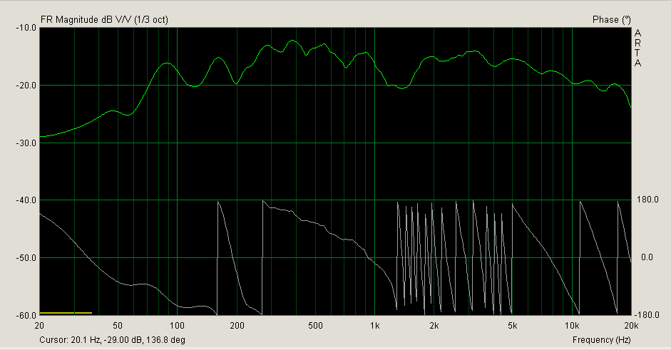

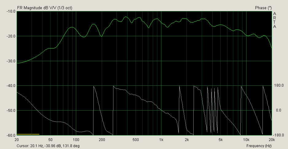

I accidentally put the tweeters in reverse on the first attempt but that was great, now i have some confirmation that i got the phases kinda correct at least.. 🙂
Right (the one i did all the measurements on)
Inverted Tweeter:
Correct:
Left
Inverted Tweeter:
Correct:
So, what do you guys think? =)

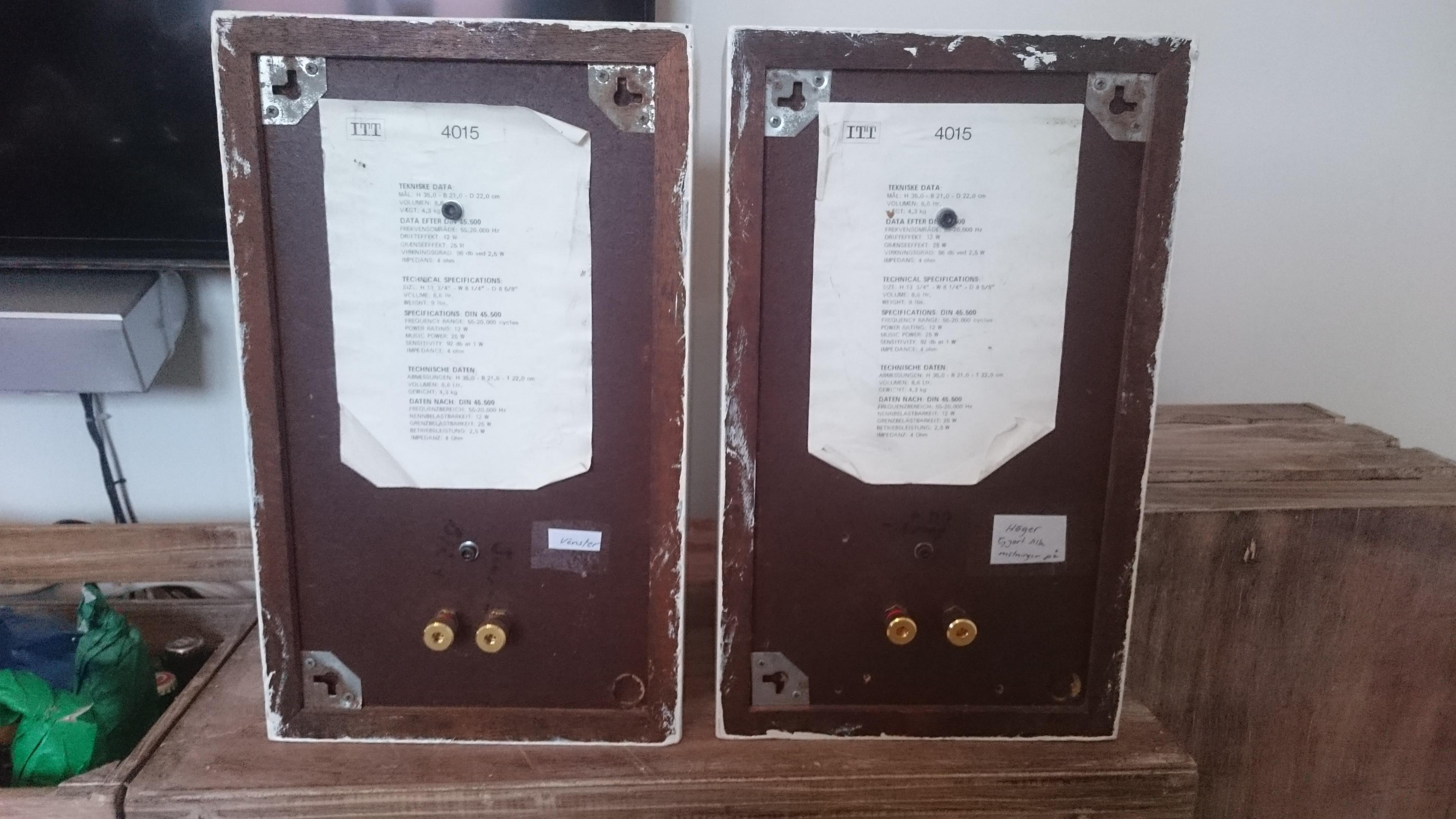

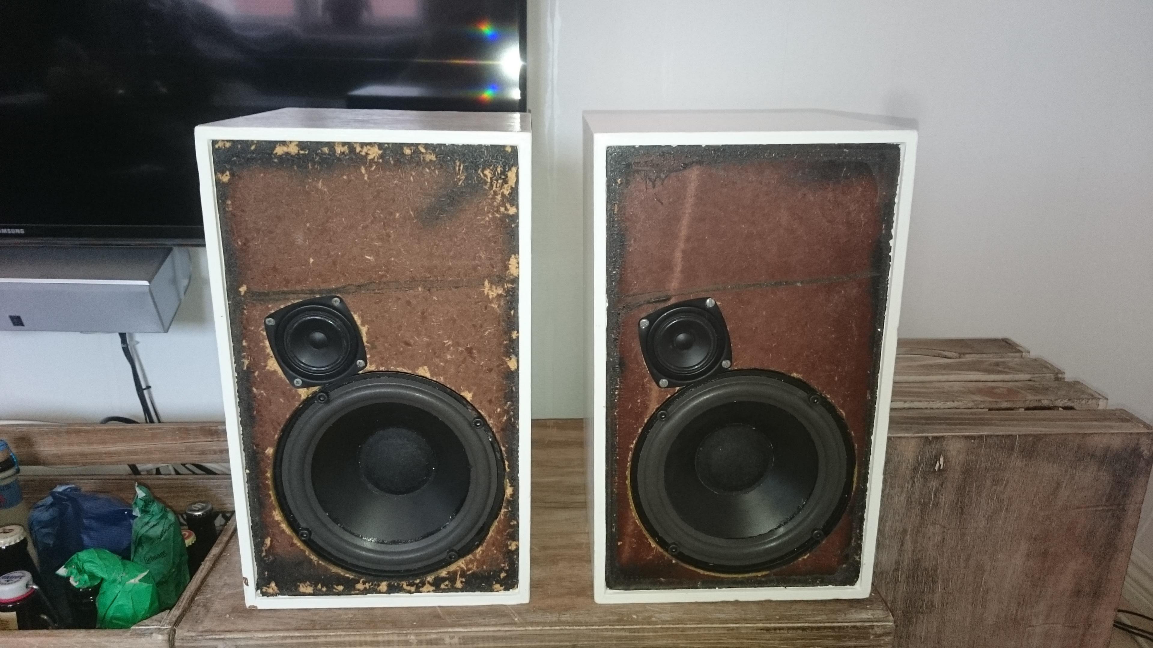

Inverted Tweeter:
Correct:
Left
Inverted Tweeter:
Correct:

Very nice! What do you think of the sound, and the treble balance?
As I recall, you were going to put them up against the wall, but these measurements seem like free-space. Those are some pricey woofer coils! 🙂 Go play some music and let us know.
Best,
Erik
Best,
Erik
Thanks 🙂
Unfortunately i did a really stupid thing in the garage about a month ago and i ended up getting tinnitus on my right ear so i have kinda hard to appreciate music at the moment 🙁 I hope that i will learn to live with this and learn to ignore that but its hard at the moment. But i have listened to some music on the speakers and the improvement is huge! Maby there is a bit to much treble but i think i need to wait a while before adjusting it.
The speakers are up against the wall during this test, maby there is a way to get some deeper base from them but this is what i have at the moment? As i may have mentioned before i'm running the speakers in a HT setup so i have a subwoofer that can complement the lower end. On a side note though, i have realised that the balance on that subwoofer is really crappy 😛
miniDSP for the win! 🙂
Better is miniDSP + bass traps, but that's usuall more than people want to spend.
Get a miniDSP unit for your sub, cut the peaks, and then you reset the level and it integrates better.
