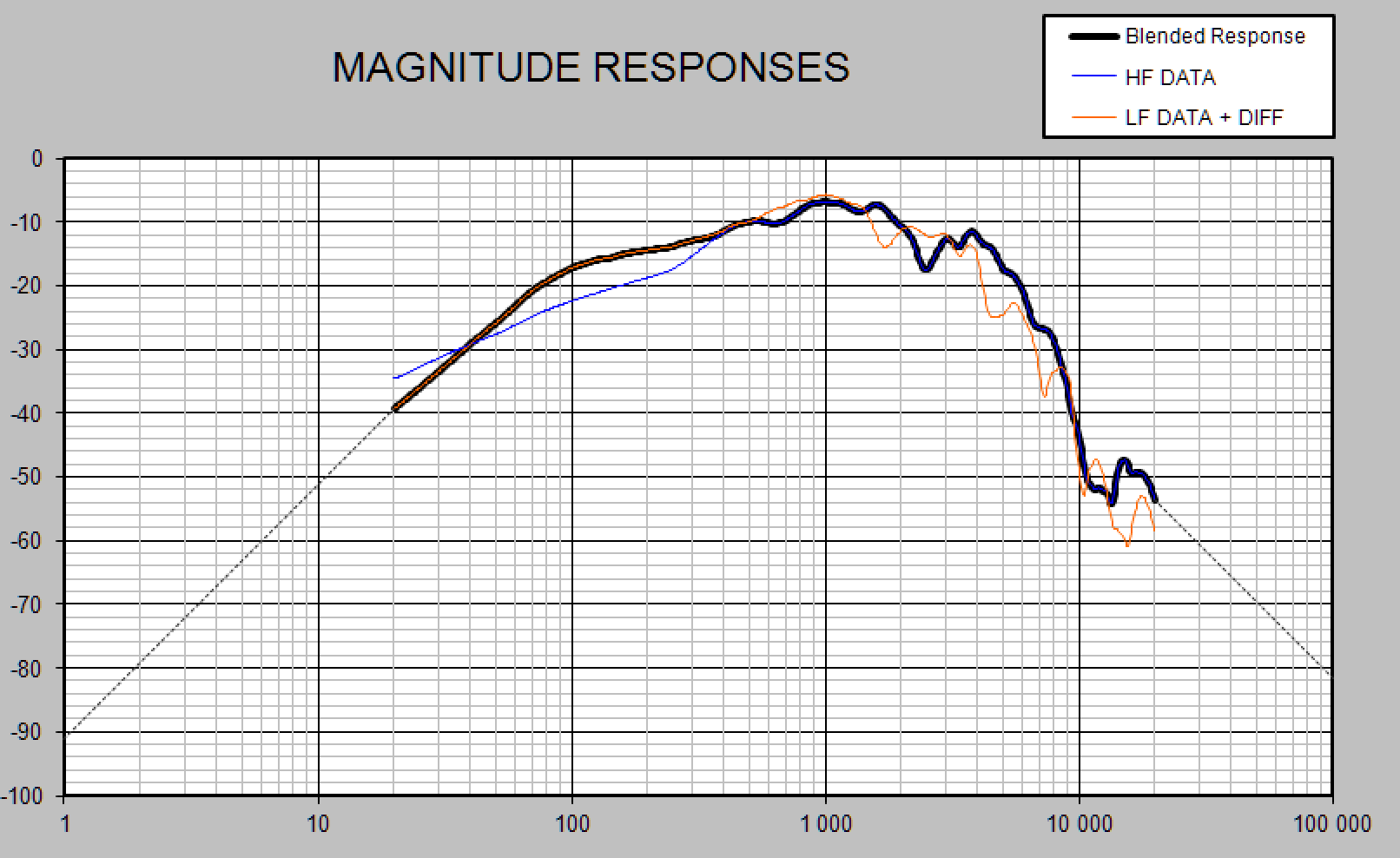

Sorry if i messed up explaining my measurement method, since i started using ARTA instead of Tombstone ALL my measurements has been gated. In ARTA the invalid frequency range is represented by the yellow line in the bottom left corner of all FR screenshots. It might have been unclear that they still was gated when i stopped posting impulse/gate screenshots like in #200.
This was why i was taking nearfield and farfield measurements(that i still think is valid but needs to be merged and i don't know how to do this correct).
As robotc noticed i did an "ungated" measurement in #209 just to show what happenes when i extend the gate and introduce room noice.
Regarding old measurements i think that we can ignore all the old once as "learning history" and only rely on #208(imp), #209(farfield), #210(nearfield).

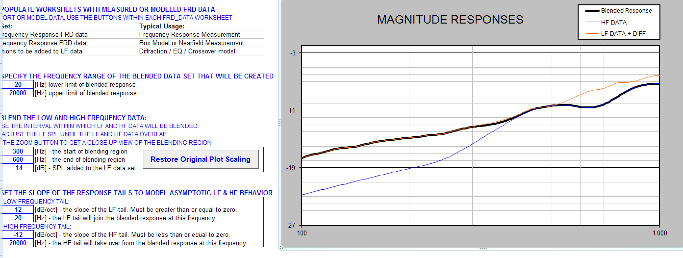

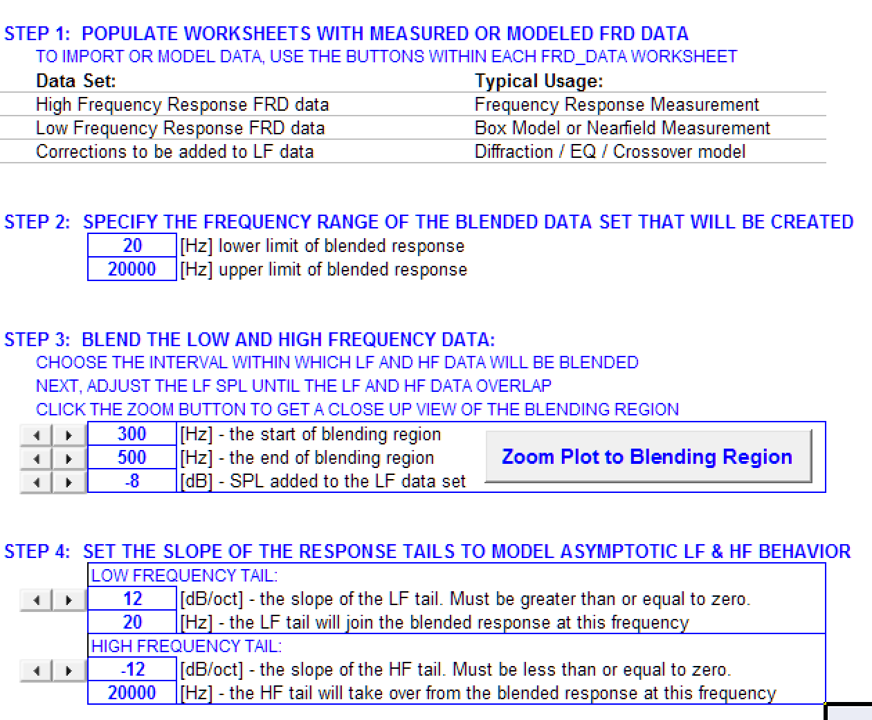

I did play around a little with the Excel sheet "FRD Response Blender 2.0".
I will post my settings(mainly default i think) and the resulting graphs and blended FRD file.
Settings:
attachment.php
Final Blended Minimum Phase Response:
attachment.php
MAGNITUDE RESPONSES:
attachment.php

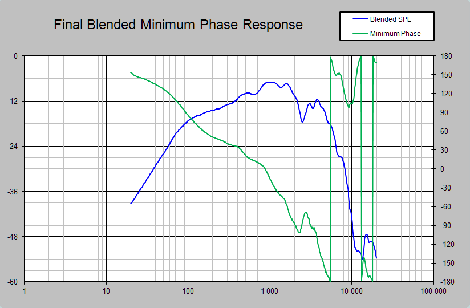

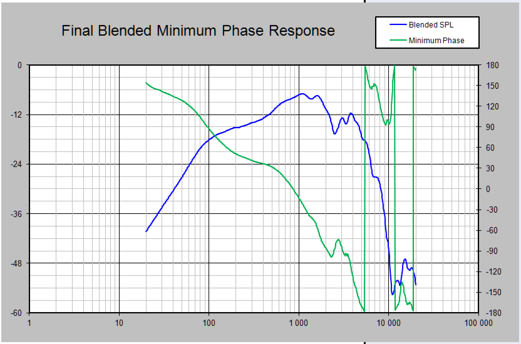

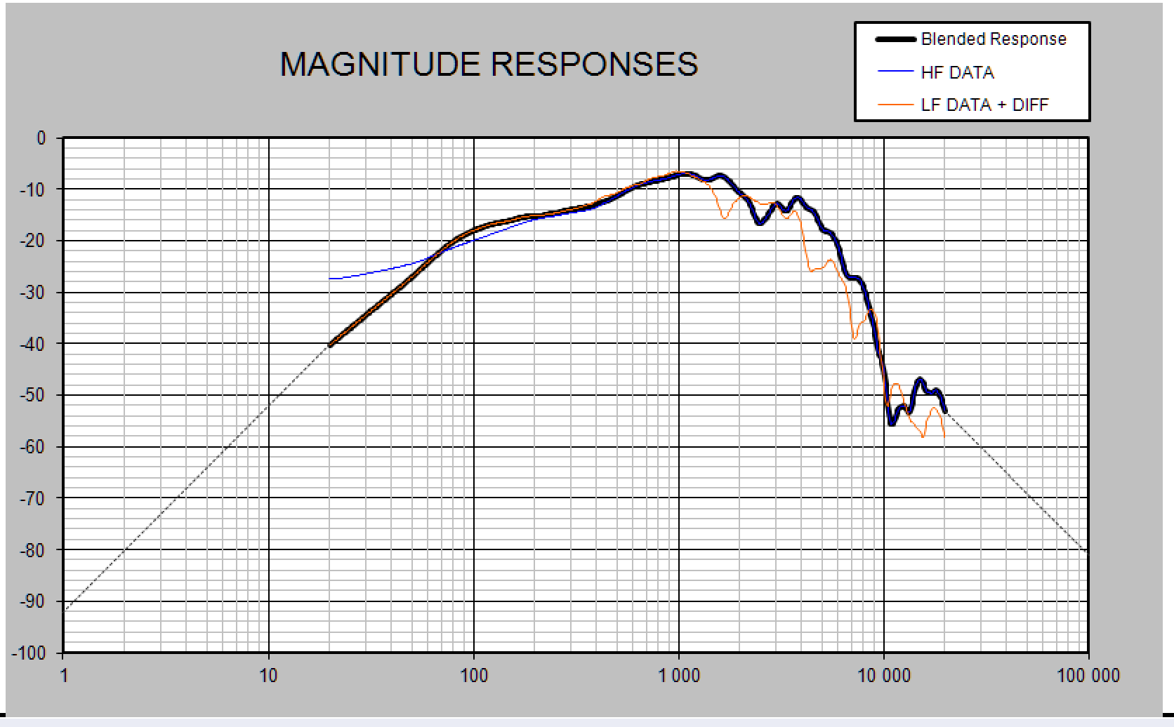

Okey, so i got my "woofer wall" merged frd file put together now. Redid the nearfield measurement at 0.497V just to make sure i had good data and it looked almost identical to the former lower voltage nearfield measurement so i'm pleased with that 🙂
Following the guide that robotc provided i merged "farfield wall" + nearfield + baffle step correction and got the following results:
Merging range 300-600Hz:
attachment.php
Full range:
attachment.php
With minimum phase:
attachment.php
FRD is attached 🙂

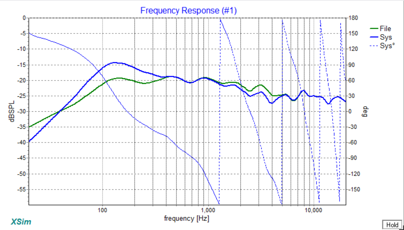

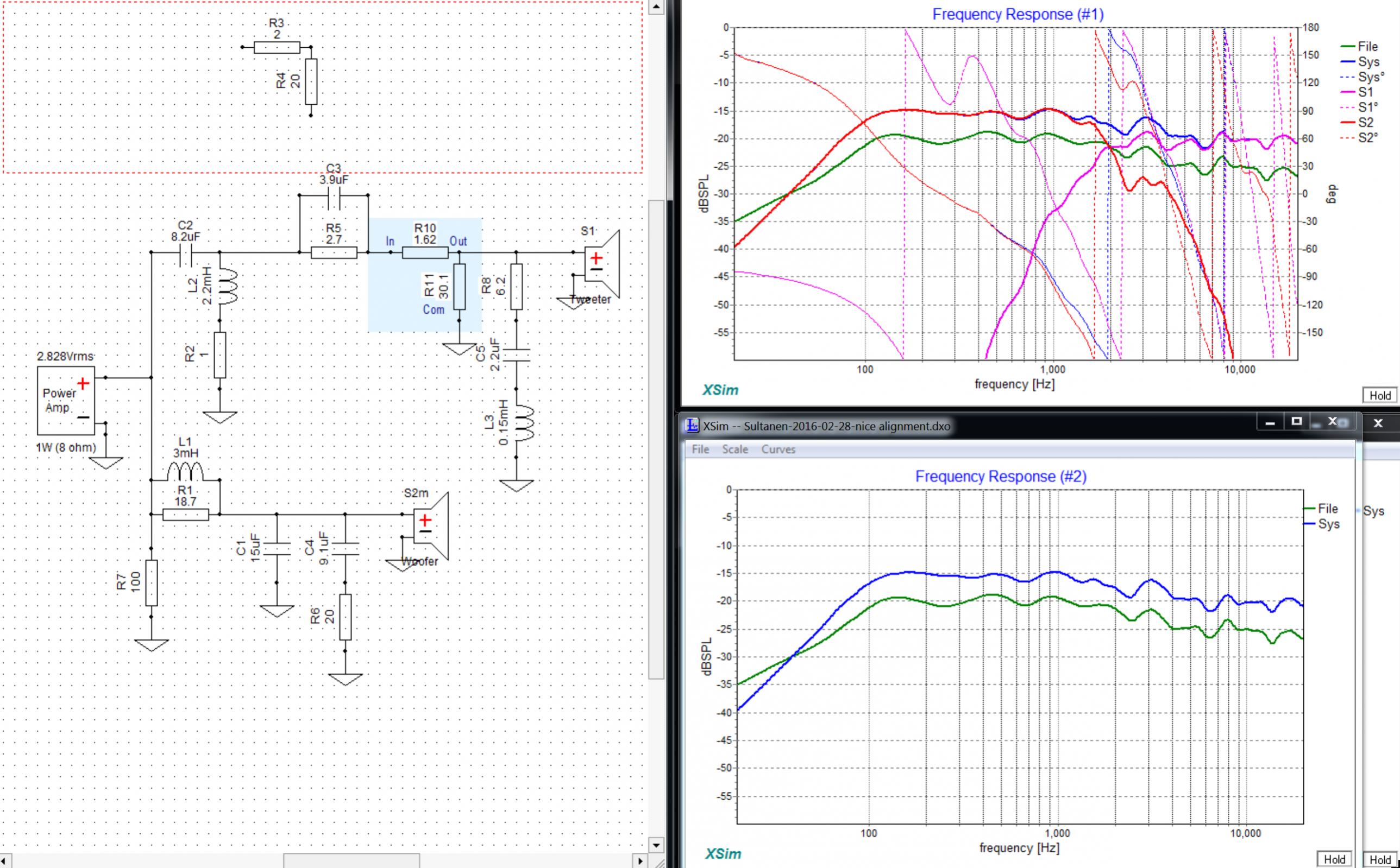

Here is eric's latest Xsim crossover design with the new woofer data 🙂
OLD FR (Green)
NEW FR with merged nearfield+baffle step correction (Blue)
attachment.php
I hope i did a good job with this, im quite eager to hear this crossover design soon 😀
Inverting the tweeter makes sense, but wait! 🙂 Ignore that for now.
With the new woofer data the BSC has over compensated. You want it to look more like the green line around 125 Hz or so. So you'll want to reduce the compensation in the woofer (coil + resistor). Then you'll need to bring the tweeter level up too. 🙂
It's a domino effect. The tweeter phase matching may fix itself when you are all done, so there's no point in attempting to optimize it just yet. The proof of good phase matching is that inverting the tweeter causes a big null. If inverting the tweeter removes a null, then that's how the speaker should be wired. 🙂
Let's discuss more of that later. 🙂
Best,
Erik

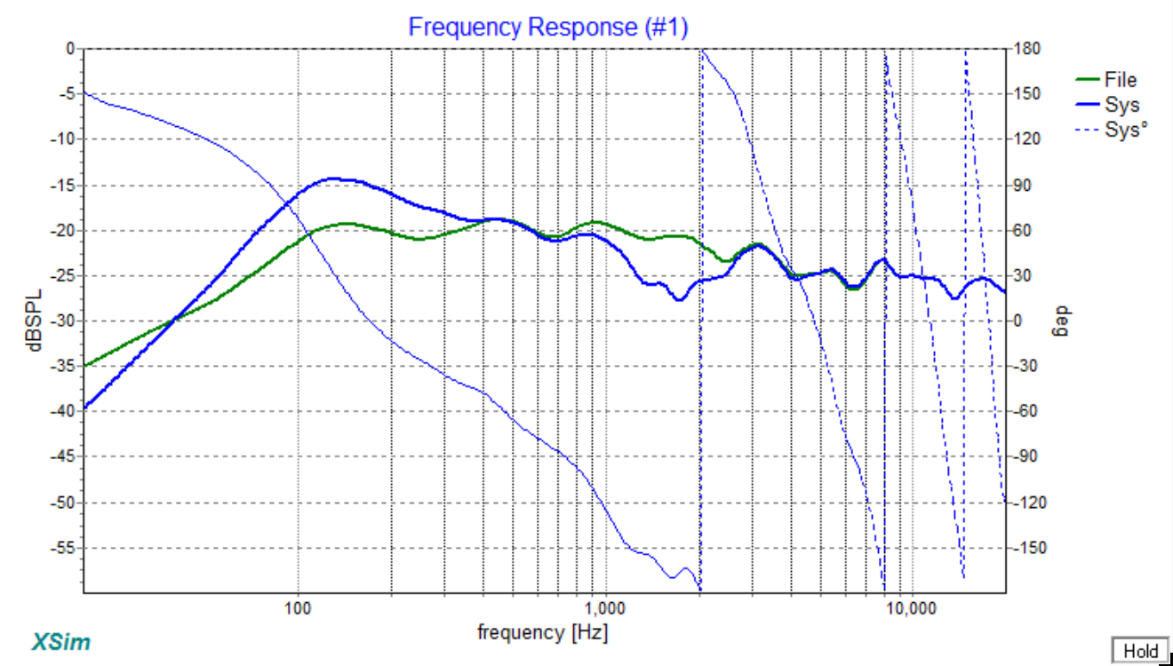

Hum, i just tried to invert the tweeter and now it aligns better, why and should i do that? 😛
attachment.php
Best,
Erik

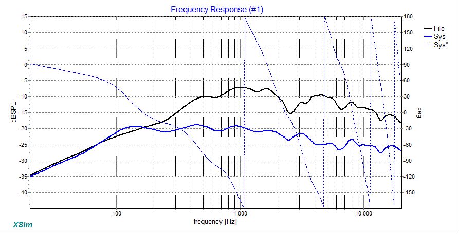

Okey, lets get into inverting later 🙂
Now it looks quite nice! =)
attachment.php
BUT, we are not in phase so inverting the tweeter does not give us the awesome big null. How would you go about getting the phase to mach up better?

Gah! Too many phase plots. 🙂
Look at just the drivers, with crossover and with the phase. you see where the line goes across the entire graph? That's when it crosses the 180 crossing point. You want that to line up for the tweeter and woofer, or as close as possible.
That FR looks really nice though, I don't think you are far off.
Good candidates to tweak are C4, R6, C1, R2 and C3. Try pushing those a little in either way to see if they improve your phase matching. But keep in mind, perfect phase alignment rearely happens as you never put your head in a vise. 🙂 90 degrees is a little further than I'd like though, 30 or less would be better.

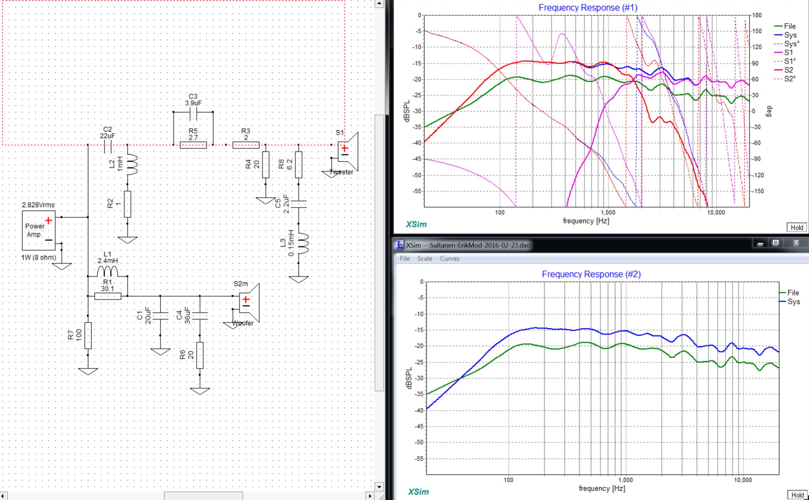

You mean the three vertical lines at about 1500Hz right? Im trying to get them closer together by playing with the components but aint getting it much closer =/ C1 is the component that affects the phase the most but when i lower that to get it to match up better the FR shoots up in the sky and i dont manage to lower it without ridiculous values on other components 😕
attached Xsim project as a reference =)
From a quick look, try to push your crossover frequency up a little, to around 2 kHz. 🙂
Also, use the L Pad circuit block instead of separate resistors. It's a lot easier to adjust the level and maintain constant impedance.
Erik
Thanks for the tip with the L-pad, alot better 🙂
I managed to push the crossover to about 2kHz but the phase is petty much unchanged 🙄
attachment.php
