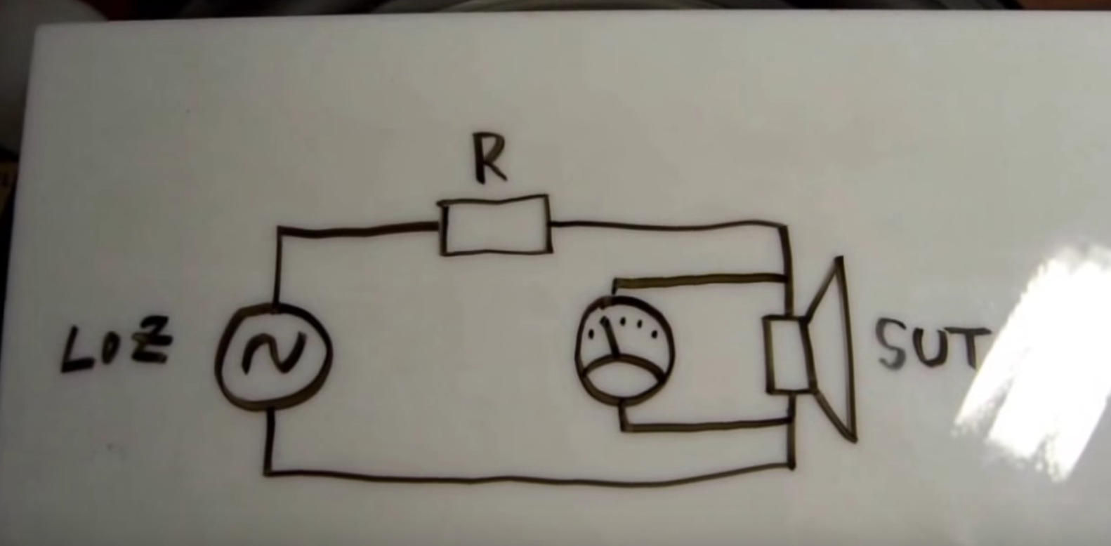

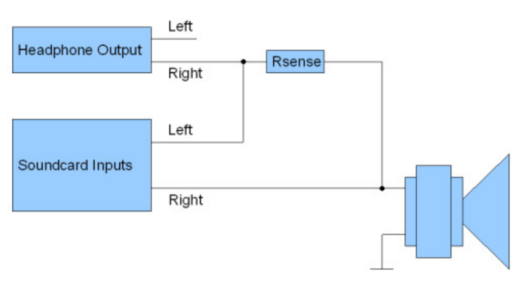

Unfortunately i dont have a Dayton DATS V2 so we will have to make do with my new fancy multimeter and my computer, i hope thats enought even if it will be more work for me 😛
How would you go about measuring R and L? Is R just the DC resistance across the Woofer?

Just sweeped the frequency until i found the peak. I guess i can do something similar and just note the values at each frequency measurement point?
I don't have a scope.. yet.. it's something that ive been eager to buy for some time now but it will have to wait a bit longer i think..

So you found the resonant frequency. What we want is at multiple frequencies, what is the impedance at each one? 🙂
So, you sweep from 20 to 5kHz using a resistor of a known R, say around 4 - 10 Ohms. You put that resistor in series with your woofer and measure the voltage at the resistor. As the voltage drops at the R, the impedance is at maximum in the woofer, and vice versa.
I'm afraid I'm having a terrible allergy and cold right now, this is just the principle. I'm sure some one else can help you.
Part of this however is knowing the limitations of your meter. See if you can find the max AC frequency or something like that. Otherwise you will have to:
1- Get signal generator
2 - Calibrate at 60 Hz. Increase the volume on your amp until it says 1.00 V
3- Sweep from 20 Hz up wards. Yo'll notice that at 60 Hz and for a while it will read 1.00 V.
4 - Notice when meter's V starts to drop. It should be really good up until 60Hz, then at some point, maybe 100Hz, maybe 10kHz, the V reading will start to get lower and lower. That's how you know the limit of your meter.
5 - Now measure the V across an R of a known value. Sweep from 20 Hz up to your meter's frequency limit, which you found above. Use your own judgement. Below 100Hz, maybe do every 5 Hz, then every 100Hz after that or something. Most critical part is the area around the resonant frequency, then after that a general idea of the shape and magnitute of the impedance is all we need. You don't have to be very careful below and above that peak.
I'd use a voltage that's comfortably in the meter's range, like 1V or something like that. When you see it go from 1.0V to 0.9 then 0.4 you'll know you hit the "Knee" it just depends on your meter's design.
What we'll miss is the phase of the impedance, i'm sorry I don't remember how to get that, but you should be able to find some online guide.

I had to give up getting impedance measurements with the built in soundcard of any of the 6 laptops i tried with so yesterday i bought myself the little USB soundcard UCA202! Amazing a great little thing that gave me the impedance measurements in just a few minutes 🙂
