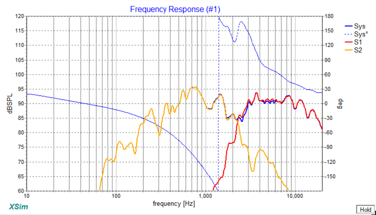

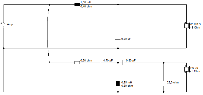

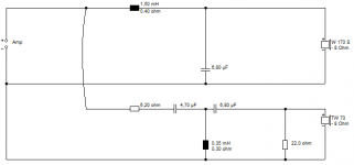

I've been looking at a circuit like below, which seems to do the right things. Now do bear in mind I'm using different, albeit similar, drivers.
Hehe, yea, it is getting rather late here, 02:07 and probably time for bed since a few hours..
Nice to get some data, i hope you know more than me about what to do with it =)
I will simulate that circuit before i got to bed.
Edit:
The black boxes you have in your drawing are inductors right? I notice that it has a resistance?

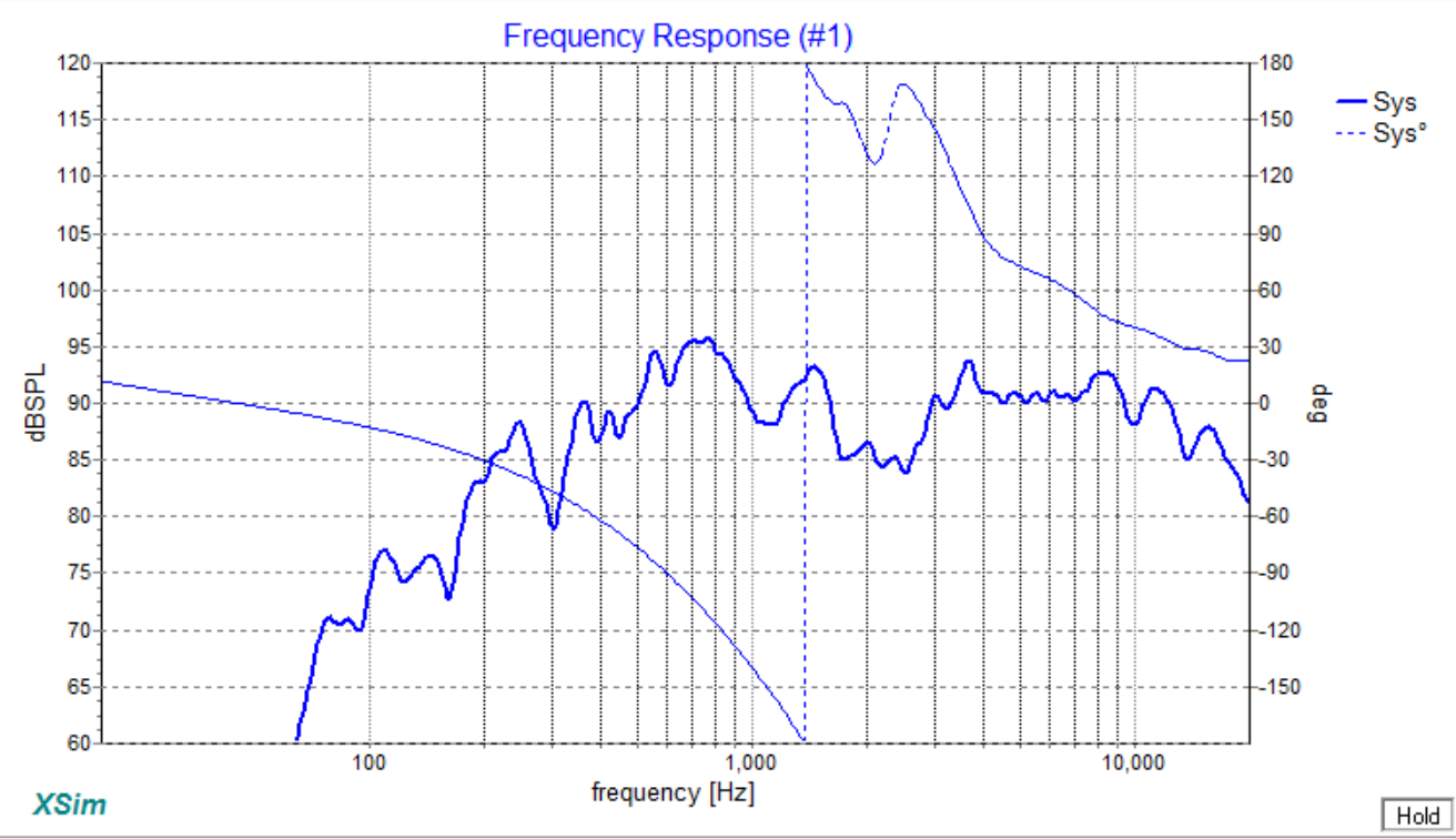

I think im getting close to where i need to be atleast 🙂
I will keep playing with Steve's circuits and i think this will be great! Can't wait to hear it 🙂
I'd suggest show the bass separately, and change the range on XSim so we can see down to 20 Hz. 🙂 It will help.
Just to clarify, show the woofer curve separately?
Remember early on I suggested the first thing to do was to flatten the bass from the 40Hz level or so? 🙂
I do remember that verry well but i don't think i understood how to 😱
Hehehe. 🙂 XSim FR lets you show the individual as well as combined FR. On the FR window, click "Curves" and select S1, then give it a unique color. You can do this for all 3 curves. Woofer, tweeter and total. UP to you.

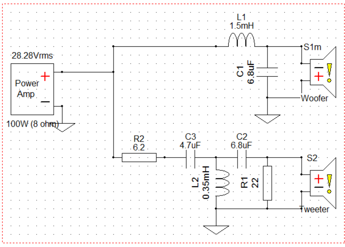

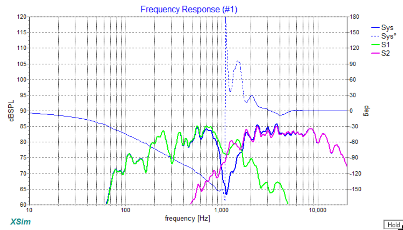

This with that second order 1.5mH/6.8uF bass I suggested. Crossover 3kHz.
529133d1454549064-2-way-speakers-suggestions-improvements-screen-shot-2016-02-04-02.04.39.png
Looks like the woofer isn't very flat above the 1kHz surround dip. It's falling away hard. Big hole there around 2kHz. 😕
I couldn't dig up a frequency response for the Peerless bass. Maybe try just a 1.5mH coil, no 6.8uF shunt?
See, I knew Steve was missing the Baffle Step view. 🙂
Try a single pole low pass filter on the woofer. That means just an inductor. Add inductance until the woofer looks as flat as you can make it from around 40 - 80 Hz upwards. Then pad the tweeter down to match the same level. That's a good start.

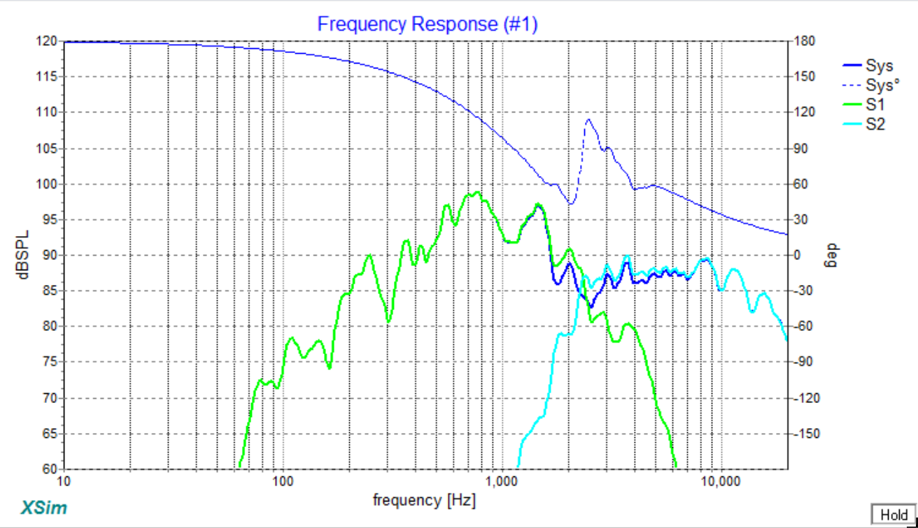

Hi again =)

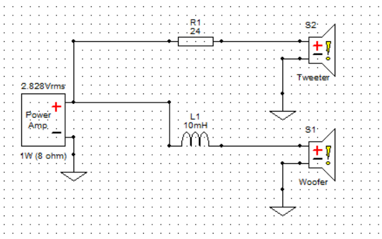

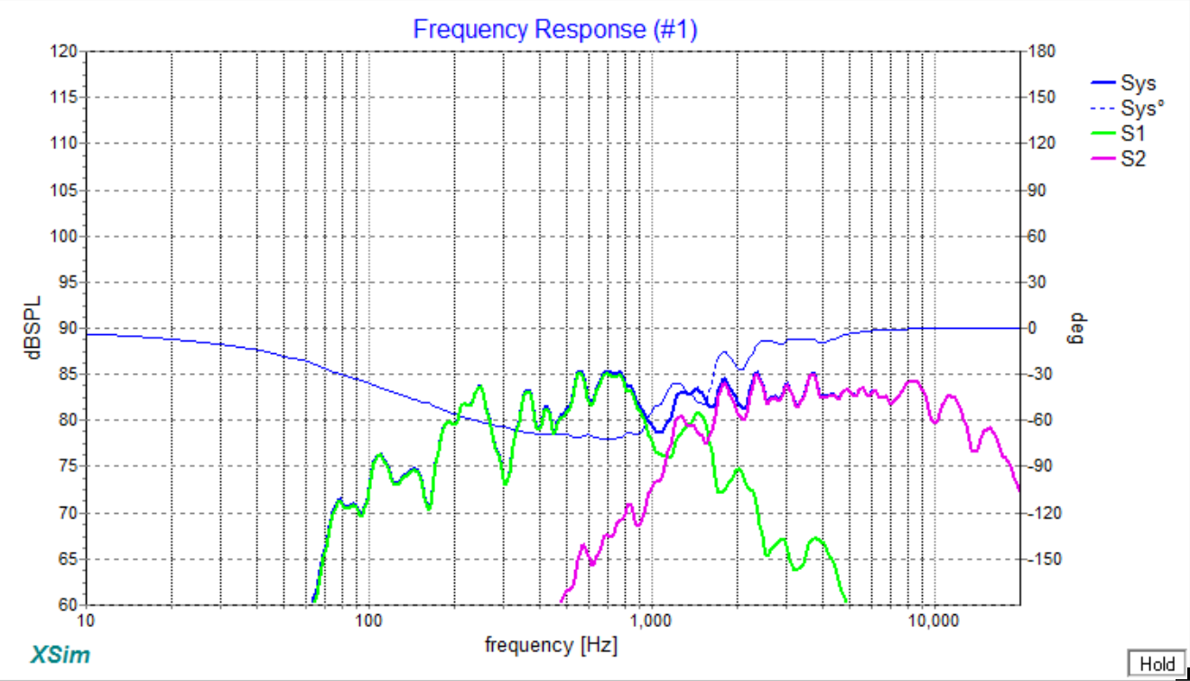

I did a test to add only an inductor to the woofer and increase it until it was as flat as its gonna get before it starts lowering the entire range to much. I ended up with 10mH. Its still not anywhere close to flat in 40-80Hz range?
Then i lowered the tweeter with a resistor and ended up with 24ohm.
First graph is with 1W amp and S1,S2 driver only. Thought it would be interesting to see how much lower in volume it gets:

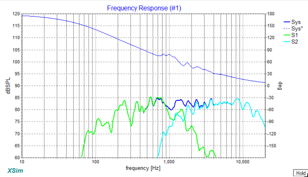

Second Amp 100W+Woofer+system to see the entire graph better:
attachment.php

It's a bit late at night to be doing this! 😀

Hi again =)
attachment.php
attachment.php

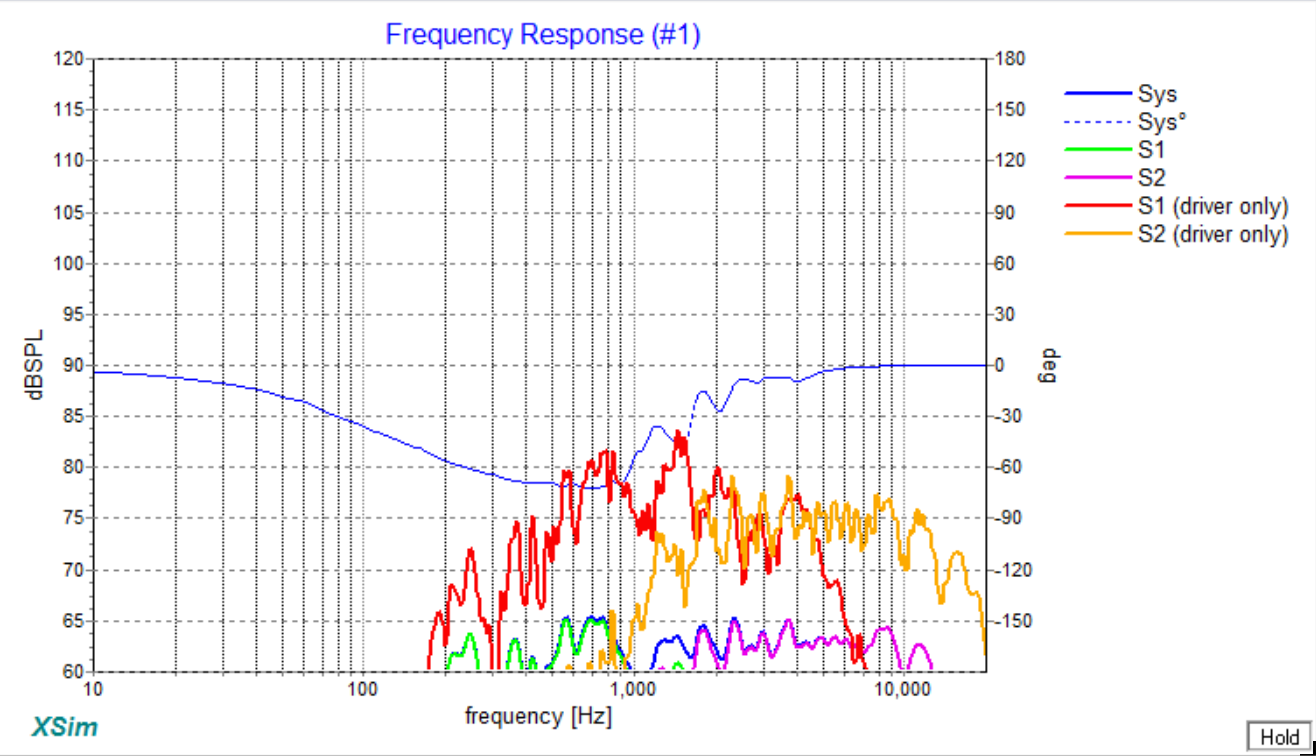

Forgot to add the delay of 3.23in.. Now it looks much worse:
attachment.php

Sultanen, my friend, this is quite a step into the unknown for me.
I've never seen a 6" polycone and cone tweeter design in my life!
You can't run a tweeter with no DC isolation, so a capacitor at least. Tweeters don't like low frequencies, it fries them.
I think your offset between the acoustic centres at 3" is just plain wrong. 1.5" might be closer. Or try flipping the polarity.
To fill the 2kHz hole, we have to make the tweeter work harder. So try a bigger tweeter coil.
Im glad i can give you the opportunity to take this epic journey with me!
Yea, thought of that but i was just trying to get to some baseline from Erics advice 🙂

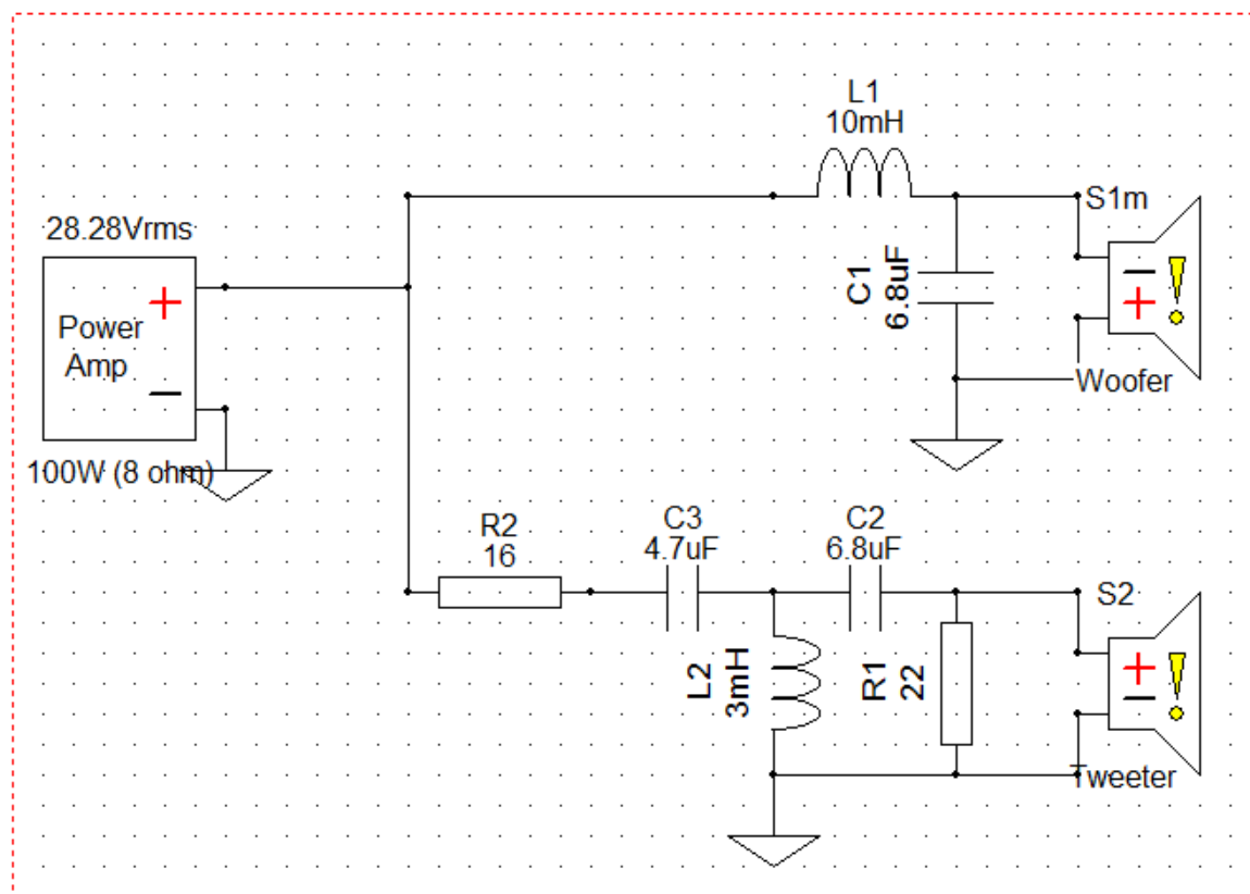

This is the circuit without modification, woofer flipped polarity and offset 0.77in:
attachment.php

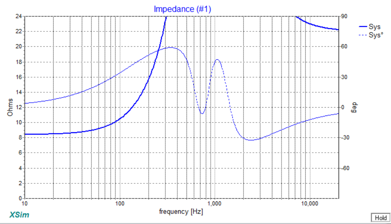

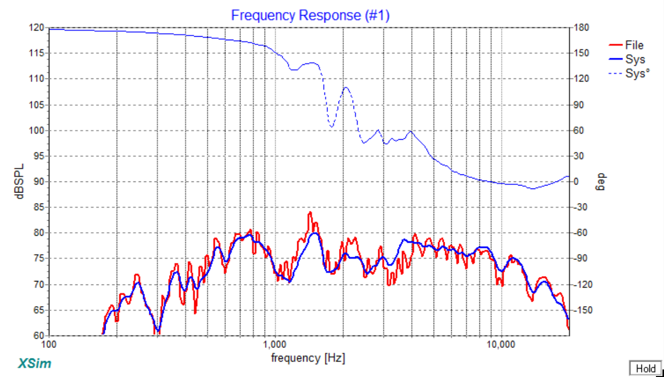

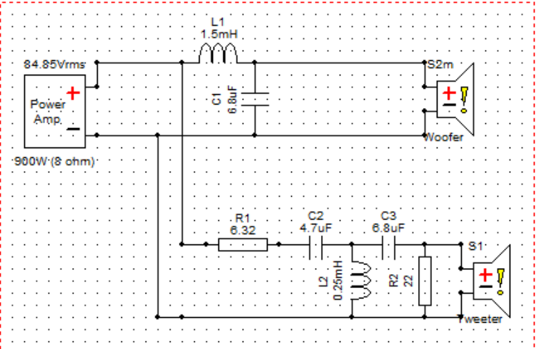

Tried to play around a bit. I put in a bigger tweeter and woofer coil and bumped the tweeter resistor up to level it out and this is the result. But the impedance curve is totally off right?
And i still have no bass =/
