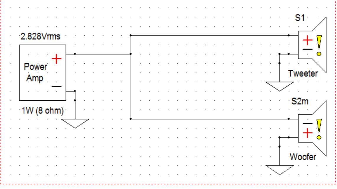

Here is a zip of the base design, Tweeter+Woofer. Woofer has inverted polarity and a delay of 0.77in.

Here's what I came up with. There are 3 cheats.
1. The 0.1mH Inductor is phony, but meant to represent the L of the voice coil.
2. The 56 Ohm resistor is phony, just there to make XSim see the tweeter as a 7 Ohm.
3. I've added an impedance curve from the Woofer from a Focal I have that has similar specs. Or might be. Who knows. 🙂 IT's a total "Hail Mary" like they say in US football when you have nothing to loose and you throw a 50 yard pass in the hopes you could win the game.

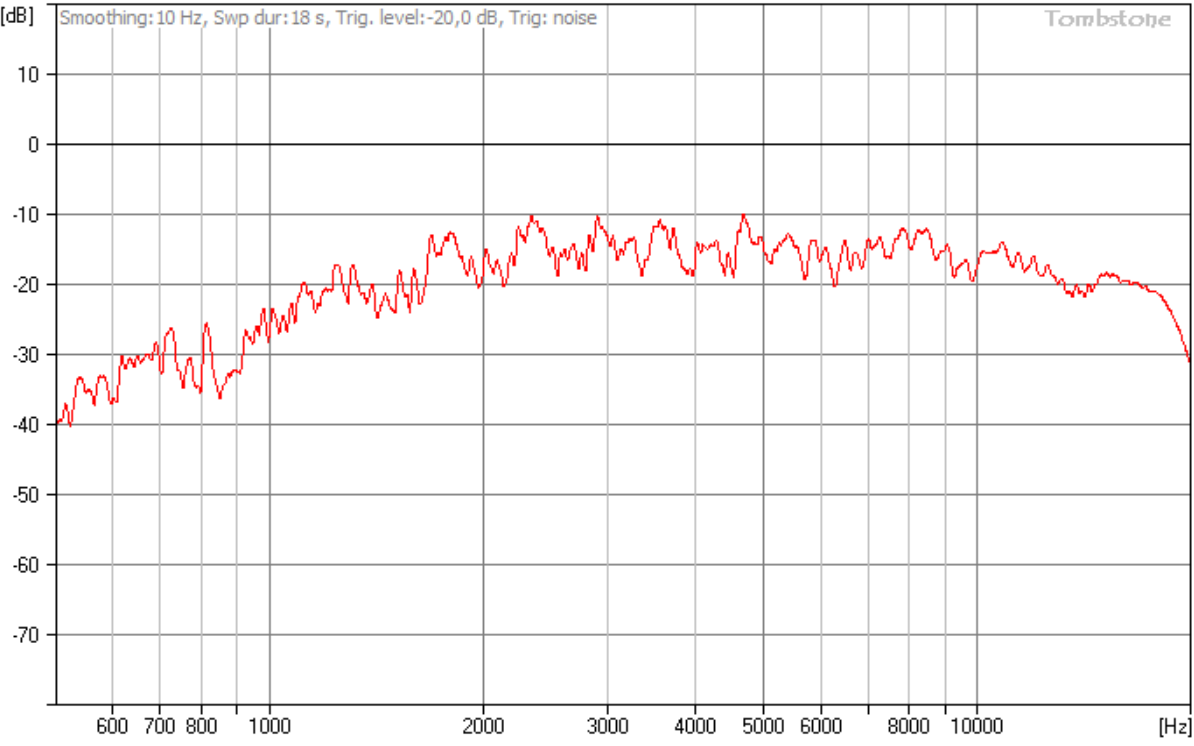

Last question, are you sure you measured the tweeter with the microphone pointing straight at it? I'm a little worried the top of the FR is a little too steep.
Here are the pics. You won't get agreement with the FR because you don't have my impedance file. I'll send it all to you when I figure out how to upload.
This would be much more accurate if we had real impedance curves instead of the one I borrowed from a Focal driver. It matters most for the woofer, but the tweeter as well.
Let's go over the schematic.
Tweeter
I used two "CircuitBlocks", a High Pass 2nd Order and an L-Pad. R2 and L3 are just there to make XSim pretend the tweeter is closer to the real one. R2 makes the effective 8 Ohms 7. The 0.1mH inductor is straight from the spec sheet. In real life, you would not buy these, they are part of your tweeter already.
C4 is an equalizer that's helping to boost the top end of the tweeter. It's essentially a high-pass filter around that resistor. We're cheating because that resistor is both part of the L Pad and part of the EQ circuit. It happened to work, but in some cases you'll need to break that resistor down into 2 and bypass only one of them. Examine the FR as you remove it and add it back in. Also examine the Component Voltage graph for S1. You will see the voltage at the tweeter change as this value changes.
Woofer
This one is not going to match real life very well for two reasons. One, we are using phony impedance curves, and two, I suspect the FR was from free-space. We need the FR from the speaker against the wall for the woofer to be accurate. Still it's a good example.
L1/R1 are the Baffle Step Compensation, but also part of the low pass network. C1 is the second pole. C3/R6 are a Zobel network I threw in. It keeps the impedance of the woofer low despite the inductance. To see the effect, pull out the tweeter high pass block, and add and remove the ground at R6. Look especially at the impedance curve. It has the end result of helping to keep the downward woofer slope stay consistent, but also changes the overall phase of the woofer, so sometimes this circuit can be played with to get better phase matching.
R5 is an impedance compensating circuit. When I looked at the impedance plot there were some very high numbers. If you were using tubes it would be mandatory. With solid state it's optional, but it can prevent ultrasonic ringing, keeping your amp from working extra and some say makes it sound better. Again, try adding and removing it while looking at the impedance plot.

Okey, now i've done in box measurements as well and i got 80HzFree air frequency: 51Hz
Will do in box tomorrow =)
Good afternoon and thanks for all the posts! Sorry that i did not answer earlier, i did in box frequency measurement and also another tweeter response curve to answer this question 🙂Last question, are you sure you measured the tweeter with the microphone pointing straight at it? I'm a little worried the top of the FR is a little too steep.
I actually noticed that the microphone was not really aligned with the casing so i tried to correct that.
I set a frequency of 1000Hz and measured the dB of the mic with the old placement and got 62,9dB, when i got the microphone into the most optimal angle i could find i got 64,8dB so its a bit of a difference.
I will also get the FRD file in a few minutes =) Will answer all of the other posts after that.
EDIT - FRD file attached. Its only 500Hz-20kHz, hope that will work okey =)
It was in the middle of the free space in between tv and the sofa, 1.2m to the wall from the back and 1.1m to the wall on one side, about the same to the sofa on the other side.Got it. When you measured the woofer for XSim, where was the speaker? Against the wall or middle of the room?
