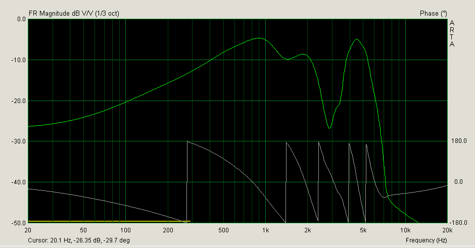

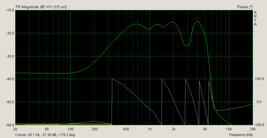

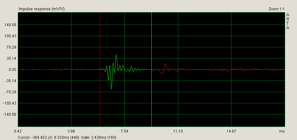

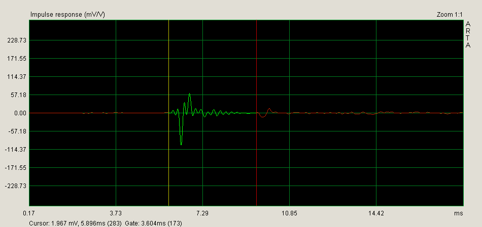

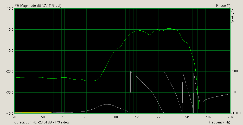

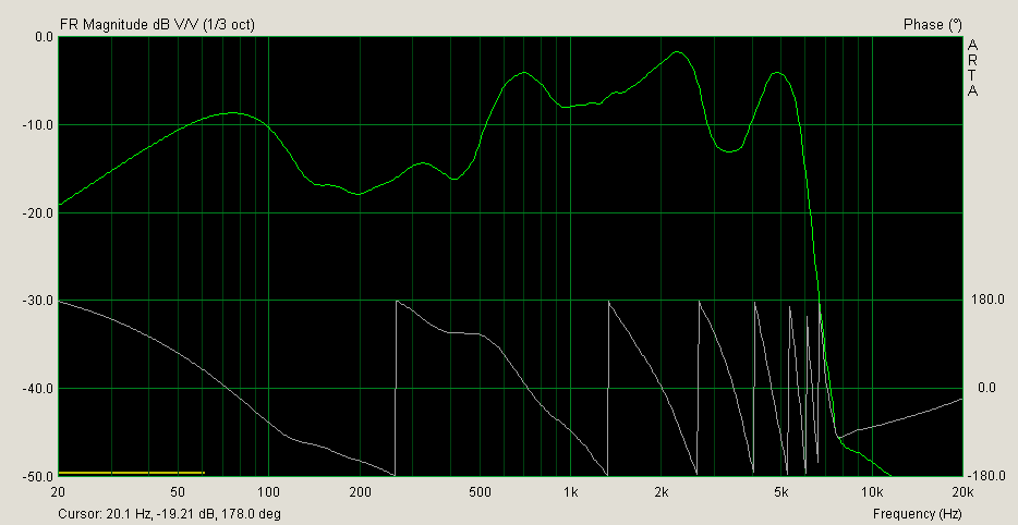

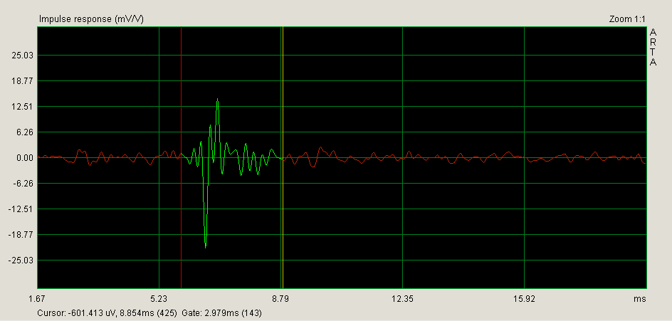

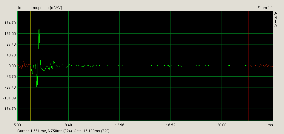

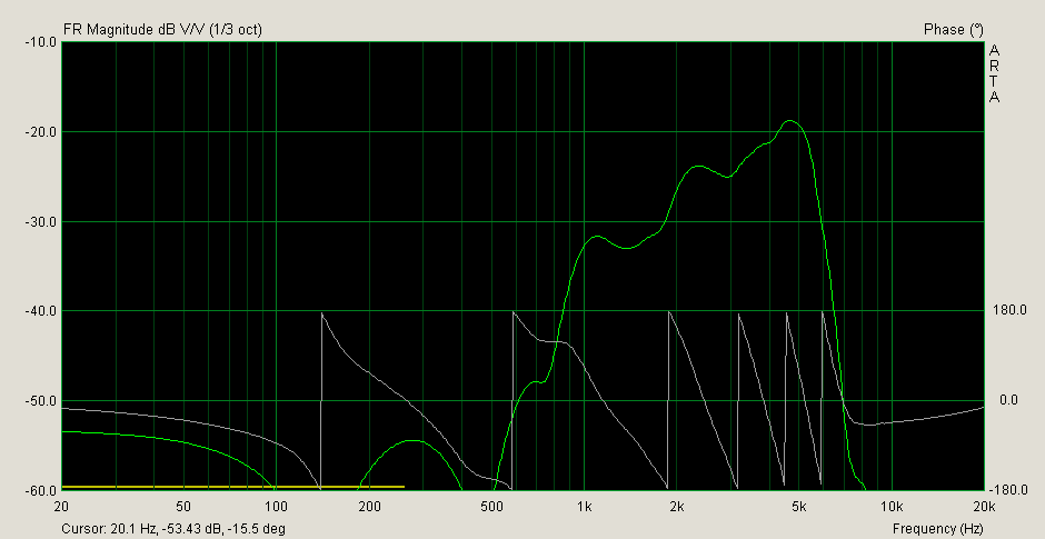

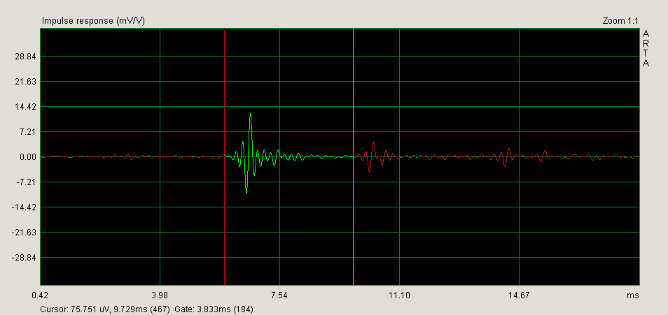

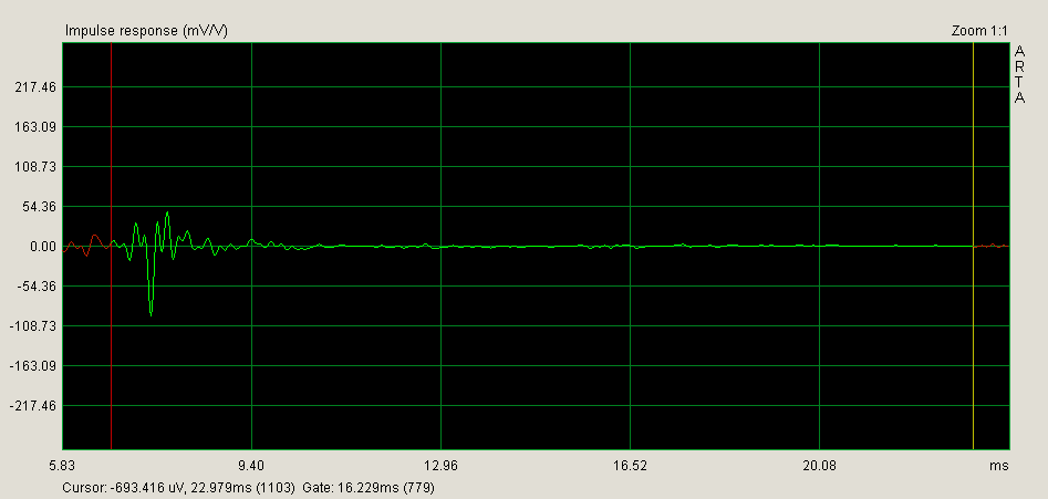

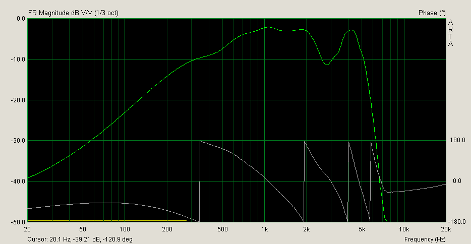

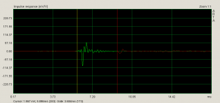

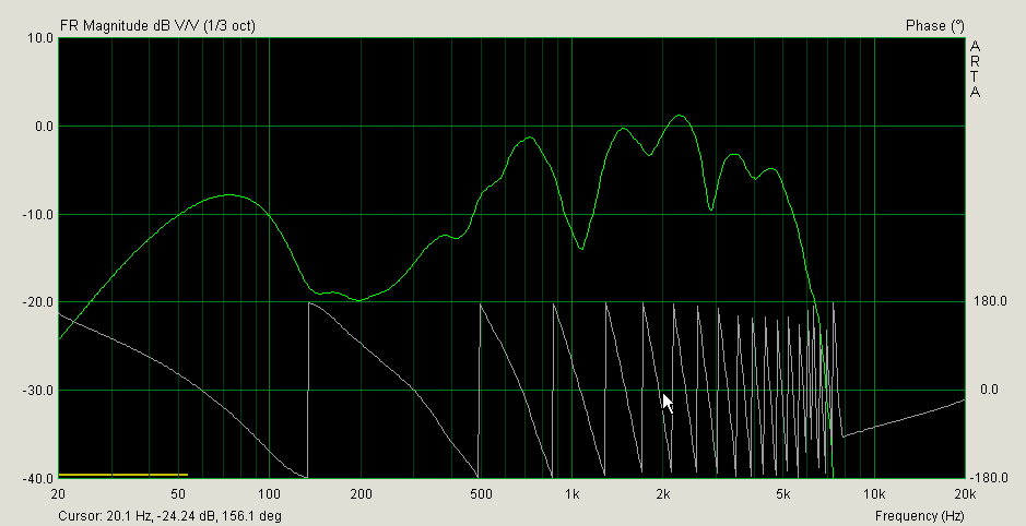

I have been playing with ARTA quite a few hours today, i moved the speaker to the garage and used a car amp to power it at 1,837V. The speaker was positioned in a corner with about 1,1m to both walls. I used the laptops soundcard for input and output instead of USB soundcard becous i had some issues there.
I kept the starttime on the impulse the same for all far field measurements.
I hope i did some of this the right way, otherwise please tell me 🙂
I did the following measurments with hopefully decent impulse "intervals"
Far field 1m from speaker, never moved mic or speaker:
-Tweeter
-Woofer
-Tweeter+woofer
-Woofer wall - listening position
Near field 10cm from cone:
-Tweeter
-Woofer
2016-02-07 18_58_09-woofer+tweeter-far-field-impulse.png17.4 KB · Views: 214
The last uploads, was limited to 10 in last post.

I have had a look at your measurements and I have a few comments.
The zma files show an Rdc around 110R for both woofer and tweeter. This can't be correct.
You measured the nearfield response at 10cm. It is best to get as close to the dust cap of the woofer as you can without the mic touching the speaker - say 4mm.
The nearfield FR of the woofer has a 17dB dip between 70Hz and 700Hz. Someone else might be able to explain what is happening here.
I can't find any mention of which microphone you are using for your measurements. Is it calibrated?
Regards
Robert

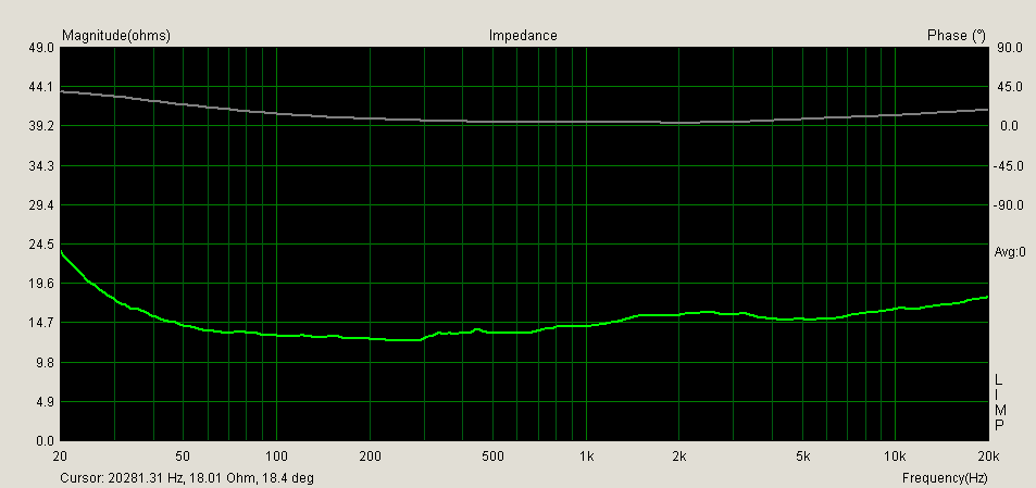

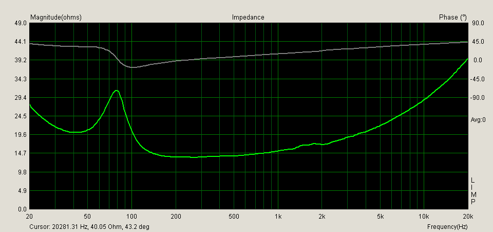

So, now i finally have some impedance data thats closer to the values we want. Does this look okey now? =)
Woofer in box
Tweeter in box
Woofer in box
Tweeter in box
Haha, no way. 🙂
Driver should be around 3-8 Ohms at the bottom. 🙂
Manufacturers usually get the impedance charts right, but little else is trustworthy. 🙂 Compare your tweeter with the spec sheet.
Best,
Erik
Best,
Erik
