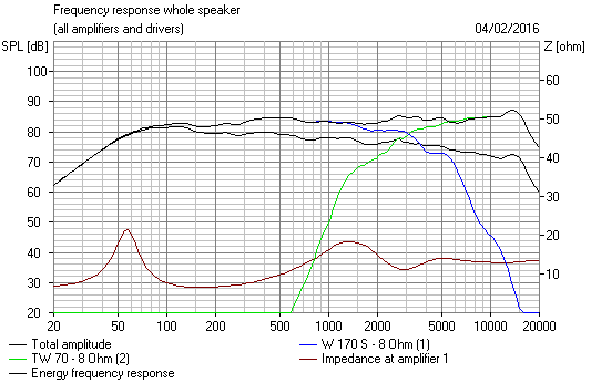

I got the last set of curves into Xsim with SPL Copy =)
Added 90dB so the range i used was -60dB->30dB, 0dB -> 90dB

Aha, so ill get a FRD file of the full system without crossover aswell and display both? Will do!

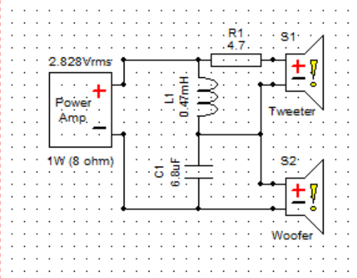

And a classic old peerless CT62H cone tweeter. Marshall Leach's circuit will probably do about the right things, though you can do more. 6" polycone is an easy speaker. Possibly 2.5kHz crossover. I'd spray the baffle black too.
I will draw this circuit in Xsim to see what results we get 🙂

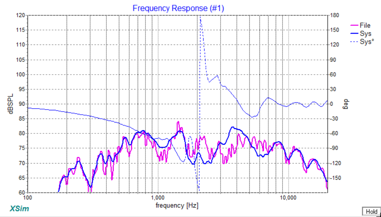

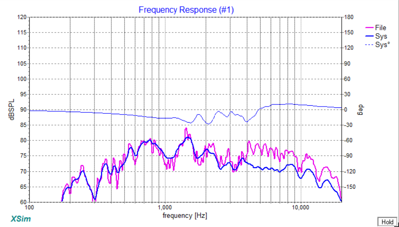

Yea, he seems to know what he is talking about 🙂 I actually tested the circuit he showed 69 in # but then i realized i had to do the delay first..

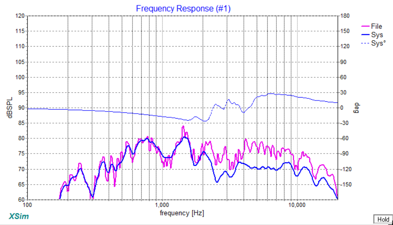

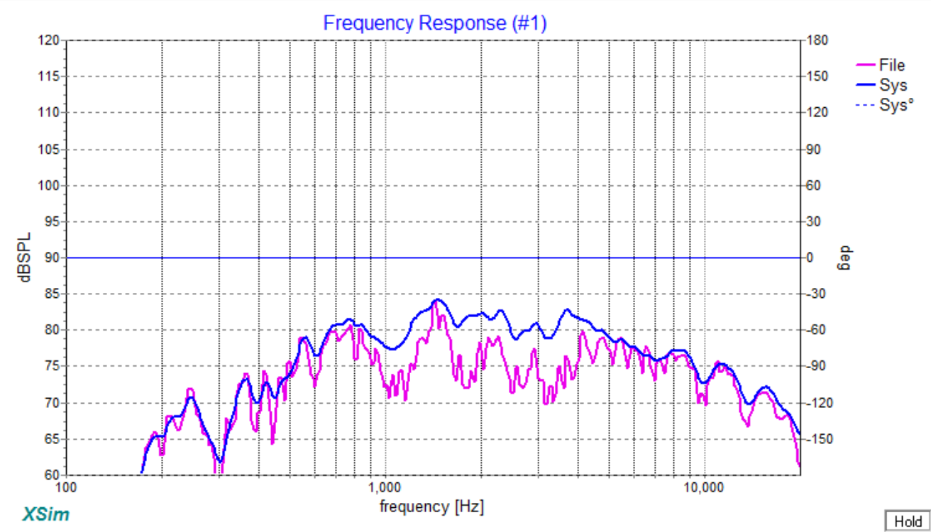

I've got the full no crossover graph into RF now, without delay:
When i adjust this, what is my goal? Some specific part i should aim on getting down? Ive tried both positive and negative delay and it's not getting that much better than without delay.
I also attached the RFD files(renamed to .txt)

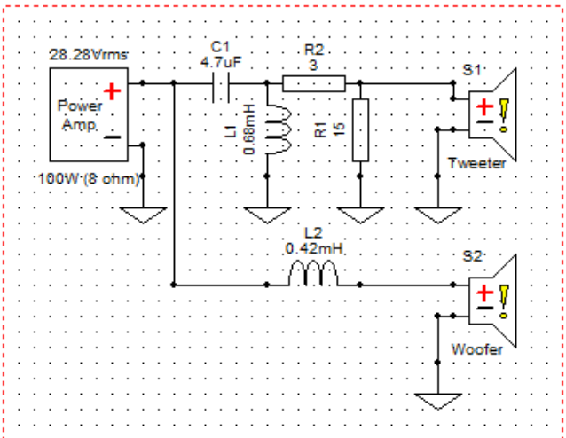

Sultanen you are very busy with your sims! 🙂

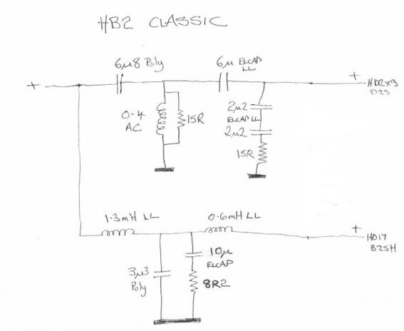

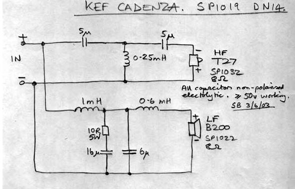

Can I suggest a couple of circuits to try? These use polycones:
Heybrook HB2 simplified:
KEF Cadenza, for which you should flip the tweeter polarity IMO, this being an 8" bass circuit, yours being 6" bass:
You'll need to attenuate the tweeter, of course.

Do the delay calculations first. You are looking for the best match of FR. Try changing the woofer delay about 1/4" at a time first. You can estimate the delay by measuring the horizontal distance between the back of the tweeter to the back of the woofer. It's probably at least an inch. You'll see the FR suddenly snap into place assuming you measured correctly, without the cap, and without moving the microphone, and microphone on tweeter axis.

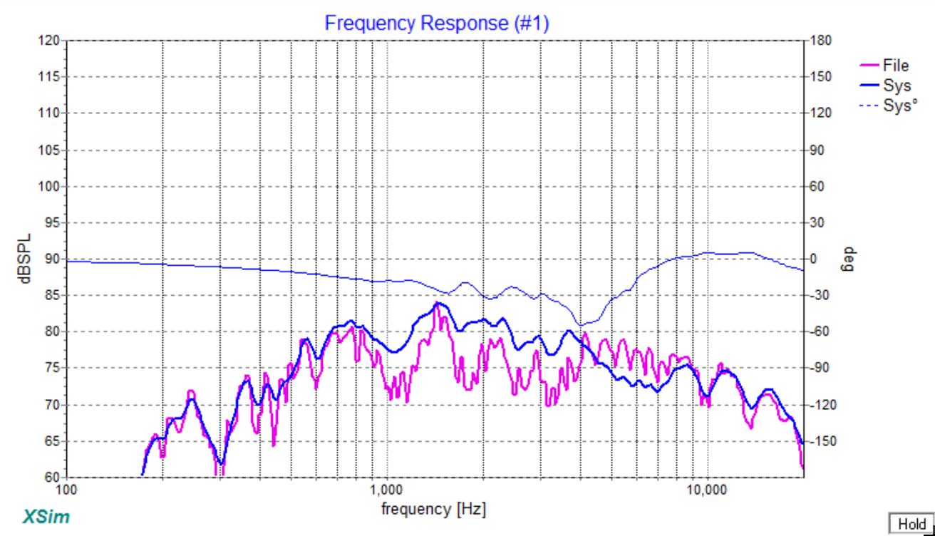

I did the measurements of the drivers and i got about a 6.5cm or 2.56in diff from the back of the tweeter to the back of the woofer. When i add that into Xsim i get:
2.56in:
2.88in:
3.23in:
0.87in:
I think 3.23in looks like the best match?
Another question, how do you incorporate the delay into the crossover? 🙂
Thanks alot for the circuits! Will try some simulations on them as soon as we have decided on the delay =)Sultanen you are very busy with your sims! 🙂

Yep! 🙂 I mean, once you are close, you can try small changes, like 0.1" at a time. 🙂

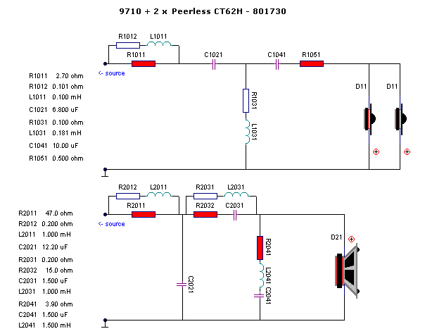

Ooh, I've just realised I've seen Mr. Troels Gravesen, no less, doing stuff with the Peerless CT62H!
Philips 9710/
This is always a help to get some confirmation of the right approach.
He's using a third order filter on the (paralleled) cone tweeters, as I often do. Here 2.5kHz crossover.
You halve the capacitors and double the inductors for a single tweeter. The resistor in front of the filter adjusts level. I always put 22R shunt after the filter too.
Philips 9710/

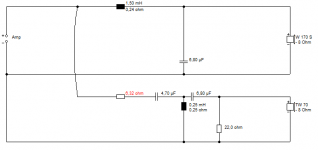

It must be getting late in Sweden, but I've dug up some woofer data:
Imbedanssi 8 ohms
Taajuusvaste 48-4,800 Hz
Fs: 47.5 Hz
SPL: 89 dB 2.83V/1m
Vas: .20,7
Qms: 1.63
Qes: 0.42
Qts: 0.34
Xmax: 4mm
Paino: 1.5kg
And an Le of 0.8mH we knew already. Which is voicecoil inductance. And that is a reflex driver with a smallish xmax.

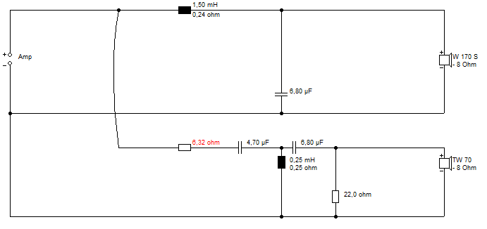

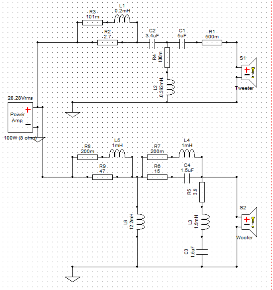

I've been looking at a circuit like below, which seems to do the right things. Now do bear in mind I'm using different, albeit similar, drivers.
Imbedanssi 8 ohms
Fs: 47.5 Hz
SPL: 89 dB 2.83V/1m
Vas: .20,7
Qms: 1.63
Qes: 0.42
Qts: 0.34
Xmax: 4mm
Paino: 1.5kg

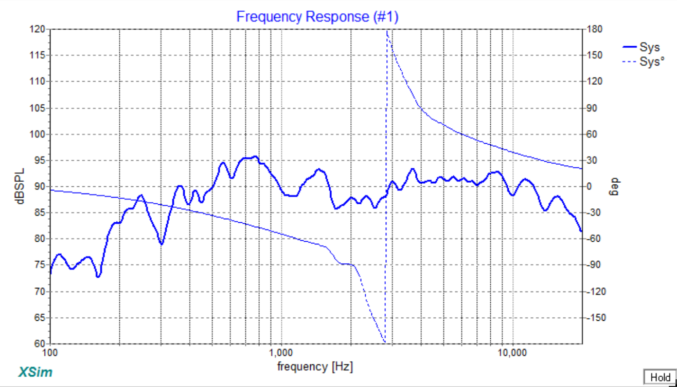

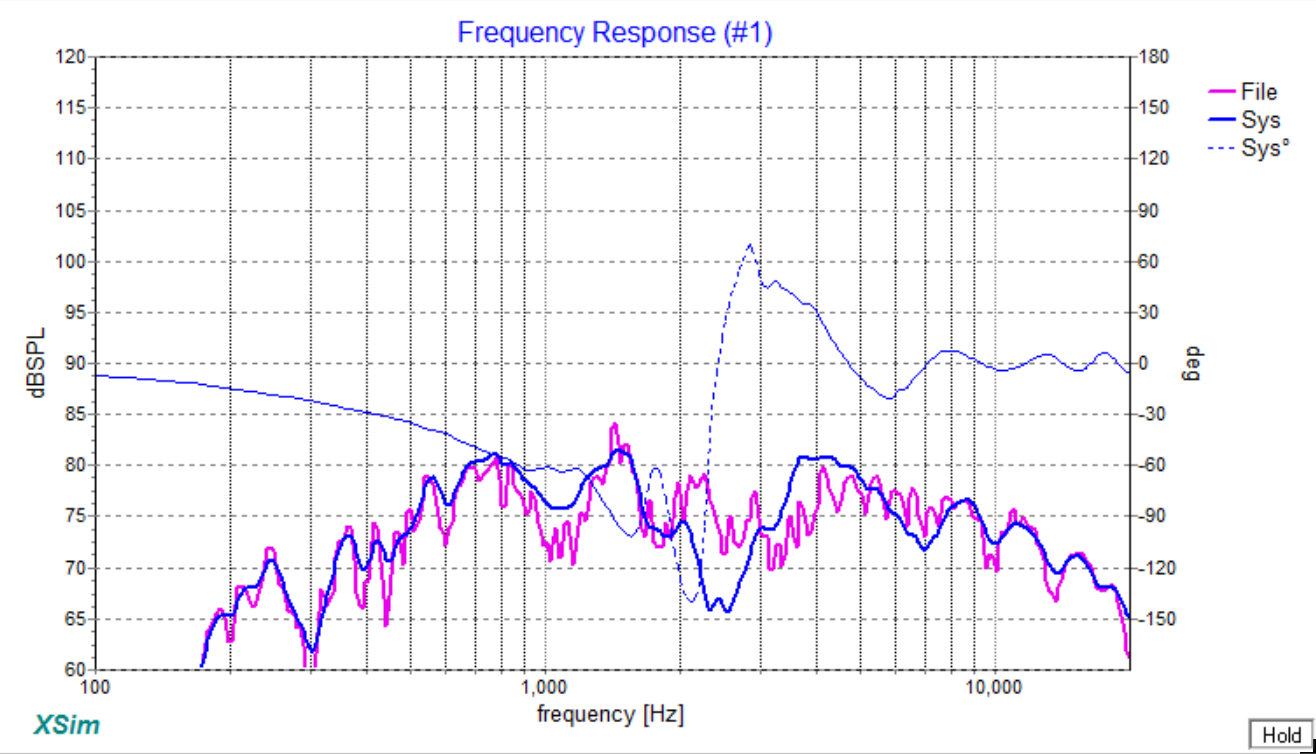

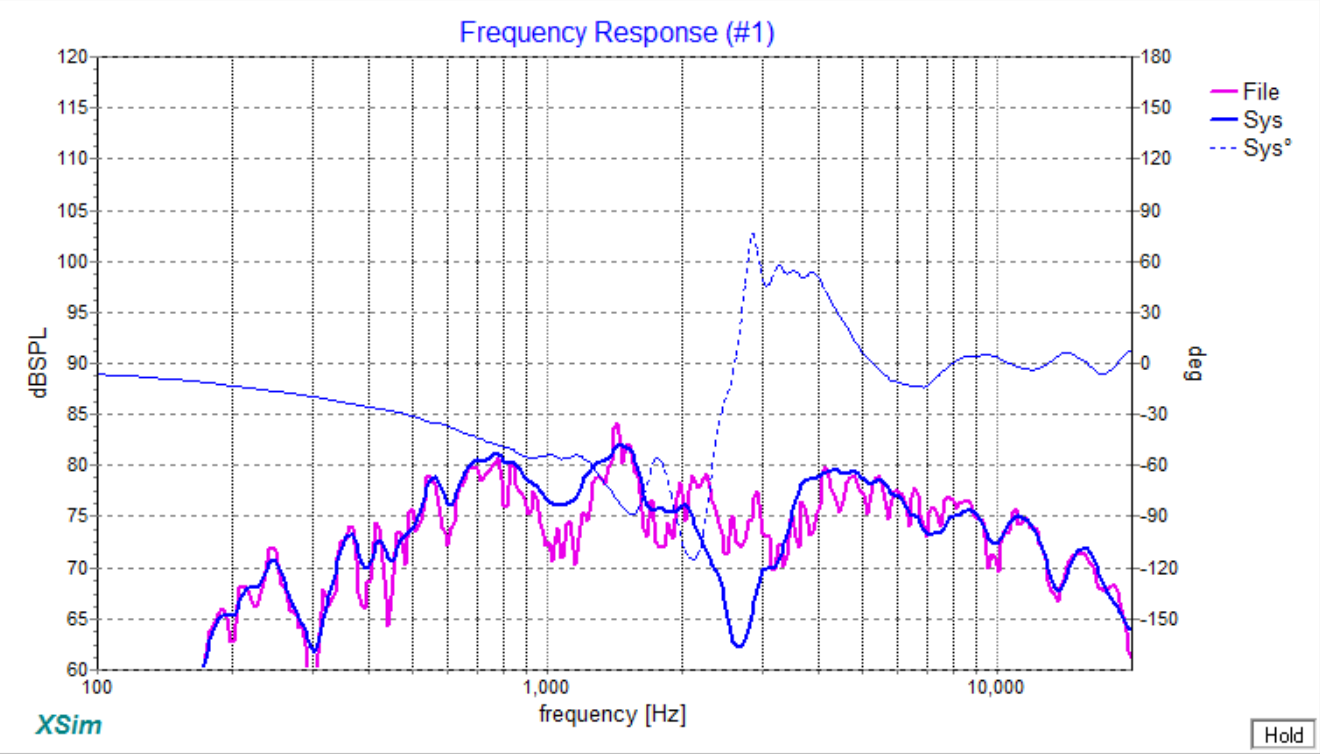

I have simulated the previous circuits but haven't posted the results yet. This however looks like the best one yet 🙂 Its starts to look straighter now! I changed it as you instructed for single tweeter.
without Woofer delay

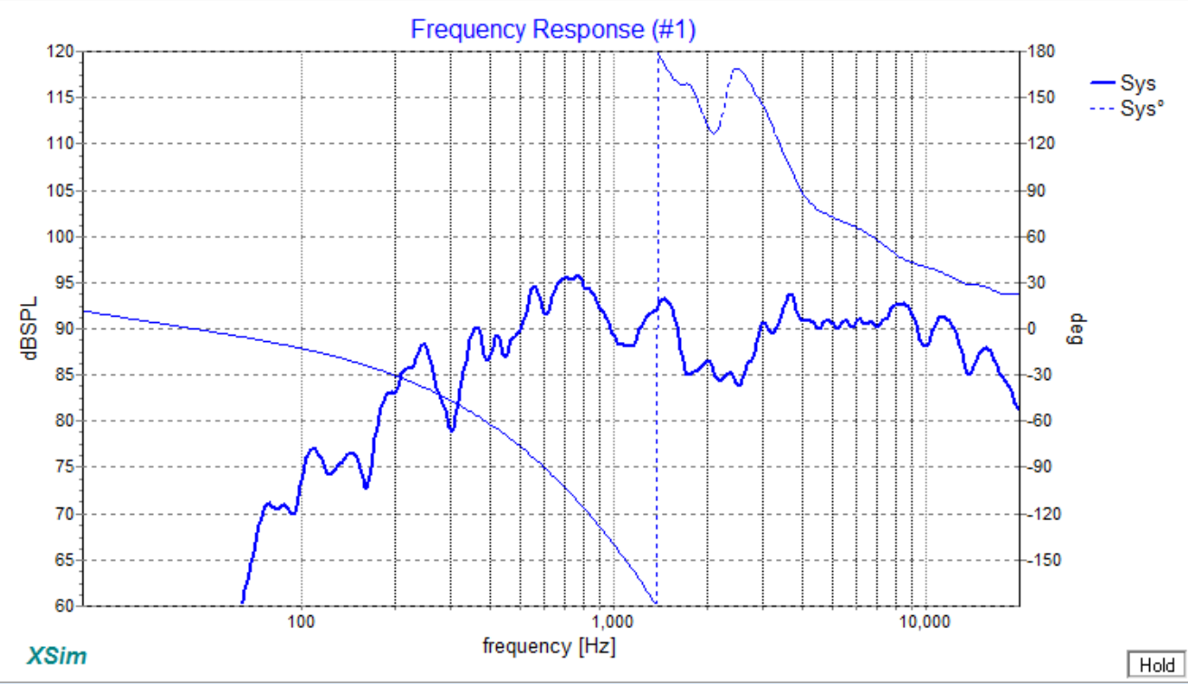

3.23in delay:

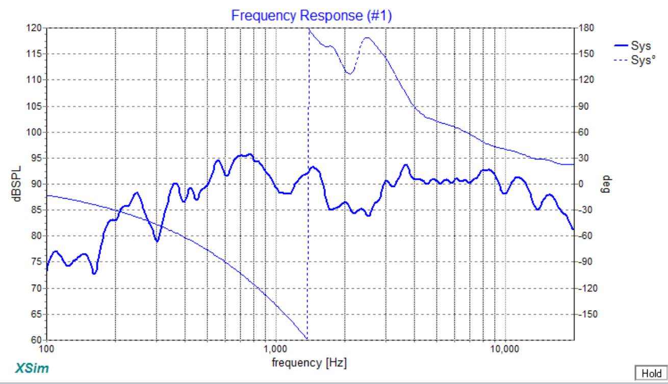

3.23in delay but min freq 20 instead of 100:
Getting there? =)
I still dont have any bass at all though? =/
I'd suggest show the bass separately, and change the range on XSim so we can see down to 20 Hz. 🙂 It will help.
Remember early on I suggested the first thing to do was to flatten the bass from the 40Hz level or so? 🙂
