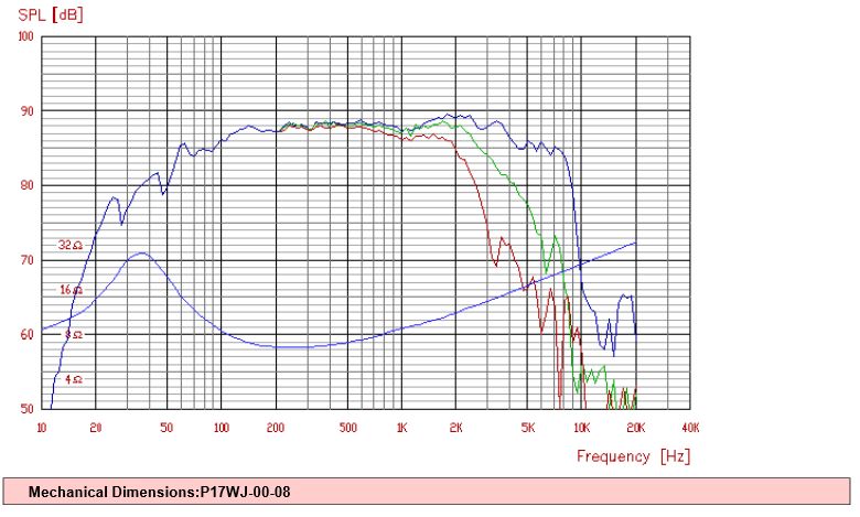

This is a foam surround polycone which is doubtless quite well-behaved on it's own. Just like the old Vifa P17WJ.

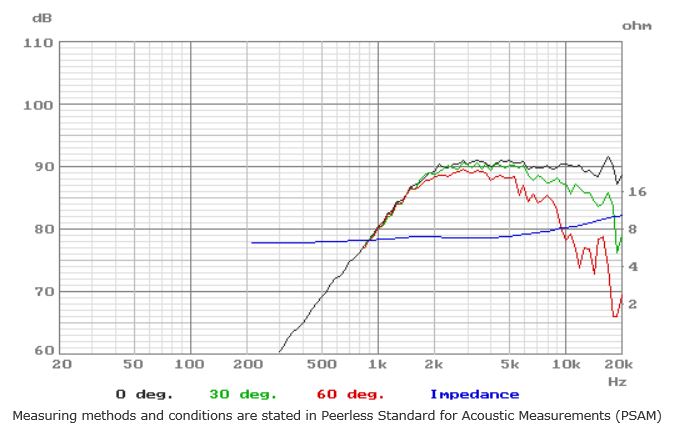

And a classic old peerless CT62H cone tweeter. Marshall Leach's circuit will probably do about the right things, though you can do more. 6" polycone is an easy speaker. Possibly 2.5kHz crossover. I'd spray the baffle black too.

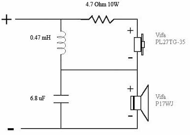

Hi steve,
My friend here seems to want to keep his speaker and use it to learn about speaker and crossover design.
If im wrong and he just wants to build a kit then of course this is too complicated. however no one is hatched as knowledgeable as you are. I think for him this is a fine path, cheap too for now.

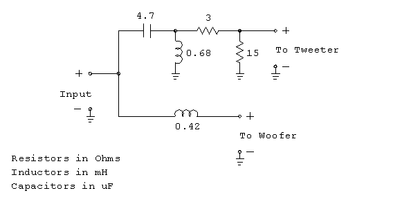

Well, TBH, Erik, I'm winging it here. But 6" polycone plus tweeter is a well travelled road.
You can end up with the simple circuits like below:
And then fiddle with tweeter level to get it balanced. The perfect can be the enemy of the good, and I always sim it with similar drivers to see what it does electrically.

Now, some people do simple series filters like below, but that is just TOO Mickey Mouse and rough and ready IMO.

You make beautiful crossovers Steve. 🙂 But this gentleman is starting from 4 drivers and two caps of different values. Let's wait for him to figure out his measurements first.
He's almost to the point where he can enter your sample crossover and see what it does.

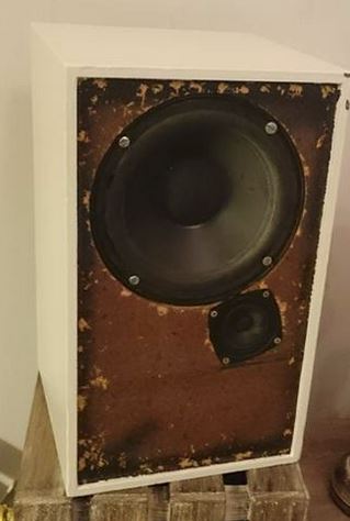

I have finally managed to set the voltage in the correct ballpark! I was initially using Room EQ Wizard and that had output signal set to "-20dB".. I totally missed that yesterday 🙄 Now i switched to Tone and did the 50Hz voltage setting at "-0dB". I managed to set the level to 2.90V. I think that will have to do it for now.
I'm using Tombstone for the curves. Something i noticed is when i use this high volume i get "Input was overloaded during the test" every time(as you also see on the curves upper left corner). Im not sure what that means but i think it feels strange that the curves are so smooth on "0dB", might be something?
I added a carpet and a peace of cloth on the walls on either side of the speaker.
