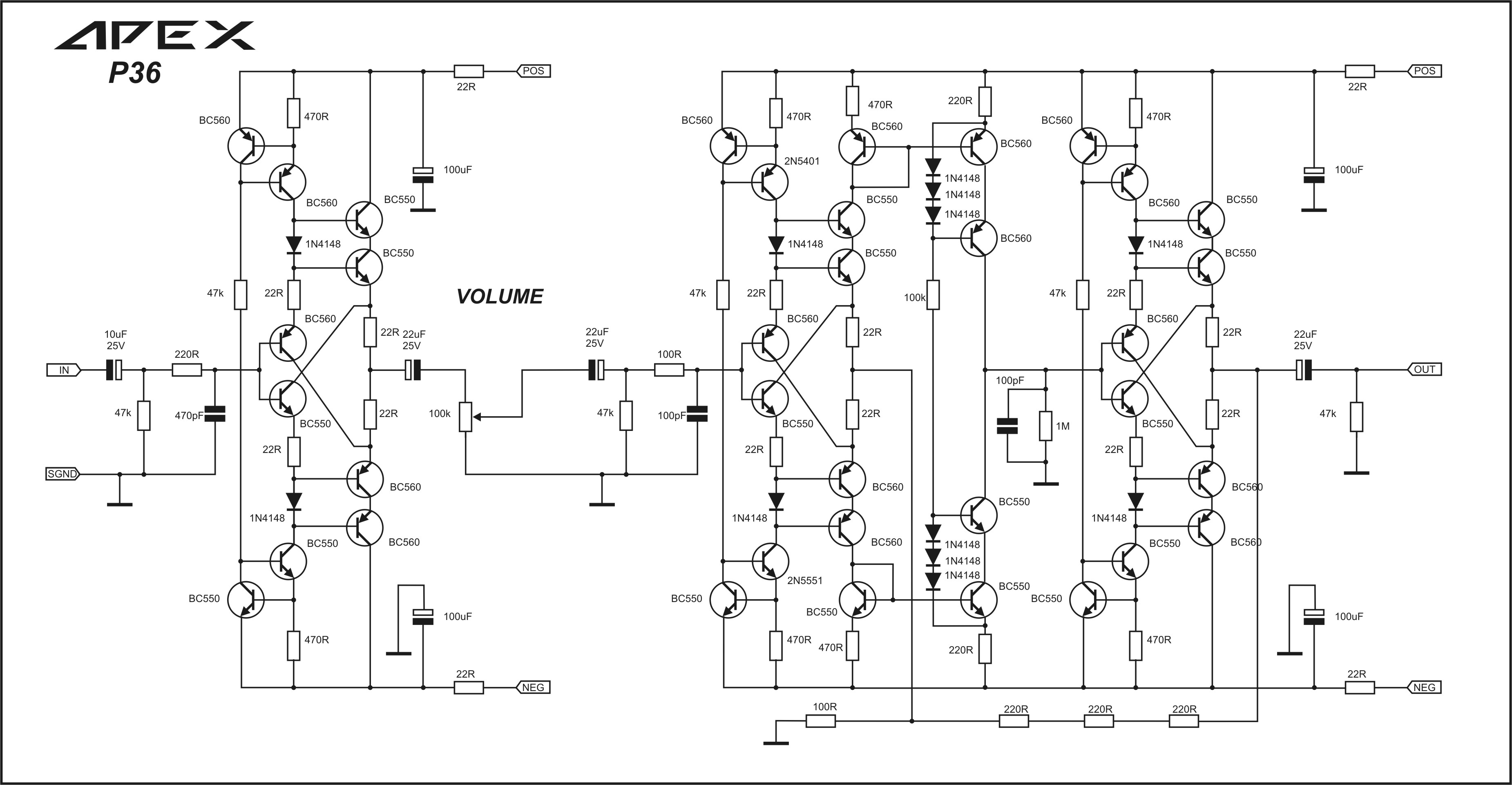

100W Ultimate Fidelity Amplifier
APEX P36

Thanks!:)
If it's possible parts ,parts numbers?

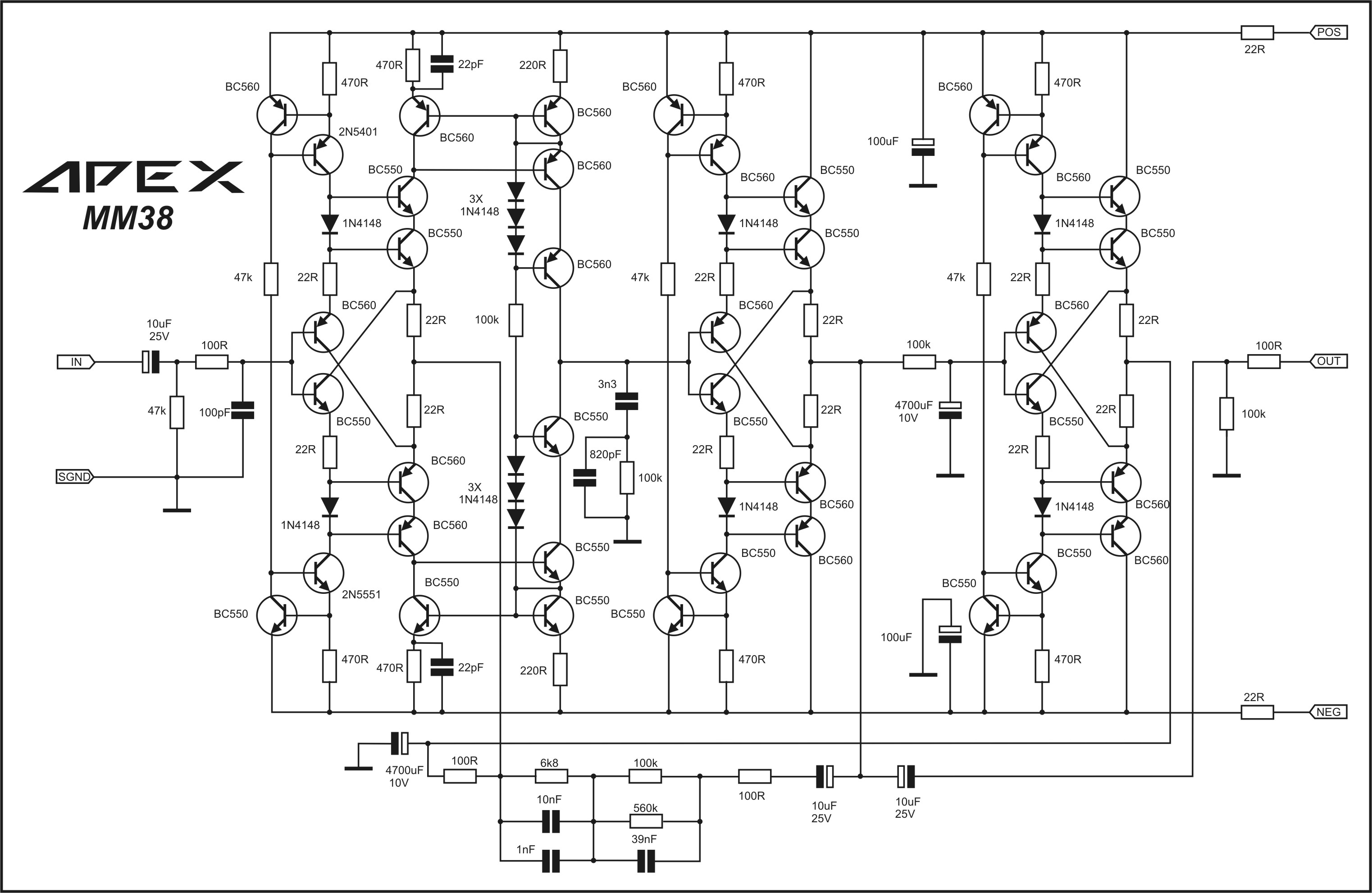

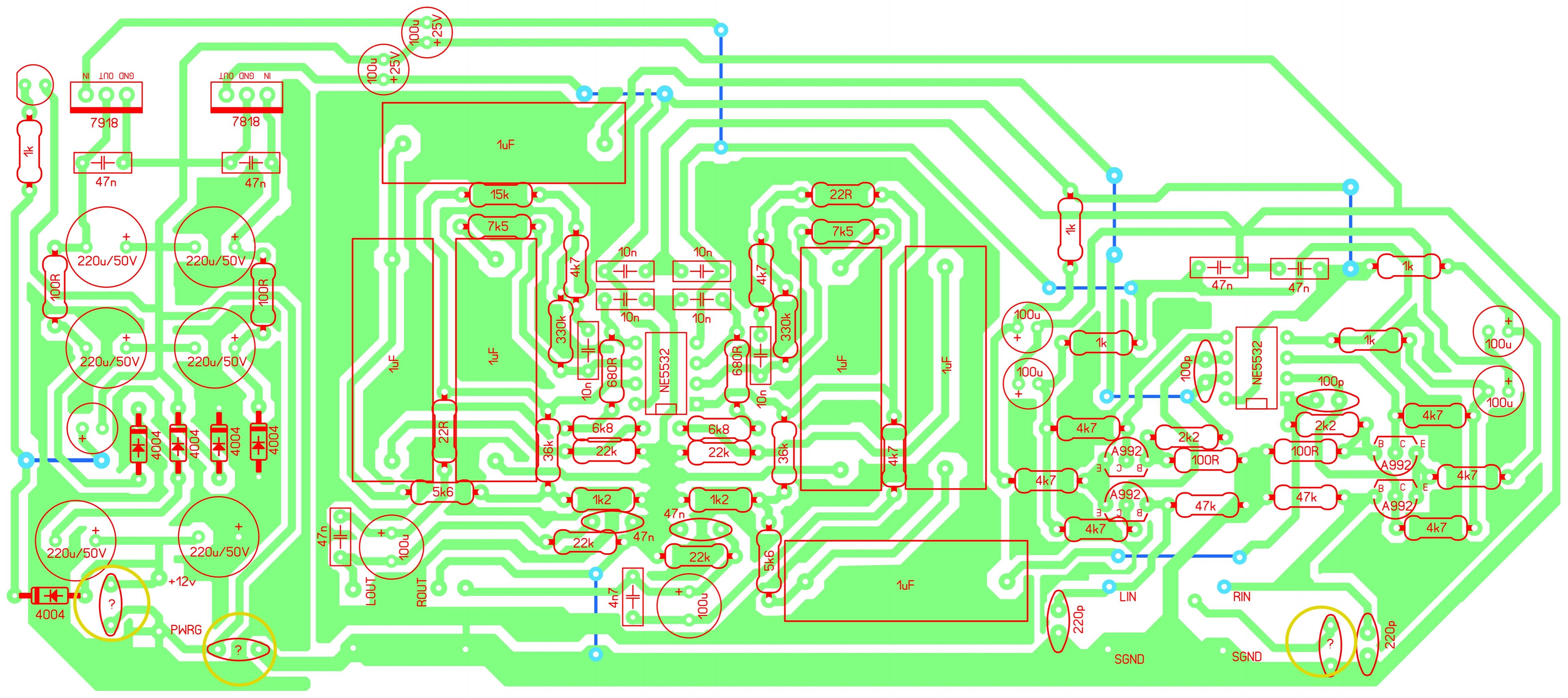

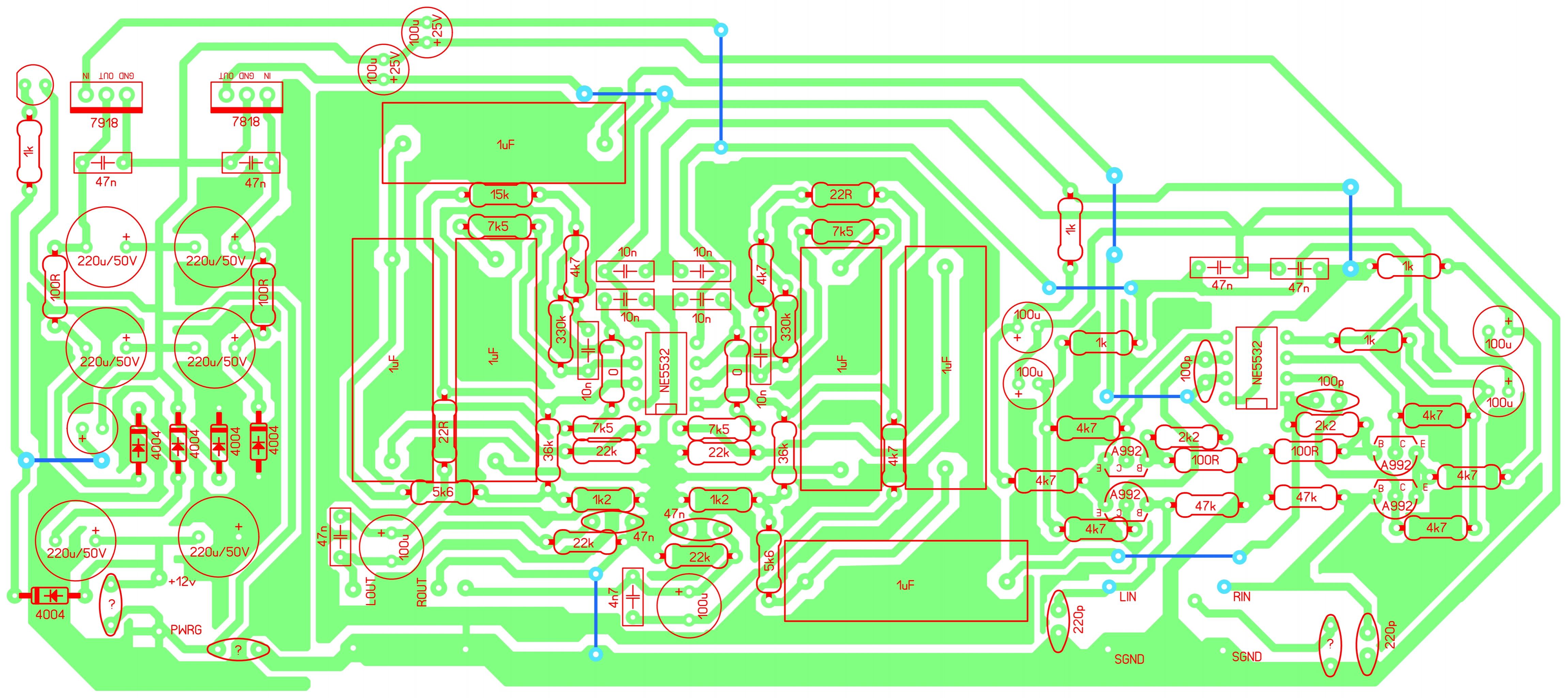

Hi Thimios,
Here is a stab at part values. BC560 is the wrong pinout for this layout. I used 2SA992 but maybe something else is better. There are two resistors that are not in the schematic so I gave them a zero ohm. Maybe Mile can say what they are. Please check against schematic in case I have errors. I guessed on the LED circuit and there is one cap on the bottom right that is not in the schematic. Anyway, I hope this helps.

Hi Thimios,
Instead 7k5 and 0R you can use 6k8 and 680R.
OK thanks. Do you know the value of the three caps on the lower edge of the layout? One across the +12V input, one across the ground circuit although it is connected. The other one is on the right and it is not indicated what it connects to.
Thanks, Terry
