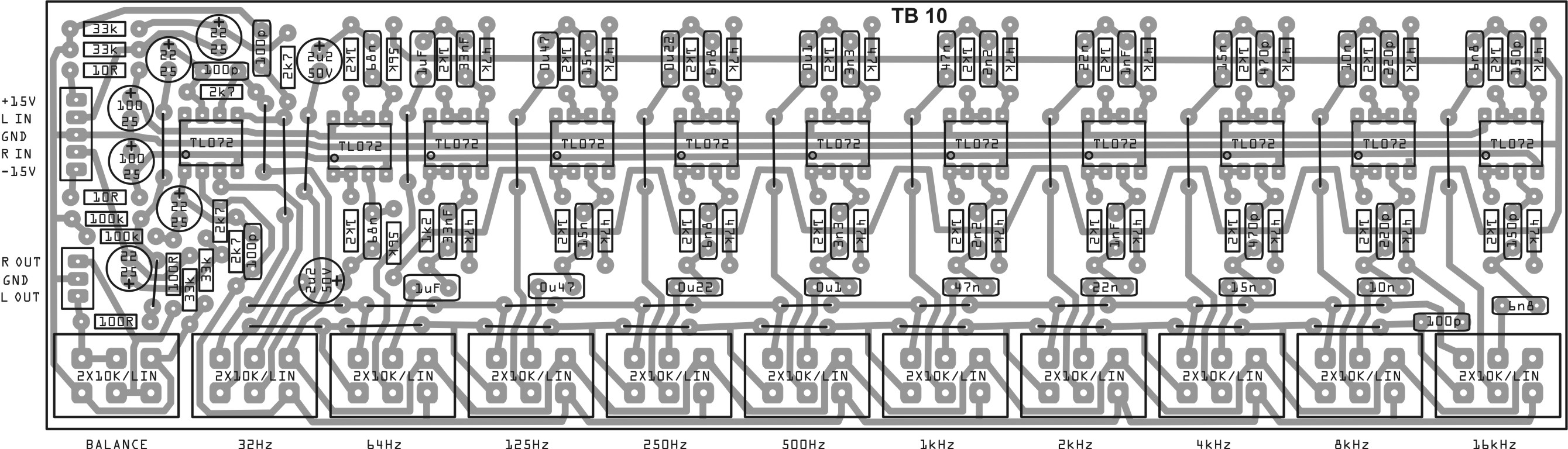

Pcb TB10
Hello, do you have PCB, termic transfer, for this tone control?
Greetings

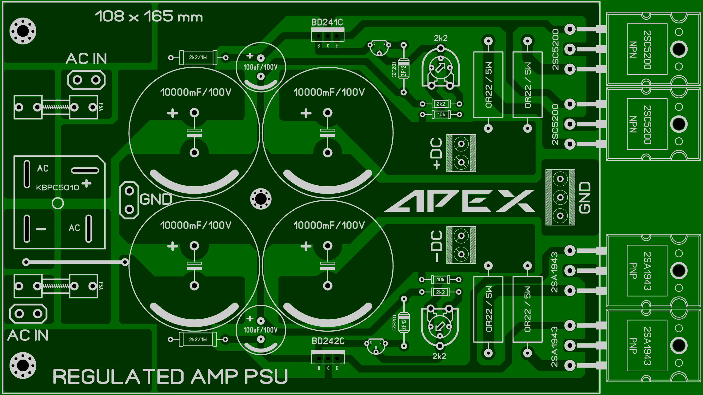

Hi everyone!
Could you help me?
Assembled APEX PSU-10 for APEX A40 and for some reason the output voltage is not regulated. Rotating trimmer voltage does not change at all, on average 48-49V. The difference between + and - is approximately 0.6V.
Although if you measure it at the anode of the zener diode, then it varies from 7 to 17V. Although if measured at the anode of the zener diode (20V), then it varies from 7 to 17V depending on the rotation of the trimmer. Therefore, I am confident that the trimmer is in working order.
I already tried another trimmer, I thought maybe I didn't get a worker, everything also remains. The board is washed and clean. I checked all the details before soldering, selected similar characteristics in each shoulder.
All components are used as indicated on the board. Except for capacitors 10,000 microfarads. They were replaced by 20,000 microfarads.
Could you suggest what else to pay attention to?
Thank you in advance.

Use 12V zeners...
